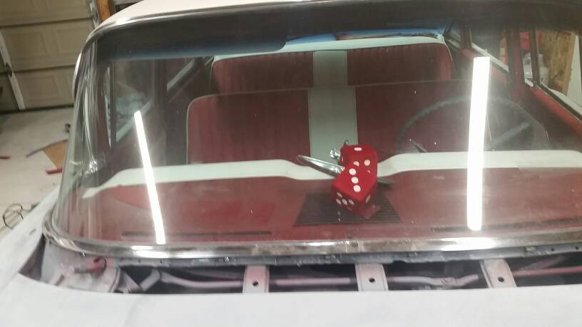

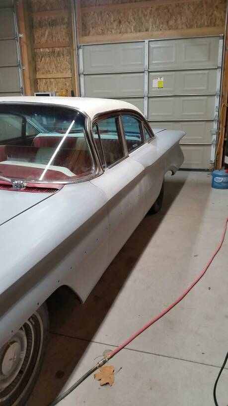

    Very cool lines, I'm doing a 4 door super 88 currently ...shaved the door handles and mirrors to really show those ***y lines, rust free Montana car. Will be putting metallic red white top red and white interior...

  5. rsmcewood
    Joined: Mar 6, 2013
    Posts: 23
    rsmcewood
    Oh yeah, 394 ci with an acid ported, custom phenolic spacer install 371 tripower manifold...runs great

  7. rsmcewood
    Joined: Mar 6, 2013
    Posts: 23
    rsmcewood
    Had an offenhauser for the 394 originally...couldn't shut the hood either, this I can without much room to spare, fun times either way
