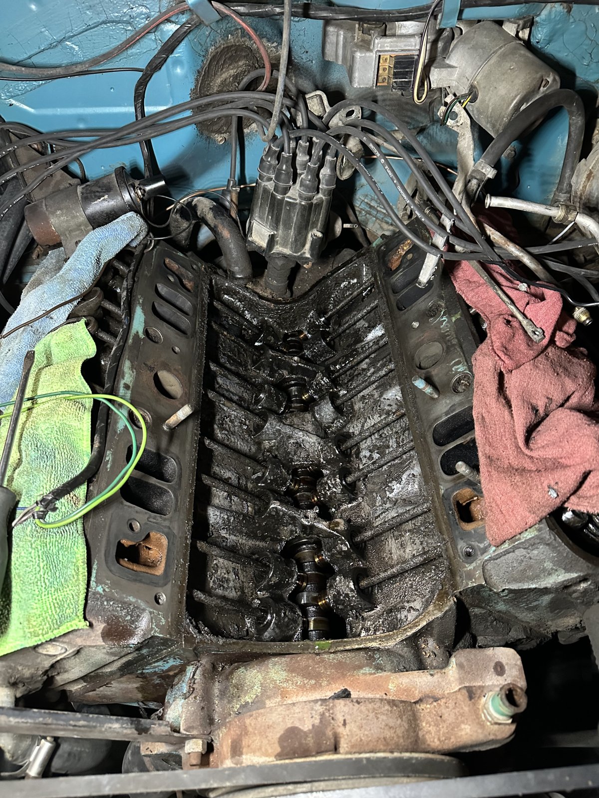

    Hey Y’all!
    Pretty new to actually posting on here. I know the 389 has a lot of FAQs on here, and according to my old man, yall are the people I should be asking about this!
    I have a 389 4bbl Ventura, up here in Canada, and i have needed to replace a few gaskets on it that were leaking.
    As I dug in a bit, I found a TON of grime and gunk in the block under the push rod cover. Trying to find info on the specific 1960 seems a bit difficult but I have tried the search, hopefully I was searching the right things
    I was curious if anyone has a photo of how it should look inside (cam wear etc) that they would be willing to share?

    That's a lot of sludge ! Ideally you'd tear it down & clean it up , in the real world , I'd re-gasket it , use good quality high detergent motor oil , ( rotella) , wix filter , whenever you drive it , make sure you get up to operating temp (15-20 miles) & change oil @ 1000 mile intervals , itll take some time but it will clean up , be patient .

    Years ago I got I to a motor that looked just like that.
    I got it tore down to were your at, emptied the oil out, put plug back in then a liberal amount of diesel fuel and a parts brush and went to cleaning everything I could reach, lifter galley, cam, etc.
    Once that was done, pulled the push rods and lifters, noting specifically where they came from, cleaned out the push rods with pipe cleaners and more diesel, then dis***embled the lifters, one at a time, cleaned and re-oiled, really ***embled. Then put the lifters and push rods back in their original locations. Checked cam lobes while apart.
    Then I pulled the rocker arms, cleaned, re-oiled, adjusted the lifters and then I pulled the drain plug and let the old diesel flow out, a couple more flushes thru the lifter galley, finally put it back together. Drove it for 3 more years before selling it.....
    One thing I did do though was once together, put cheap oil and filter in it, ran for 10 minutes, changed oil and filter again, cheap stuff, went 100 miles did it again, then 500 miles and did it again. Then drove the cheap out of it...

    The one problem with using anything to clean the valley area is that sludge and debris ends up in the oil pan. It then gets ****ed up in the oil pump screen eventually starving the pump. If I was to clean this, it would also include dropping the oil pan and cleaning it and the oil pump screen. With the pan down it might be wise to pull the front cover and take a look at the timing chain and gears. Pontiacs had a problem of having the plastic teeth start falling off the large gear and end up in the oil pump intake.

    If it were mine, I'd pull it and completely dis***emble and clean. This gen Poncho oils the top end through the studs. Any clog/blockage will lead to more problems. You'll also have a chance to check the crank. Do it right, do it once.

    Cleaning is useless until you verify that there is no ac***ulated **** in the big ends. If using the engine without cleaning the crank and all other oilways you might ruin the engine. Running it on high deterent oil might losen up the hard baked stuff in the crank and take out a big end. Chances are high - don´t ask. Dis***emble the engine and clean everything and have piece of mind .
  9. Think I would use a good shop vac,and slowly s****,and **** the loose **** out.When its pretty clean wipe out as much as you can with shop towels,and solvent.This way as little **** as possible goes to the pan.Do a couple 100 mile oil changes,and cross your fingers.

    If you're not going to pull the oil pan don't touch any of that sludge, it will clog the oil pump pick up screen. The best thing you can do short of a full dis***embly is drop the pan to clean the sludge out of it and flush all that **** out of the top end with a stiff brush and some kerosene while the pan is off. I'll bet the oil pan has a half inch of sludge on the bottom.

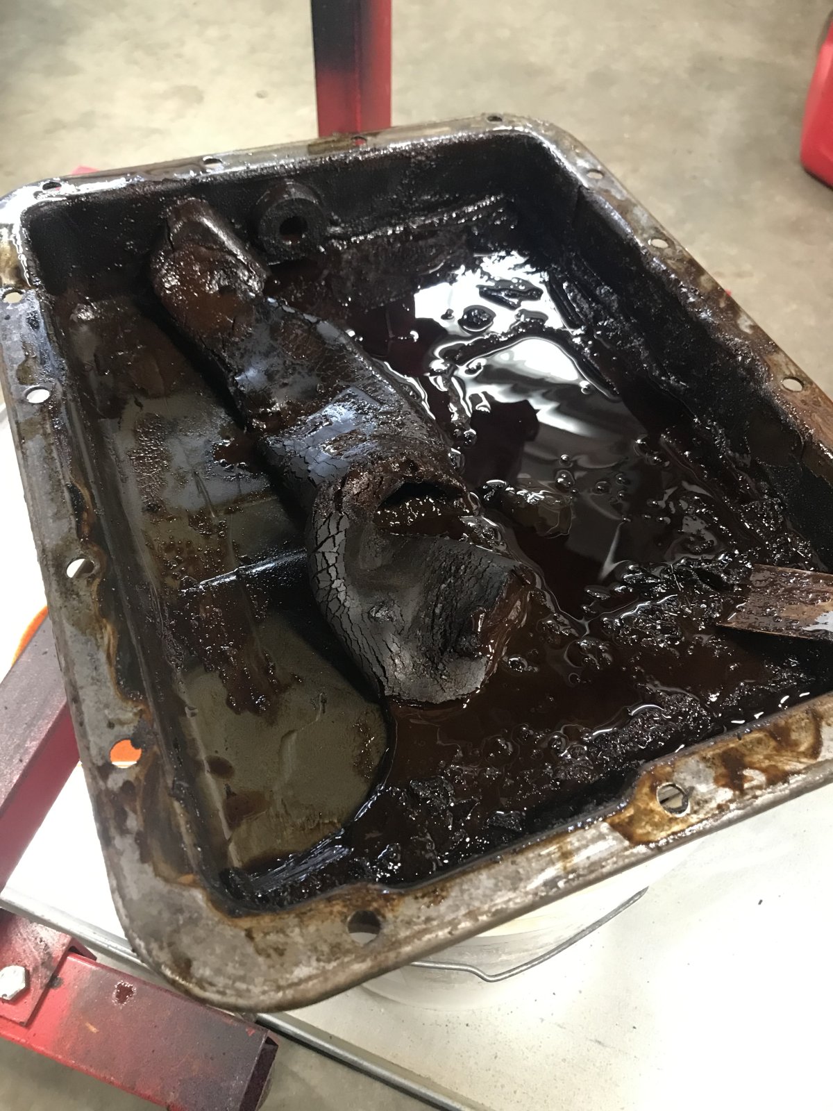

    Look familiar?
    This was what the pan looked like. There’s one chunk still stuck to the bottom of the pan.
    And in the transmission…..
    Both the engine and trans have recovered and are doing well so far. I might not take it on a cross country trip (yet), but it’s great for parts chasing and somewhat local car shows and swap meets.

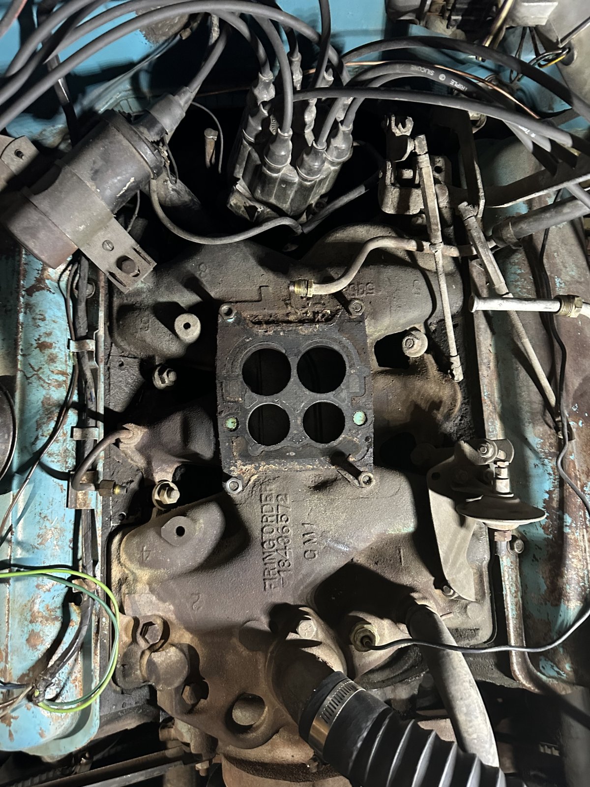

    Got a boroscope and looked around inside of the engine, surprisingly doesn’t seem all that bad. Pulled the valley pan and breather pipes and soaked them in varsol and blasted them with some hot water, they were quite crusty, but typical I guess of the age. Might get lucky!
    here are a few more pictures ! Once I figure out how to link more, I will.
