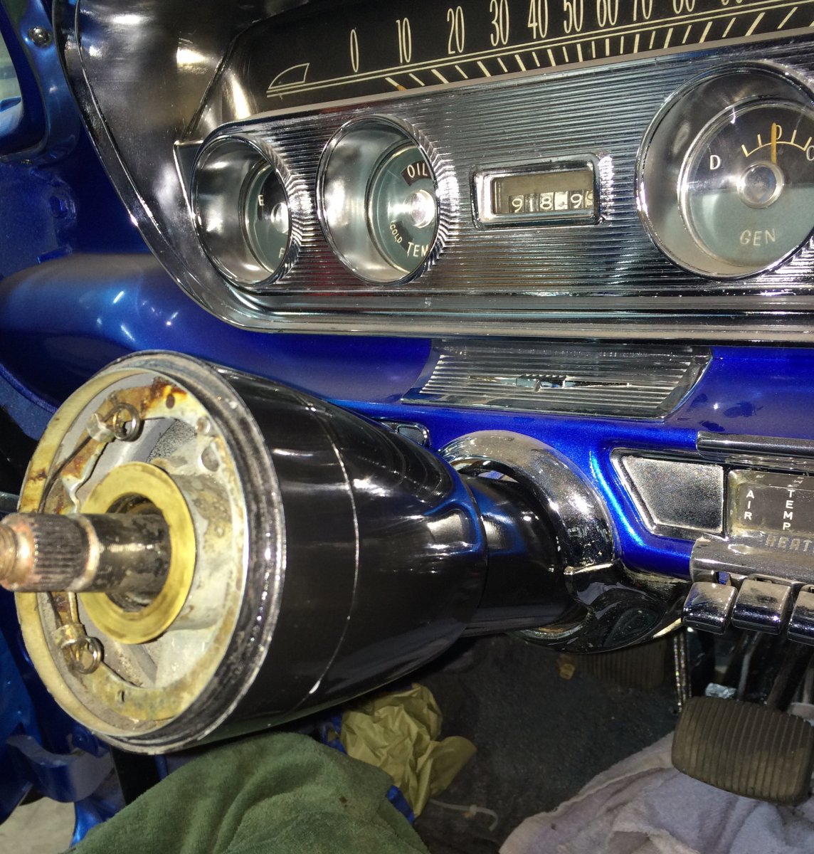

  26. Bullit68
    Joined: Sep 16, 2009
    Posts: 176
    Bullit68
    from Verona, PA
    You’re welcome! It just makes the column look correct for a stick shift cars.
