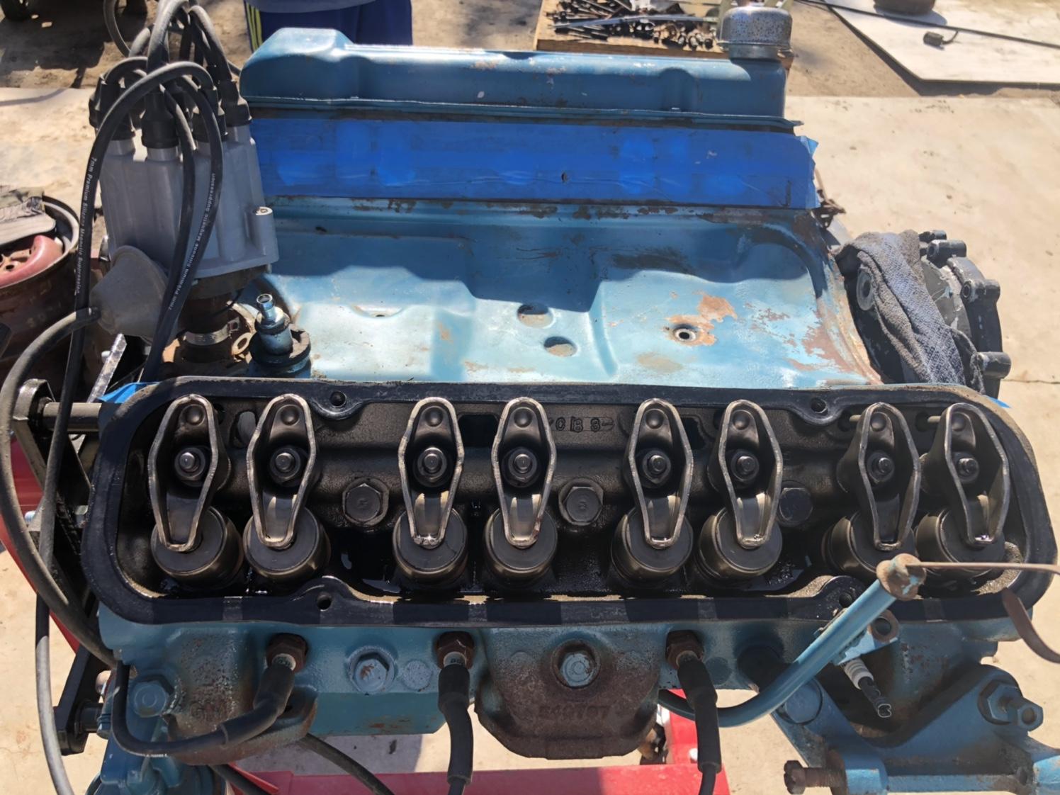

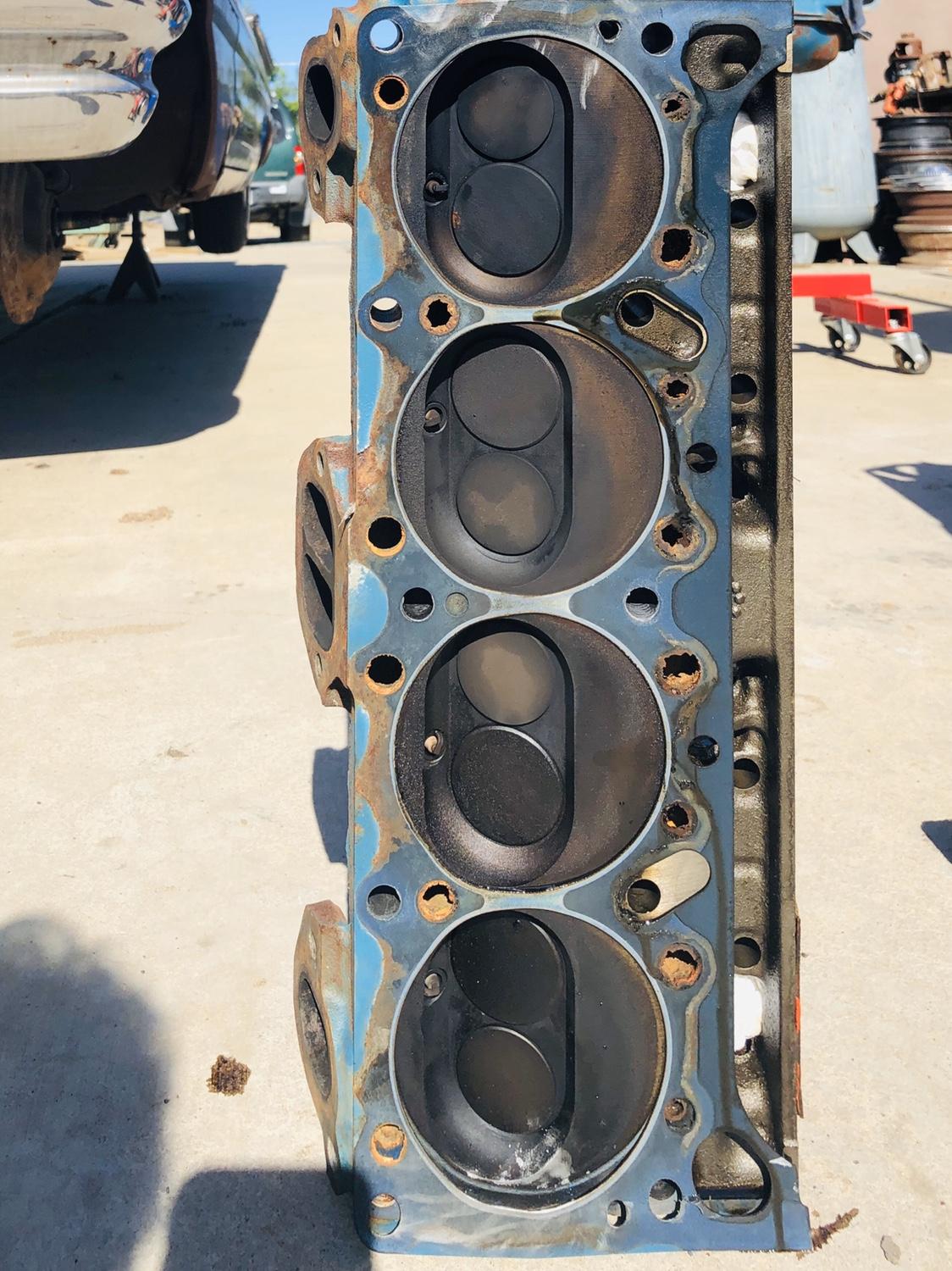

    Boys and I started taking the 63 389 apart. [​IMG][​IMG]
    Looks pretty clean up top. [​IMG][​IMG][​IMG]
    Heads look clean.

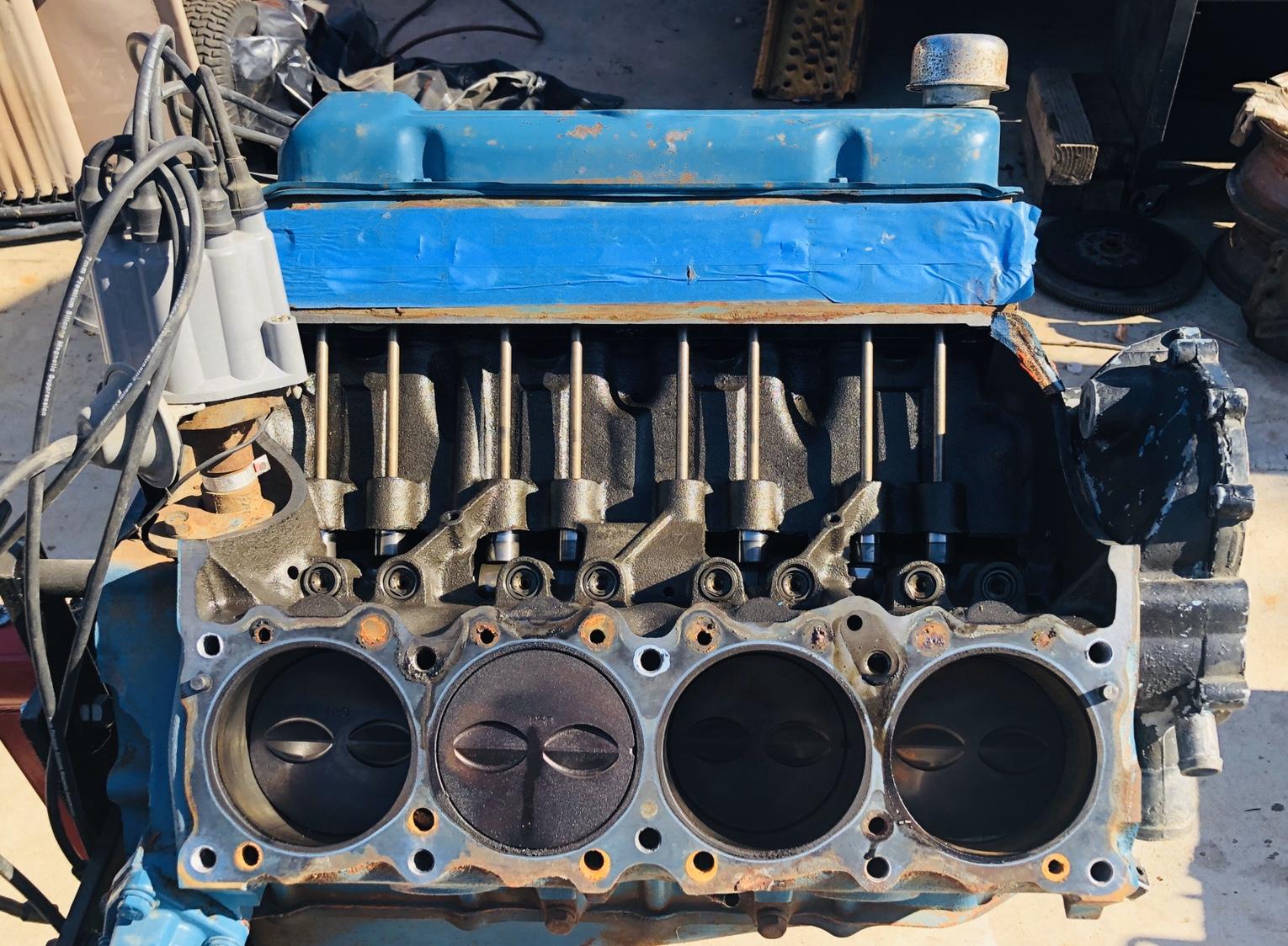

    Looks like pistons are 0.030. Are these the generic 4 valve relief pistons that accept both cylinder head angles?[​IMG][​IMG]
    Old wolf, loudbang and kidcampbell71 like this.

    Keep goin! I'm following your work. As for the double eyebrow pistons.....I dunno. I'm using late [1974] heads on a '57 block and even with my .125" over Jahns pop-up pistons I have plenty of valve/piston clearance.
    31hotrodguy and loudbang like this.
  16. 31hotrodguy
    Joined: Oct 29, 2013
    Posts: 2,699
    31hotrodguy
    Thanks Rocky! I appreciate the encouragement!
    What size valves are in your heads?
  17. Rocky
    Posts: 17,630
    Rocky
    Classified Editor
    1.96 intake, 1.66 exhaust. Using big block chevy 7/16ths screw-in, adjustable studs, factory Pontiac pushrod guide plates and hardened seats.
