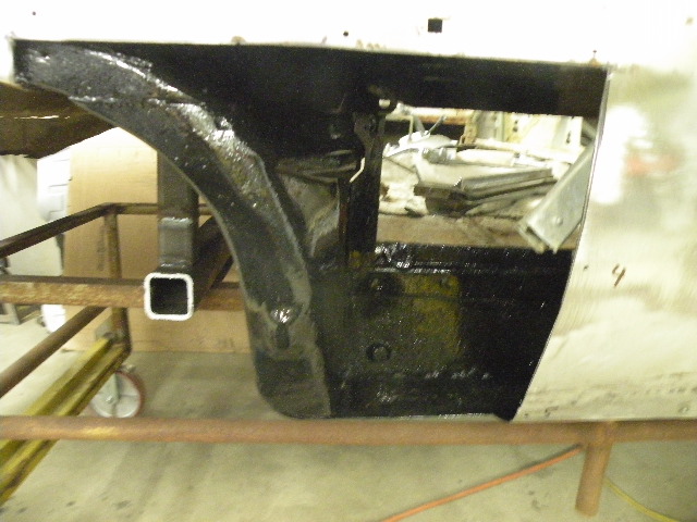

    Another small inner patch had to be made.
    then POR 15 coated.
    Several of the trim bolt holes are rotted so a die for forming the square holes to match was made & patches made. For us it is all about doing the details correct.
    More to come.

    Max got some more progress on the Starliner today.
    There is still quite a bit of welding & grinding to do on this back corner but it is starting to come together. Yes that is the very rust thru trunk floor you are seeing thru where the hand made repair panel will go.

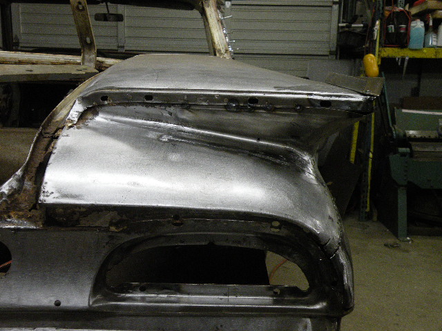

    carbuilder
    Max got the rear corner welded up, ground, planished & into DA 80 grit..Plus some pin hole sand blasting where the side trim goes. Remember these are all hand formed panels, no after market bad fitting junk here.
    More to come as the build progresses.
