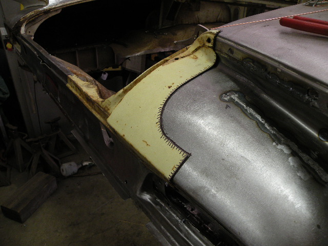

    Then he started the upper right rear fin rust out repair. The first 2 are after he cut out the rotten first half section.
    Welded & welds ground.
    Tomorrow he will do the same to the other 2 ft section of the fin, more to come.

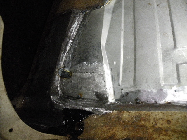

    Max finished up welding in the patch panel in the front of the right trim area rust thru then ground the welds. The right side is starting to look good a couple of other small things to do.
    Next is the trunk floor it is just a little hole'e.
    More to come.

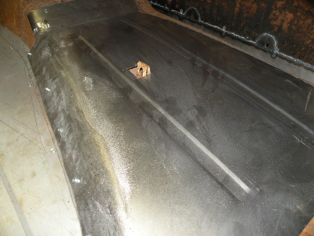

    carbuilder

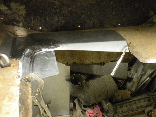

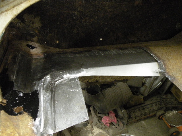

    Some progress on the trunk floor.
    The galvanized looking center was supplied by Dave the silver looking new hand formed metal on the right & lower left corner was made by Max.
    This new panel is the right side made in the shop.
    Another hand formed piece for the right side.
    All the right side pieces tied together.
    Panel made for the left side.
    Thats it for today more next week.

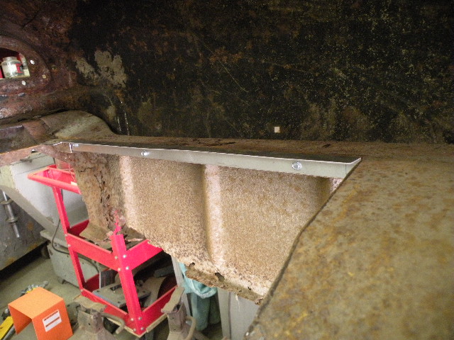

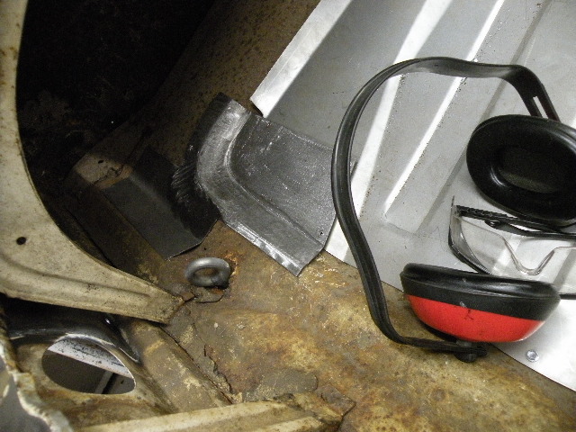

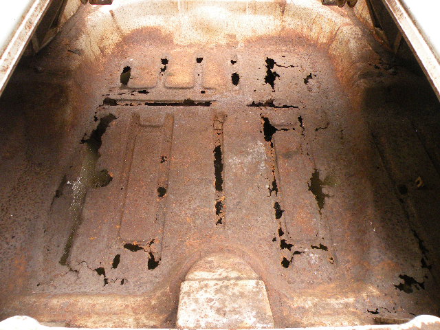

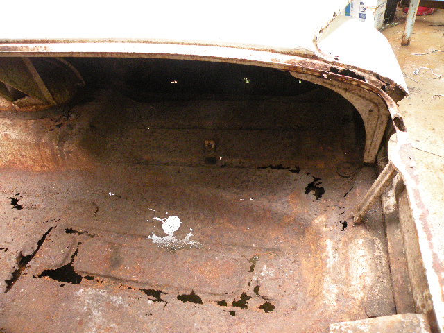

    max started removing the rust out in the trunk & found another replacement panel needed to be made.
    Some attachments strips were made to Ty in the new panels to the old.
    More to come.

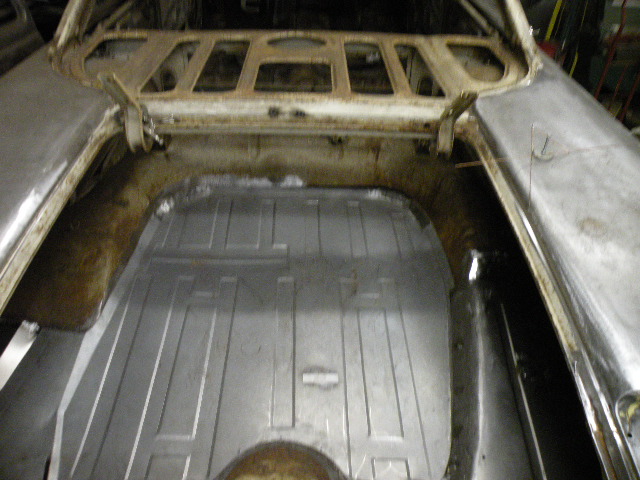

    The rear panel is taking shape Max had to replace the rusted thru lip area the goes just under the bumper I think a rubber flap attach's to it guessing. we did not do the dis***emble Dave did again its all in the details of the metal.
    The trunk floor center is starting to come together. Lots of weld, grind, hammer & dolly work.

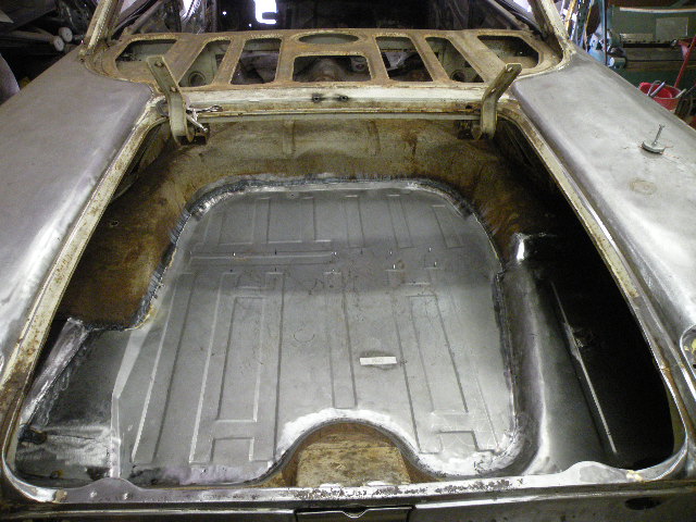

    carbuilder
    Trunk floor is all welded up & good part of the grinding done.
    Its getting there.

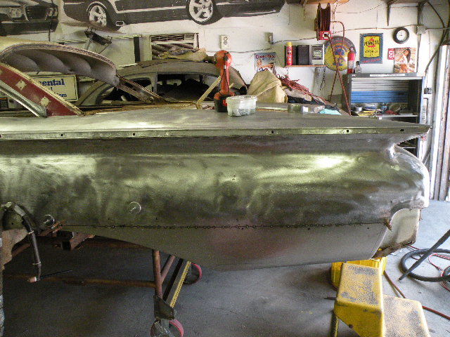

  19. carbuilder
    Joined: Nov 21, 2006
    Posts: 982
    carbuilder
    The rust mights had eaten away on the upper left fin so some work need to be done.
    It's getting there 1 step at a time. A little more welding & grinding then on to the next part.

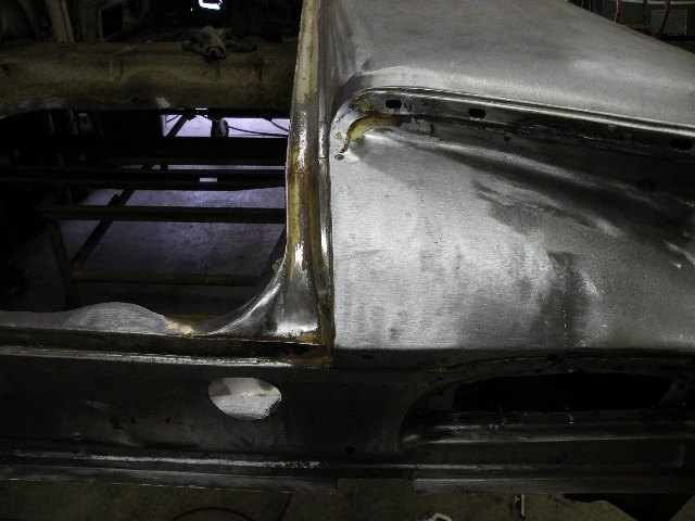

  20. carbuilder
    Posts: 982

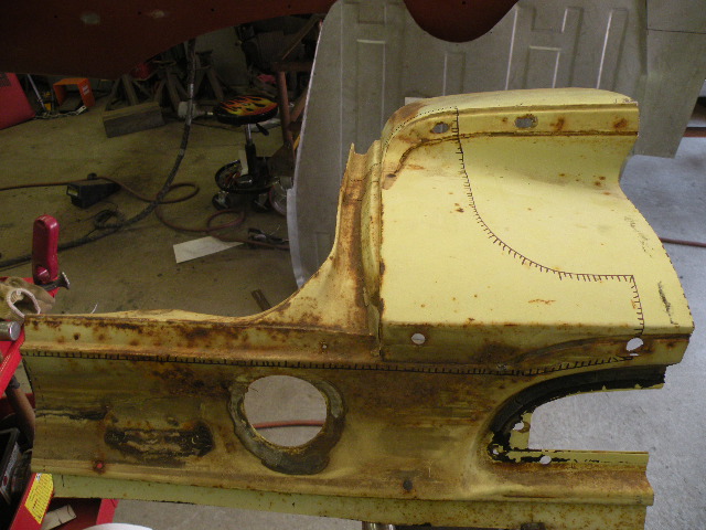

    carbuilder

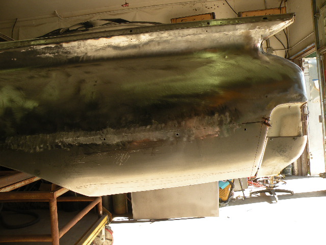

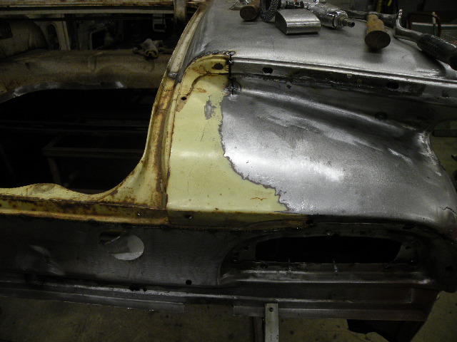

    More progress on the Starliner the back 30 inches was rusted thru in quite a few places so a new section was fab-ed up.
    Old section cut out.
    New lower quarter welded in & the upper qtr top fit.
    Notice the upper recess line is in for the factory trim to fit to.
    The top section still needs to be welded in & ground that's tomorrow. Keep watching.

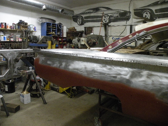

  21. carbuilder
    Posts: 982
    carbuilder
    It's a tougher then it looks welding in the top section keeping it from warping like a ruffle potato chip & banana combined, but Max got the job done.

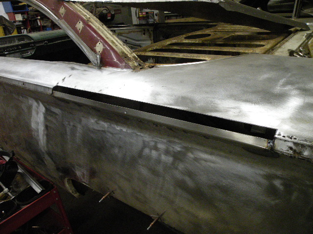

    carbuilder
    A small patch had to be made for up under the left rear fin.
    Then it was on to final trim & weld in the main left rear quarter patch that Max made.
    Another patch had to be made for the bumper inset area.

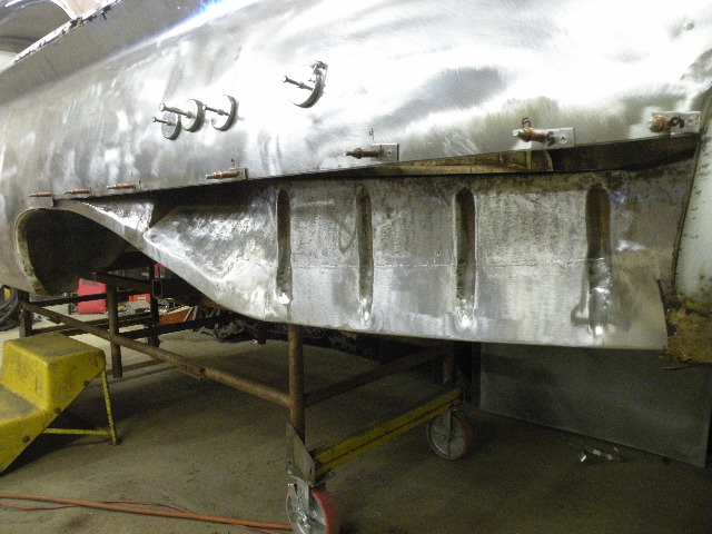

    Max worked on the very rear of the left quarter where the bumper recess goes back side first.
    Inner & outer hand formed patches.
    The 2 panels as they will fit on the car.
    Outer recess cut out
    Por 15 coated
    Good start on the welding
    Thats it for today.

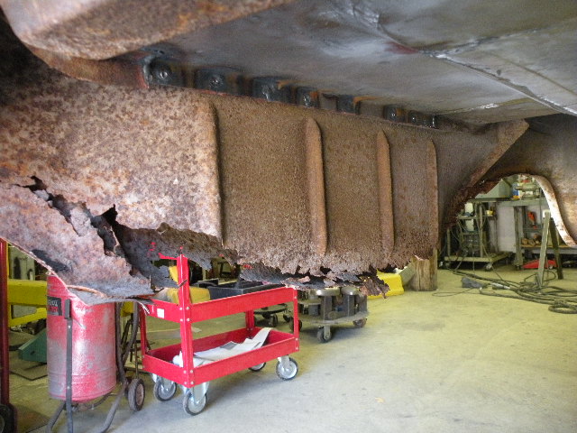

    carbuilder

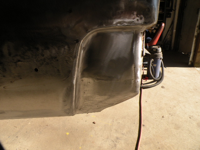

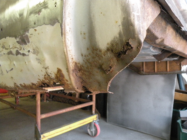

    The left front wheel arch was a rusted bad on the underside. So Max made a new section to replace the rot.

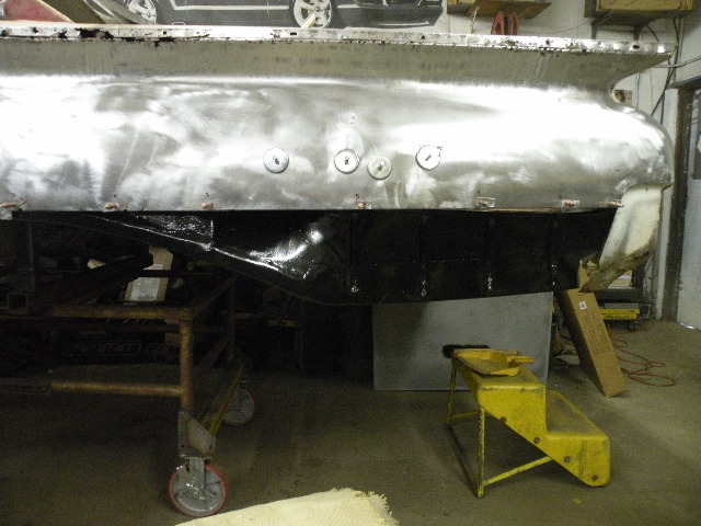

    Max did a little finish welding, hammer, dolly & shrink disc tune up work today.
    Now he is off on vacation he will return to this project May 31ST.

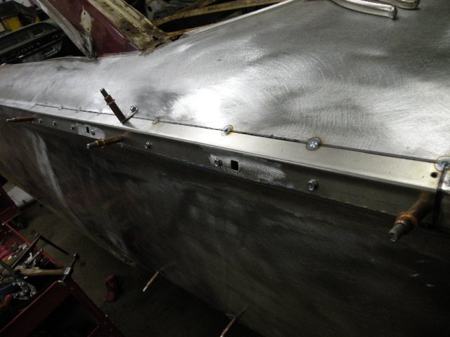

  29. Where did you get the round magnets? I like them!
  30. carbuilder
    Posts: 982
    carbuilder
    I got the magnets at the local nut & bolt store then added the bolts for handle's or if you want to be trick use cabinet nob's.
