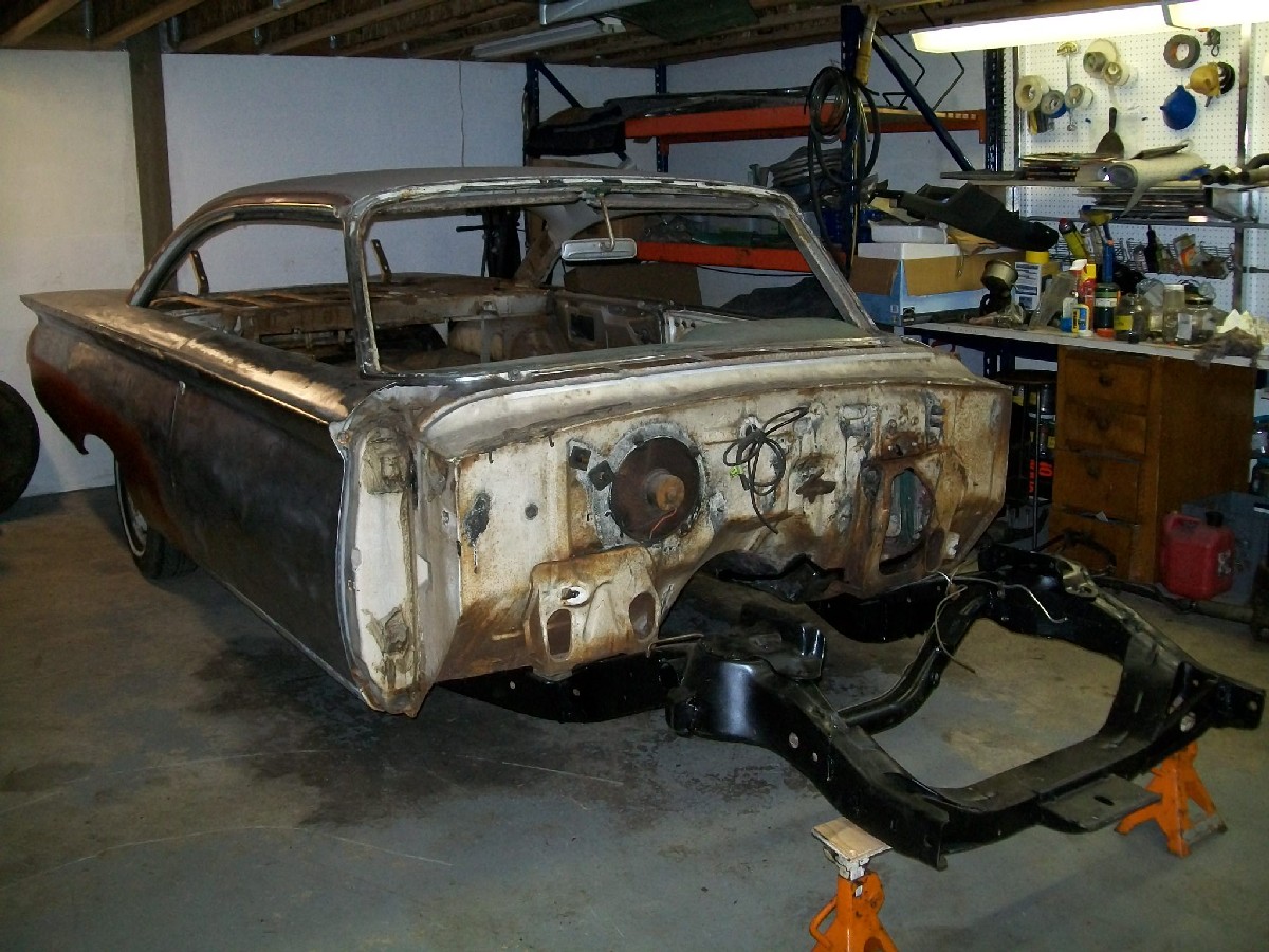

    Carbuilder it seems to me that you see no problem with welding onto the panel that has been coated already. When you are done do you just ruff up the part that has been burnt off and recoat it or is there something I am not seeing. This is my first time using the Por 15 type product I am using.

    Barney it was ground back a little just before welding & the panel you are looking at was welded from the other side it is the exposed side so the exposed when finished weld was ground, hammered & dolly-ed.

    That makes more sence. I never give it a thought that you where welding from the other side. Thanks

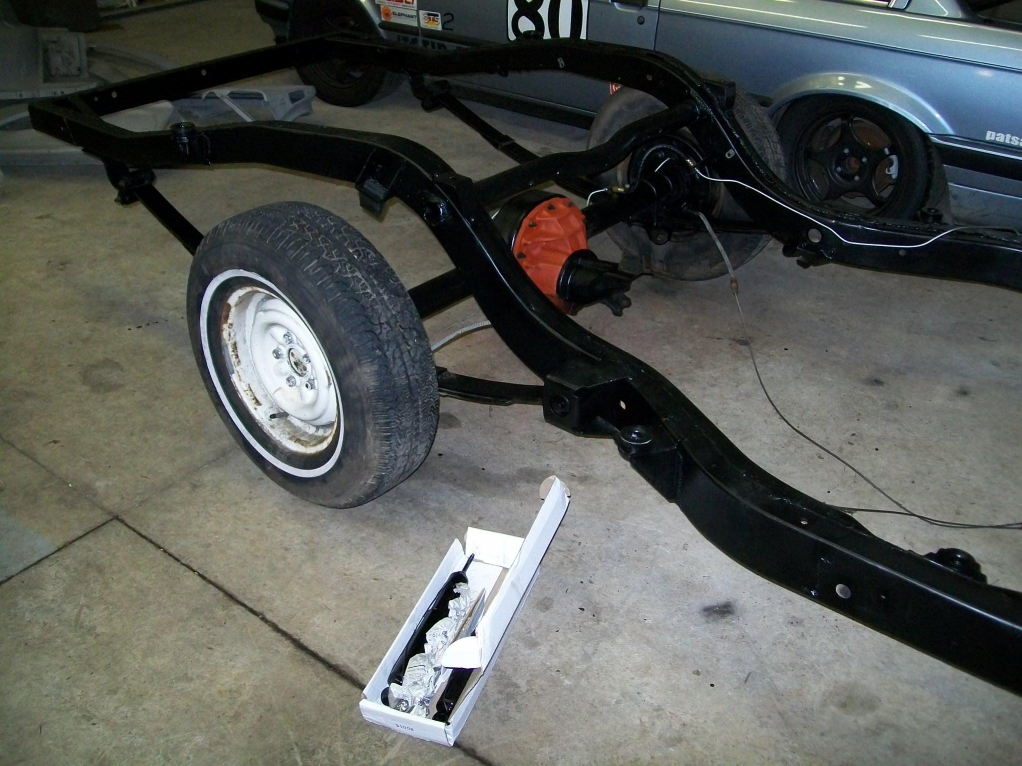

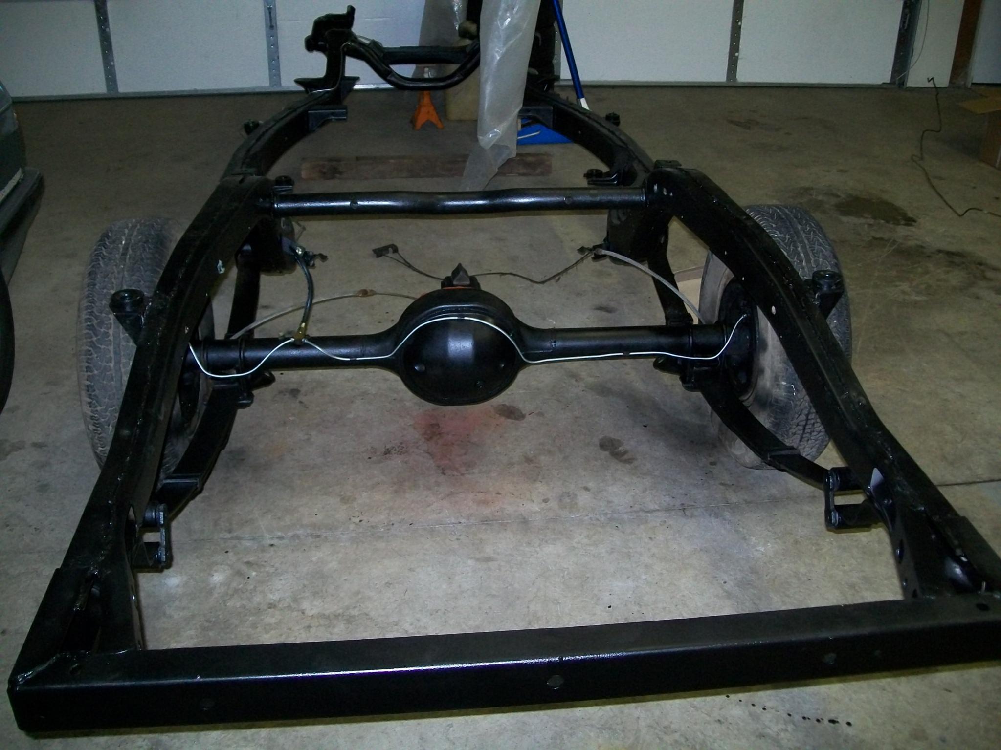

  13. About time I chimed in. Lately most all my spare moments have all been directed toward my daughter's high school graduation, but I have managed to get a little bit done. This marks the central point in the rebuild where parts start to go back togehter,
    The frame was blasted along with all the other bits, but the camera's been tied up, so here are the latest pics, after POR and the installation of fresh brake line. Fuel line comes next and new shocks. Then off to carbuilder's to re-mate body and frame.

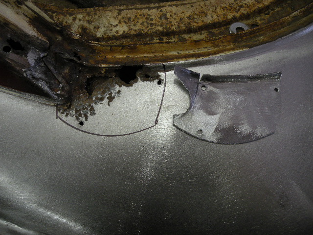

    The rust mites attacked the left front toe panel so Max made a new piece.
    A little more to do then back on to the ch***is.

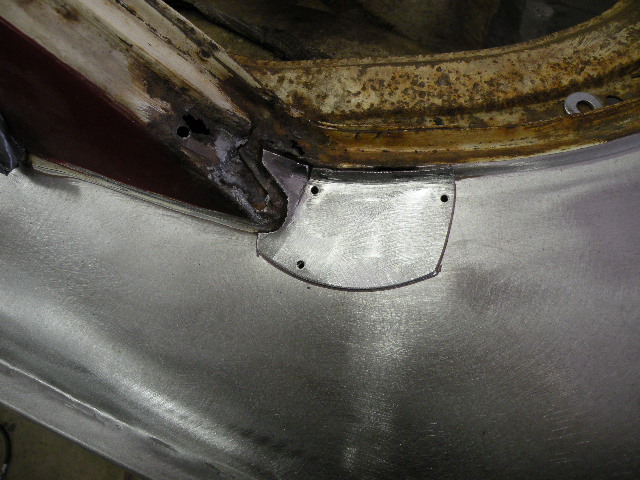

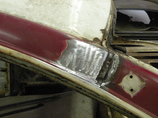

    Another patch had to fill some more rust mite's holes then a final grind of the welds top & bottom followed with some seam sealer.

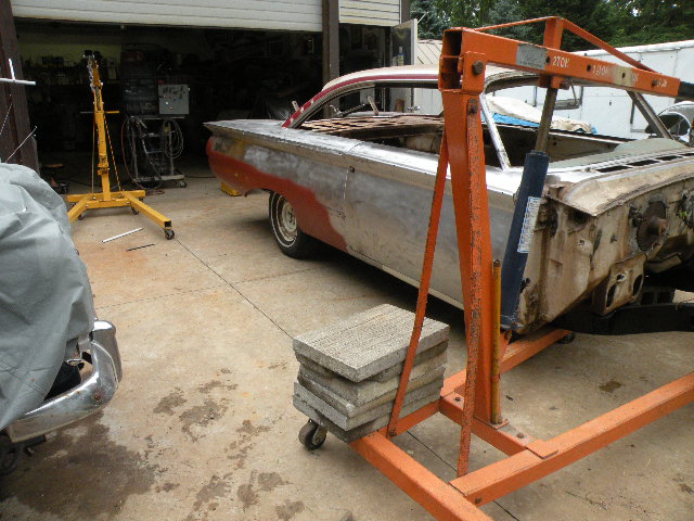

    Well we finished the starliner & Dave brought over the ch***is & we put the body back on then sent it home with him.
    Now it's up to him to finish we gave the body & paint person a real solid base to work from.
