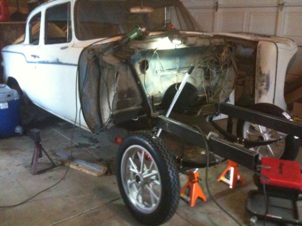

    Ok, so I've had this car for awile and have worked on it in short intervals dependant upon motivation (as I ***ume most builds are). Been kickin' around starting a thread for awhile and I guess nows the time since I'm feelin motivated again!
    By no means do I consider myself a Studebaker fan, when I came across the rolling shell I thought "what is that, that would make a *****in g***er!" Turned out to be for sale shortly after. I sold my A coupe and started cutting stuff apart. When I started, I had no clue what drivetrain I was going to run etc etc...started lookin into Stude motors and was pretty impressed, so I was donated a stude 289 and some crude informational books to peak through. After rigorous internet searching for Stude speed equiptment and rapidly loosing motivation I came across John Erb who lives here in my home town and has a stockpile of this stuff, he's extremely knowledgable and helpful. Back on track....
    Here are the early stages of the build. The hideous, heavy front end was cut off and replaced with 2x4" tubing and a speedway axle kit. Decided to run Radir spindle mount wheels and I'm crossing my fingers that it won't be too scary to drive on the street.

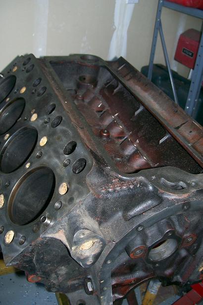

    Heres a few more pics of what I got goin so far. Just got it back from havin a buddy put a cage in it, I'd say he did a damn good job for trade for a tattoo, even mounted the seats for me:). Couple pics of the alien-like engine and the Halibrands I scored for the rear.
    One of the first obsticles I encountered so far is the camber on the front axle. After a little research I found out that the speedway axle is designed with different specs than an original axle in order to work with their redesigned spindles for their disc brake kits. So when it says for 49'-54' Chevy, what they mean is 2010 speeday spindles. The problem with this is that appearantly the spindle mount wheels won't fit the speedway spindles (I have yet to check for myself)...so as far as I know I have to bend/cut the axle to correct the camber.
    Another speedway complaint. The "deluxe kingpins" with roller bearings are ****!
