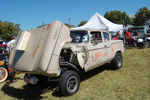

  3. I was going to look for a pic of this one myself. I was reading a little about it a few months back.
    These guys build some odd ball g***ers for sure. The first Flintstone Flyer was Packard. Big ol boat and they were compe***ive with both.
    What a smooth project. Gotta love a Stude G***er.

  6. Yea tires sticking out of a slab side (on a streeter) is pretty '70s. Well sticking out a ton is pretty '70s, I like 'em with the fenderwells radiused and the tires just about meeting the outside of the sheet metal on the right car.
    But for the most part tires sticking out is pretty hokey.
