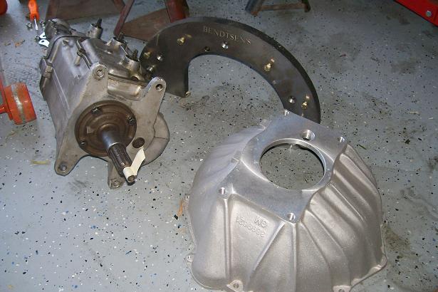

    Yeah I had some fancy ford trans but decided to run a manual. It would have been EXTREMELY difficult for me to adapt. I picked up a Chevy to Stude adapter from Bendtsens and a Muncie M20, new #621 bellhousing from the parts place.
    Got the new spindles apart FINALLY but the kingpins were wasted, so I've ordered some from speedway...will have "corrected camber" pics when they arrive. Motor should be done at the machine shop today or tommorow. order parts for the 9" today...I'm gettin excited!!

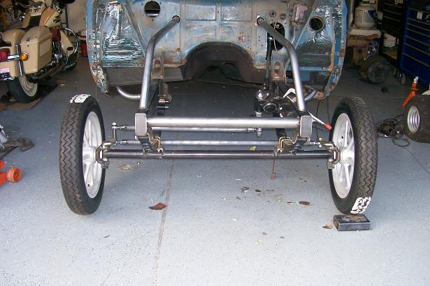

    Finally got somewhere today! After hours and hours of screwing around with the spindles/kingpins, installing new bushings, filing, measuring, grinding axle bosses etc...I got em' installed. they fit perfect and my camber issue is FIXED!

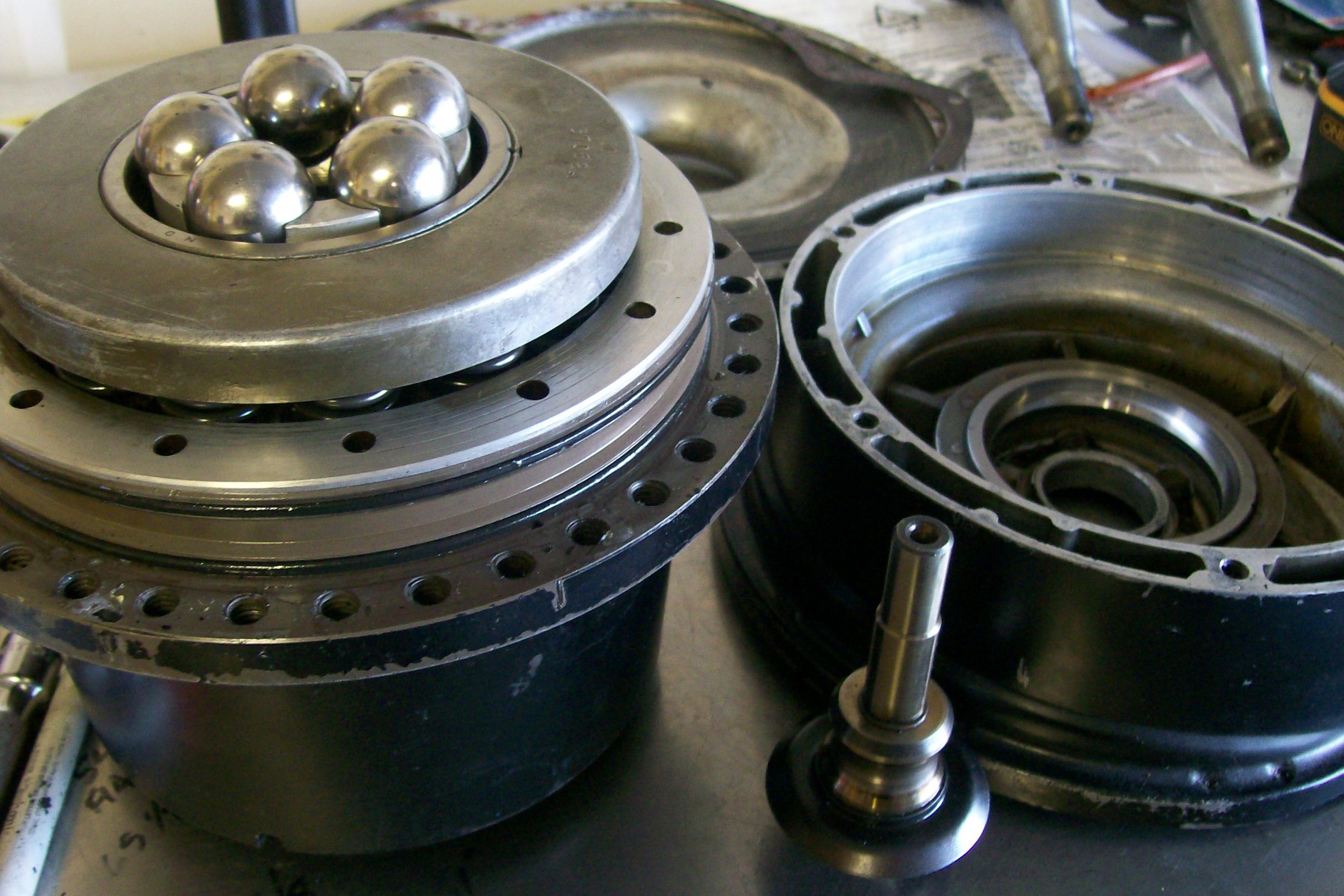

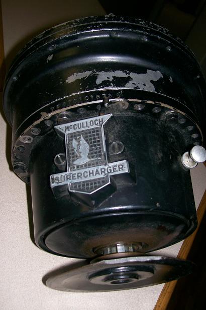

    Quick update, mainly for you Jake.
    Tore apart the supercharger today to see why it wasn't turning freely. Other than the packing peanuts and shredded newspaper it was shipped to me in I found that the bearings did not fit in the driver as you can see from the picture and the rear housing is damaged, which attribute to there being too much spring pressure and not enough clearance. Hopefully the housing is still useable and all I need are a few minor parts...

    OK, I see what you're talking about now. I know that housing looks bad, but I don't know if it's really a big deal. That dished piece on the center race is an oil-slinger meant to keep the oil in the supercharger from going to the intake via the housing. Although the oil slinger does have some contact with the damaged part of the housing it's not a load-bearing surface. In fact, there should be a few thousandths play when you shim the impellor upon final ***embly. If anything, this blower might drink a little more ATF fluid than usual but I doubt it will cause catastrophic failure.
    Also, I read the part about stroking the motor by welding the crank. This used to be done with Ford flatheads. They'd build up the rod journal by metal-spraying and then grind them off-center. The biggest problem is that it's hard to get stuff to stick to cast iron so sometimes the welded part would come loose. However, because the Stude cranks are forged steel and not cast iron, they are ideal candidates for this process.

    Yeah I figured it wasn't a load-bearing surface, or not designed to be anyways. Should clean up and work ok

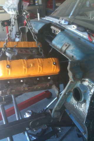

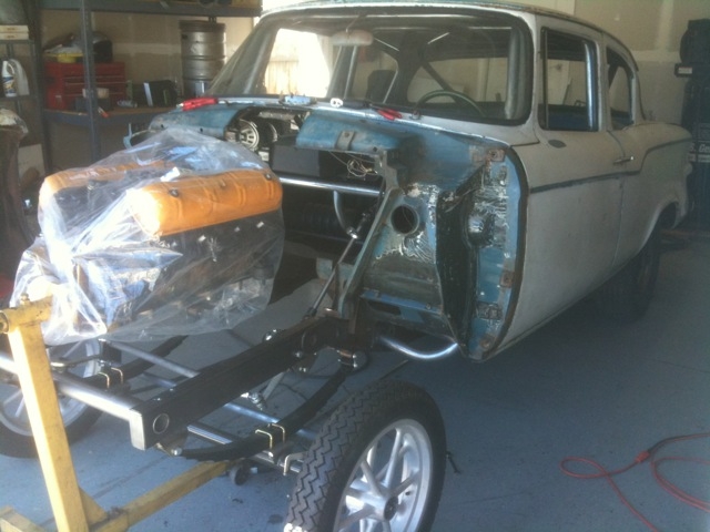

    Finally making some progress!! Dont know if I've already posted any of this but engine and trans mounts are done. Crank center is a little high so I'll likely be making some adjustments. Picked up some parts from Mr. Erb today and began bottom end ***embly. CNC custom ground cam is on order so hopefully I'll have a short block real soon. Still waiting for the 9" to get finished up. Get'n motivated again though!

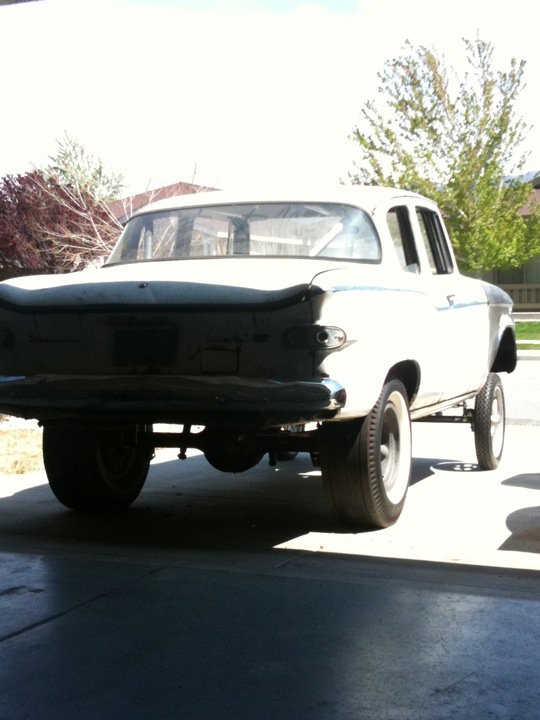

    Still waiting on head/supercharger work to be finished but I got the axle in. It fit like a glove.:D
