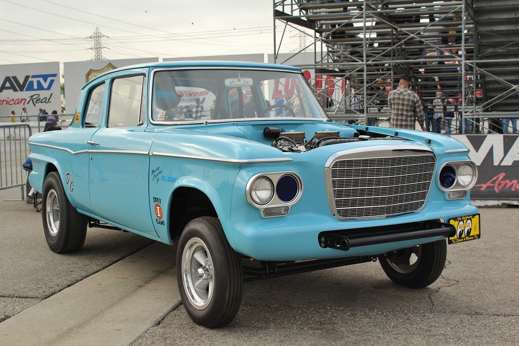

  1. Hightone111
    Joined: Apr 5, 2007
    Posts: 323
    Hightone111
    I do! Blue/white with scallops, lace and lettering. I think
    Six Ball and loudbang like this.
