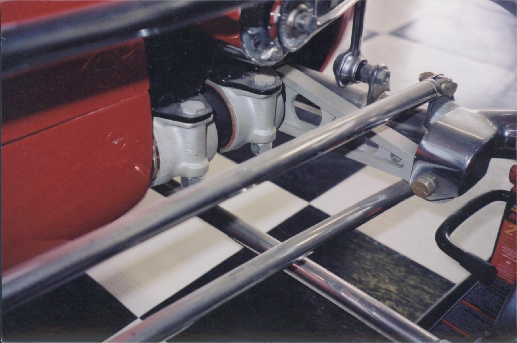

    Ah...so, approximately understand.
    Here is a neatly done torsion elastic front suspension on a '46 Kurtis ch***is #19. Certainly not widely copied if at all.
    I suspect that is true of this car as well.

    The leading arm is more common in springer motorcycle front ends. The anti-dive comes from the braking torque trying to lift the car via the arm. Given the radius of that arm, it should have significant jacking effect. Perhaps even zero dive.
