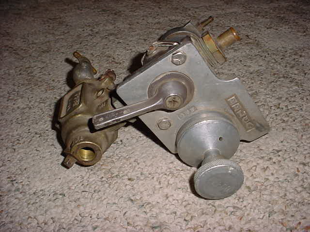

  2. This setup was not for fuel injection, but for carbs. The filter is an aircraft unit sold by speedshops as a high performance unit in the 50s and 60s. The pressure pump is to pump up pressure in the tank to push fuel into the carbs. The shutoff is to keep the carbs from flooding when the motor isn't running.

    Ive seen the same set up on fuel injection too so, until we find pics of the car we dont know what was on it.

    wow never seen one mounted that close,,though its recommend for the filter to be as close to the tank as possible

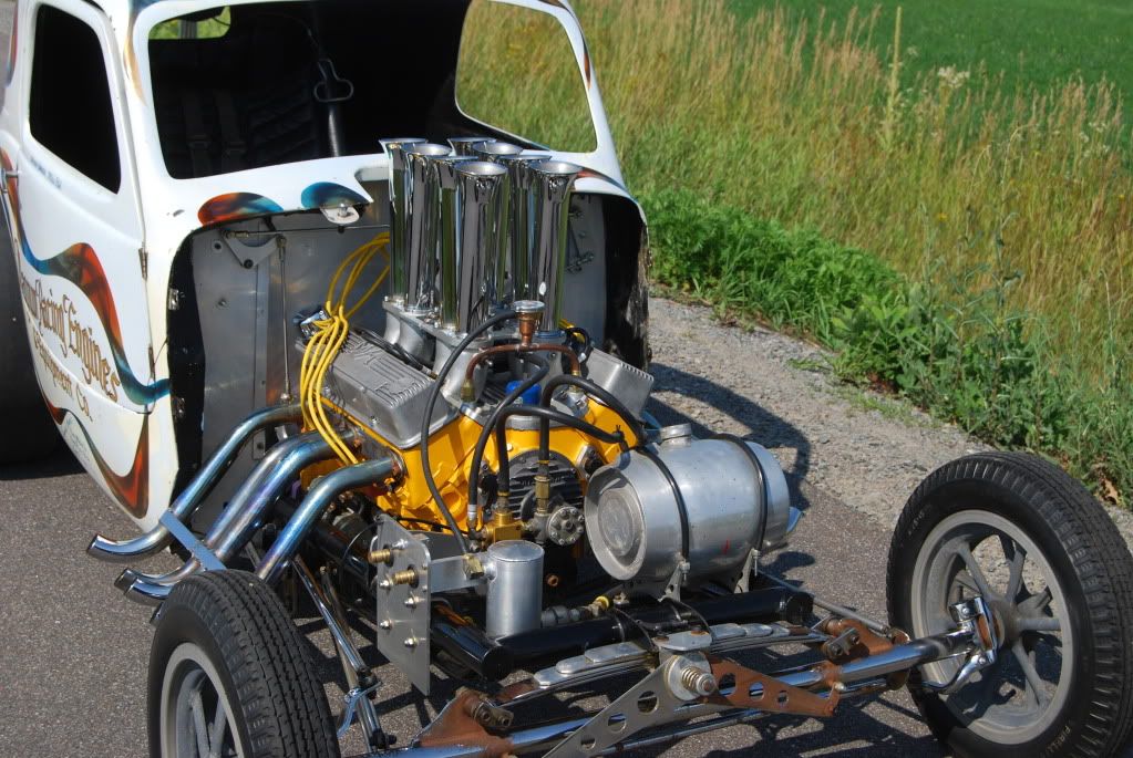

  7. Trust me, you can run it. All I had to do on my Topolino was new harnesses and a coolant catch can. Plus I joined the Midwest Gassers. My tank is a Tapper, and hold 3 gallons. I run it at Da'Grove. Hunnert Car Heads-up May 8th, get going so I can run ya!

    INLAW MODEL A: Trust me, you can run it. All I had to do on my Topolino was new harnesses and a coolant catch can. Plus I joined the Midwest Gassers. My tank is a Tapper, and hold 3 gallons. I run it at Da'Grove. Hunnert Car Heads-up May 8th, get going so I can run ya!
    WOW! That thing SICK! Hope when we find some pics of mine, it's injected! Love your videos, but your door works? lol
    That sound great, just want to run the hell out of it!

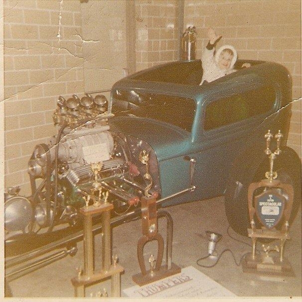

    Here are some pictures that where sent to me today from (33 ply 440) he found the wife of the driver and engine builder of this car. Aggie, Bob's wife, sent these two pictures for us! Thanks to Ron, now we all can enjoy these pics!

    Where is that little girl now? What a cool picture!!:D

    I talked with Aggie and Bob (Henry). Henry said it was owned by four guys and the B/comp car never raced with the blower on it. He said they ran it with a MAN-A-FRE inject as seen in pit, picture. They ran a 283, .060 over, 12.5 compression and 3/4 (Dencroft, help me on this) camshaft? Did say the the car was red when they bought it. Then in was painted metal flake teal in Iowa, by a guy named Skeet. Henry said that it had a '57 Olds rear, 1st & revease was takin out of the tranny. Oh and the little girl in the picture is their daughter. Now they are watching this thread with us so, I'd like to thank them so much for their time.
