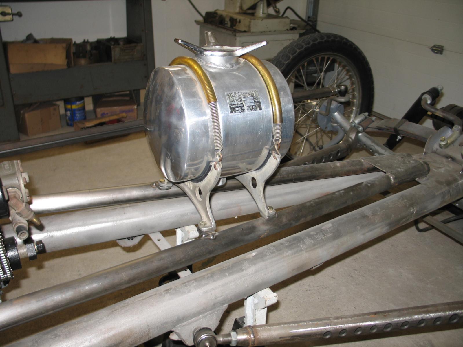

    Henry said that it had a 2gal. tank on the front of it, but didn't know what kind it was and looks like a moon w/3 bar cap w/moon mounts to me?
    Question is, would that be to small for any reason?
    Like you must drive these down and back from the end of the track?

    A 2 gal. Moon tank is what was on it, like the one pictured..That will be fine. Remember we talked, you may want to fit a starter to the car for self starts. You don't plan on running it for an hour so the small tank should be fine. Oh yeah, right on with finding the intake!!!! Call me about the injection part of it. Todd.

    You, teasing me with that tank pic. Thats the one I need! Now I know how my wheels makes a guy feel! lol

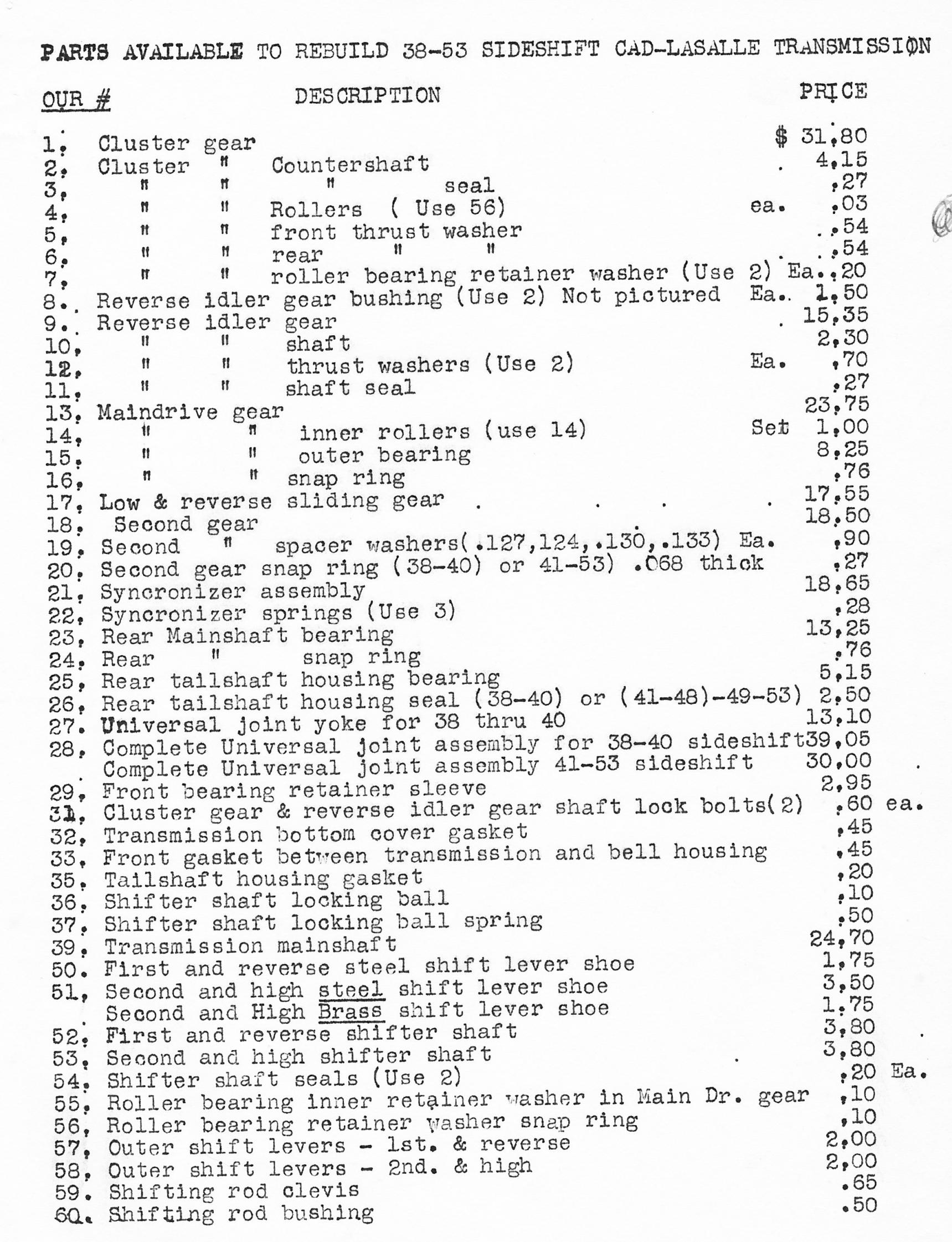

    This should help with transmission parts,,Click on it 3 times for largest view

    Thanks For the break down sheets, big Help! Have the #s I want: 2-#8s, 2-#12s 1-#9 and 1-#11 for side shift type. Can you tell us what year this tranny is, in this car?
