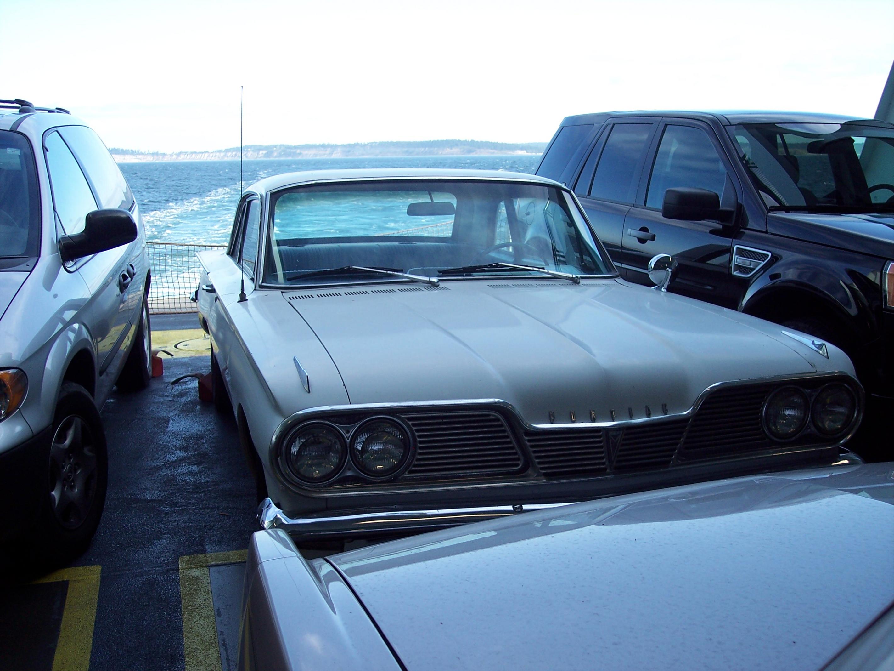

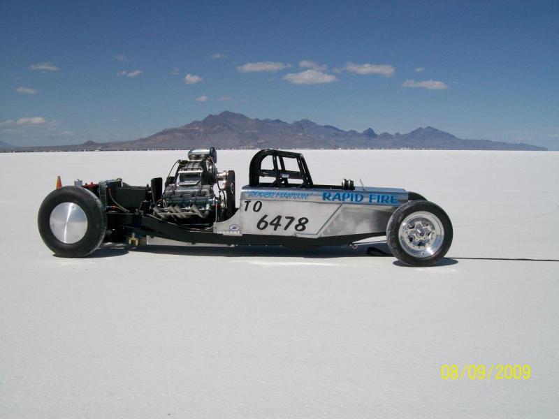

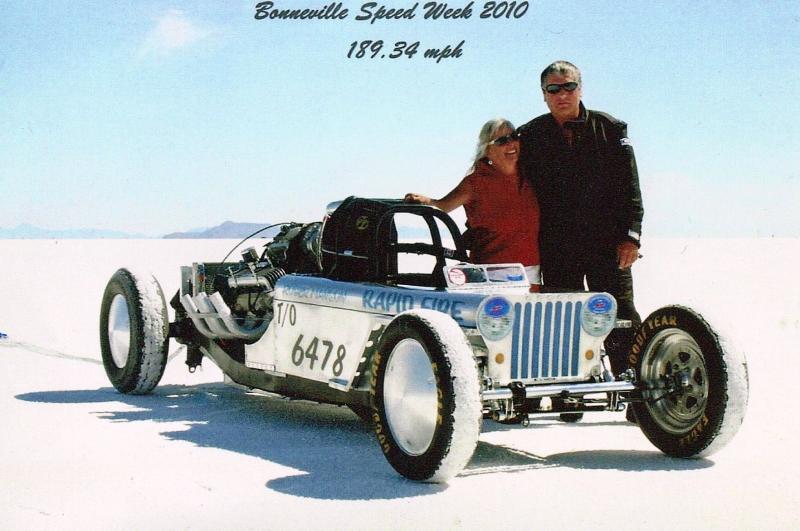

    Wow JEM,
    Thats some serious hate on the 195 Poncho.
    If your words are true then tell me why this car has gone 192mph at Speedweek on the salt in 2011? Yes the one pic is from 2010 when it only went 189mph? I expect it will go 200 this year, to bad I won't be there.
    Here is a shot of my 62, runs fine with 150,000 miles.

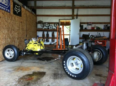

  20. Here is the chassis is my son's 1926 Model T roadster.
    1962 Pontiac Tempest 194.5 with the rear transaxle.
    MechanicKeith can speak to this one as he is the one who repaired my bent rear axle.
    Thanks again, Keith!!!
    Runs great, shakes a little...and goes like stink!!!:D
  21. Rusty O'Toole
    Joined: Sep 17, 2006
    Posts: 9,756
    Rusty O'Toole
    Love it! Bet you get some funny comments at rod runs!
    Billeekid seems to have disappeared back in February. Too bad he missed some good info.
    How hard was it to shorten the drive shaft?
  22. Like anything, it can be totally over engineered. They used some sort of special mil-spec alloy to make the shaft.
    What I did was take measurements with the engine and transaxle installed in the frame and determined that I needed 25 1/2 inches taken out.
    I cut the shaft and tapered the ends. then I split a piece of pipe and drilled about 50 holes for plug welds.
    I clamped it in the pipe and welded around the tapered part while running in a v-block to stay true. After all the welding I quenched it in oil, and it has been doing great ever since!
    Best part is...I have never seen one before!:D
