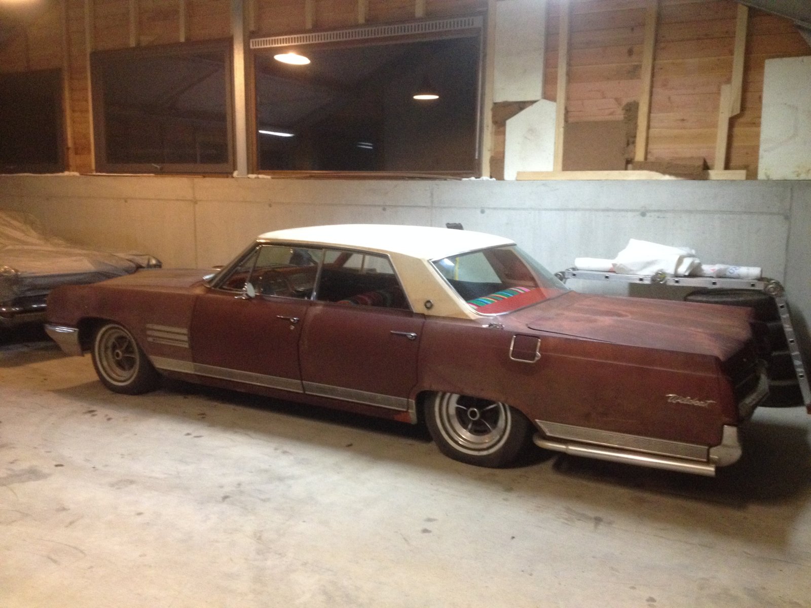

    That’s some great info! I dropped both , my 61 and 64, in the rear by cutting the pigtail and a coil out and fabbing an adapter for the now too big spring end. I wish I knew about this 15 years ago IMG_0912.jpeg IMG_0910.jpeg
