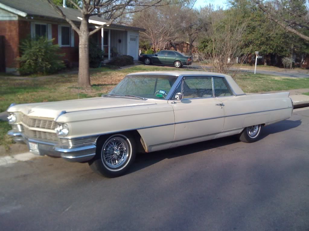

    How's this look? This is my grandfathers 40,000 miler...
