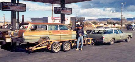

    Back to the car itself. After dropping in the 455, 400thm, etc and getting the 'newness' worn off a bit, I started making further improvements in brakes and handling to allow for better towing. As shown earlier, my prior tow vehicle was a '72 Grand Safari. After using the '72, I nick named it the "Super Wagon" or "Super" for short. My friends knew it as such. Why? because it was simply just that. The '72 did everything in a "super" way. Outstanding brakes, very stable towing, lots of inside room, etc. Even though the '72 had so many virutes, I was just infatuated with the styling of the '61s and '62s. I had decided to get at least one of each when ever I could find them. Over the last 15 years, have now have 5 '61 wagons and 6 '62s. Have also been able to sell some to people who are going to build them too. That feels good.
    Once I started driving the '61,. I just loved the dash and styling, colors, etc but, the brakes were awful, the cooling system was marginal, the steering was slow, the handling was just not there, etc, etc.
    Over the next few years, started making improvements in all areas.
    At the time, there was no simple way to add disc brakes so, I put brakes on both axles of my trailer. Did not seem to need brakes on the trailer with the '72 but, with the '61 it was mandatory.
    One of the next things was to swap in a Trans Am steering box. That helped the steering.
    The simple little cl*** 1 hitch came off and a heavy reciever hitch was found at another yard on a '63 Safari. Then added air shocks, air bags.
    Then crammed in a 4 core cross flow radiator out of a 70s Pontiac full size, had to torch the frame horns a bit and dent the tanks with a hammer but, it helped a bunch. Also a make shift shroud and then a good clutch fan.
    Then, I boxed the lower rear control arms and fitted a rear sway bar off of a '71 GTO.
    Things were getting better but, still not on par with the '72. I simply just towed at a lower speed and drove it more carefully.
    This was a time of growth for my Pontiac yard and I averaged one new Pontiac purchase a week. Sometimes would get 10-12 a month. Then made some deals with other yards and bought packages of Pontiacs by the dozen. Prior to Jan '99 this was all done with my '72 Grand Safari, from Jan '99 through the spring of '06 towing was all done with my '61 Safari. Hundreds of old Pontiacs bought locally and as far away as Oklahoma were towed back with my '61.
    Also hauled other things like this tool shed.
    In 2000, I ordered a new nostalgia Top Fuel dragster. The '61 became the official tow vehicle for this car. it was the only car in its cl*** thatr actually used a vintage car to tow it to the track and use it for a push car as well. My friend Bill, who helps me with many of my projects, built a push bar for it. Here we are at Bakersfield California Hot Rod Reunion 2003 getting ready to fire up!

    Here is yet anothe pic of my '61 towing another vintage Pontiac to my yard.
    This is another nearly Safari nearly identical to mine. A few differences- this one has red int & is a 9 p***. Note, this is not the same white '61 shown earlier I bought in Wheatland.
