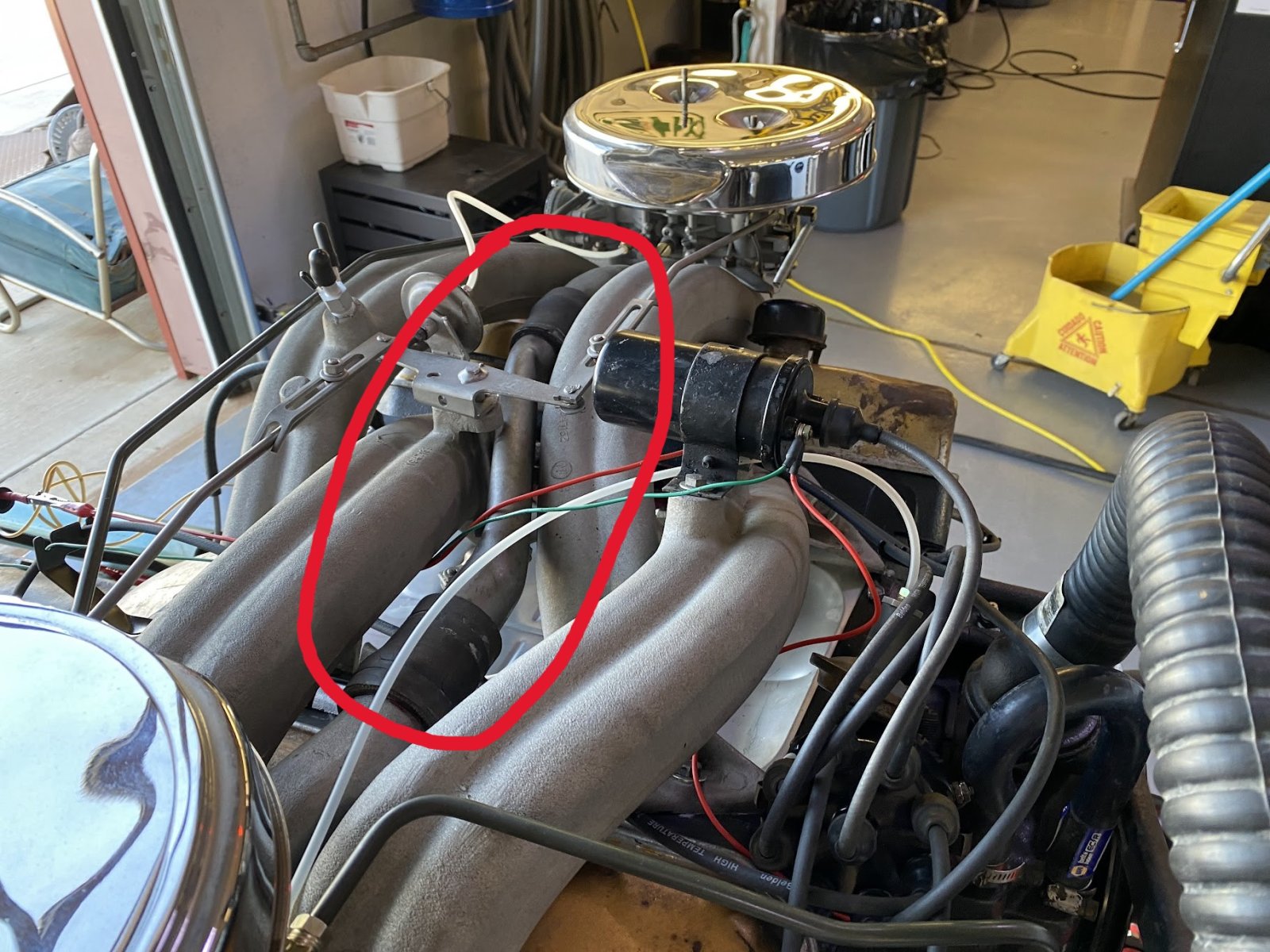

    Just checked my parts books and have some good news! The actual intakes are the same for the B vs RB, it's the coupling tube that is different due to the difference in the deck height on the block. So if you don't have that tube you'll have to make one, this is what the longer 413 tube would look like: IMG_7882.jpg
    The linkage would also be shorter on your engine, so that also would have to be custom built or buy the reproduction 413-style linkage and cut down to fit.

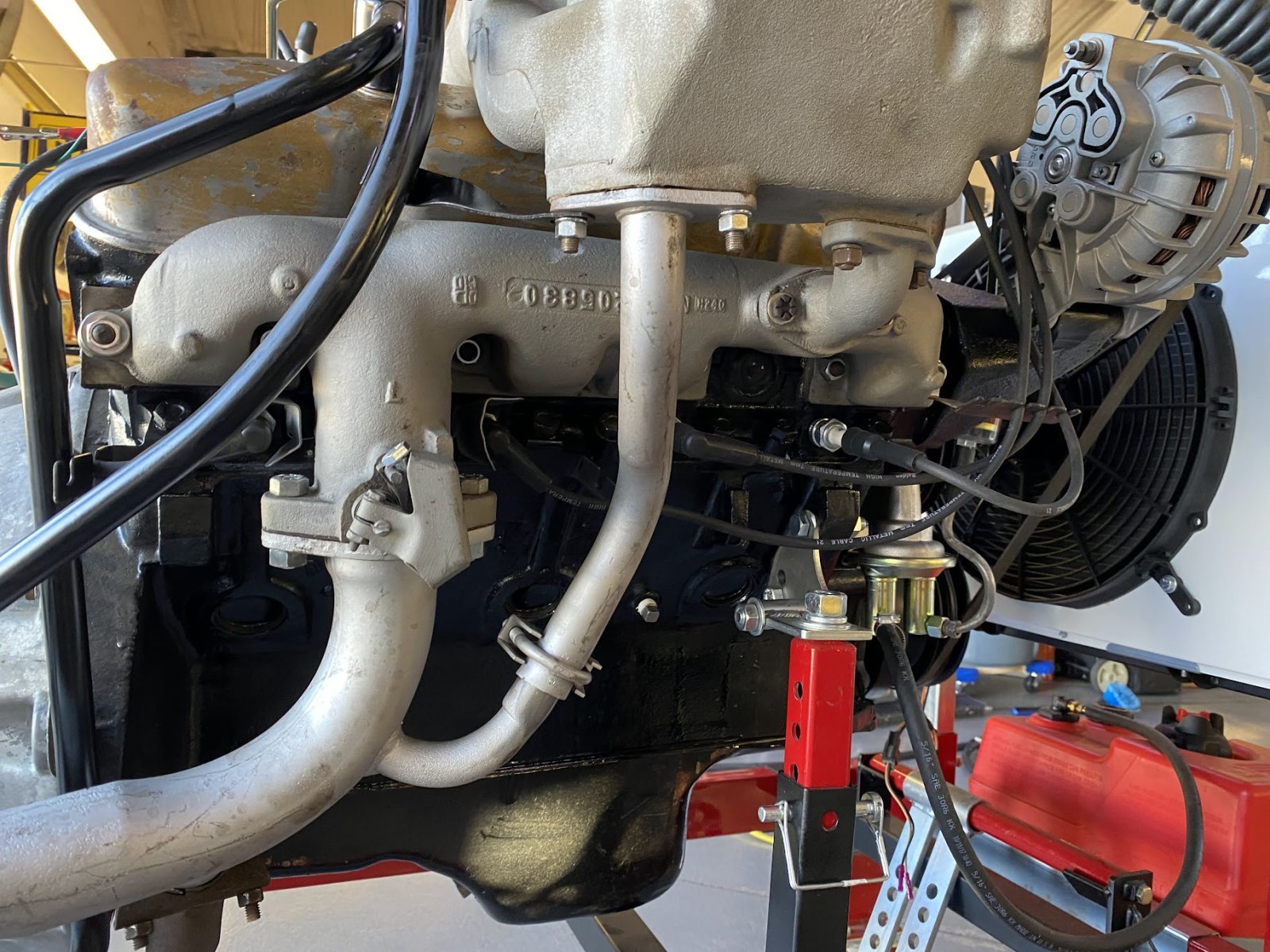

    You also should have some supports to carry the weight of the intakes, they originally had these ductile-cast iron elbows that bolt to the unique exhaust manifolds:
    As you can see, when hooked up with the original chokes, you have to have the exhaust go through the intake to help warm up, otherwise they won't want to idle on a cold start. Also the crossram cams are dramatically different than a standard 4bbl cam, they have a unique overlap to help "****" more air/fuel down the intakes and into the combustion chamber. The long runners literally becoming vortexes of swirling atomized fuel into the heads. Amazing tech for 1960!

    Man, I wish I had checked back here before searching around frantically to find the same answer you just gave.
    I was under the impression the exhaust was solely to warm up the intake, and not an actual support?
    I swear I read it on the forwardlook site, but danged if I can find that info again. Someone butchered the bottom of these things for unknown reasons. I'm sure I can figure something out. It's not the highest priority, but they were stupid cheap, so I had to get them.

    The intake must be supported by something out by the exhaust, otherwise you're cantilevering 3ft of aluminum with carbs, linkage, air cleaners, etc.. all off the opposing head's intake bolts. Too much risk of cracking the intake manifolds. Even on hot rods and customs I always recommend some kind of support off the exhaust manifold studs to help hold the intake from vibrating/cracking. That's why the front elbow is ductile cast iron vs being simple a thin wall tubing.

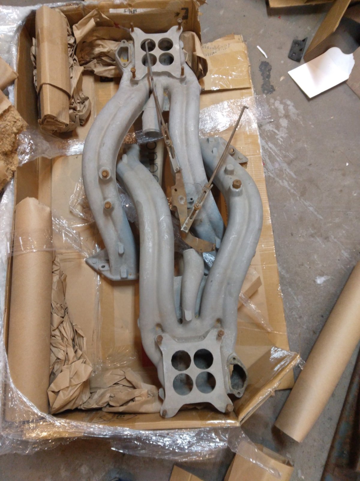

    I’ve always wondered what those intakes were for. Maybe 20/25 years ago me and a friend were walking through the Turlock swapmeet, I spotted one with a 300$ price attached to it, I asked what it was for, he said “I don’t know, but there’s one for a 100”. This was two stalls down.
    Finally my curiosity is over!
    alanp561 likes this.
  20. caprockfabshop
    Joined: Dec 5, 2019
    Posts: 696
    caprockfabshop
    Yeah, there's a lot floating around because from day 1 buyers realized how finicky they can be to daily drive, especially since it essentially has to be tuned every Summer/Winter. So most had the dealership remove the rams and install a single 4 or inline 4bbls.
  21. Budget36
    Joined: Nov 29, 2014
    Posts: 15,282
    Budget36
    My memory might be fuzzy, but the two I saw, I don’t recall having “runners” casted look to them, I kinda recall just a long, sort of plain looking casting. But I didn’t look/study too much to let it sink in.

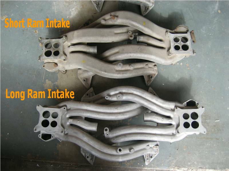

    Those would be the "short-Rams", that would've come on the 1963-64 Chrysler 300s.
