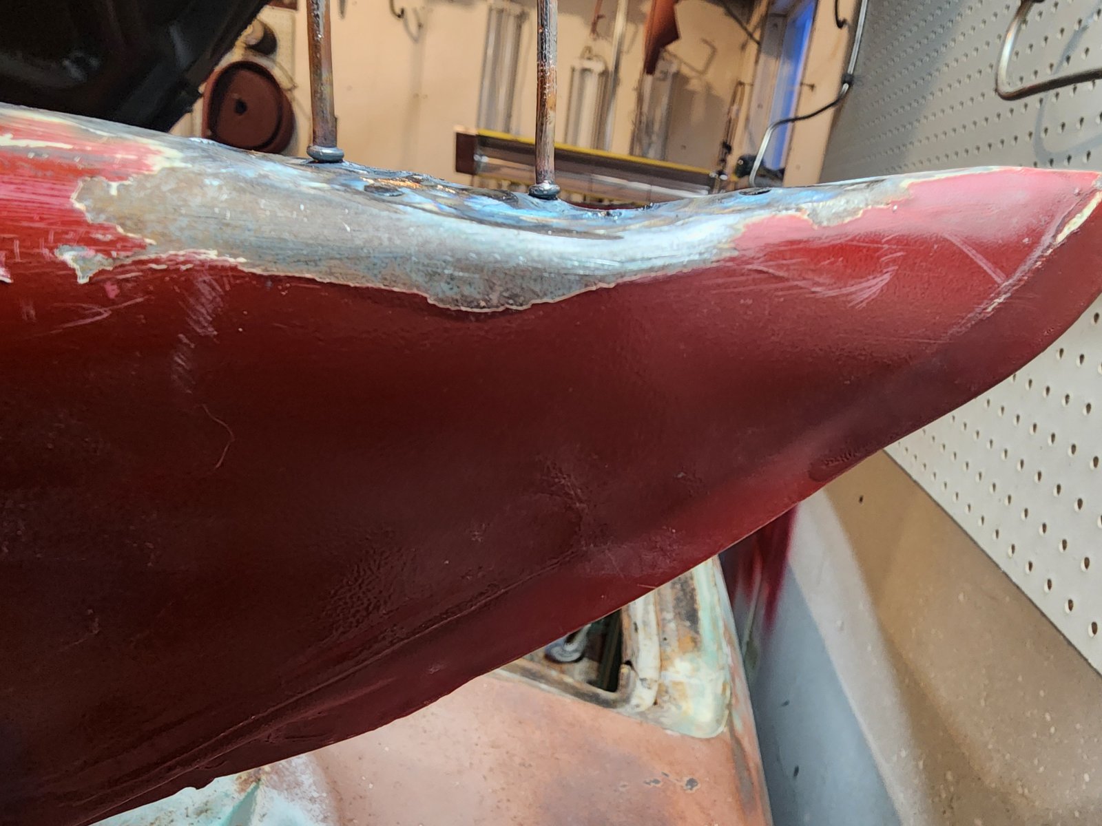

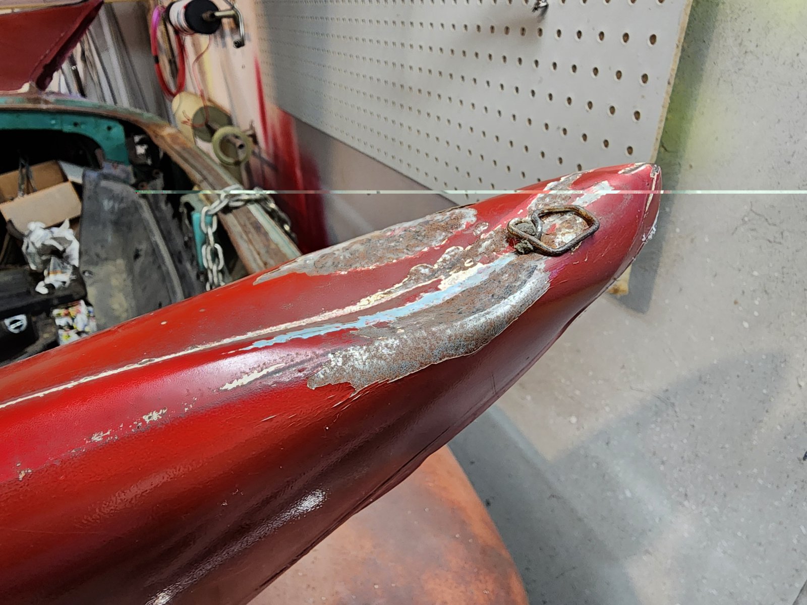

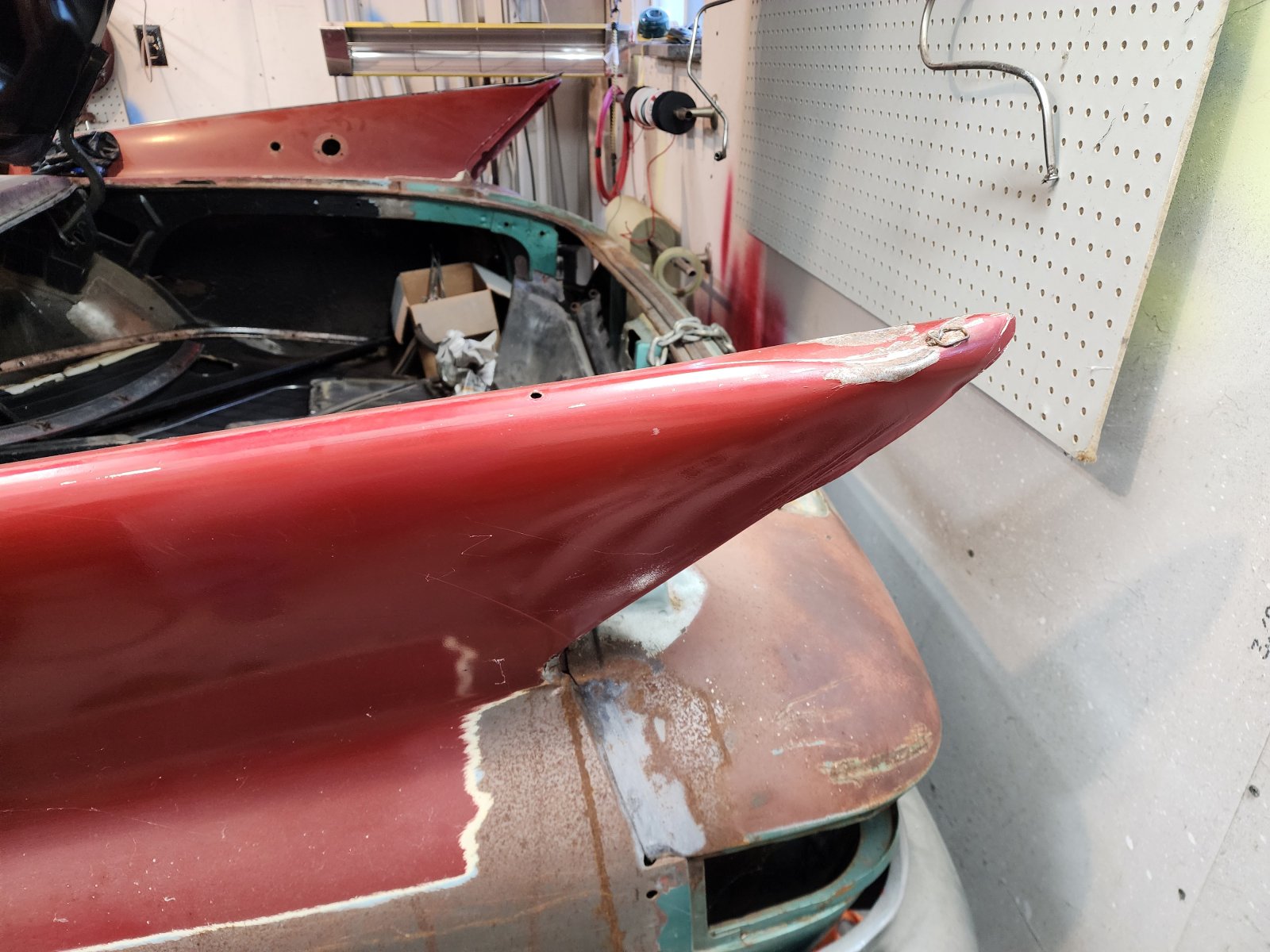

    In other news when it was shipped out here, the idiot shipper put a strap over the fins and crushed them. Any thoughts on the best way to work this out? Maybe a long pick? It''s not terribly accessible.
  2. Squablow
    Joined: Apr 26, 2005
    Posts: 18,494
    Squablow
    My dad's 65 GMC had a dent in the very top of the tailgate, straight down. I ground the paint off, welded a pull tab to it pointing straight up, then hooked my engine crane up to it and lifted it. Once I had significant weight on it I tapped around on the outside of the dent until it moved back into place. Took several tries, but that tailgate top roll is thick and the dent was hard. I think you could lift that dent out of there and tap the "high" spots down with some tension on it pretty easily.
    Big slide hammers are a ***** to use vertically. The engine crane is one of my favorite dent pullers.

  5. We use br*** or silicon bronze when we weld sweat plates (pulling tabs)
    Seems like it is less likely to tear the metal

    I used one of those lifting loops like what you bolt onto an engine, not sure what they're called, some engines still had them on at the factory. Like a big, oblong washer kinda with an oval hole to put a hook through. Lift bracket? One big chain link would probably work too, or the hook off of an old ratchet strap or something.
    If you've got access to brazing stuff, I like @anthony myrick 's idea of brazing on whatever you're using to pull with. I did end up tearing a hole in the tailgate top pulling on it. Was no big deal to weld it back up again, but would be nice to avoid it.
  7. I’ve also used dent puller studs.
    Then clamped them to pull several at a time.
  8. Here’s a few body shop methods
    washers can be tack welded along a crease and a hook tool in a slide hammer is common
    Welding 18-16 gauge metal to the crease then using common frame pulling clamps
    You can probably drill a hole in the 16 gauge to use a hook if no clamps are available.
  9. “In other news when it was shipped out here, the idiot shipper put a strap over the fins and crushed them. Any thoughts on the best way to work this out? Maybe a long pick? It''s not terribly accessible.”
    What kind of transporter does this??? Did he think he was hauling a backhoe?
  10. For stuff like that I just a stud gun
    safetythird and chryslerfan55 like this.

    Pulled most of it out with a stud gun and a slide hammer, then some lead free lead.
    Needs a bit more love, but better.
