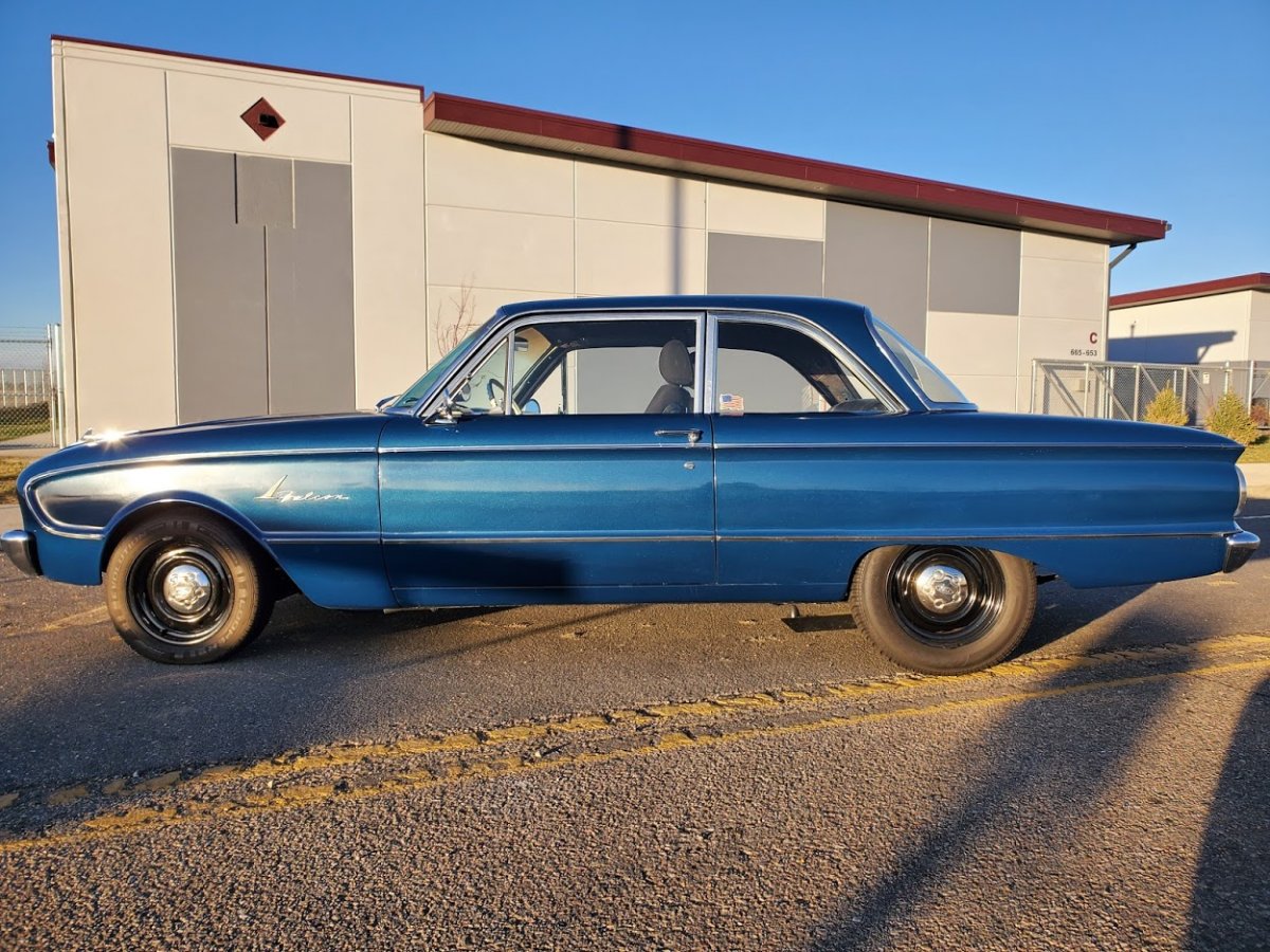

    Yo! I recently sold my 1951 shoebox that was my driver for the summer, it's soon on it's way to Normandy, France to a good dude I met through the Shoebox Facebook group. I wasn't planning on getting another car for the winter, was going to focus on motorcycle projects. Fortunately, things didn't go as planned...
    My first car was a 66 Mustang (still in the family), and I'd figured the next car was going to be another first gen Mustang build next year, time to get back to my roots. I was ****ing around on Facebook marketplace like usual, and a ****py ad for a 61 Falcon popped up, that had some interesting details. Something about a 5.0 and a T5 swap, but the pictures ****ed. It wasn't too far away, so I stopped by to take a look.
    The car turned out be super nice! A Falcon is close enough to a Mustang to make me happy. It turned out to be a long term project by an older guy, who didn't really spare any expense.
    Very nicely done 5.0 swap from a ~99 Explorer, and fully built. Lumpy cam, new top end, aluminum heads, Weiand Stealth intake, Holly Double Pumper, Performance Distributor, ****** super comps, etc. Newly rebuild T5 swap nicely done. Whole car is straight, no rust, new paint, new interior, etc. Still needs a headliner (which he gave me), and gotta get rid of those 90's cougar bucket seats.
    Suspension is all done with Falcon Sprint parts. Subframe connectors, sprint rear axle with 3.73's and new posi. Too much other stuff I can't think of or don't know about. Luckily the rad guy gave me a 3" binder of pictures and receipts for the entire build. Still need to sort through it all.
    I'm driving the hell out of the thing and having a blast. Plan on taking it to the track in the spring, so going to upgrade and sort it out over the winter. I figure I'll post my project on here, should be cool.
    On the way already are new Procar lowback bucket seats and mounts, and a Holley Sniper EFI conversion. I'll get into the details on those next.
    **** ya Falcon Fun Factory! I can't wipe the **** eating grin off my face every day I'm driving this thing!

    Nice car! Should go pretty good, cant weigh more than 2500 pounds.

    Why does the word Sleeper come to mind? :)

  4. Nice little Falcon.... I'll make some suggestions to help it out with that V8 power. I see you say the PO added subframe connectors, that's a good thing. But there's a few more bits you should add.
    When Ford came out with the Falcon it was only designed for a 6 cylinder motor, so the body shell was designed to be as light as possible. When Ford looked into adding the new 260 for '63, they found the body was too flimsy for the added power/weight so they beefed it up considerably. This lead to two shells; the 6 version and the V8 version. The V8 version had thicker metal and/or additional bracing added in the rockers, frame rails, shock towers along with torque boxes tying the rockers and frame rails together. Now, you're not going to be able to add all this (short of a rotisserie rebuild anyway) but there is two available parts that will help. One is a bolt-in lower crossmember that ties the frame rails/lower a-arm pivots together, available from Delta Bay Mustang for about $100. The other is a shock tower brace AKA 'Monte Carlo brace'. You'll need to drill a few holes for this. Both of these are Falcon/Comet specific as they're a bit over an inch narrower than a Mustang so the Mustang parts won't fit. Delta Bay used to sell the shock tower brace, I don't see them in their catalog currently but there are other suppliers. These will noticeably improve steering response/precision by reducing flex, which will help prevent cracking in the body structure. Do monitor the attachment points for the upper control arms as they are known to crack there (Ford tripled the metal thickness on the V8 bodies at that point). Don't go road-racing... LOL.
    I used to own a '64 Comet 302/4-speed car, it was ton of fun. Enjoy!

    That's a very nice Falcon, and wont take much changing to be perfect. I agree on the seats. A number of other older or even some modern seats will look more appropriate.
