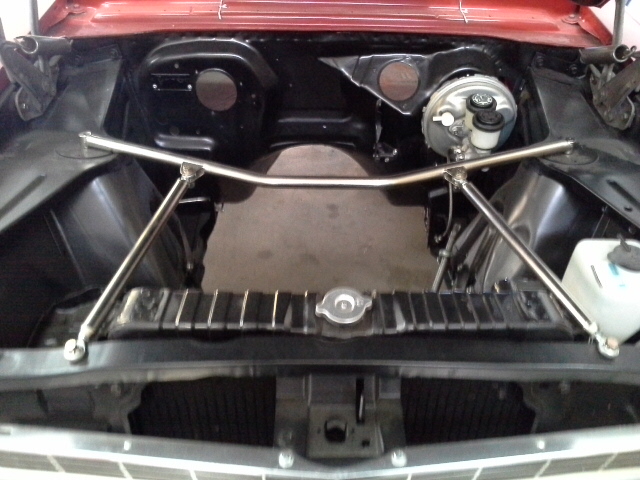

    Also, probably a stupid question. When you install an export brace, do you cut out the 2 factory cowl to shock tower braces? Or do you just put the new brace over them? I've seen it done both ways. Definitely don't like the look of having both in place, but is there any benefit to leaving the old braces there?

    I think you need is a Monte Carlo bar if I remember correctly . It goes from side to side at the shock towers . The braces you are speaking of bolt into the Mustang Ch***is , the are welded into the Falcon and Comets . I would not remove the welded in parts and replace with bolted in parts . The Mustang is a tad bit wider that the Falcon , be sure you are getting Falcon parts also .
  4. To tell the truth, with the Monte Carlo bar I wouldn't worry about the export brace.

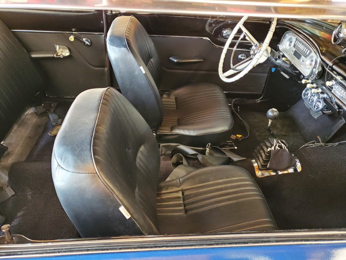

    Got my Procar seat rails put on the seats, and started mounting the bases.

    You don't need to install an export brace. Your car has one built in, from the factory.

    It doesn't have a fancy name, just a shock tower brace I made for my Nova.

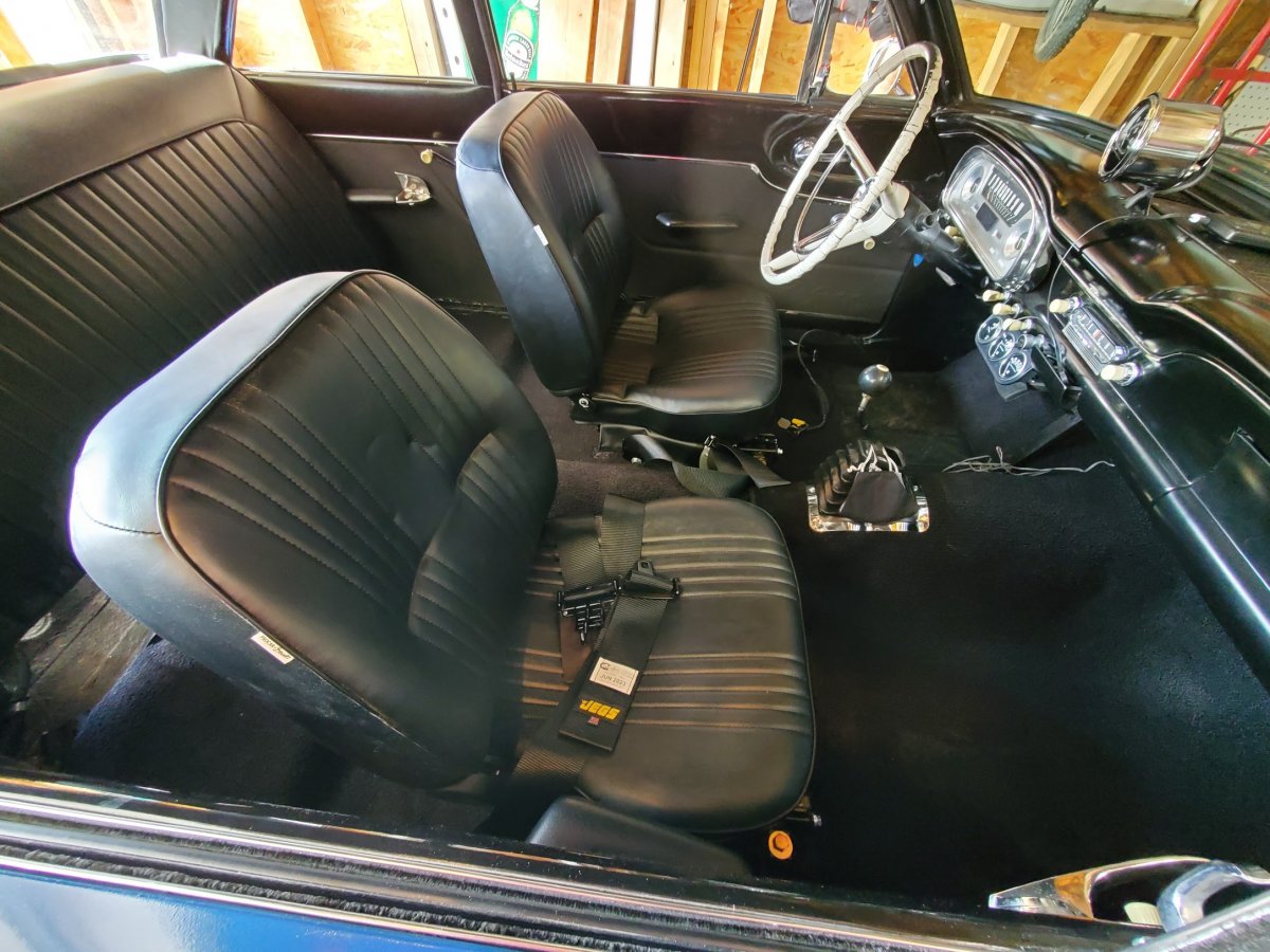

    Haven't updated in a bit. Got my seats installed. They look great and are super comfortable, really happy with the Procars.

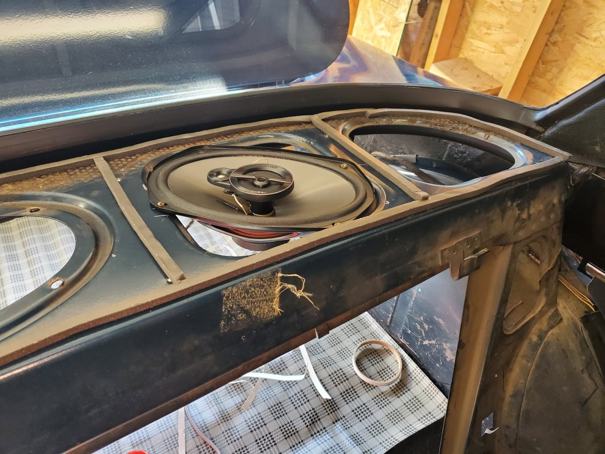

    Decided to put a stereo in the car as it will see a lot of daily driver service. Mounted a couple 6x9's in the package tray that fit well.
    Waiting on some new kick panels with speaker mounts should be here soon. Using a small amplifier mounted in the trunk to power them. I'm building a transmission hump mounted mini console that will mount in front of the shifter, under the dash. It will hold the head unit, my GPS speedo drive box, and the display for my EFI system screen.
