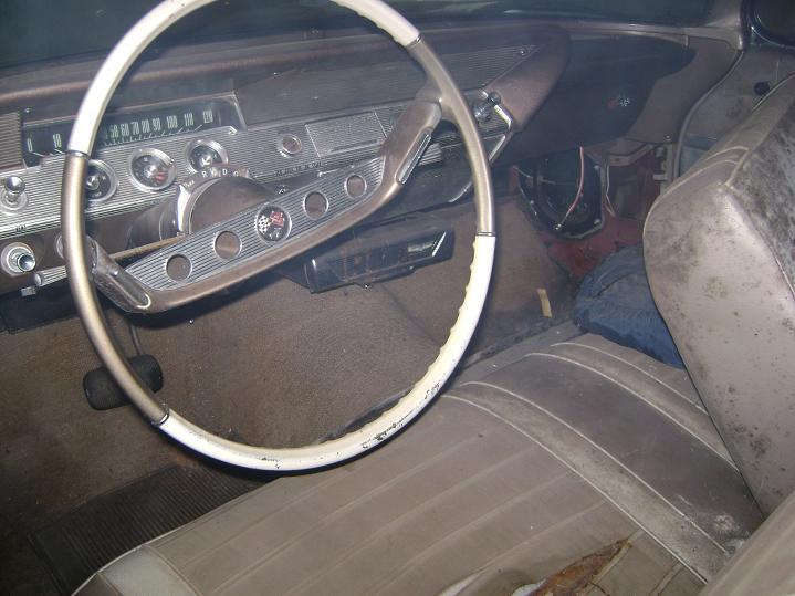

    Nice pics, but the first one of the steering wheel reveals that this car has a TURBOGLIDE transmission. (PRNDGr) I can barely see the G, but that would prove the TURBOGLIDE is either intact, or someone changed it out to a Powerglide or something newer. Let us in on the secret!

    The car does have the original TerribleGlide still in it. There's fluid on the dipstick and it smells fine. From what I understand those transmissions got a bad rap because they did have problems early on. Supposedly improved upon over the years. Some people I've talked to that actually have driven one, seemed to like them. I hope the trans is still good because "original is original". The previous owner said it's a good working trans and he's a square shooter. If it's bad, I have a back-up plan.

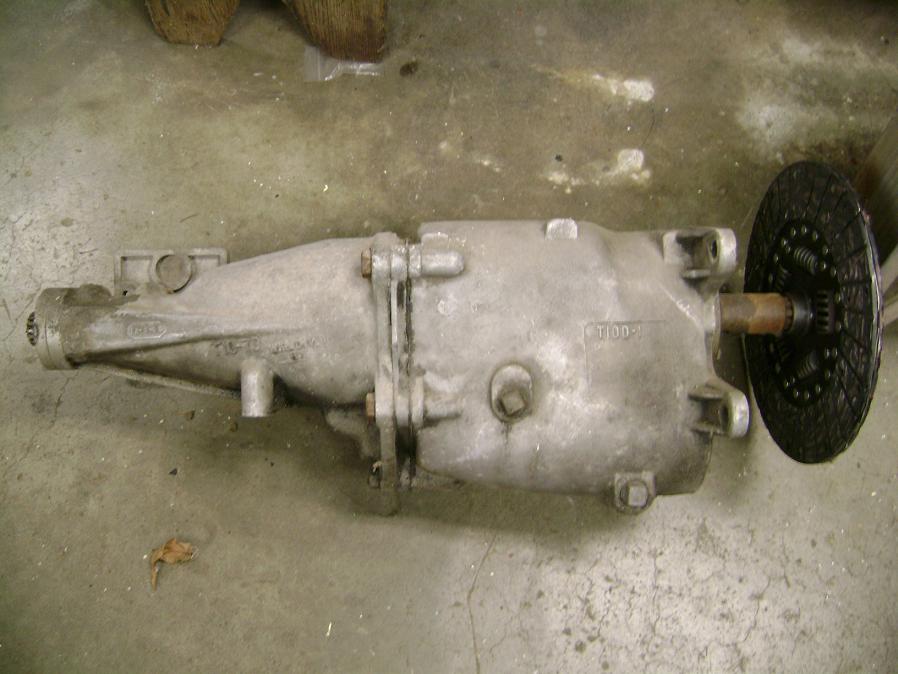

    Borg Warner T-10 four speed. If I remember correct, this came out of a 64-65 Impala. I also have a Muncie M-21 but the tall first gear probably wouldn't work well in this tuna boat that's running highway gears. Already have a bench seat Hurst shifter and the other stuff needed to make the conversion other than a set of pedals, pedal rods, z-bar and a correct steering column.

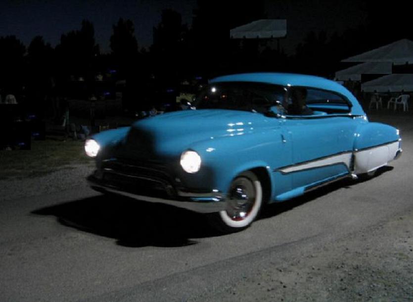

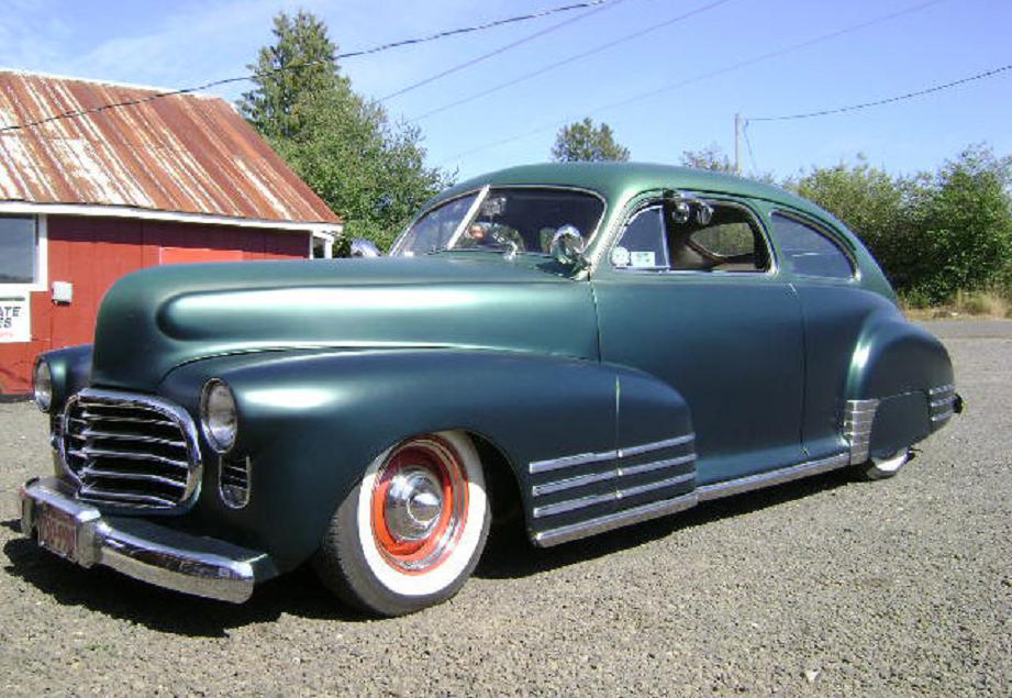

    Here's a couple of Dave Spears cars that have been p***ed to his gearhead son.

    Figured out it's a T10D-1 wide ratio (single ring on input shaft) from a '63 p***enger car with an 8/62 date. Originally installed behind a 327 or 409 engine. Not a good date match but a good match to the engine and rear gears, if I have to use it.

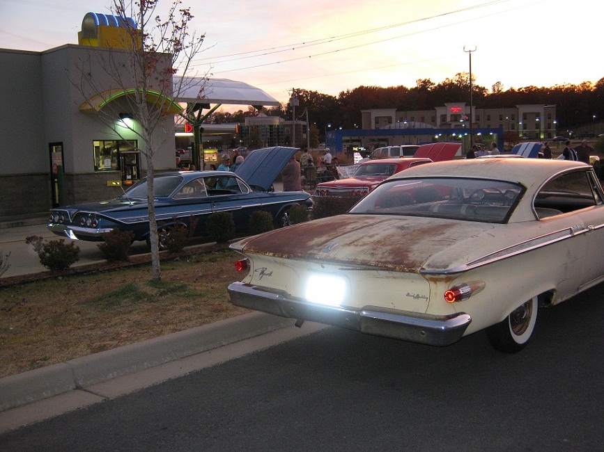

    Here is a pic of a '61 Bubble top beside a Real car. The real car is mine!!! lol Do you notice the similarities in these 2 cars!!!

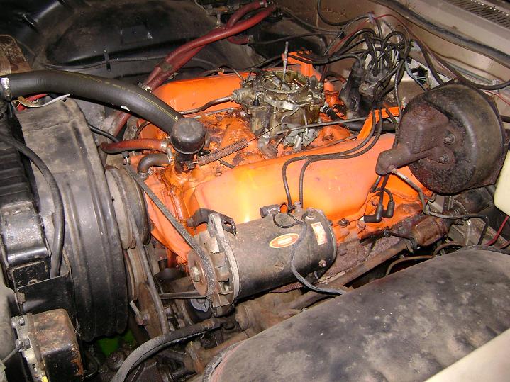

    Still working too many hours to get much done at home. I did get the core support cleaned up and some of the front end stuff back on. Polished on the hood but really the paint is shot.
    Stopped at parts store on the way home and ordered a carb kit which will be here tomorrow. The carb had the aluminum ID tag and is original. Next job, install new gas tank and get new fuel lines.
