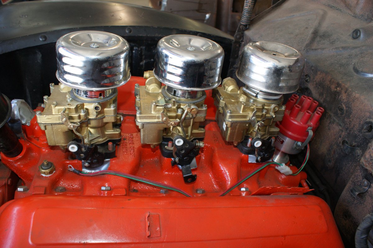

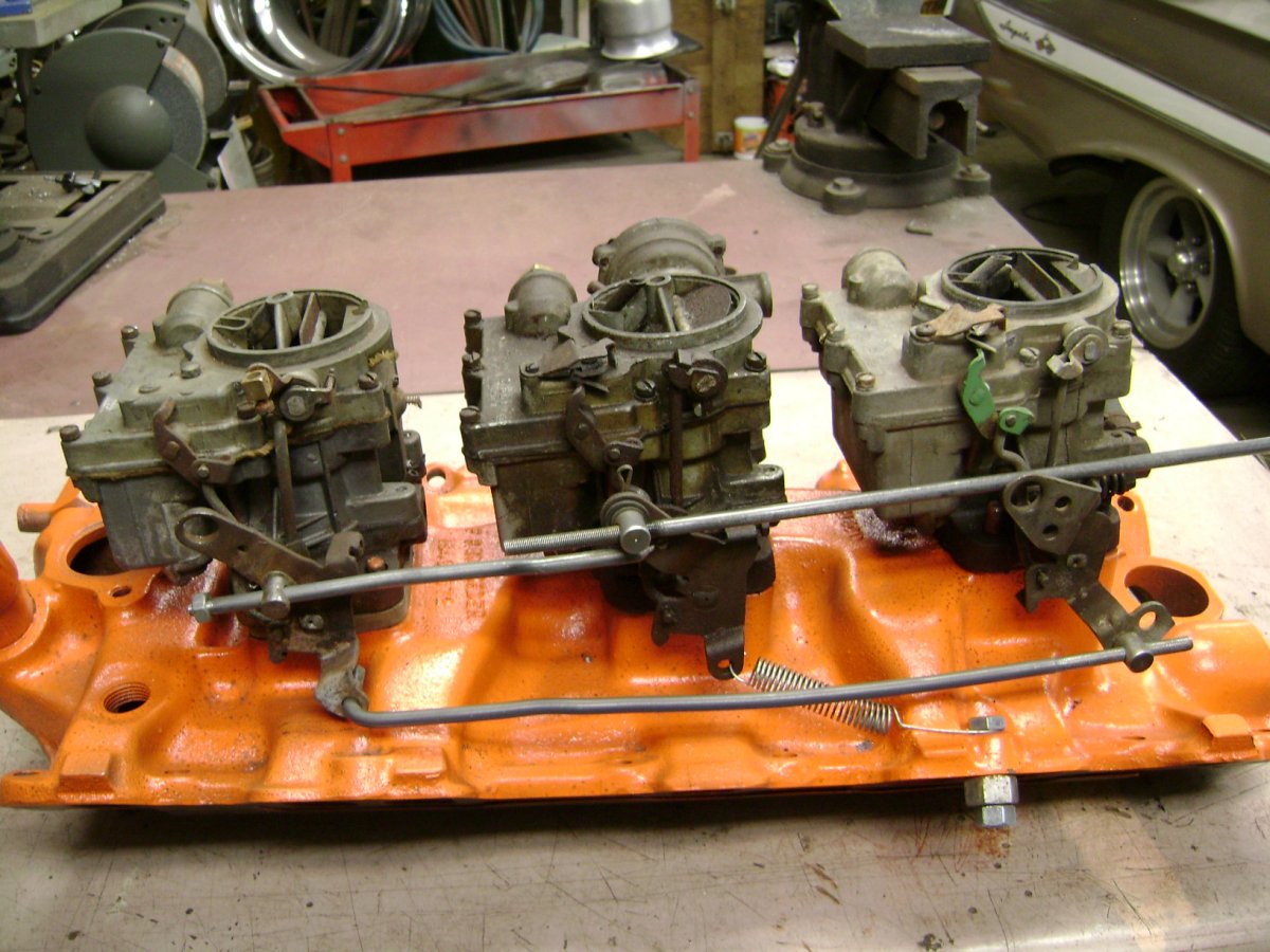

    I already had an original 3x2 intake so I was telling a gearhead friend that I'll be looking for some 2G Rochester carbs at the upcoming Portland Swap Meet and I hope he'd look too. A few days later he shows up with a whole crop of them. I tried to pay him several times but he said no.
    Not correct tri-power carbs but the right era with side fuel inlets and hot air choke. I'll be able to make 'em work. Plug the idle circuits, remove choke plates, choke shafts and plug the shaft holes. Buy the correct reproduction throttle shafts for all three and the thick throttle blades for the front and rear. Now I need to find some progressive linkage.
    YeeHa.

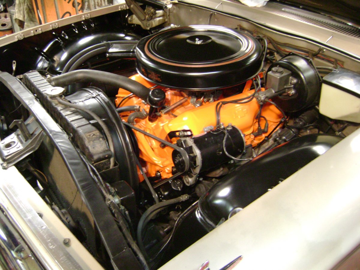

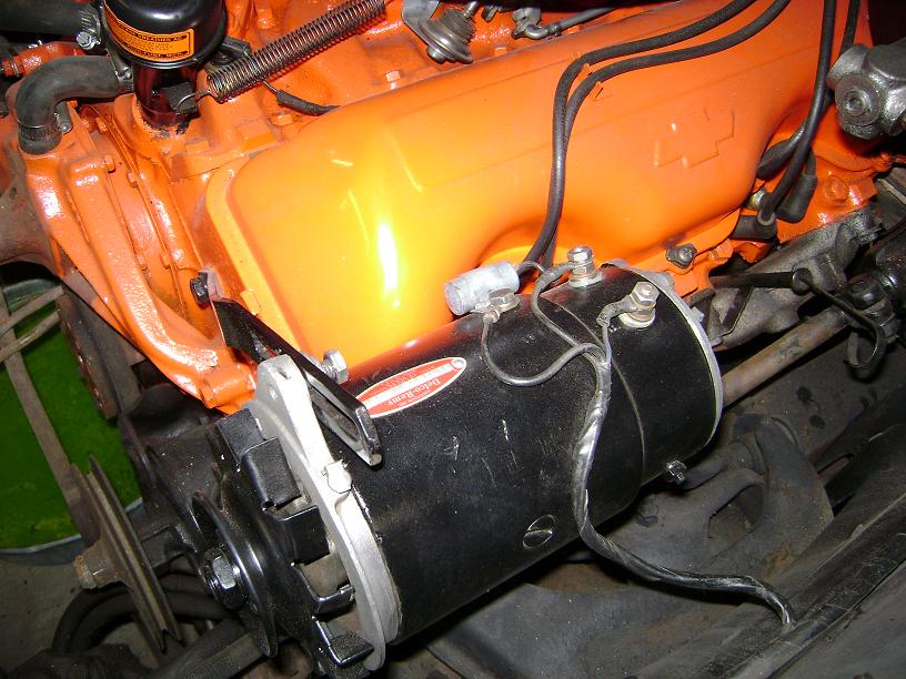

    I have been doing a little work on the car.
    Did a rattle-can restoration on the generator.
    Pulled off the fan, pulleys, shroud and radiator for some clean-up.

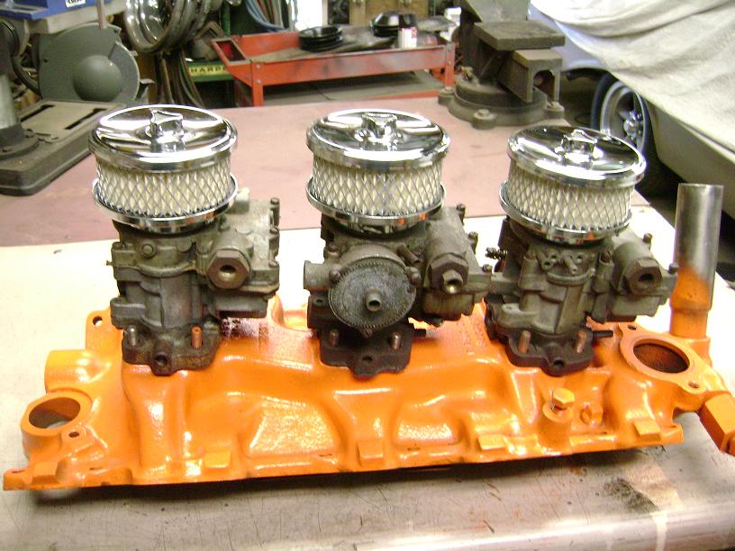

    Got the manifold cleaned up and painted but it needs another coat.
    Soaked the carbs, got everything moving freely and ready for dismantle.
    Borrowed some funky little air cleaners for photo fun.

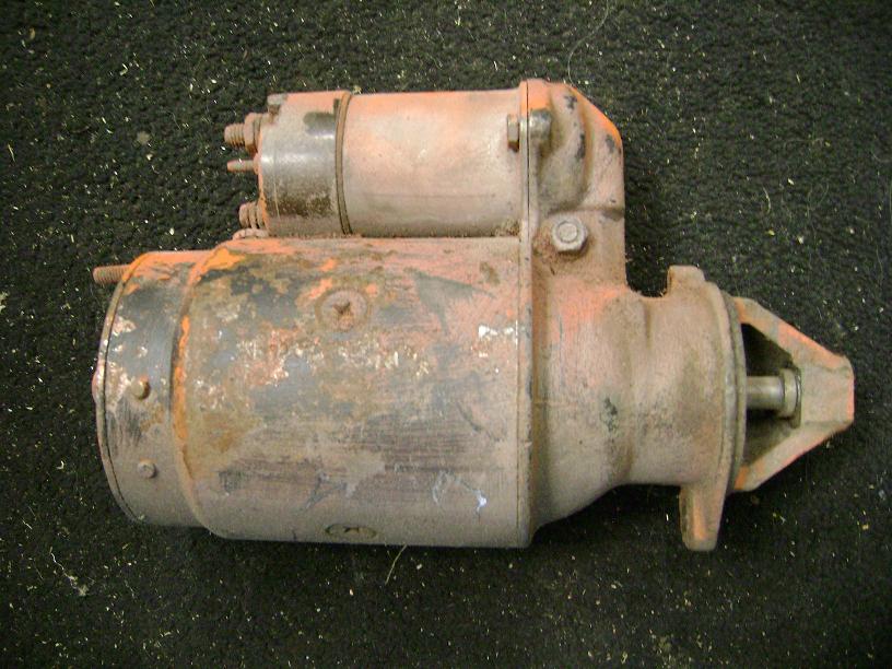

    A correct starter that fits the bell.

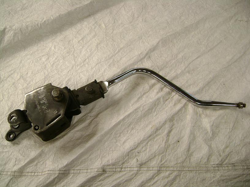

    A "spaghetti" shifter I thought was Chevy but found out it's Mopar.
    I think I can make it work.
    I have a boot and ring to use from my spare parts stash.
    Not a correct boot but free is a very good price and it looks "close enough".

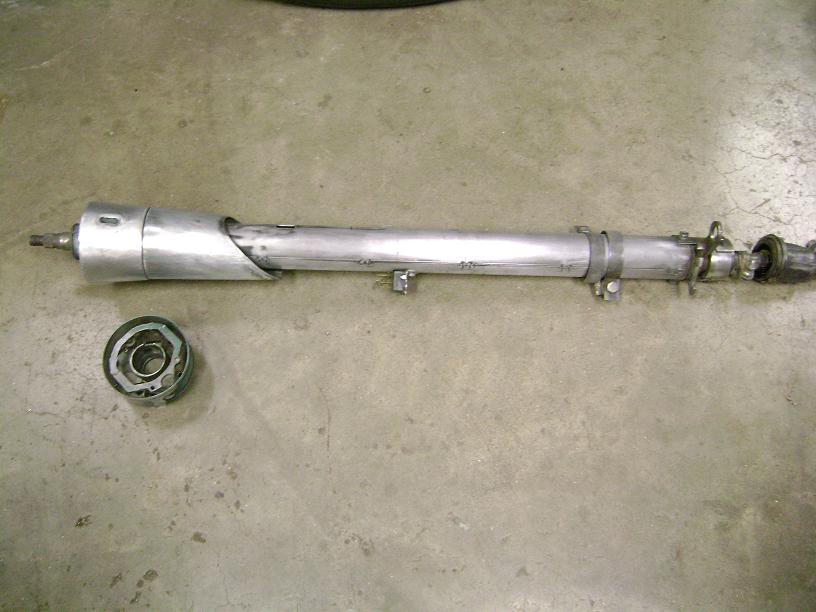

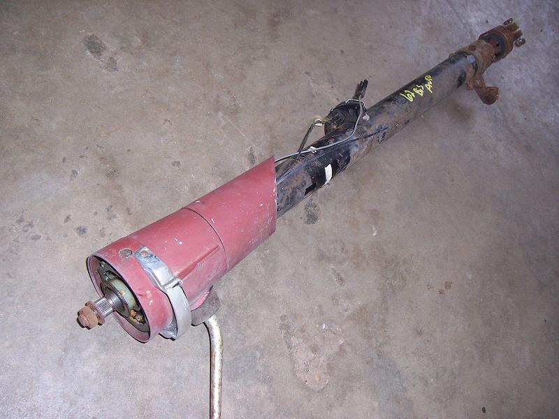

    Also scored a Powerglide steering column to make look like a 4 speed column.
    Finding a 1961 four speed column is impossible unless you have very deep pockets.
    Already had it torn apart so here's a red one that looked the same as the green one I bought.

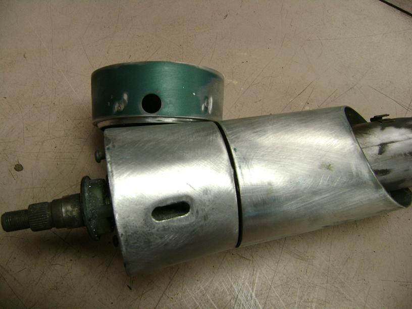

    You can see the shift indicator pointer and shifter handle boss have been ground off.

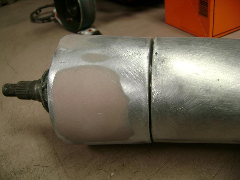

    I beveled the edges of the ground off shifter opening so it'll hold filler better.
    You can also see the hole in the collar that needs filled where the shift indicator light was.

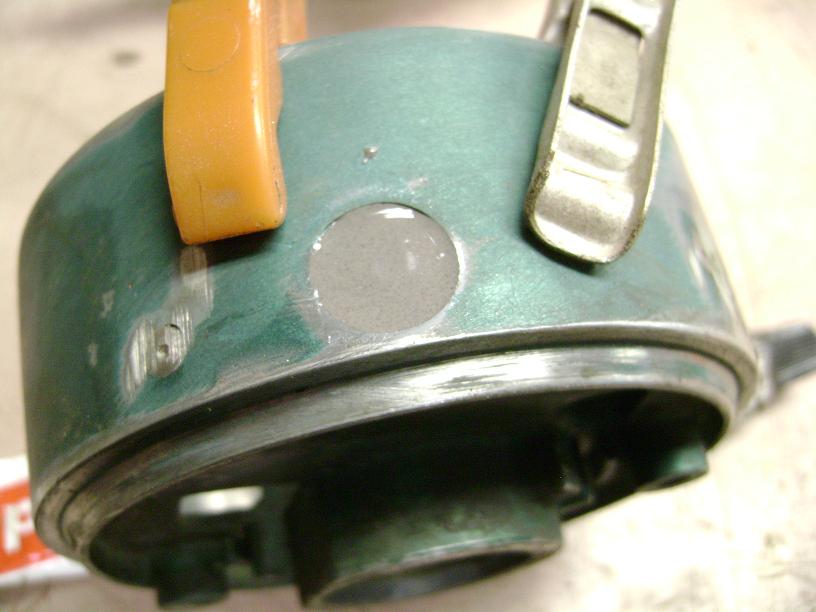

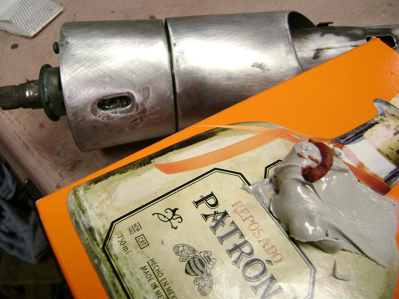

    For the shift light hole I cut a piece of metal to back it and JB welded it inside of the collar.
    This will give the filler something to bite.
    Stuck some clamps on it until the JB dries.
    Put some screws in the two shift indicator holes and ground them off.
    Mixin' up some Bondo for the old shift handle hole after it was mostly filled with JB and a little mesh.
    I like to use a smooth cardboard box for Bondo so I don't have any clean-up except the applicator.
    Roughed in Bondo.
    Almost ready for primer.

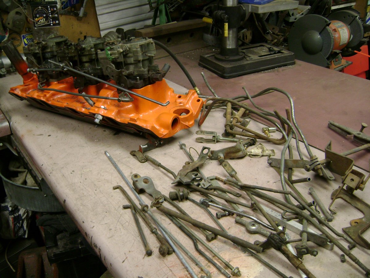

    Got the progressive linkage built for the Impala's tri-power out of my junk linkage box. Kinda stock looking compared to all the aftermarket stuff offered. Now I gotta rebuild the carbs, switch the top on the rear carb to match the front, plug the idle circuits and remove the choke ***embly on the front and rears. I'll cut off the rest of the throttle bellcranks I don't need and straighten out the lower throttle rod to clean it up a little more.
    Very happy how it works. Front and rear carbs engage at about 60% throttle.
    The throttle rod connection on the front carb is a slide.
    Has a nut on end of rod which acts as a stop to actuate front and rear carbs.

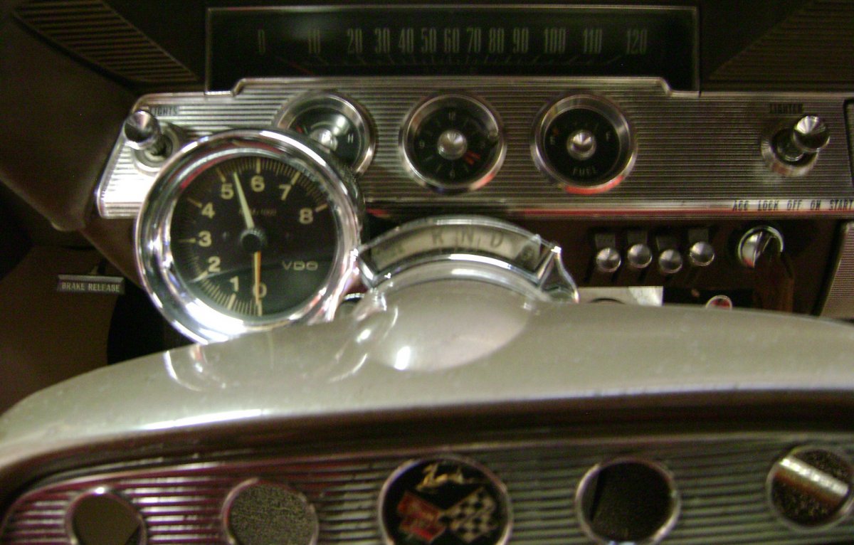

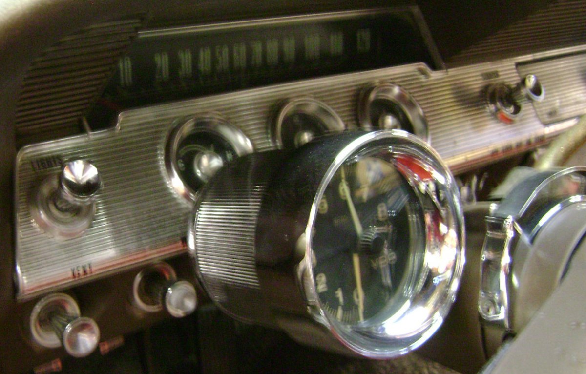

    Couple weeks ago installed an old VDO tachometer from my parts stash.
    It has a ribbed case that mimics the dash trim.
    Used the old school hose clamp method to attach to the column.
    I gotta keep looking for a proper Sun tach that I can afford.

    vtwhead is correct, the 348/409 site is a good place for tri-power info: http://www.348-409.com/
    I haven't finished mine yet. The main thing to get a tri-power working correct is make sure there's no air ****ing past the throttle blades on the front and rear carbs when they're not engaged. If you hold each end carb up to a light with the throttle blades closed and you see light, you're going to have problems.
    Real tri-power end carbs have much thicker throttle blades than ordinary carbs so they seal better and also have extended throttle shafts on the p***enger side. That's where the factory linkage connects the front and rear carbs together. I'm using junkyard carbs and after much reading decided to use "Vintage Speed" throttle body bases for mine which are made to convert normal carbs.
    As far as linkage, there's ready made stuff from Speedway, Jeg's, Edelbrock and others but I don't like the modern look with alloy throttle arms and heim joint ends. I think you can get some of the tri-power reproduction linkage rods at Show Cars: http://www.dr409.com/
    Here's factory linkage for a 1961. Notice the vacuum diaphragm on the front carb.
