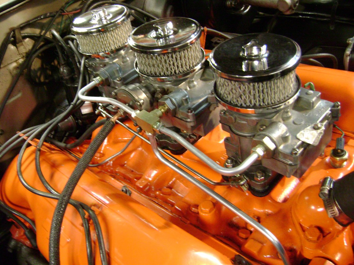

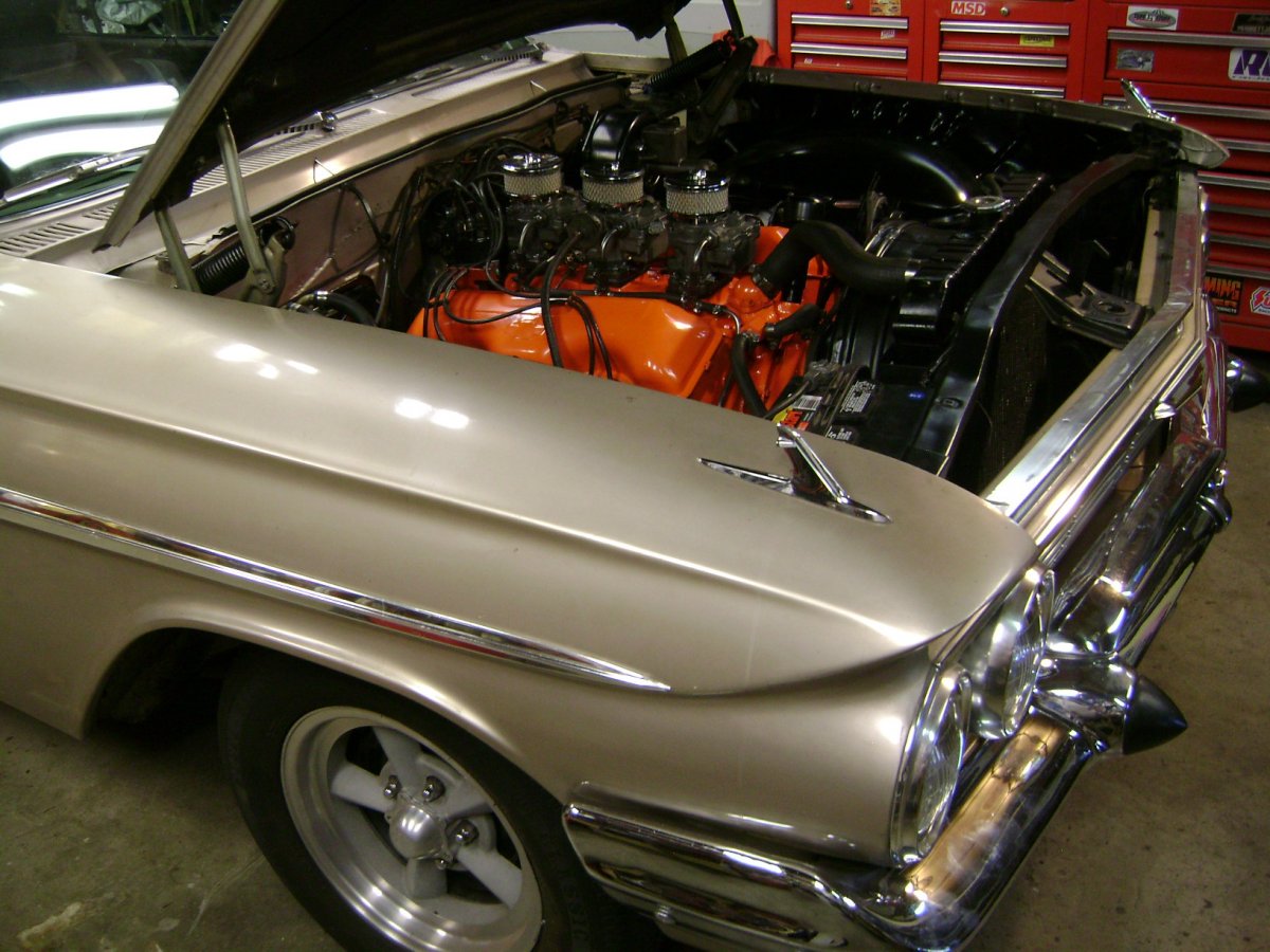

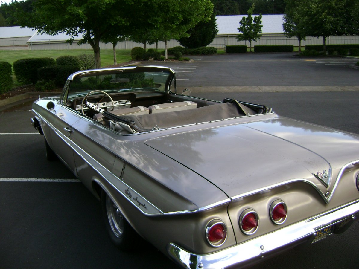

    So I got busy over the last couple weekends on my Impala.
    New heater core installed.
    Had to fab a spacer and move brackets inside the box to use a '62 core.
    (no new 61's available)
    Installed new motor mounts....
    Last time I drove it the fan was hitting the shroud from dead stop acceleration.
    Kind of a ***** changing as big block heads hit the firewall with engine jacked up.
    Required a 4 foot 2x4 as leverage to move the engine to each side.
    Cleaned and painted the bottom of the engine while I was down there .
    Cleaned the firewall better while I had the intake manifold off to install.............

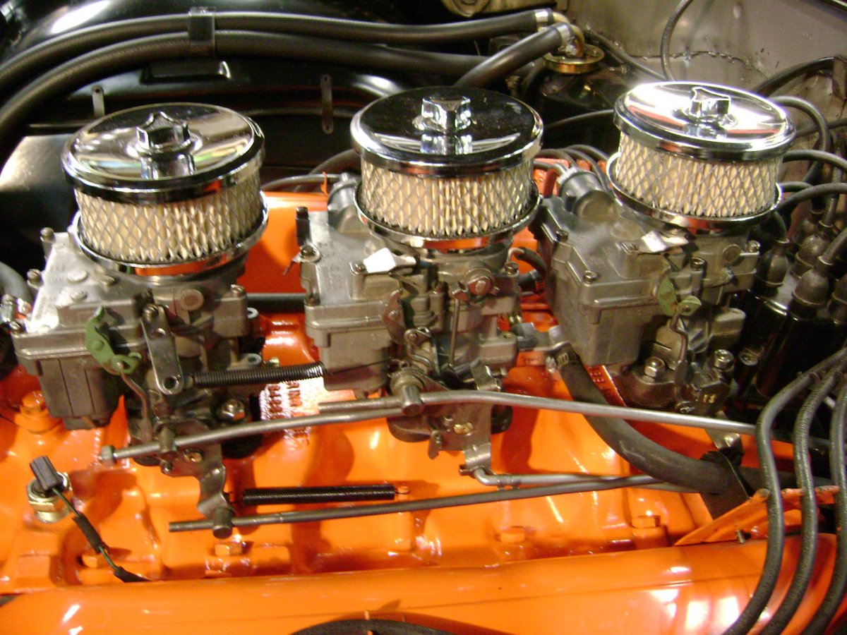

    TRI-POWER
    Used the factory throttle rod from firewall to center carb.
    Also stock kickdown rod from trans to bottom of center carb after some bending.
    Linkage works great.

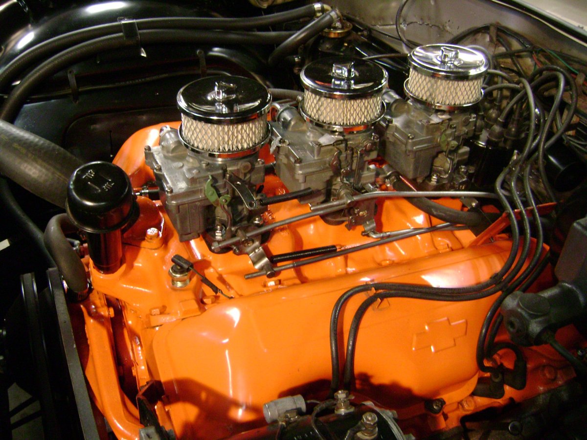

    DSC09615good.JPG It's not anything like stock but I like the looks better than new heim joints and clamp style brackets.
    Moved the coil to the factory firewall location for tri-power.
    Still need correct $57 bracket for the coil since I subs***uted an old Ford one from parts stash.
    Right now I have block-off plates under the front and rear carbs, until I can buy the "Vintage Speed" carb bases. It won't be long since I sold some junk out of the parts stash on craigslist today.
    Got the car running and dialed in on the center carb.
    Ran it a few times, then on the last try, starter wouldn't do anything.
    Oh well..... F-it for tonight, I heard it run good enough to drive.
    Trace down the problem this week.
    Not real proud of the fuel line set-up but it was free out of the parts stash.
    It'll get me by until I have an extra $100 for the correct reproduction lines.
    Should be driving this thing next weekend.

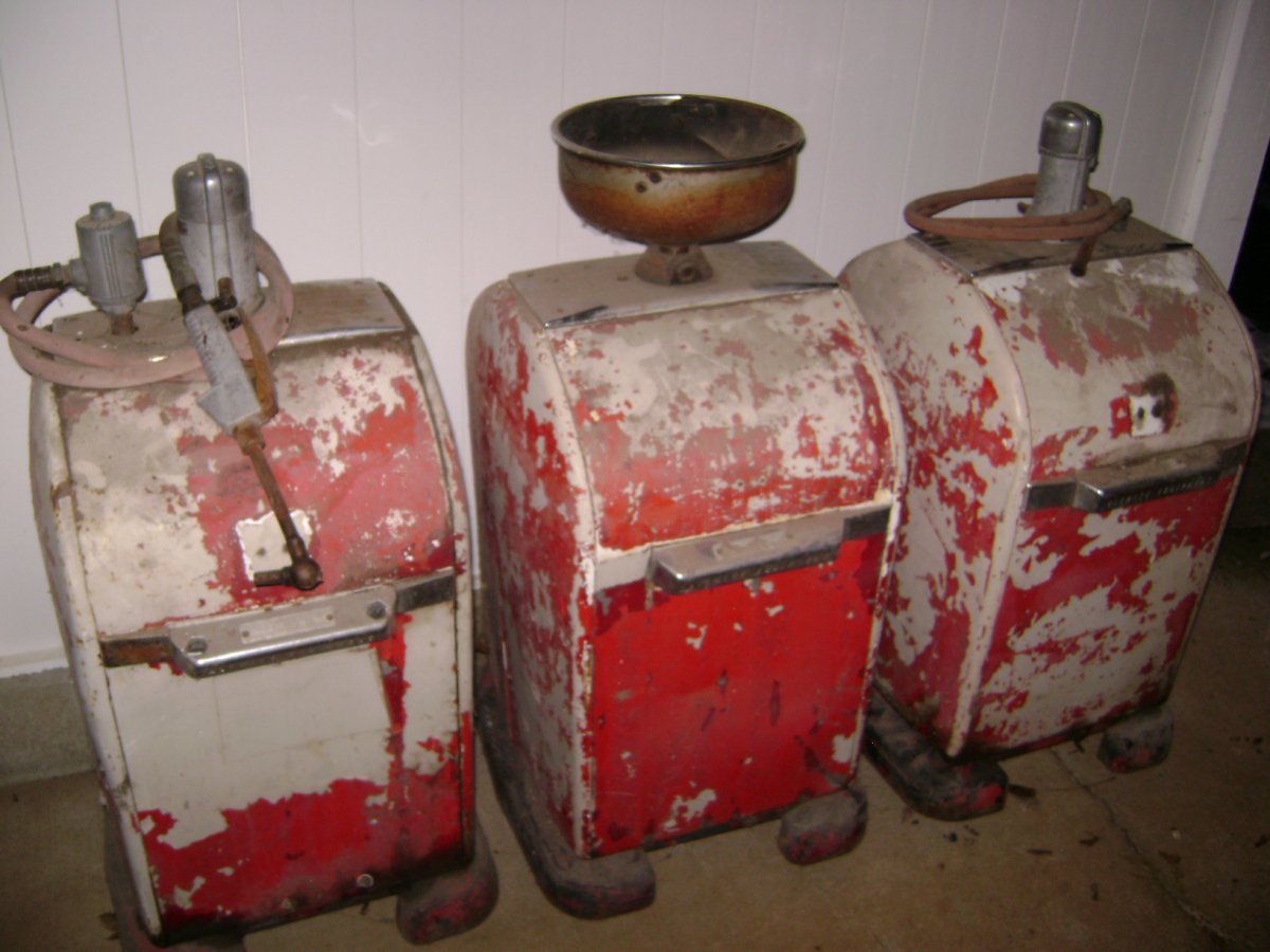

    I have an original tri-power air cleaner lined up as a trade so the little chromies won't be staying.
    Trading these 1950's lubesters but have to run a DA sander over 'em then rattle can.
    That is all...........

    Blew some cobwebs out of the Impala.
    Lovin' the tri-power sound and added performance.
    Got the "Vintage Speed" throttle bases installed along with the factory fuel lines. Also an original style rod connecting the front and rear carbs on the p***enger side. Cut off the rest of the unneeded bellcrank on the driver side end carbs since I ditched my homemade connecting rod.
    Looks better and works good.

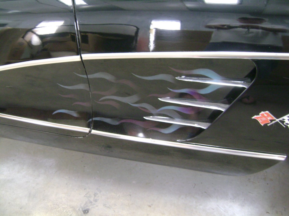

    Ghost flames added in the late 1990's.
    Not sure if they'll stay.
