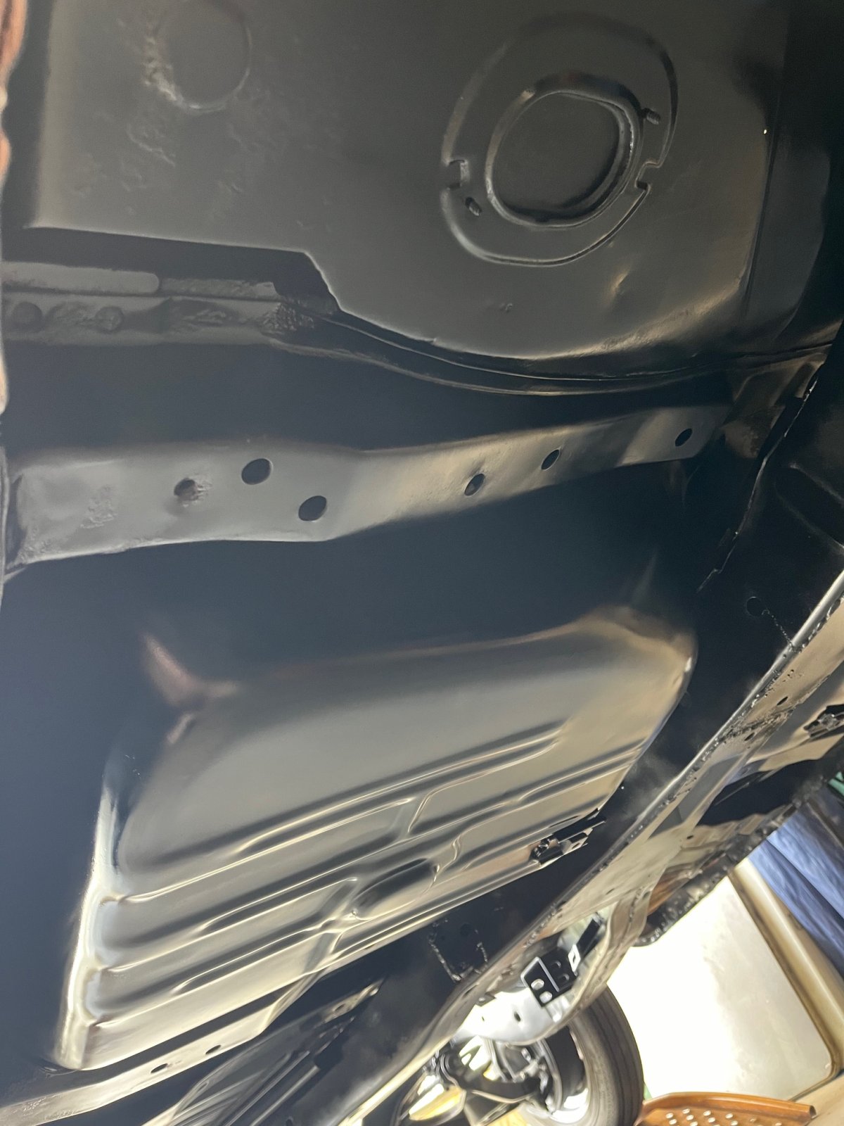

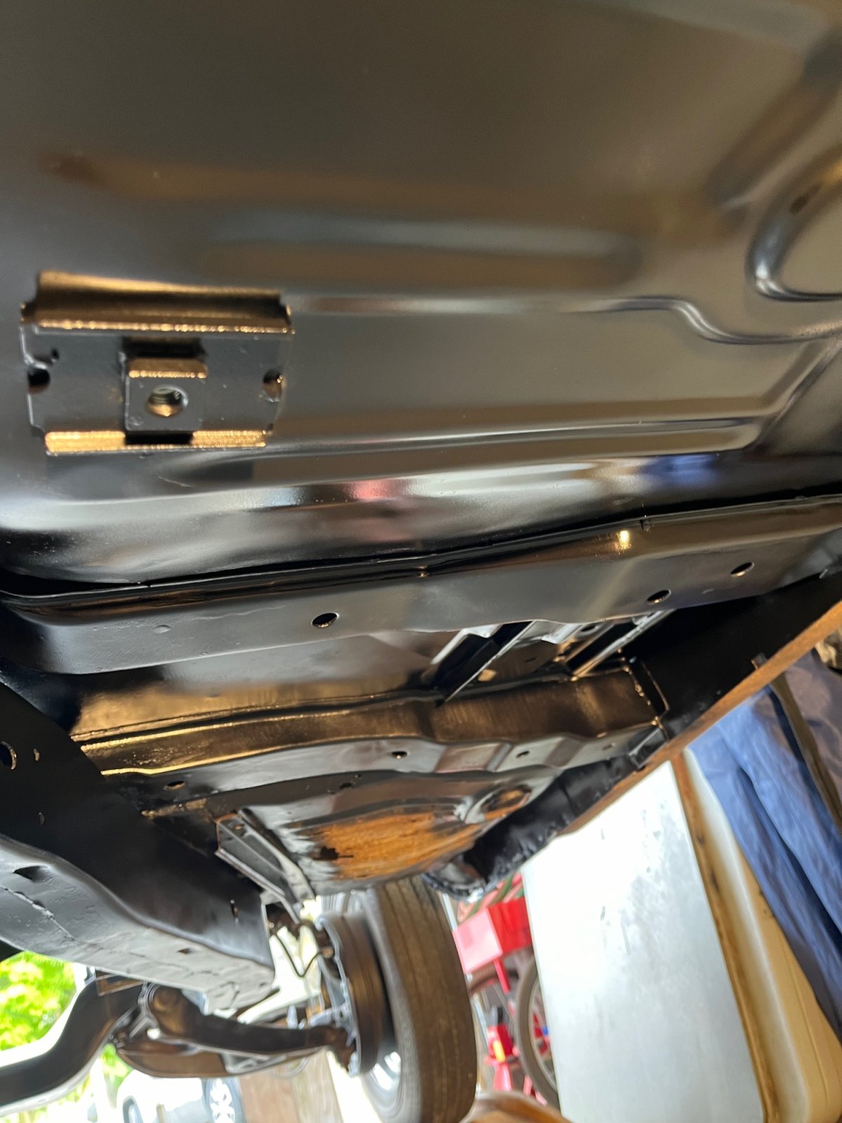

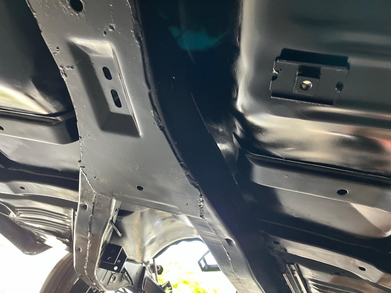

    Other than some remaining floor work, the bottom of the car is completely painted :). I used good old semi gloss black Rustoleum.
    IMG_6370.jpg IMG_6372.jpg IMG_6373.jpg IMG_6375.jpg IMG_6379.jpg IMG_6382.jpg IMG_6383.jpg

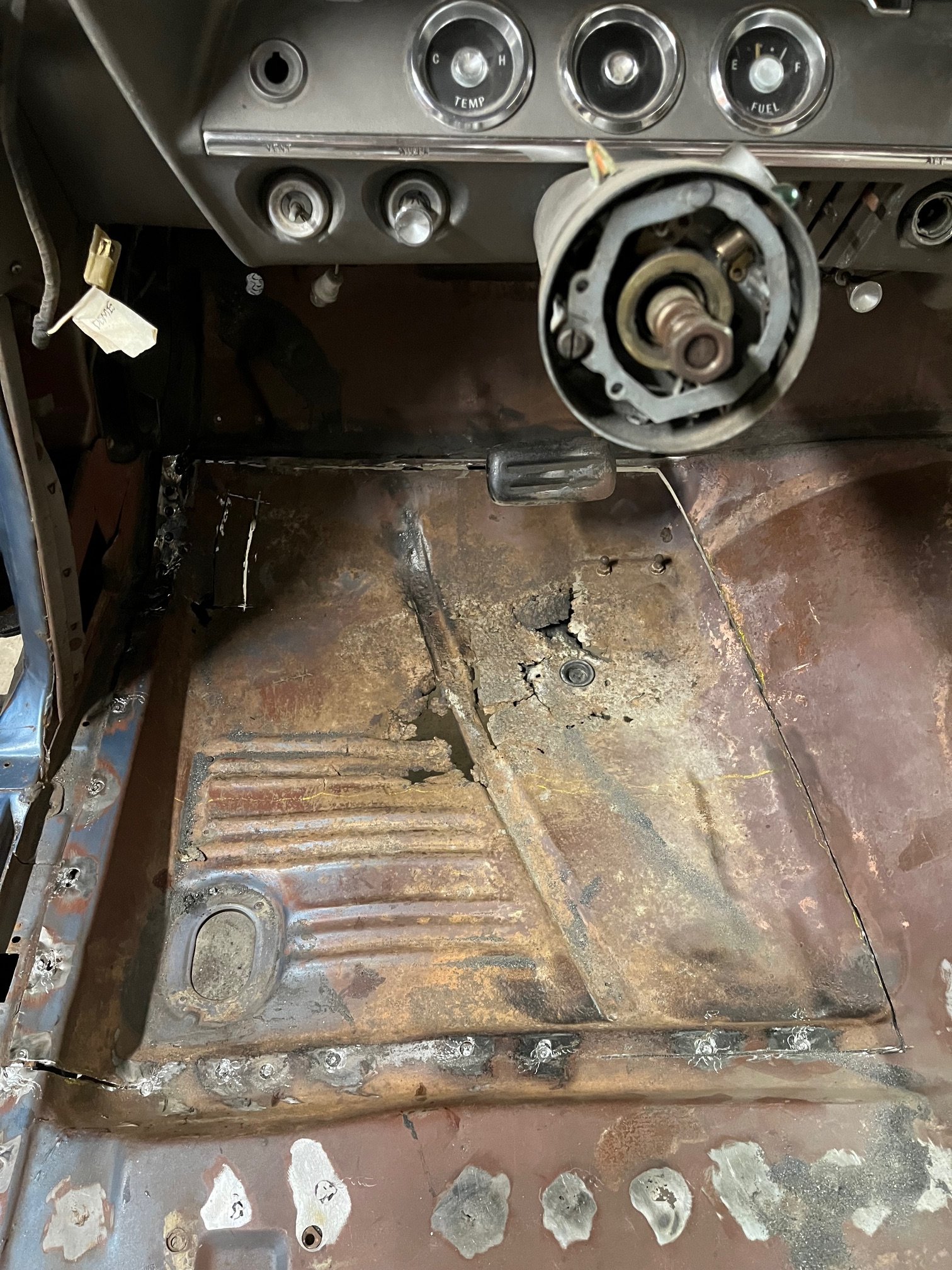

    After a short break I'm back on the floor pans. Started on the right front today.
    Saving the support bracket in the upper right corner was a bit of a pain in the *** but everything else went as expected.
    She's slowly becoming rust free ;)

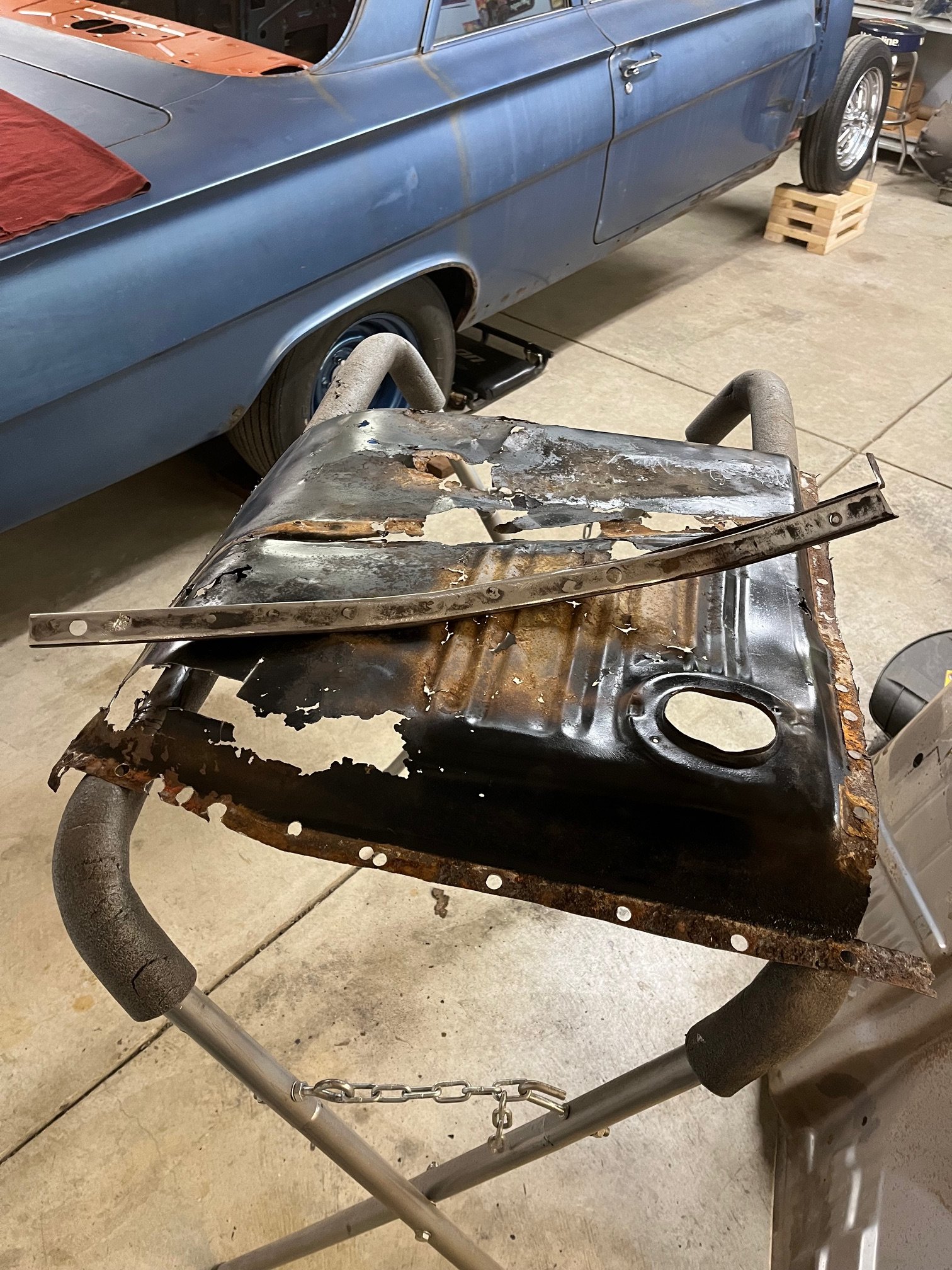

    Got the RF floor pan roughed out and saved the stiffener.

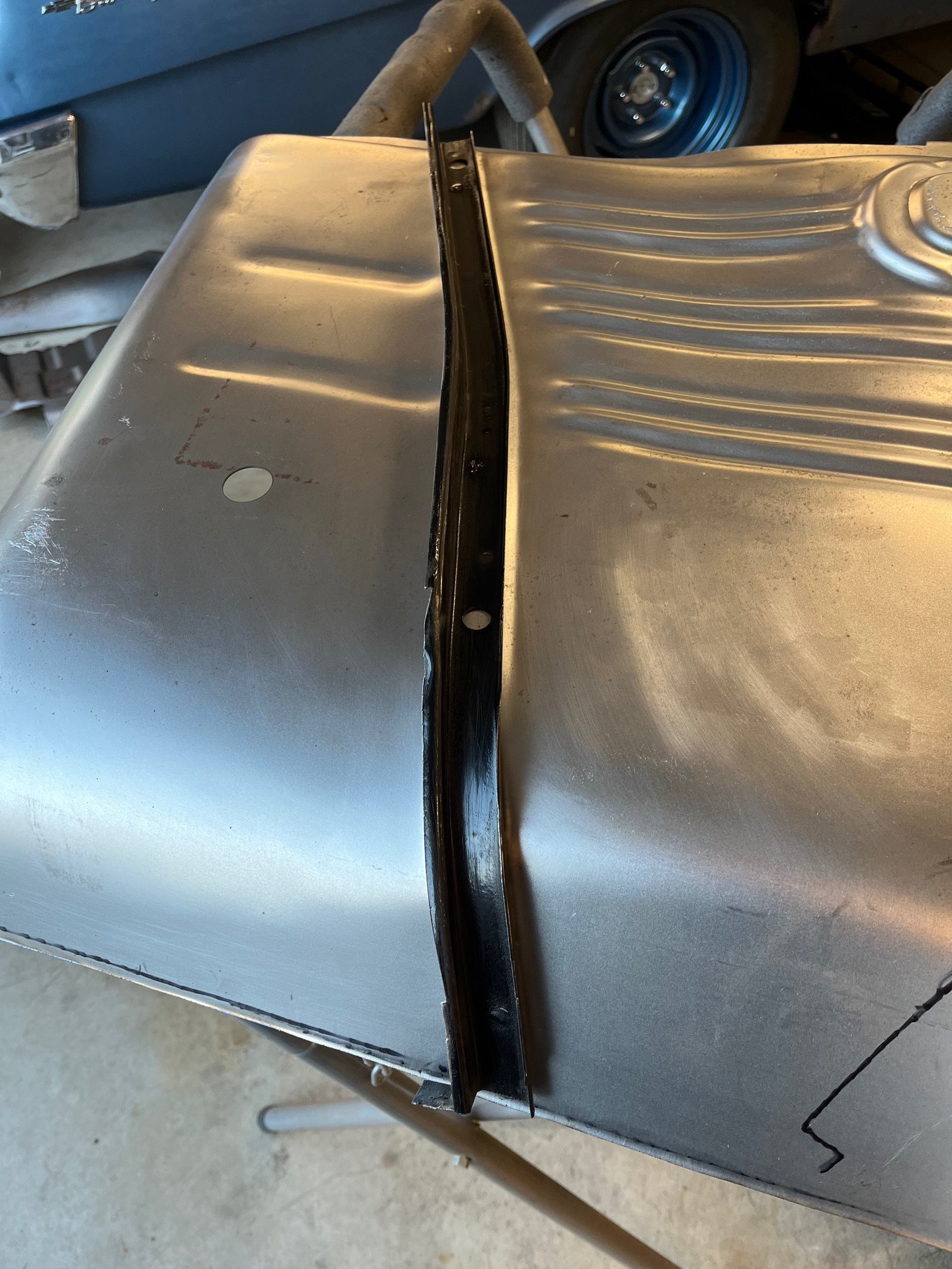

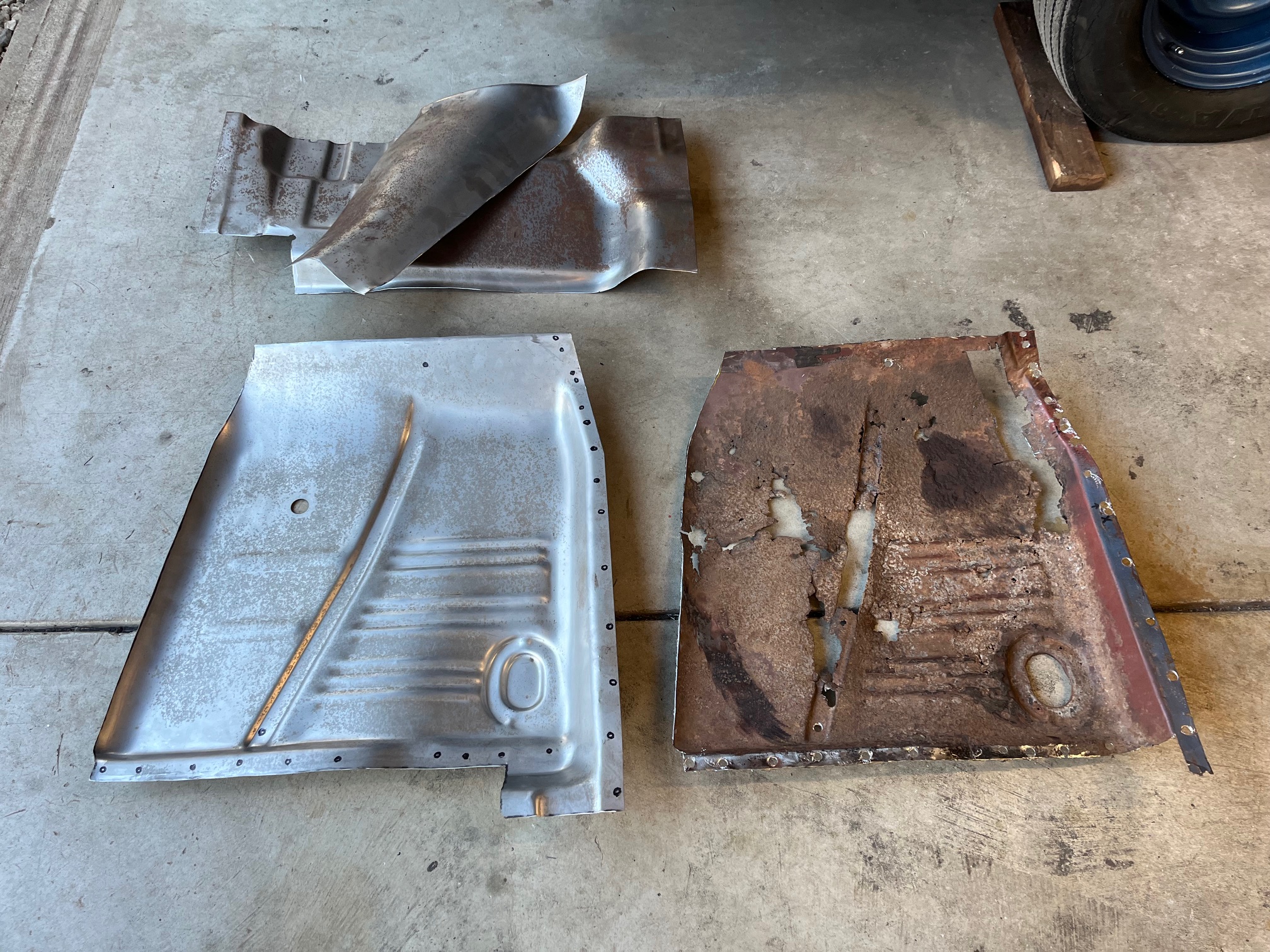

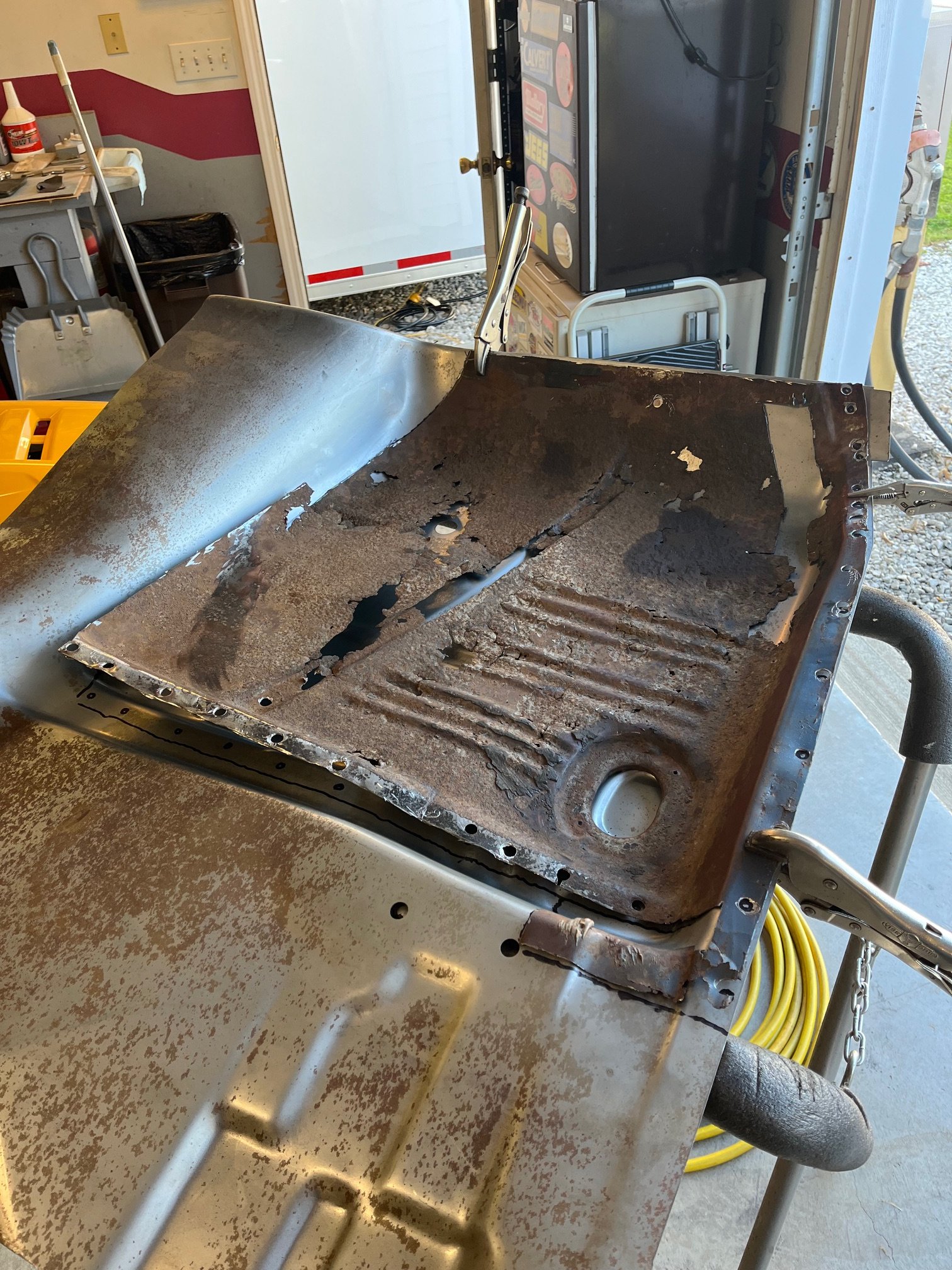

    Great question and thanks for asking. I would say it was. It's a channel with compound curves which would be difficult to re-create. It was in great shape as the rust was on the inside of the floor pan. Lastly, the floor pan was so rusted that it was only held on by two spot welds (easy to remove) and the grinder cleaned it up nice. Here's a couple pics that hopefully show it better IMG_6492.jpg IMG_6493.jpg

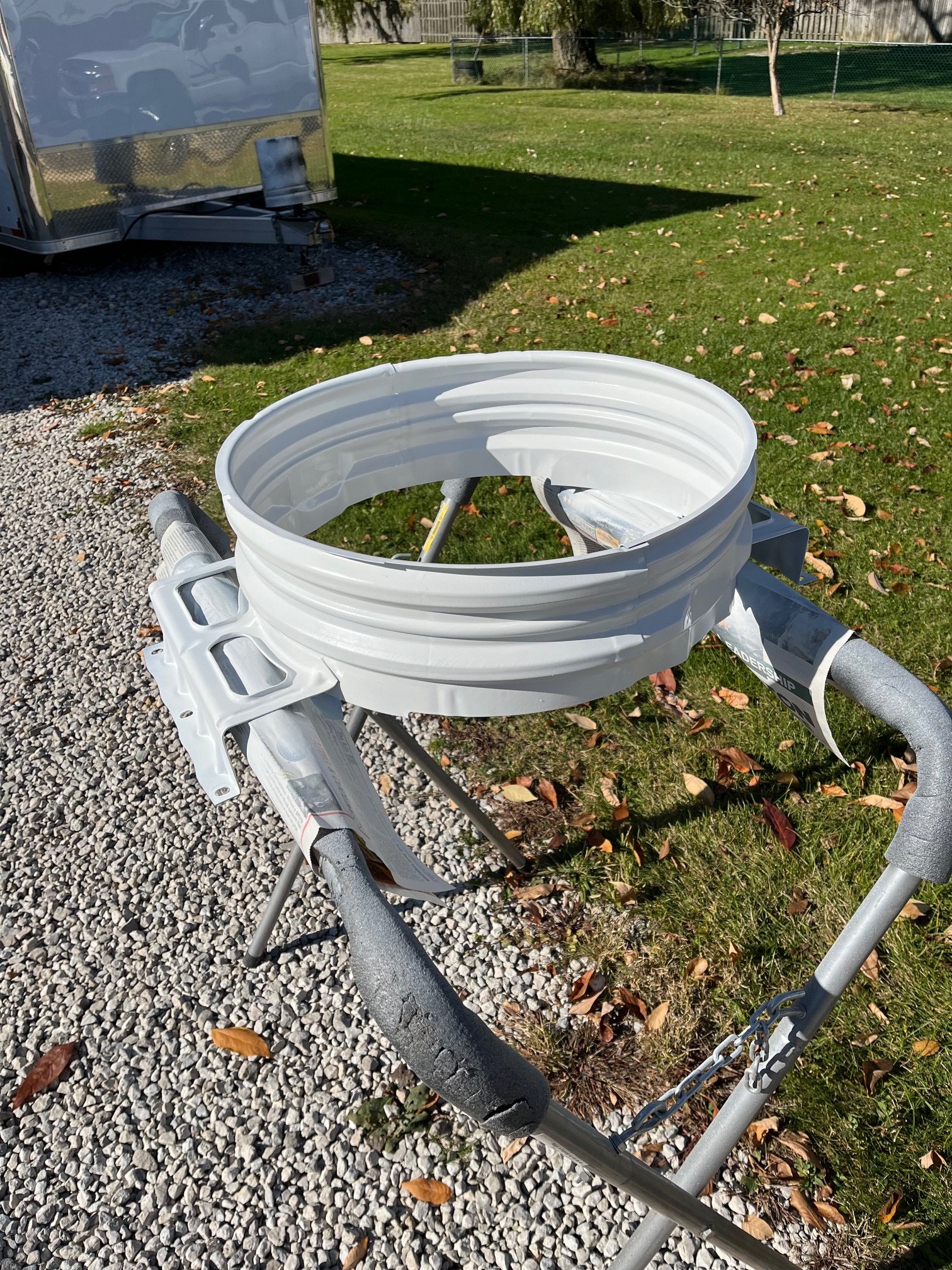

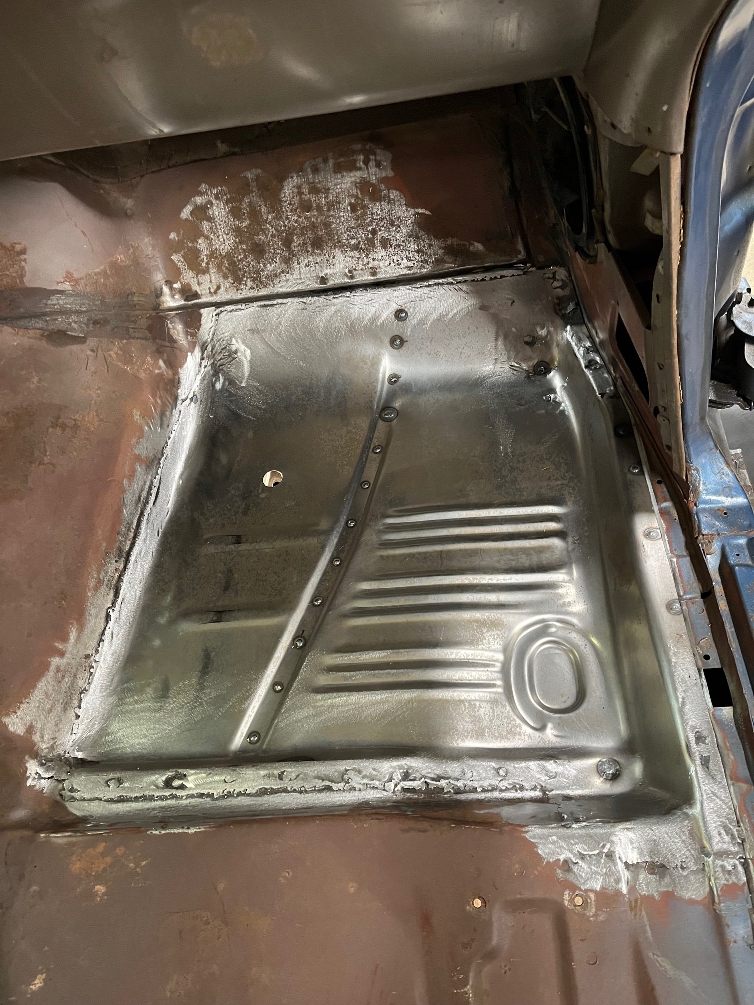

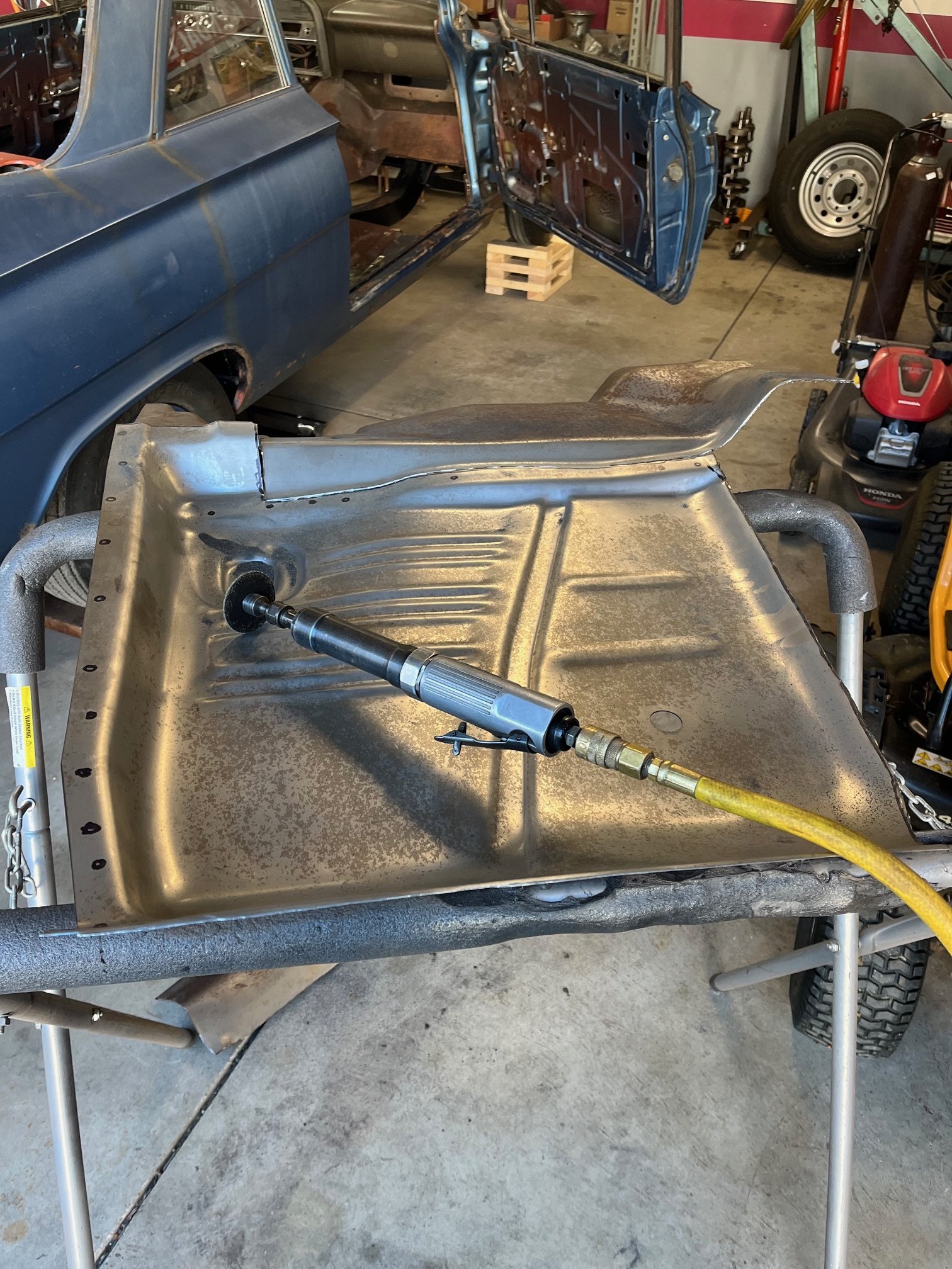

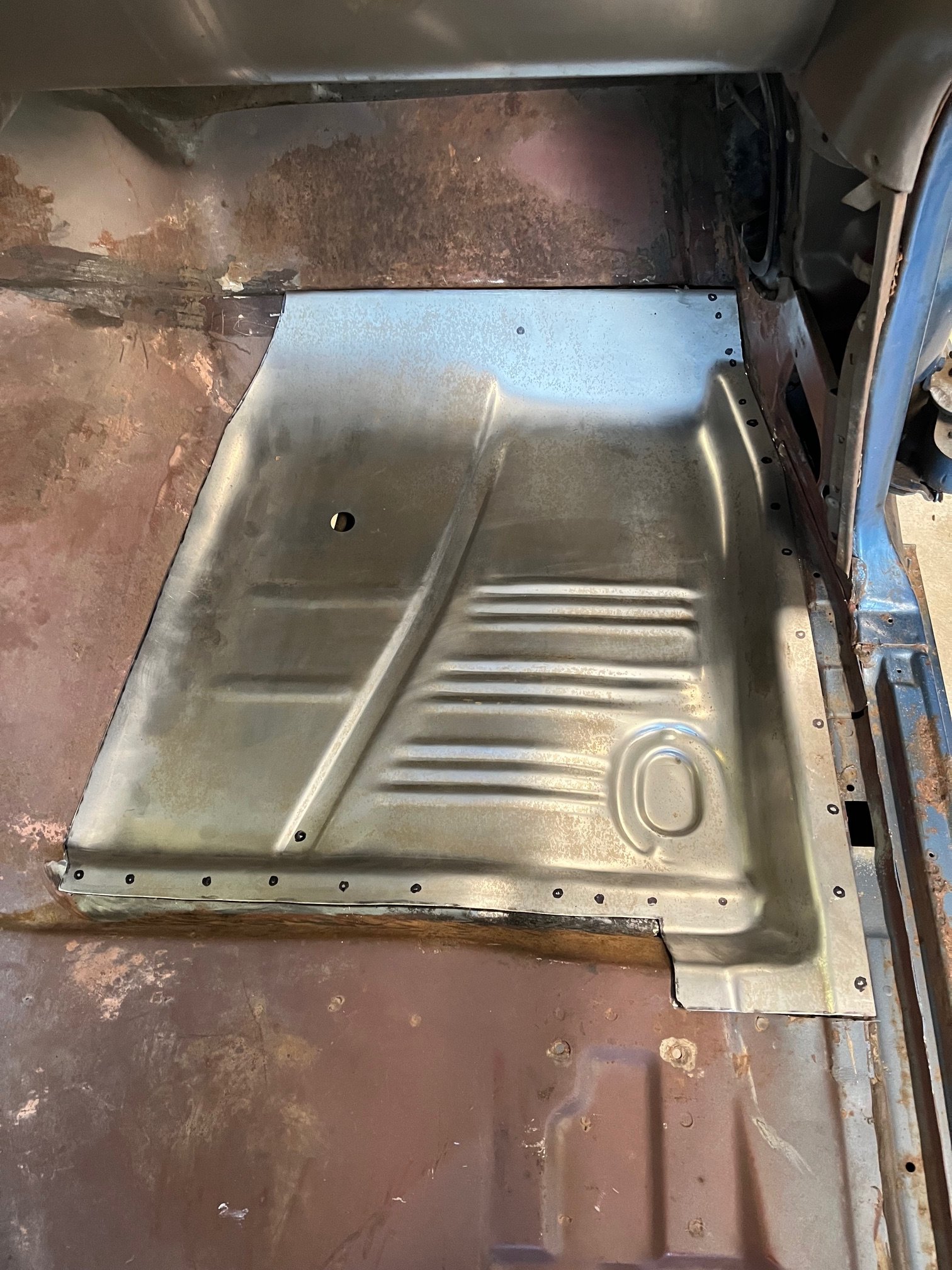

    I got the right front floor pan fitted. It doesn't look like a lot of progress but I've spent hours on it. One thing I've learned during this floor project is the better the fit, the easier it is to **** weld and the nicer it comes out. A little extra time here saves aggravation.
    I also got the core support and fan shroud in primer. I've had these parts back from the blaster since back in the spring. They went to the back of the shop and had been forgotten. Decided to get them in paint while it's still nice enough to paint outside.

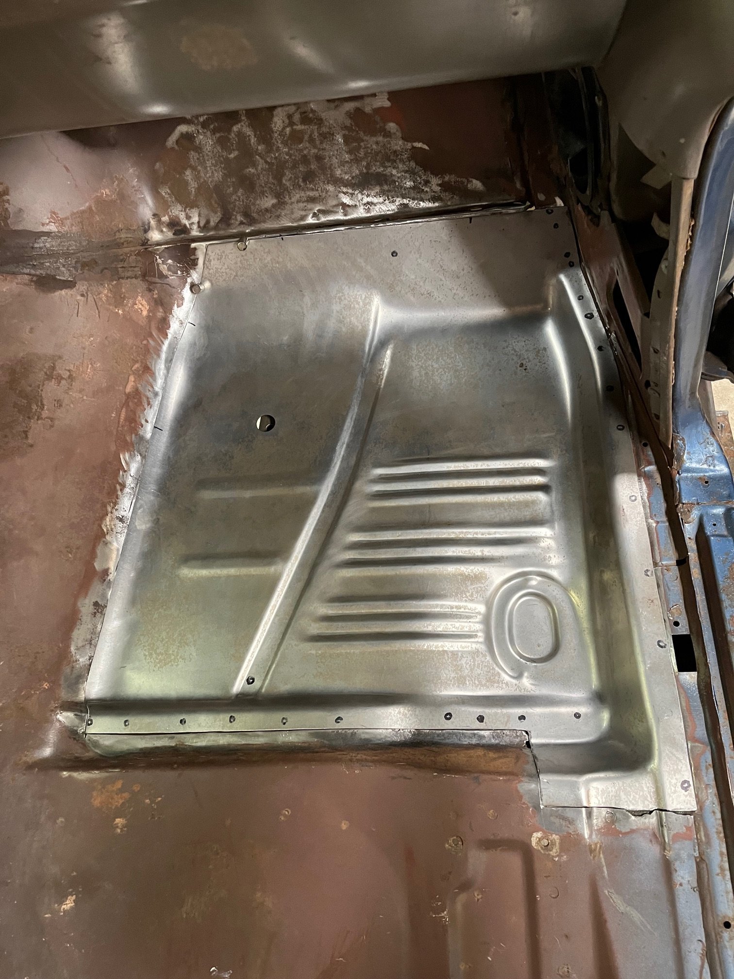

    Right front floor pan cleaned up, primed, and tacked in. Sprayed some rust encapsulator into the exposed area of the floor brace and painted the parts that I wont be able to get to after the pan is installed.
    No pics (cause it's kinda boring) but I changed the right door hinge pins and bushings. Not necessary at this point but the door would drop down, close like ****, and it was driving me crazyo_O. IMG_6503.jpg IMG_6505.jpg IMG_6511.jpg

    I didn't get much garage time this week but I did get the RF floor pan welded and cleaned up. Hoping to get the stiffener welded on this week and clean up and paint the bottom.

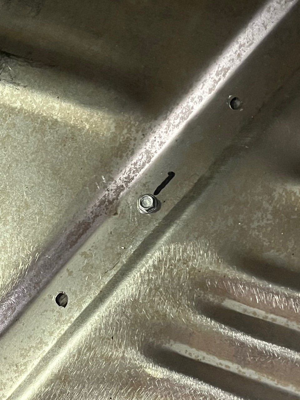

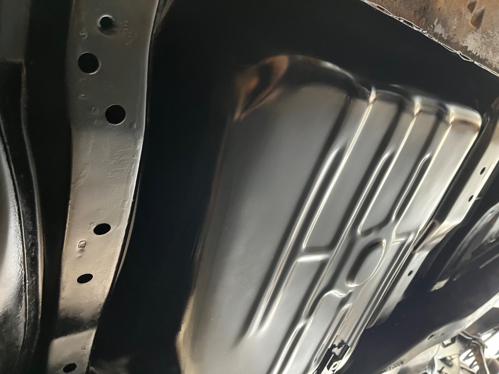

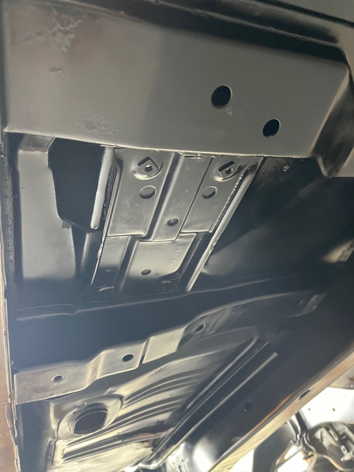

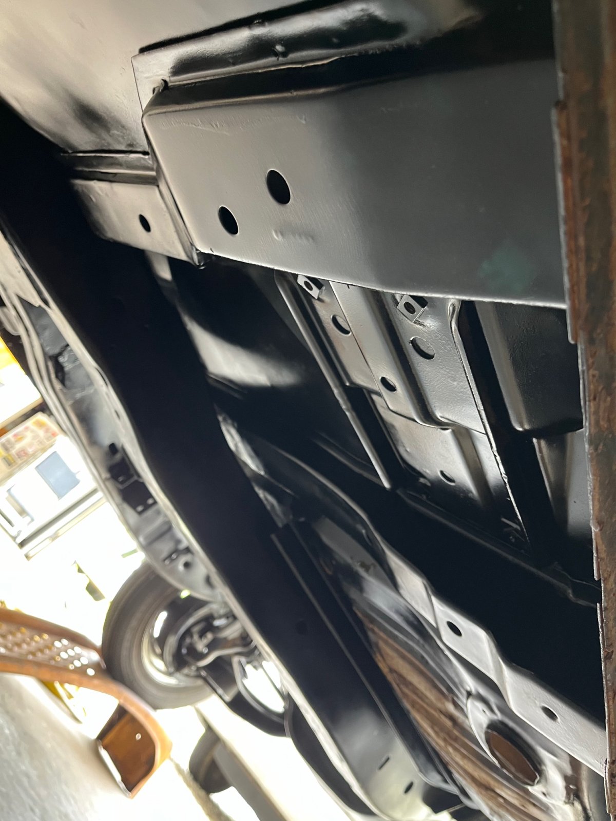

    I finally got the RF floor pan finished up. Cleaned up the **** weld underneath. Plug welded the stiffener with a couple self tappers holding it in place. Hit it with a coat of short strand fiber reinforced and then some gold. Got it painted.
    IMG_6551.jpg IMG_6547.jpg IMG_6554.jpg IMG_6556.jpg IMG_6559.jpg IMG_6566.jpg

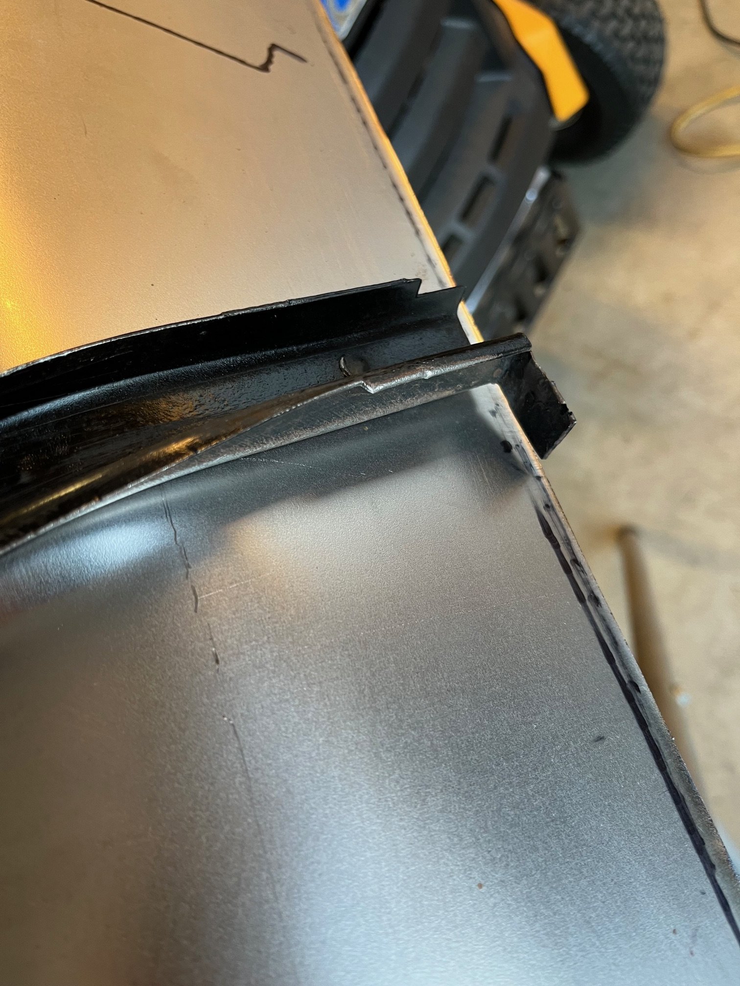

    I got the last floor patch roughed out and the contours and bends are way off and the panel is a little short length wise. Of course, the last part of the floor repair is not going to go down without a fight:mad:.
