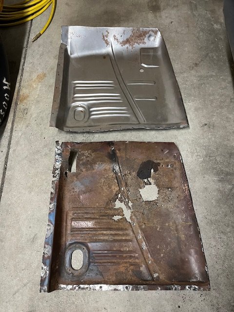

  5. Stock Racer
    Joined: Feb 28, 2010
    Posts: 1,364
    Stock Racer
    I'm back in business with a full tank.
    Finished the welding on the floor pans. Here is a before and after.

    After a few days off for cataract surgery, I got the last floor pan finished. My sheet metal welding skills are slowly improving. No pro job but I'm happy with the penetration on the backside. Got in some practice for the real body work and painting under the car is complete. For a hack job, I'm pretty happy with the outcome.
