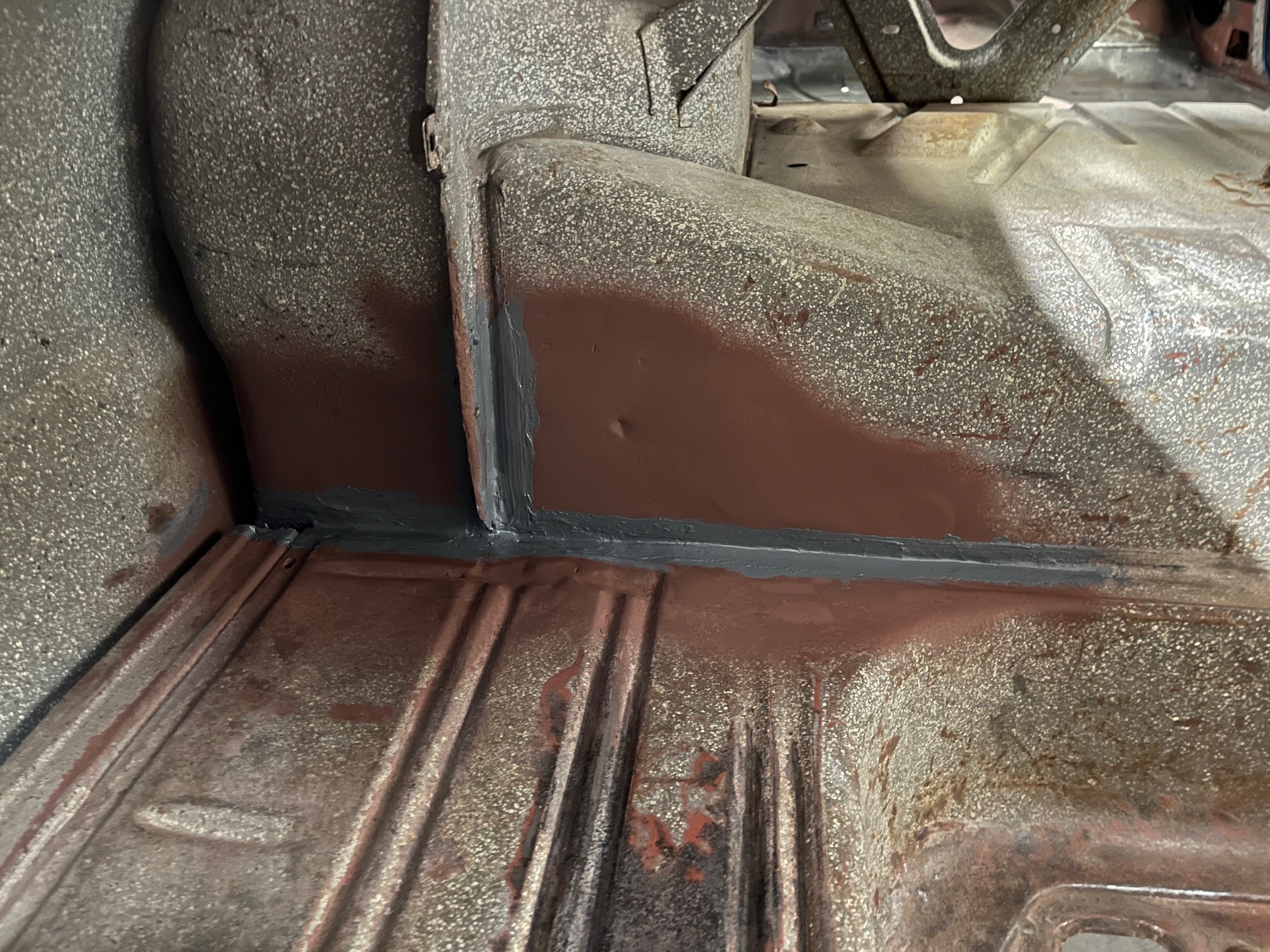

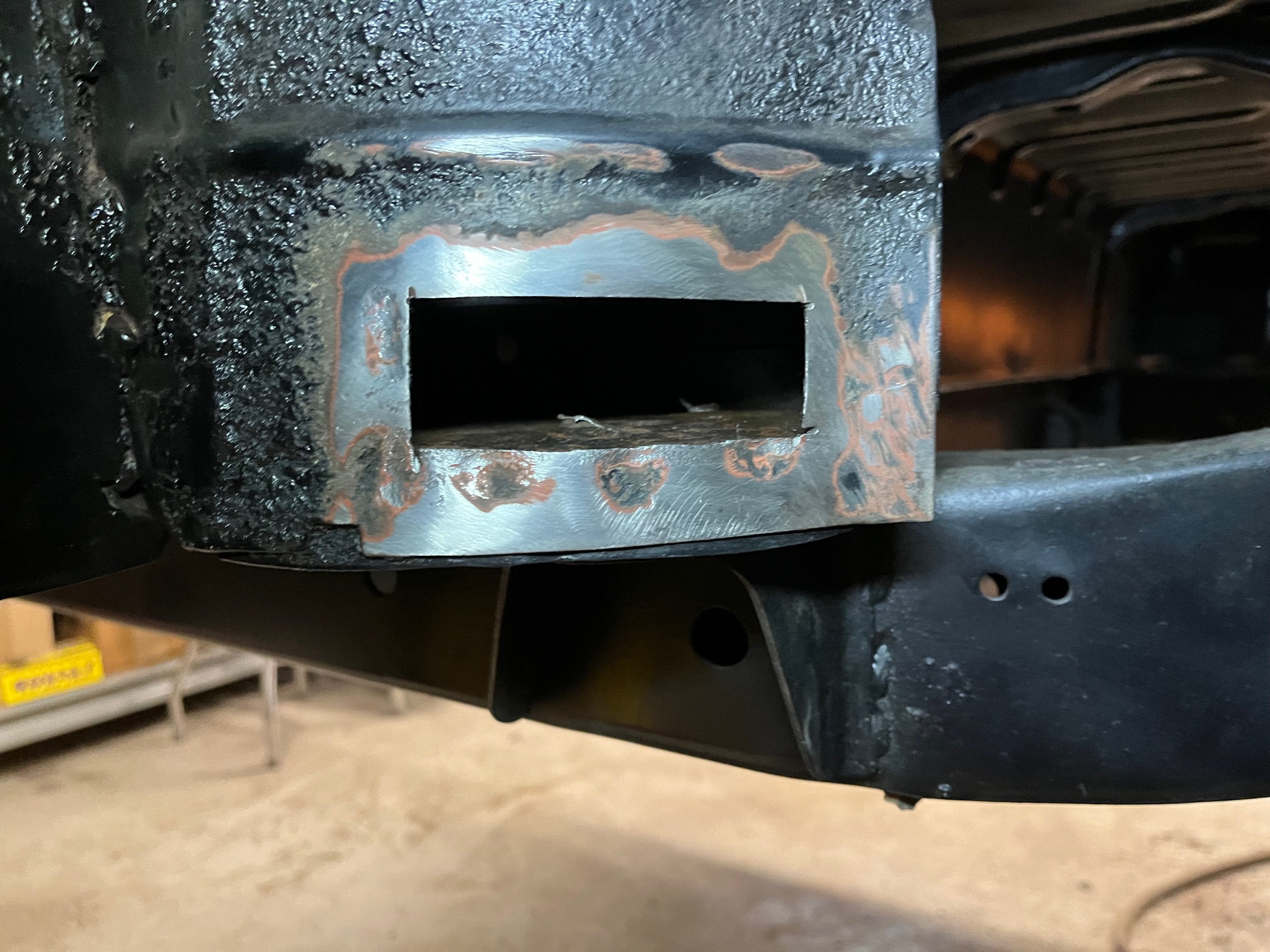

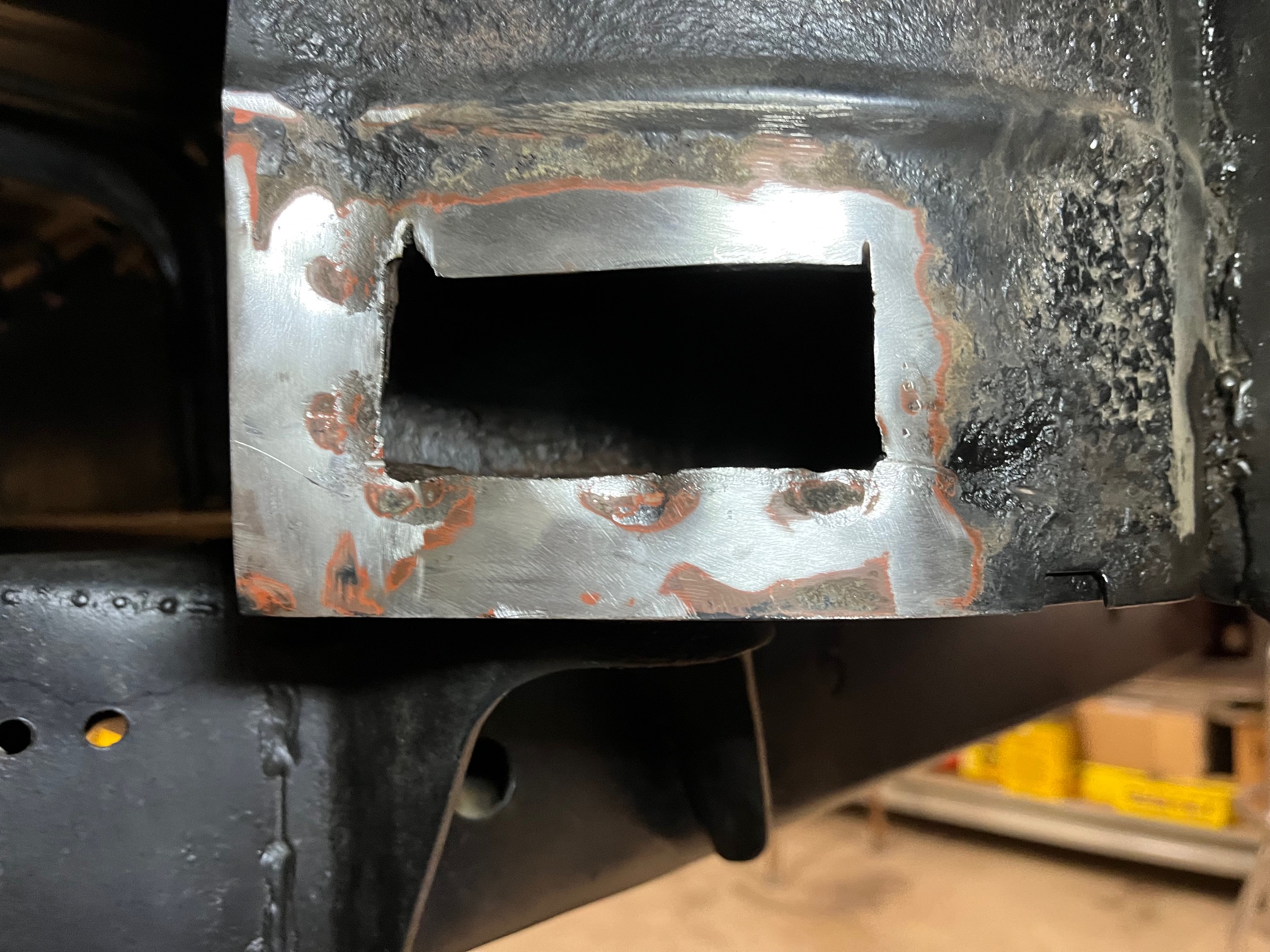

    Some before and after pics of the trunk repairs from underneath.

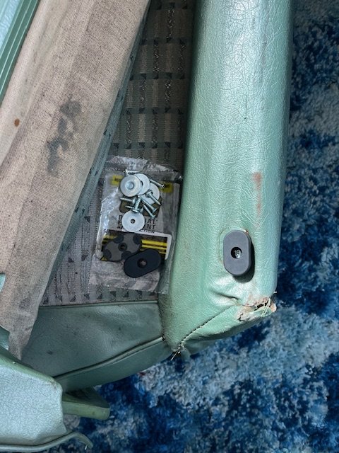

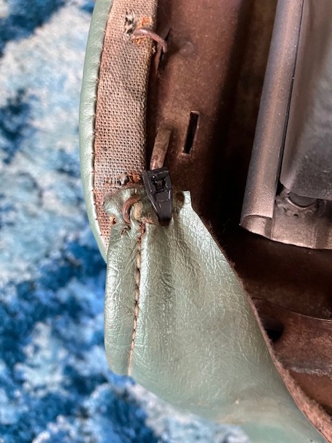

    Putting my FB Marketplace basket case of a seat together in preparation for the roll bar install.
    A few well placed zip ties secured the cover. Installed some repop rubber bumpers. I bolted the modified seat tracks on. I now have a mock-up seat.

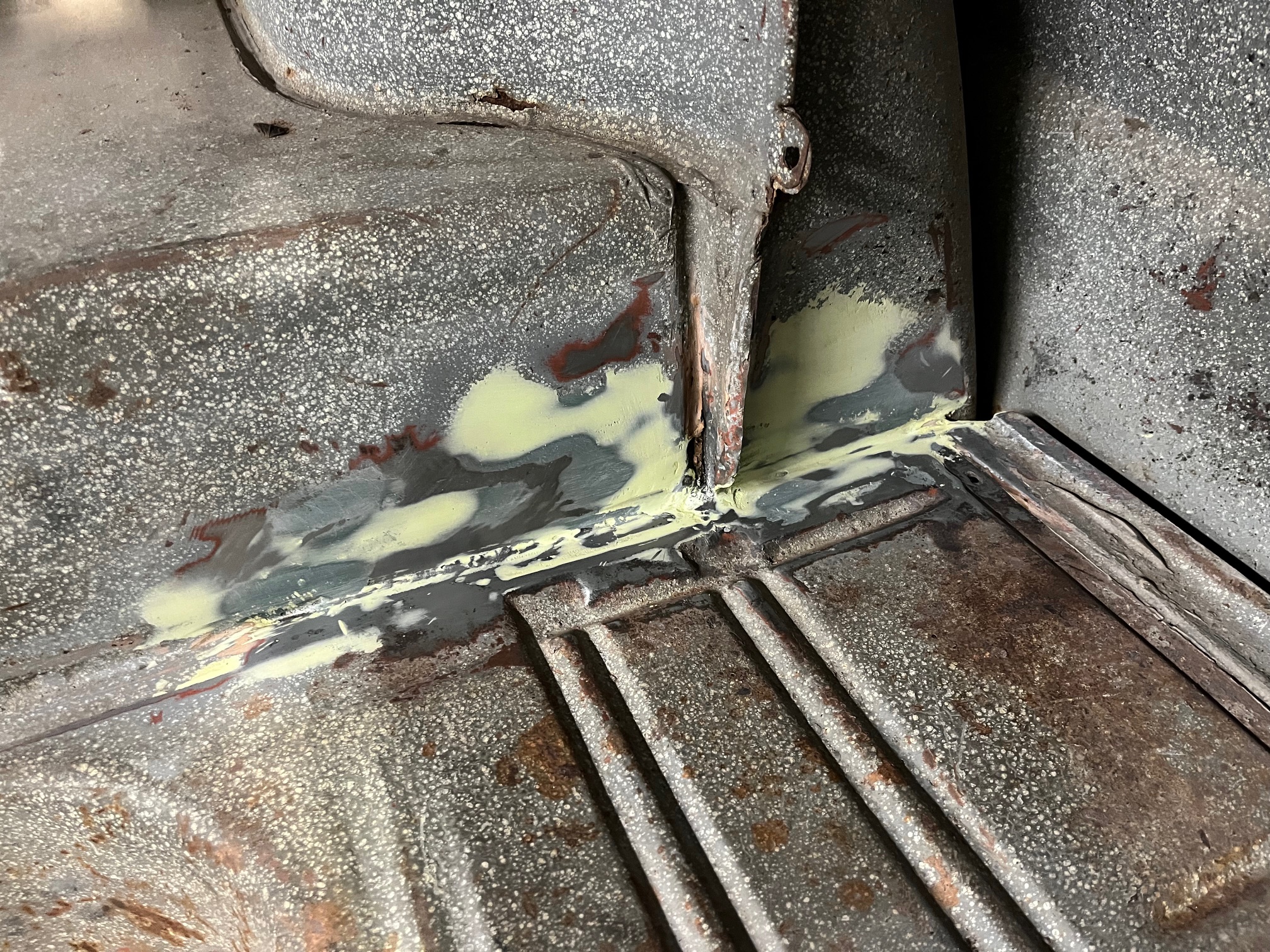

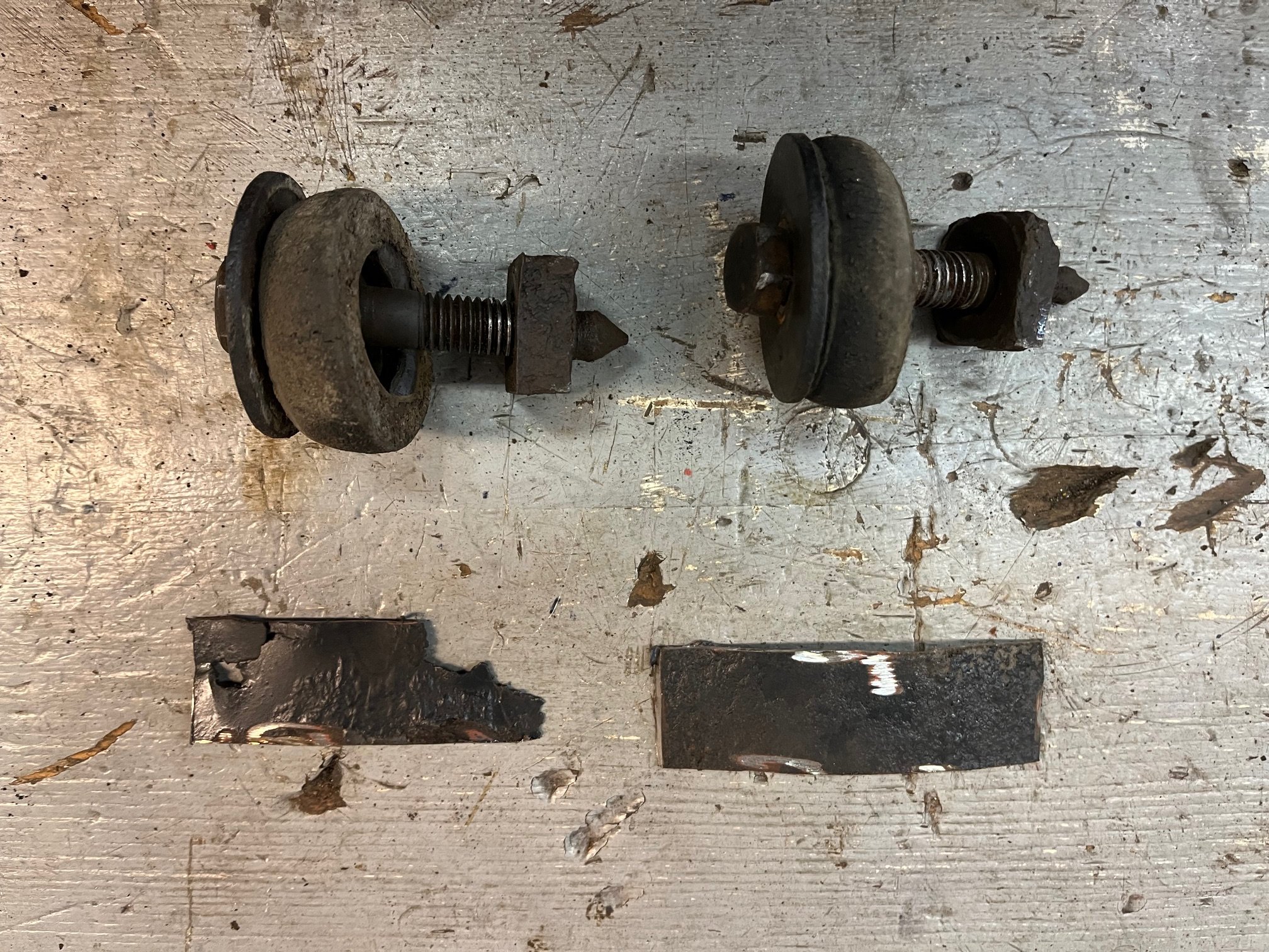

    Set out to install urethane body mounts. Six of the eight came loose but of course the two at the box mounts spun the cage nuts. More patching to do but the old mounts are out.

    I have a set of poly mounts for my 62 on the shelf and I've been avoiding installing them because I'm afraid of this exact thing.

    Yea, I was avoiding it myself but it wasn't that bad. Had the windows cut and the bolts/nuts out in less than an hour. I still have to figure out how to secure the nuts then patch the windows. Just an FYI, a 1" open end works to hold the nut.

    There is a hole and a seam that you can use as access to soak with penetrating oil. Let it sit a few days then gently hit it back and forth with an impact. If it starts to spin you can abandon the project and it will still be tight. Good luck.

    The body mount bushings are pretty much done after 63 years, so they need to be replaced one way or the other. I'll probably hit the end of the bolt with the air chisel to put some vibration through it too, see if that helps break it loose.

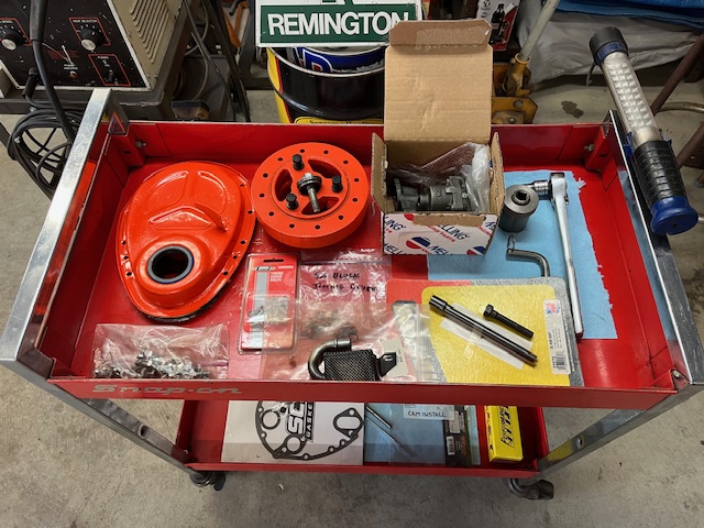

    Since the car will be at the ch***is shop for a while, I'm going to work on the engine and trans setup. I've been playing with this engine build off and on the last couple of years. I bought the large journal 327 block, 461 heads, timing cover, and balancer at a swap meet for $100. The engine is going to be a budget build, legal for NHRA Stock Eliminator but without the trick stuff and toned down for street use. The first pic is after I pulled the plugs and cam bearings before taking it to the machine shop. The second pic is when it came back cleaned, bored .030 over, and line honed. The decks checked out nice and straight so I did not deck the block (budget, lol).

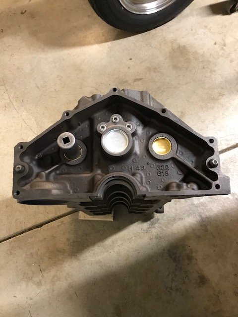

    After the block came back, I installed the cam bearings, tapped for and installed threaded oil galley plugs, installed the freeze plugs, and gave it a coat of good old chevy orange.

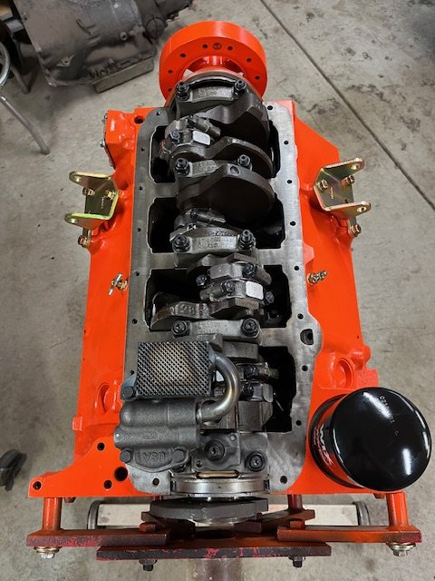

    I balanced the parts I could do myself, then sent the crank out. Must have been pretty close, only one small drill mark. Probably could have gotten by without doing the crank but you don't know until they chuck it up.

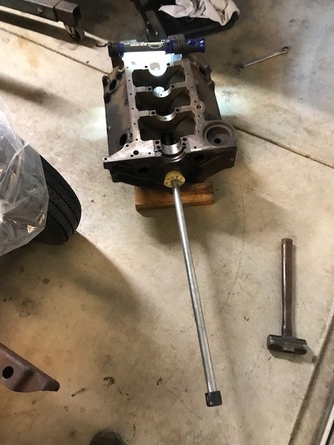

    The cast crankshaft was a $30 FB Marketplace score. It was sitting in the back of a body shop and had surface rust. It cleaned right up with 0000 steel wool. The machine shop I deal with said all the journals were dead center .010 and .010.
    I used a deck bridge to find true TDC.
    Degreed the Stock Eliminator legal cam (stock lift). If this was a serious Stocker engine it would have about 25 Degrees more duration on each side. I wanted to advance the cam 4 degree's but this timing set is an old hand me down from my race car and the one notch it had moved the cam 8 degrees so I installed it straight up (108 intake lobe center).

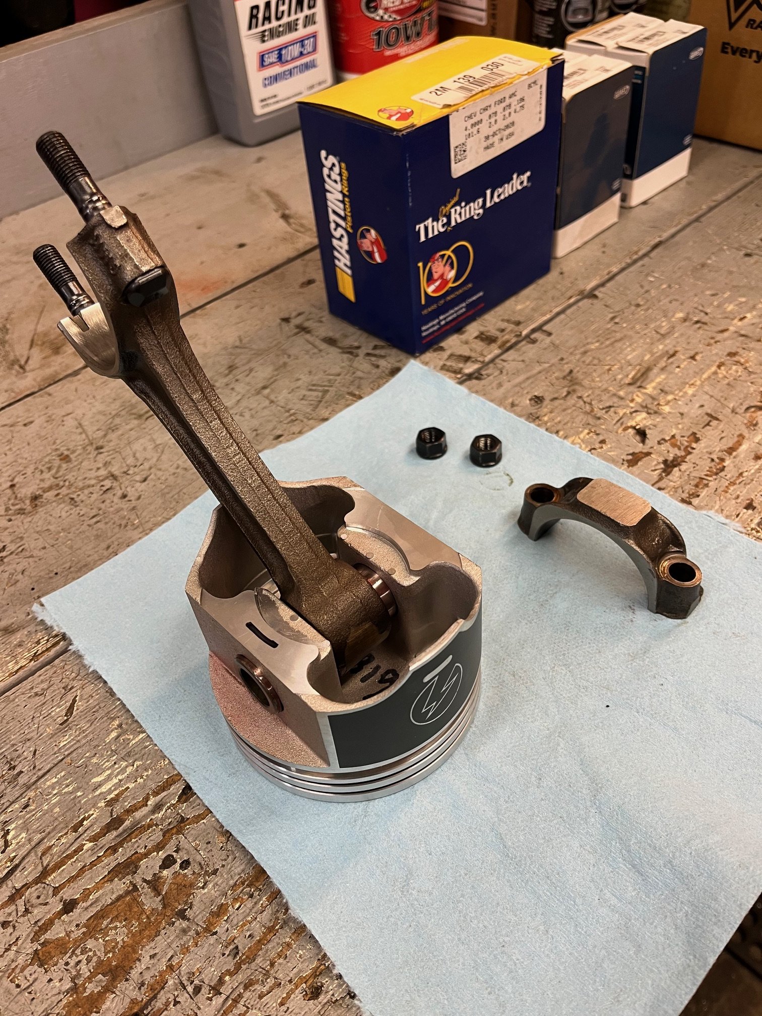

    Rings are inexpensive Hastings. Great quality, tight end gaps, and the top ring is moly. I would definitely use these again. Bearings are old reliable Clevite 77.
    Pistons are Sealed Power forged stock replacements. Rods are reconditioned Chevy with ARP bolts that are hand me downs from my first Stocker race engine.
