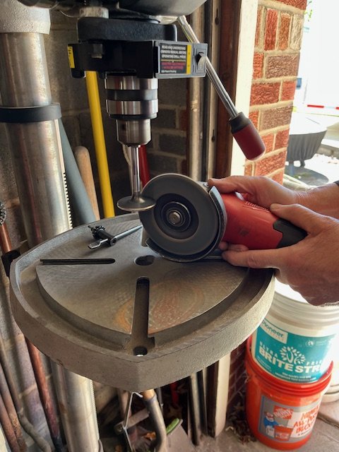

  7. Stock Racer
    Joined: Feb 28, 2010
    Posts: 1,364
    Stock Racer
    I don't have one. I'm going to try and borrow a friends to hit the seats.

  8. Stock Racer
    Posts: 1,364
    Stock Racer
    Nope, no porting or polishing in Stock. These are the valves I intend to use, they were just too big.

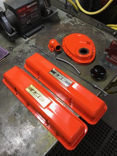

    It's been a week of family gatherings and property maintenance so there has not been much shop time. I was able to sneak in an hour here and an hour there to gl*** bead and paint a couple things. I don't want to start ***embling the heads until I can devote some time to it.
    Side panel metal strips.
    Valve covers, intake, and pulley's.
    swade41, brEad, enloe and 12 others like this.
  13. DDDenny
    Posts: 22,388
    Dig those 62 rocker covers!
    Stock Racer and 427 sleeper like this.
  14. Stock Racer
    Posts: 1,364
    Stock Racer
    They were a swap meet find. I trampled 3 or 4 people to get to them. I can't remember what I paid but it was very reasonable.
    Those are the original 327 tags and I was able to save them.
    I'm hoping I can use them but I'm not sure I'll be able to properly vent the engine (69 Block).
    enloe and Johnny Gee like this.
  15. DDDenny
    Posts: 22,388
    Yeah, I can't p*** up an opportunity to call them out as I have been a life long small block Chevy guy and didn't even know those one year only covers existed, stumbled onto an article where they showed the difference, funny, a lot of other people never knew either.

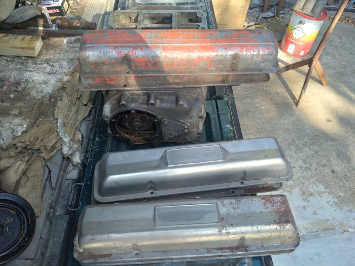

  16. Dick Stevens
    Joined: Aug 7, 2012
    Posts: 4,122
    Dick Stevens
    I don't remember if they were used in 62, but they are what came on my 63 Impala.
    Stock Racer likes this.
  17. Stock Racer
    Posts: 1,364
    Stock Racer
    I've been told this style was used in 1962 and very early 1963 only.
    427 sleeper likes this.
  18. Dick Stevens
    Joined: Aug 7, 2012
    Posts: 4,122
    Dick Stevens
    Whoever told you this was wrong, my 63 was built in July 1963 and these are the valve covers it came with!
  19. 427 sleeper
    Joined: Mar 8, 2017
    Posts: 3,366
    427 sleeper
    The "style" of valve cover is the same. The difference is the lack of the gusset's on the short side of the center rectangle, which is known to be 62 and very early 63 production only. Later versions had the gusset's stamped in on the short side's. I know... just more "Chevy Geek" stuff that doesn't really matter to the rest of normal people. ;)
    INVISIBLEKID, Stock Racer and SS327 like this.
  20. saltflats
    Joined: Aug 14, 2007
    Posts: 13,572
    saltflats
    from Missouri
  21. Stock Racer
    Posts: 1,364
    Stock Racer
    Yep, and James' picture tells the story.
    saltflats and 427 sleeper like this.
