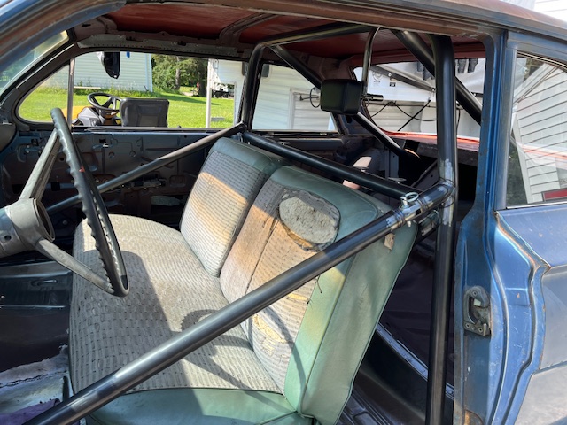

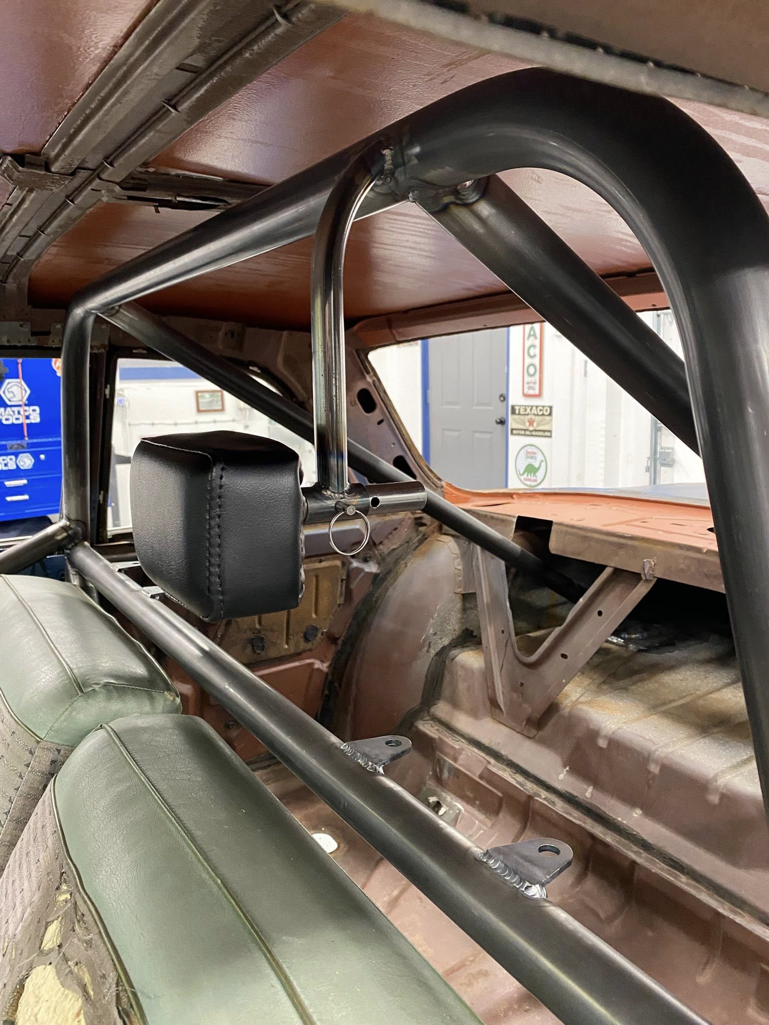

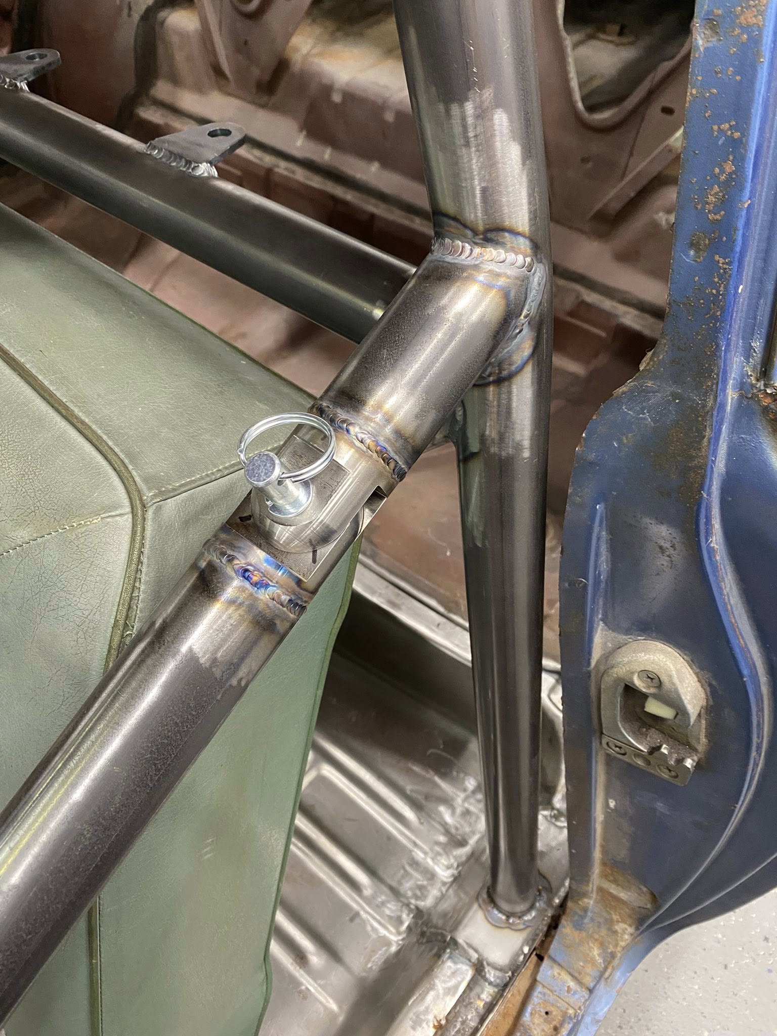

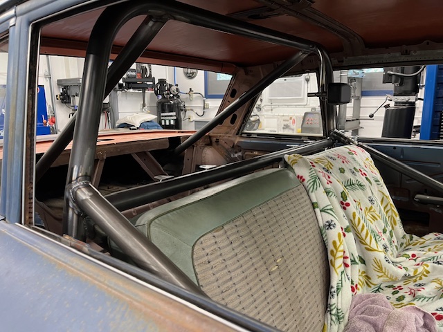

    Car is back from the ch***is shop. Here's some pics of the chrome moly 8-point roll bar with a swing out side bar. We used an S&W kit which I would not recommend. The bars didn't locate where we wanted them so we ended up buying more tubing. The head rest is required to be NHRA legal with a bench seat.

    Don’t you need a brace for the back of the seat? Had to have one for my Nova when I was racing stock.

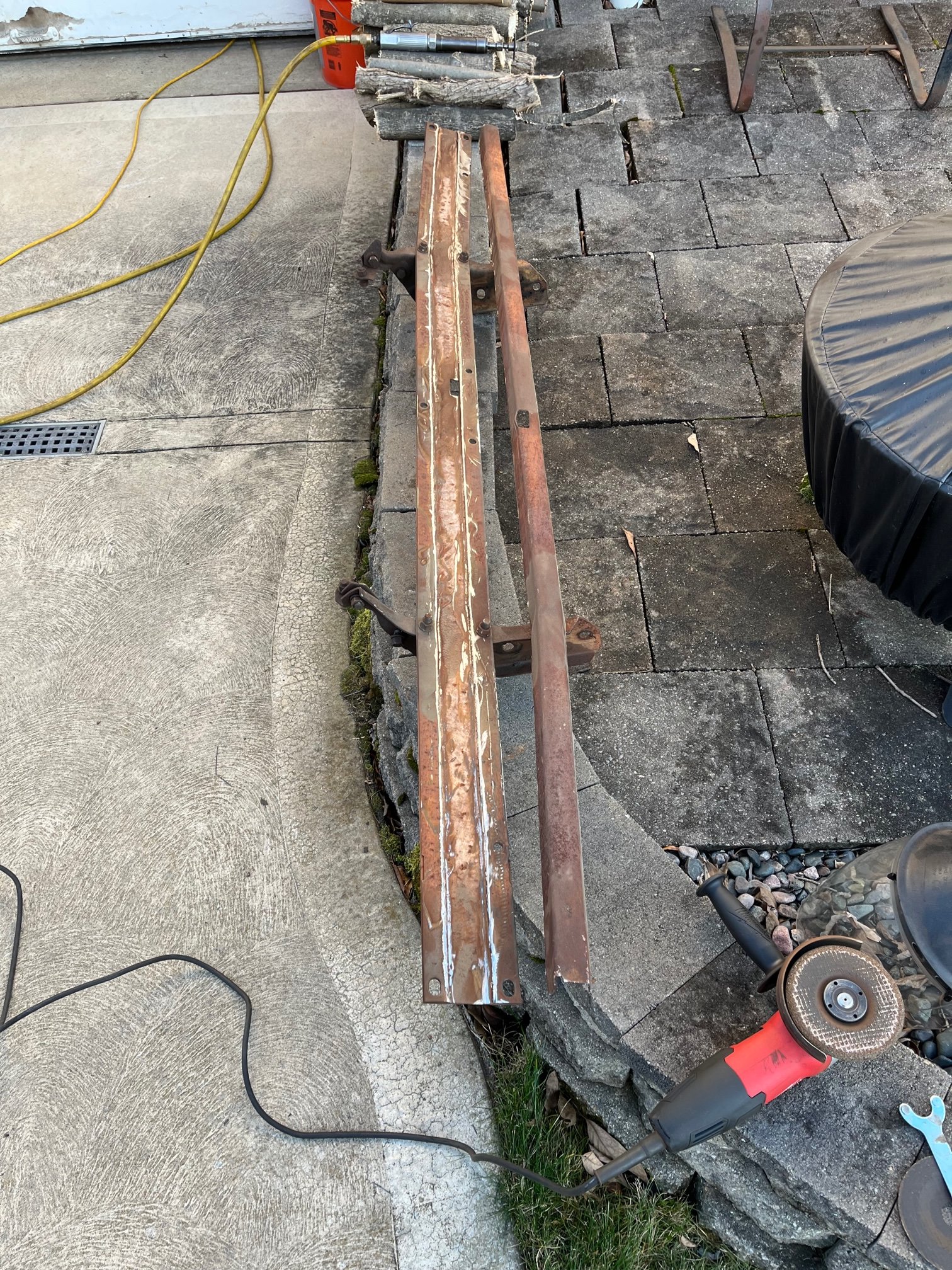

    Yea, I'm figuring 100 lbs for both bumpers. I like where the rear one puts the weight. I'm trying to figure out how to coble on the front and still be Stock Eliminator legal, lol.
  24. Stock Racer
    Joined: Feb 28, 2010
    Posts: 1,369
    Stock Racer
    So far I've chopped the channel off of the reinforcement. Trying to figure out where I can put the hole saw to work where it can't be seen, lol.
