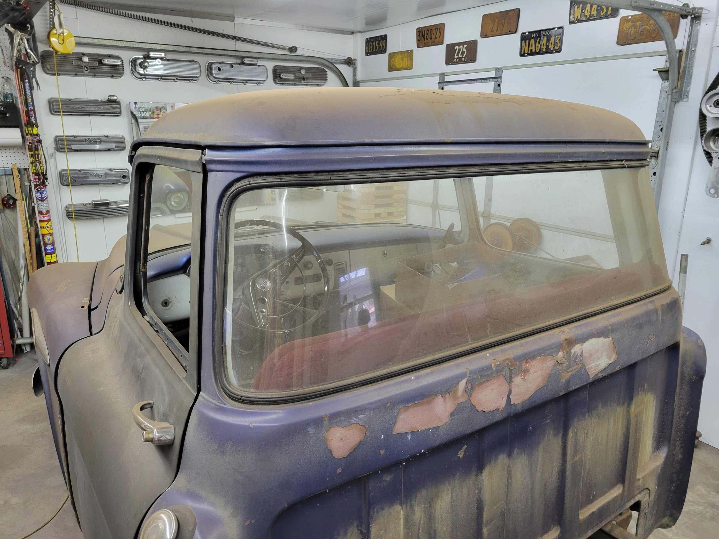

    I just went back through the whole thread, you've did a heck of a lot of work on this car.
    On my current 57 pickup project I'm getting ready to start cleaning the front half of the frame and under the cab. Just curious if you wanted to come do it for me. Lol
    And everything covered in dirt. Lol
