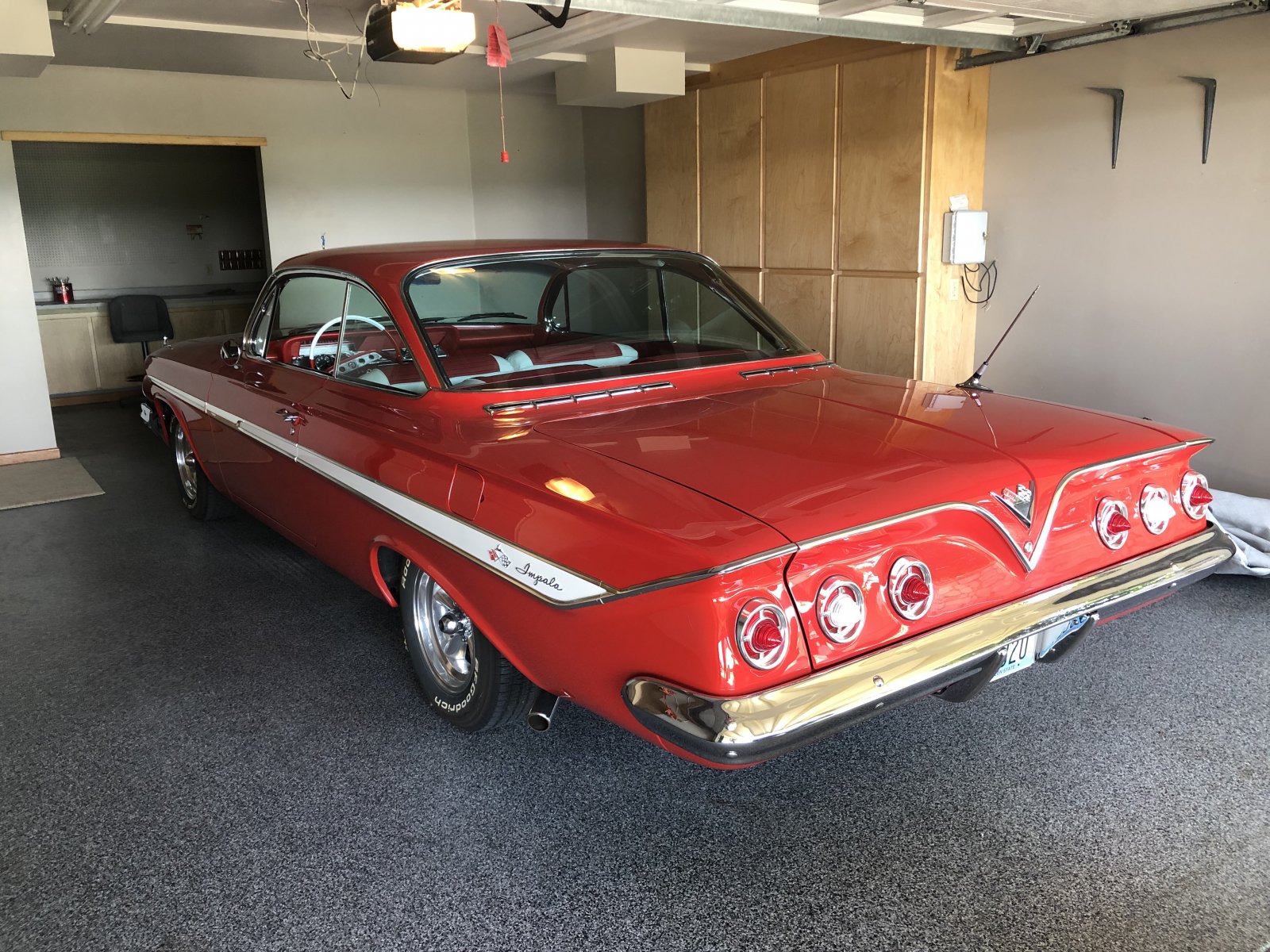

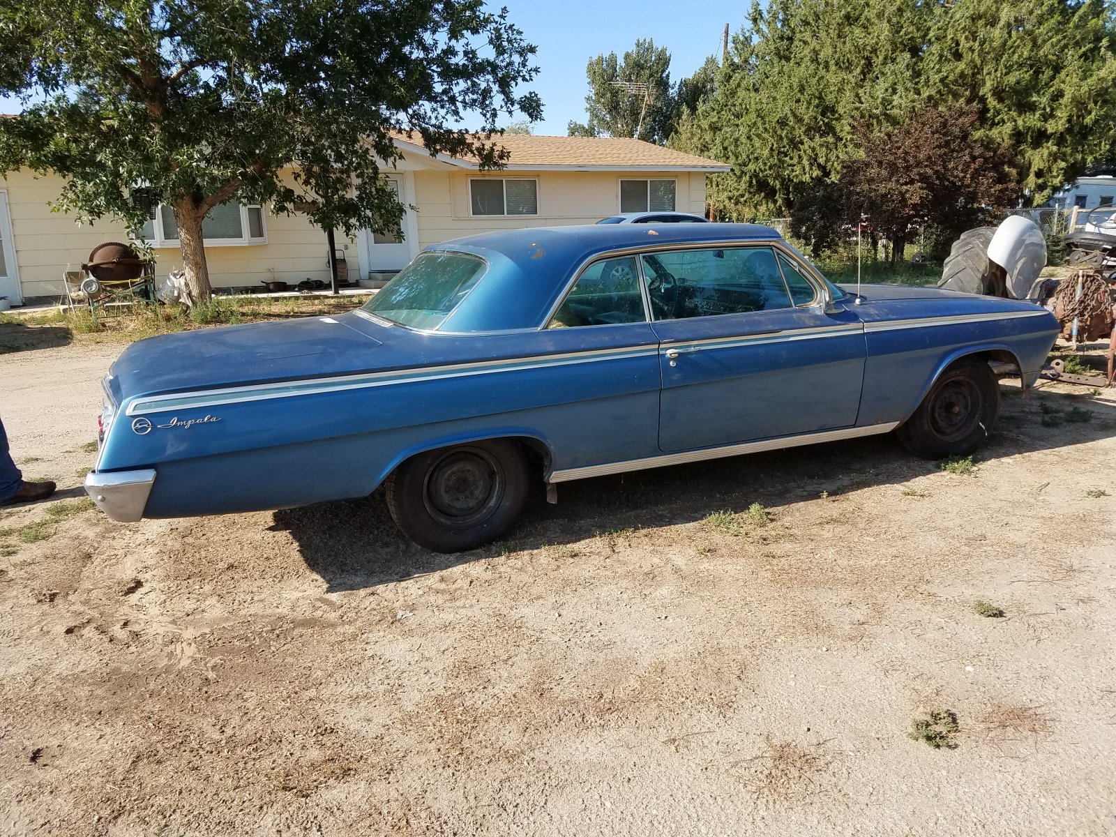

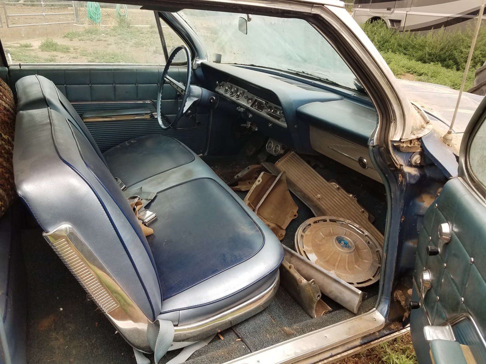

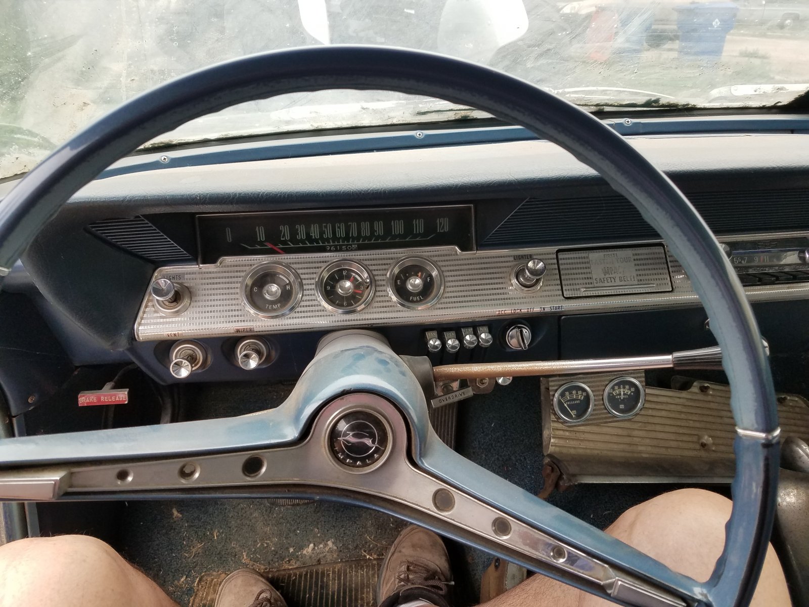

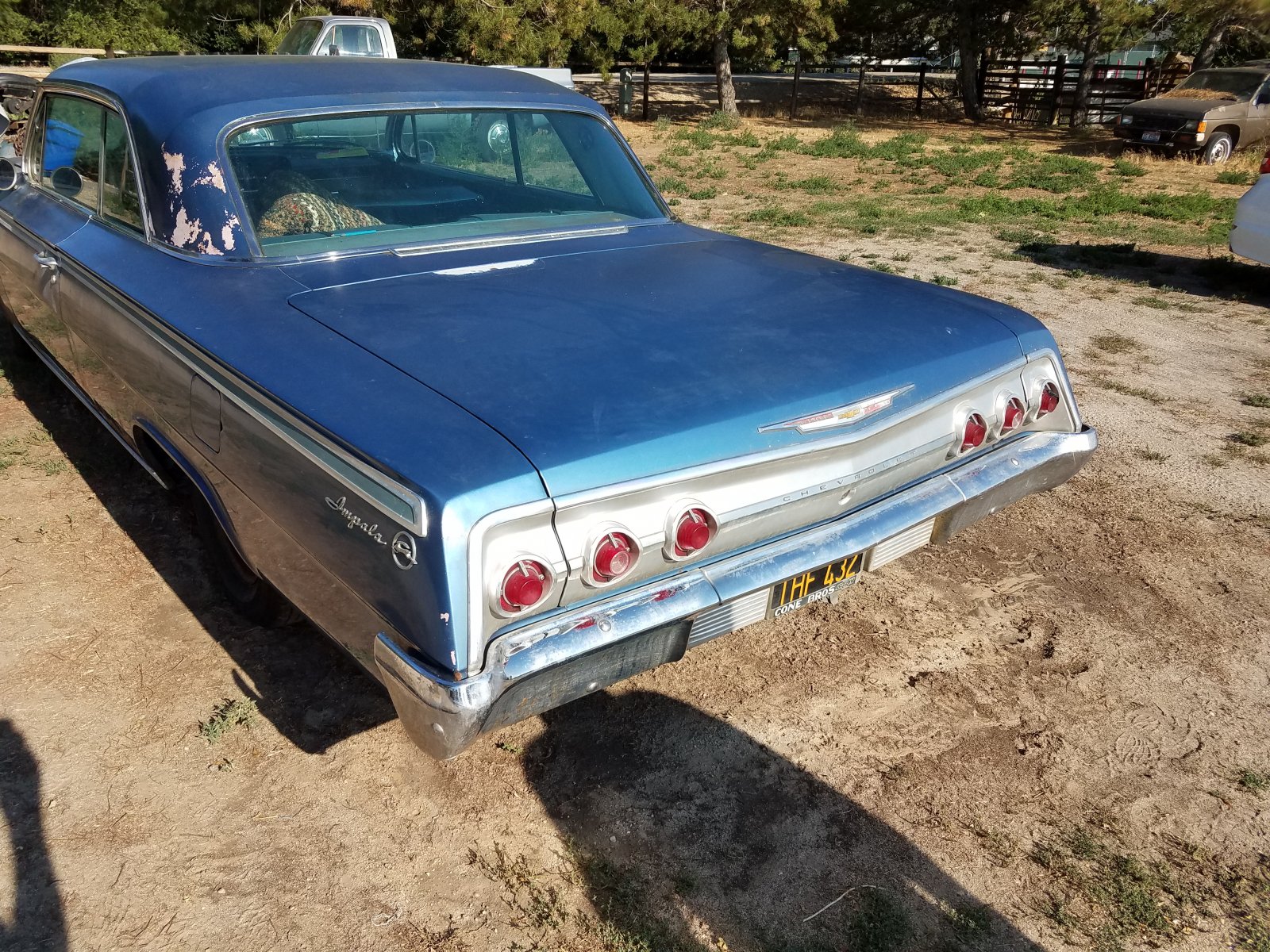

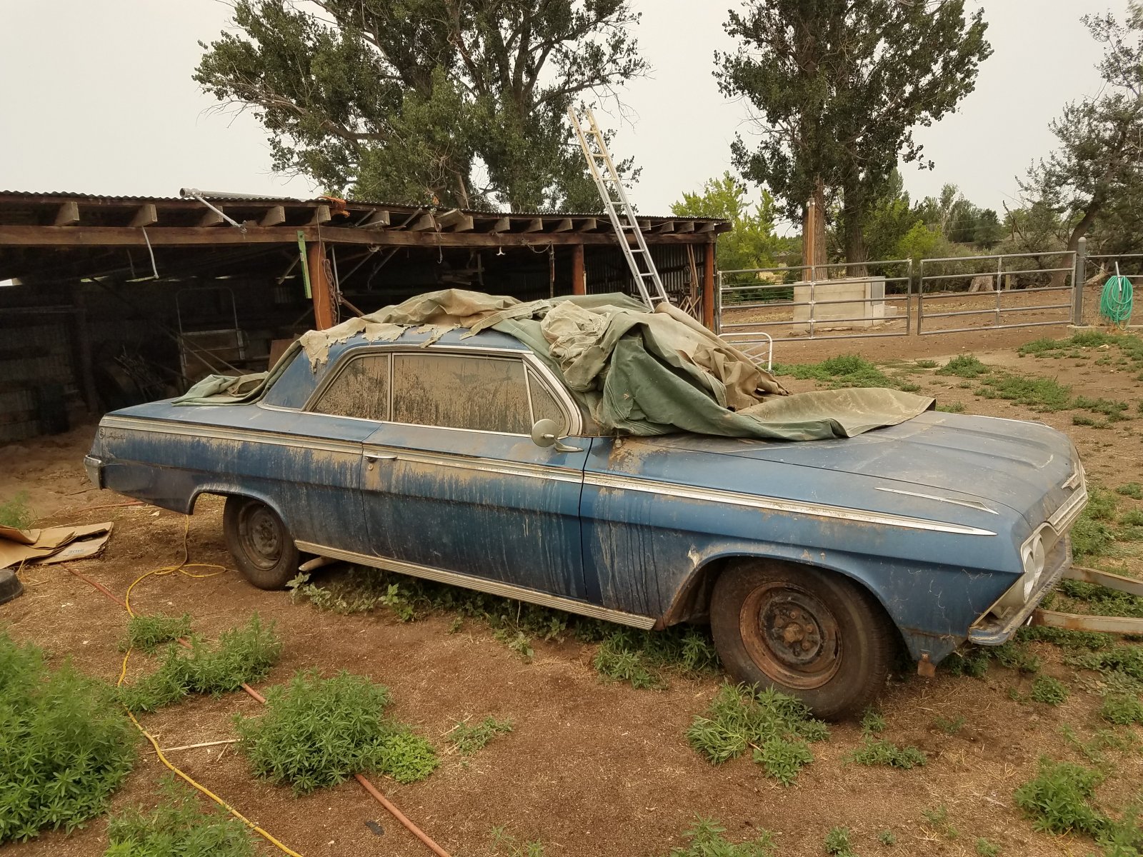

    Life has it's funny twists and turns. I had a call from my pal "Big ****" last night, and he wants me to come take away his old car. I met **** at a racer's club breakfast a couple years back, when he came to our table and asked if I was familiar with a 6-cyl that had 12 ports. Now that's a whole 'nuther story. I went to his house, which is on a farm, and there sits, covered with a "tarpaulin", this '62 Impala. He ordered it new, with a 6-cyl/3-spdOD. Rather rare in itself.... He parked it where it was sitting in 1976, after towing it from SoCal to Idaho, and literally had not uncovered it since. I pulled back that tarp, which most people don't remember, and I had forgotten, just how heavy they are. Anyway, I opened the drivers door expecting to get knocked over by the smell. Surprise !!!! No bad smell, only the smell of naugahyde.... The inside was not ever dusty. The doors open and close like a new car. The headliner is perfect, and the seats are fine, as they had been recovered. The carpet is dirty from use, as **** is a car guy. Some may remember my thread, "I met a guy".... Anyway, **** called me last night to tell me the car was mine... I have been told that I offered too much, but sometimes when you think the critter will go another direction, like to a non-gearhead son, you make an offer that opens the peepers.....
    Lemme know some thoughts.
    Did I mention.... No rust underneath. Dealer undercoated. Very minimal rust on the body....
    Now the same question..... 6-cyl or nice 327/4-spd.....

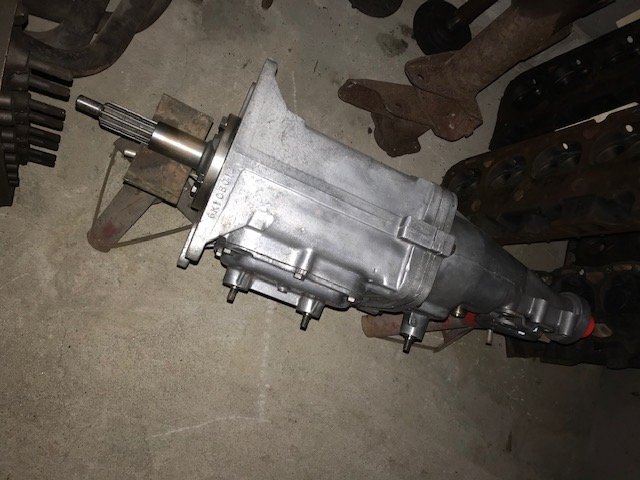

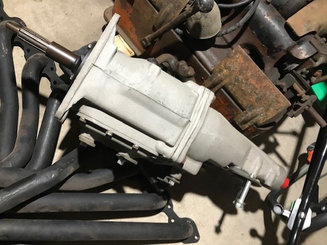

    Yea, she's a solid builder but it needs floor work. I have a Muncie, a T-10, and a T-350 with a sporty little 9" converter. Stay tuned!, I have a plan.

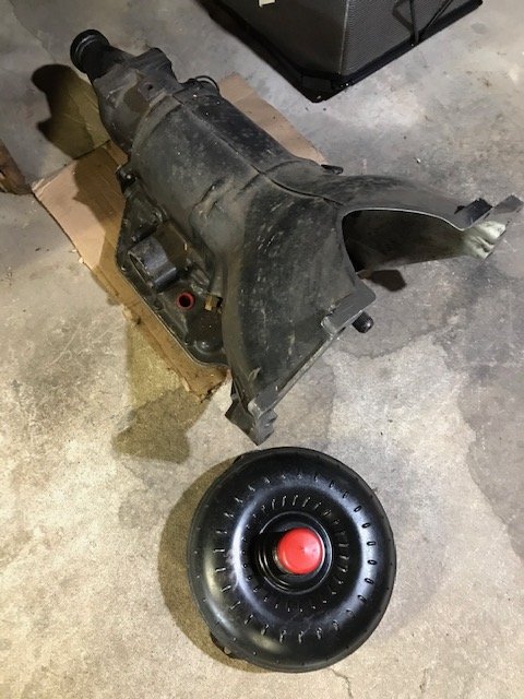

    What is the deal with the window in the top of the bell housing of the th350? I’ve never seen that before. Use the 4 speed with the biggest counter shaft! That’s the weak spot!

    In the Race Car environment the cutout helps cool the convertor which helps fluid life and consistency. It also enables removal of the converter bolts from the top.
