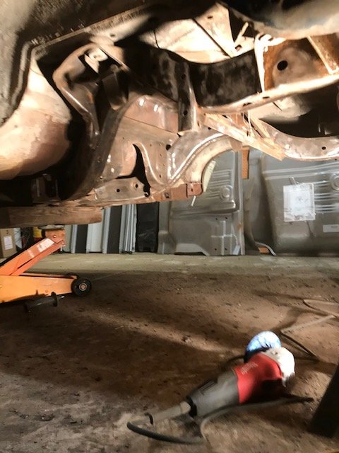

    Nothing cool to report but here's the latest. Didn't get anything done over the weekend as The Cleveland Piston Powered Autorama was in town. After 2 years of no show, I would have slept there if they would have let me.
    The back half is cleaned up and ready for paint. What looks like rust is nice clean red oxide. There may be other builds in my future but I will never do this part again, lol :). My shop is a mess and this was much easier when I was young.

    Man, your garage floor is a mess. You better clean it.
    RustyDogg, enloe and Stock Racer like this.
  7. HA! When I try to get into the house looking like that my wife tells me to go out in the garage and change my clothes:eek::):)

    The thing about grinding is no one offers to help! I can almost ''taste'' the grit when looking at those pics.

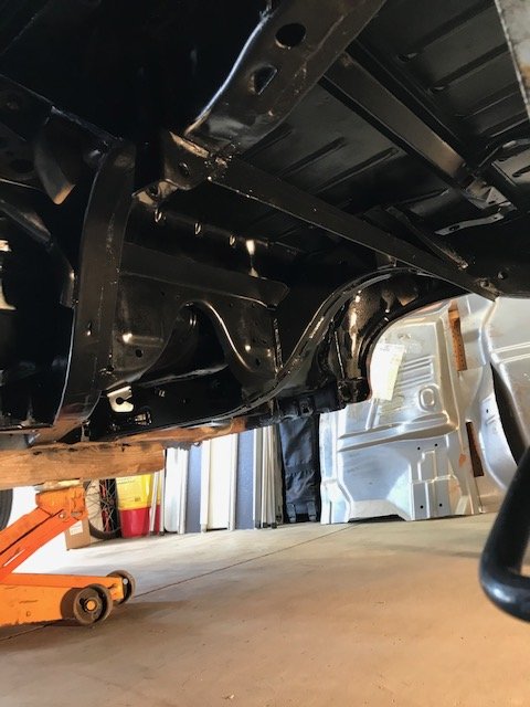

  19. Stock Racer
    Joined: Feb 28, 2010
    Posts: 1,308
    Stock Racer
    enloe likes this.

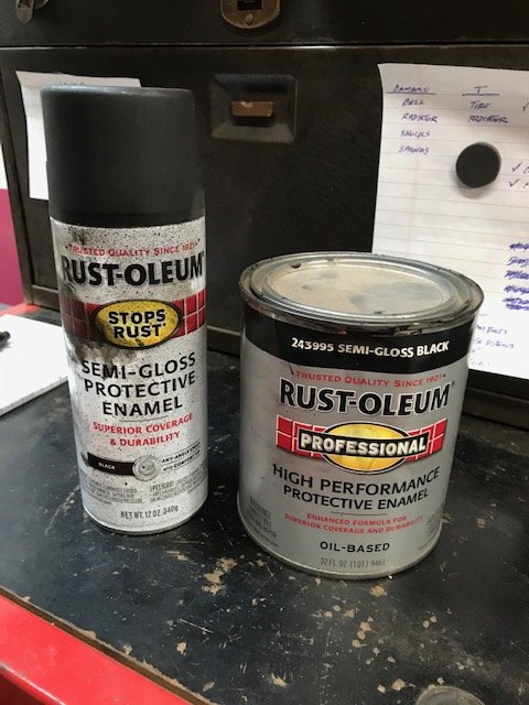

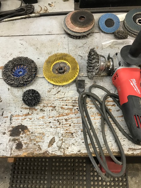

    Been thru this one before. I bought an off brand multi speed paint buffer with 5/8 arbor and ran wire wheel meant for a bench grinder. The variable speed kept the wire wheel from flying apart versus an angle grinder. Was able to knock out large sections with wide wire wheels.
    One hang up on an edge with the angle grinder and it'll come back and bite ya.

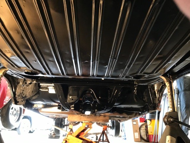

  23. Underside looks great! So tell us more...brushed, rolled, sprayed? Por15, Urethane, Rustoleom?
    Stock Racer and SS327 like this.
  24. Stock Racer
    Posts: 1,308
    Stock Racer
    Thanks for the tip. You're right, the speed of the angle grinder is too fast. Kinda out of control at times, And I did lose some skin. I looked at my buffer but I couldn't figure out how to attach the wheels. Gonna have to look for an arbor.
  25. Stock Racer
    Posts: 1,308
    Stock Racer
    Thanks and yea, I guess I shoulda shared that. Stripper Wheels (Left in pic) worked great on rust but they didn't last very long. A wire cup brush was used on everything else. The bristle disc was expensive and not very effective.
    There are a ton of new coatings out there but over the years I've learned to stick with what works, good old Rust-oleum. I started with a brush out of a quart can. It was slow going and hard to get into the corners. Spray bombs were the answer. 5 cans later and the back half was done. I did my Race Car with Rust-oleum in 2008 and it has held up well. IMG_3962.jpg IMG_3963.jpg
