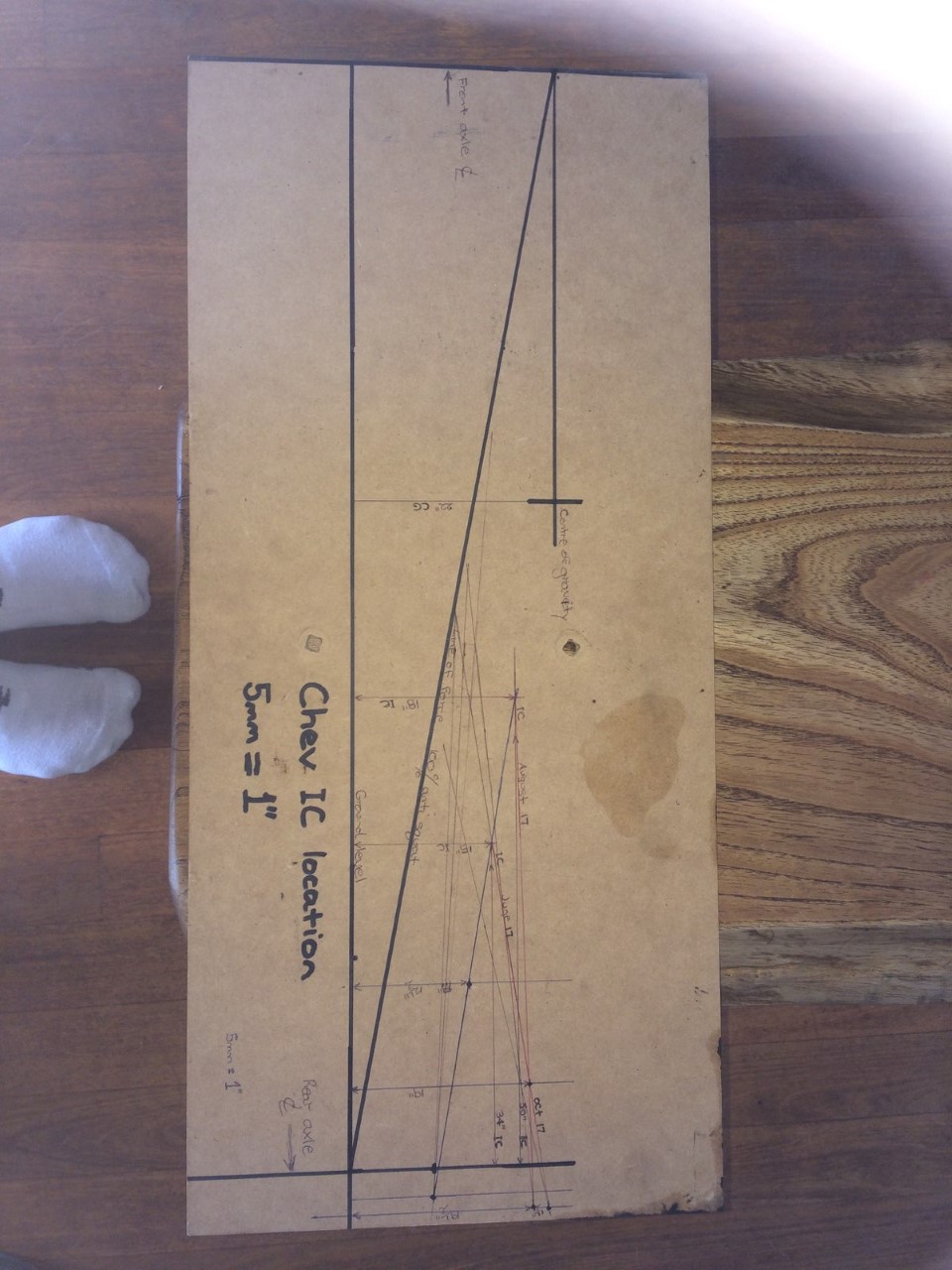

    Here's a little mapping of the rear trailing arms for better forward bite.

    Thanks! This car is going to have three lives or stages if you will. This info will come in handy for stage two

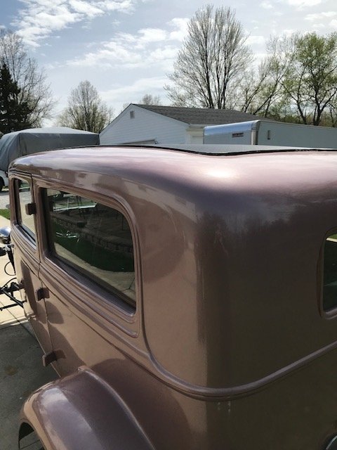

    Well Guys, I got sidetracked by a 32 Plymouth Sedan. Last thing I needed was another car but it was a deal I couldn't p*** up. It's a great base to work with but someone got ahold of it in the 80's. Fortunately it can be brought back to the 60's with mostly bolt-ons. I started a thread on taking her back to the 60's. Picture is about all I can show you for now. Color looks like 57 Chevy Dusty Rose.

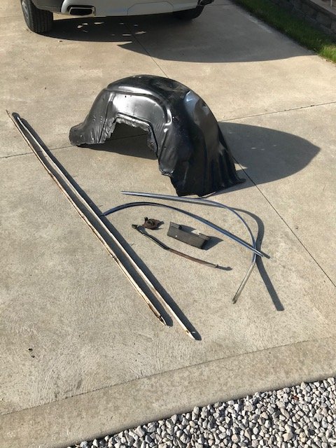

    Not much to report on the Biscayne. I've been busy working on my 32 Plymouth and my other projects. I did make some progress. I got a lead and scored some hard to find Rocker Molding's and the RF Inner Fender that I've been looking for forever. The moldings aren't great but they can be worked (another project:)). I know they repop the inner fenders but I really wanted OE and this one is nice.
