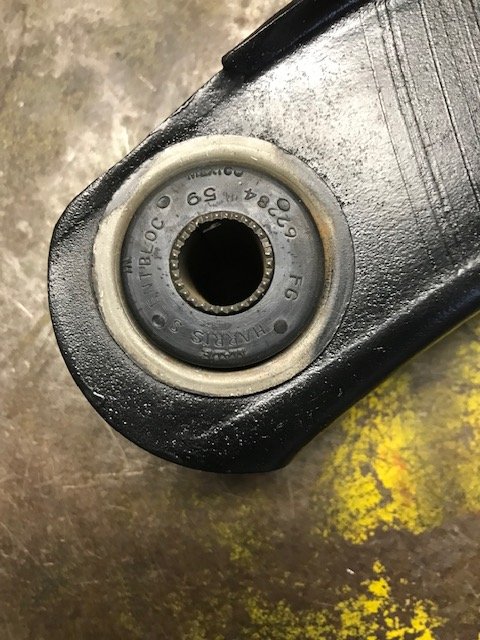

    Did an old school mod to the upper control arm bushings. The key is to keep the suspension loose and free and use an adjustable shock to control compression and rebound. Ground off the serrations. Then using a lock nut and grease on the bolt, you don't cinch it down tight. This is only temporary as adjustable control arms will be added in the future.

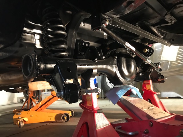

    Got the rear suspension re***embled. Progress!

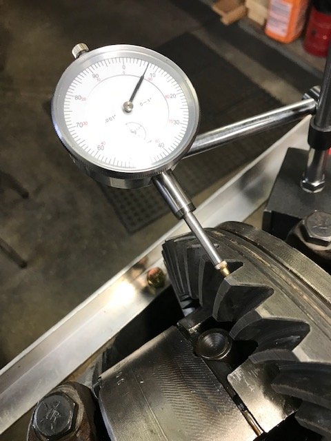

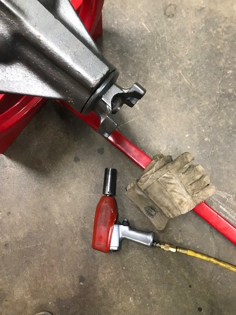

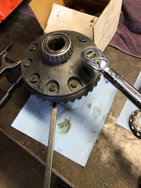

    After a two month thrash on my 32 Plymouth to get it ready for the Cleveland Autorama, it's time for a break from that one. Decided to take the pile of parts I had and build a center section for the 62. The car is going to get a 12 bolt but I need something so I can move it around and the old rear end will be easier to sell as a unit. 4.11 Posi
    Got a decent pattern for used gears and my old Snap-on IM 51 impact can still smash a crush sleeve.
    The good news is the carrier is a 4 series so I didn't need the ring gear spacer

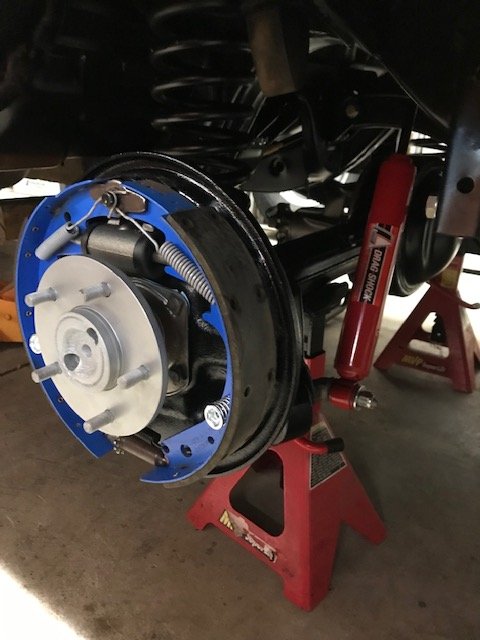

    I got the rear brakes and shocks hung today. I received a load of parts with the car and the lightly used brake shoes were in the pile. I like old stuff versus what they sell today (I mean, who paints reman brake shoes these days?) so I cleaned em up and used them. Lakewood Drag Shocks from Summit have the vintage look and as a bonus, it says they are "made in the USA" on the box.

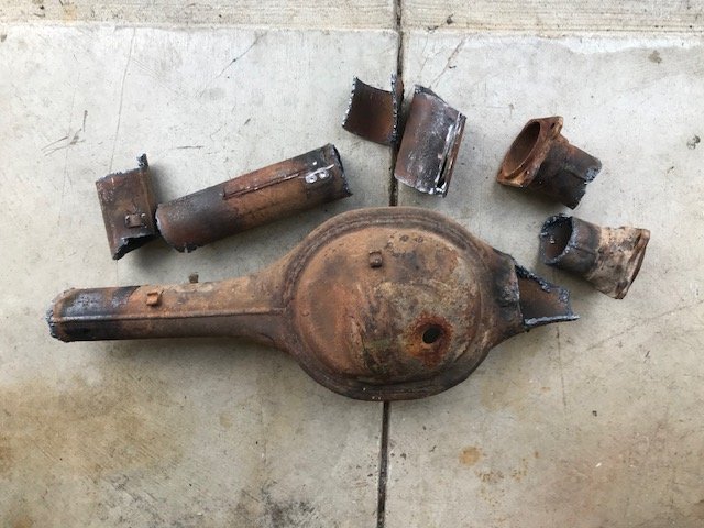

    Well...It's been a summer of working on the off topic race car, property upgrades and maintenance, and family commitments. Then I saw the post about organizing the garage, so I've been creating a swap meet pile and throwing **** out.
    As part of my cleaning/organizing, I have been throwing some parts on it here and there. I cut the brackets for the twelve bolt off a donor rear end so I could pitch it, and I'm putting the engine together so the pile of parts is slowly becoming an engine.
    When I get some time, I'll post pics of the engine build progress.

    It’s about time you were showing it some love! You might want to consider adding an extra upper control arm while you are at it. I’ve seen a few of the uppers rip out of the frame and or break brackets.
