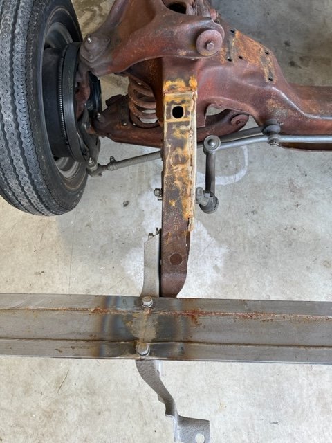

    Check. I have also added braces from the frame to the crossmember as can be seen in post 157 of this thread.
    The original upper control arms are temporary just to get everything set up. I'm eventually going to build some adjustable uppers with heim joints. Trying to decide if I'm going to add the second upper arm on the original rear housing or wait for the 12 bolt.

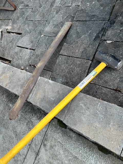

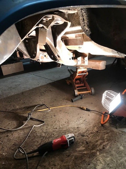

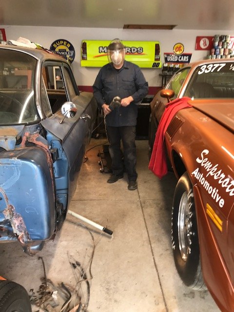

    Getting a few things done. I've never found an easy way to remove undercoating (until now). An aggressive cup brush on an angle grinder. I was sure it would clog the brush but it didn't. Worked great.
    Used the persuader to straighten a bent front support.
    Got the bigger front end parts back from the blaster.
    Had some extra holes in one of the wheel wells. I **** at welding sheet metal but what the heck, the holes are filled. As a buddy of mine says "bondo...it's beautiful stuff"

    A Propane torch and a s****er makes short work of undercoating... Stink's like Hell, but it work's!

    Tried that. Made a mess on the floor and on me and still had to use mineral spirits to clean what was left. The cup brush method provided clean metal and just swept up the powder left on the ground. Much better

    Good thinking on the face shield. Back in '65 of so I spent a whole weekend under the G/Stock '58 Delray big brother and I where putting together. Wire wheeling, s****ing, grinding, etc. I think there was even some undercoat removal involved. I finally knocked off and looked in a mirror. It was scary. Love your project.

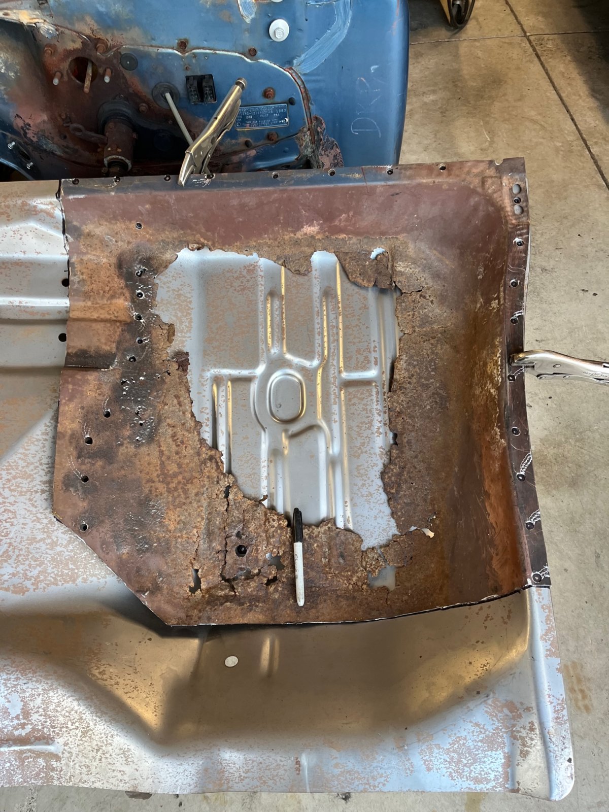

    Started on the floor repair. Shot some rust encapsulator in the floor braces and weld through primer on the joints. Fitted up the patch panel and got it tacked in.
    I come from the mechanical side of things, this is uncharted territory for me. Just trying to learn something here and I figure the carpet will cover it:D. For the record, I really didn't care for how that primer welded.
