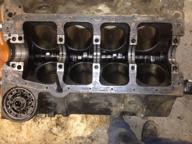

    Oil Pan off, showing a fairly solid bottom end, not too much crud, and no major issues:
    A different view:

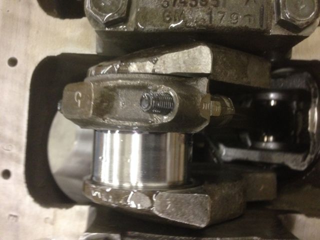

    numbering the connecting rods and caps:

    When I got the freeze plugs out, there was a LOT of sludge built up in the block. I went down to the local car wash and blew out close to 1/2 gallon of rusty gross ****. The machine shop will bake and shot peen the block but i wanted to give them a fighting chance.

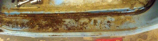

    When I got back to the shop I took the doors off, yanked the seat and then the gas tank, and vacuumed the crud off of the floor, including several rodent nests.
    There was a bit of rust underneath the trim piece at the bottom of the door on the driver side.
    With the seat gone, I vacuumed up the rust flakes from the threshold. You can see that it's not really that bad, but the vertical piece of steel that goes under the threshold trim piece is completely rotten:

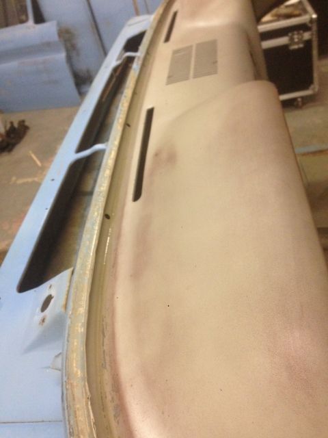

    Today I got farther along on the dis***embly of the cab, on both sides of the firewall. I pulled the vent cowl off, the wiper motor, heater core, front window, and the glovebox. I am really amazed by how little rust there is around the window. Being raised in Ontario where salt and humid weather eats everything, I'm used to seeing more rust after 5 years of existence, not 50.
    Wiper control arms:
    Windshield pulled:
    Heavy duty DeLUXE heater!! ;-)

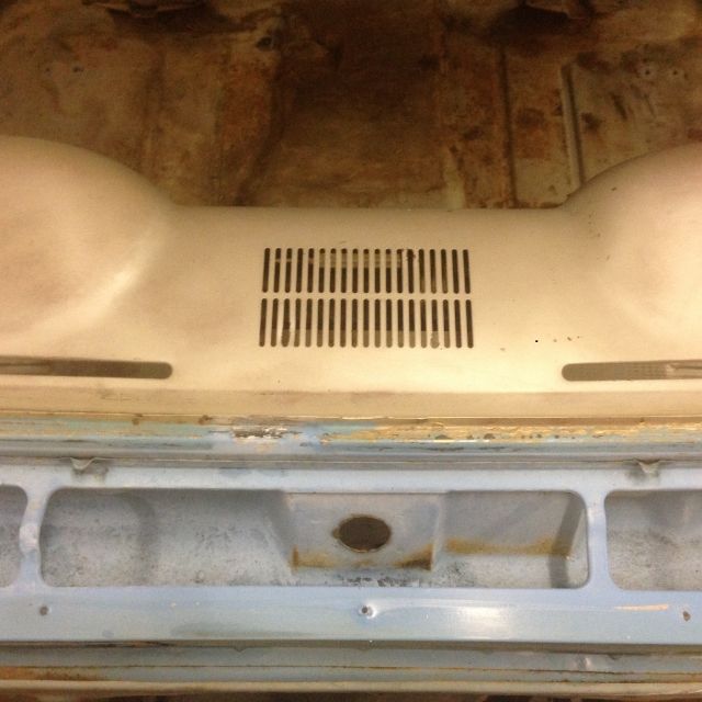

    Today I got the rest of the interior stripped down. All gauges, wiring harness, accessories, mirrors, and switches have been removed. I had some time to start washing off the dust and residue from the dash. I'm really happy with the condition of the steel around the window. Here are the pics.

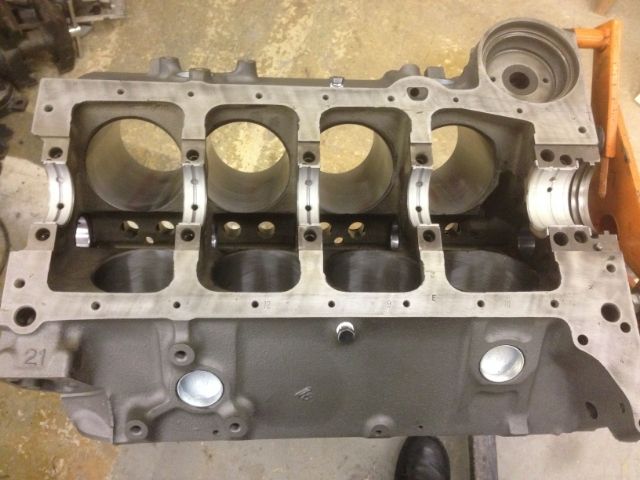

    This will probably go down in history as the slowest engine rebuild in history, but I'm making progress. I've been collecting parts and pieces this month, and I had some time this afternoon, so I began the re***embly today. The key to doing this is to be methodical, clinically clean, and double check your process and tolerances all the way through.

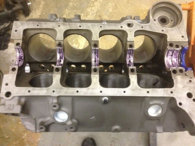

    I followed behind the machine shop to retap all of the threads, blew out all of the oil galleys, and then used a rifle cleaning brush to make sure there was no metal left from the shop. I used ATF on a lint free rag to super clean the cylinder bores. I installed all the freeze plugs. The machine shop had installed the cam bearings already so I didn't have to do that.
    This is what the block looked like at this point.
    Before I started with the crankshaft, I carefully dropped the cam with a bit of oil on the bearing surfaces to make sure the cam spins freely, and then pulled it back out for later.
    One last check of the bare block before I start re***embly. Looking good!

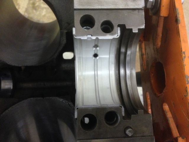

    Bearings:
    Bearings installed:
    Thrust Bearing:
    Add the rear main seal:
    Carefully oil the bearings - Not too much, but definitely not too dry. Plus a drop or two on the rear main seal.

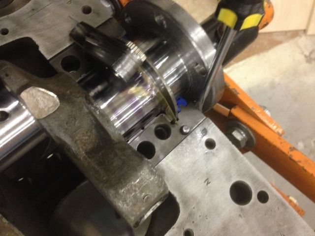

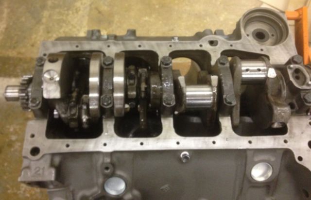

    Time to drop the crank into the block, and check how smoothly it spins. It should have almost no resistance at this point.
    Checking Endplay - we're at .007" gap between the thrust bearing and the crank. That's on the loose side of what is acceptable, but within spec.
    Rear bearing cap installed and torqued to 75 ft lbs. Endplay is now .005", so we know we're OK there. One thing to watch is not to use too much sealant on the bearing cap or the block at the rear main seal so that you don't fill the block up with silicone that gets squeezed out and eventually plugs oil galleys. I also spin the crank every time I add a bearing cap so I know right away if something is binding.
    Here's where we are at the end of my time today. All 5 bearing caps are now torqued down to 75 ft lbs. Everything is spinning freely and there's just the right amount of RTV squeezing out from the rear main seal. (It looks like about 1/16" of excess)
