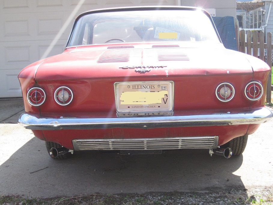

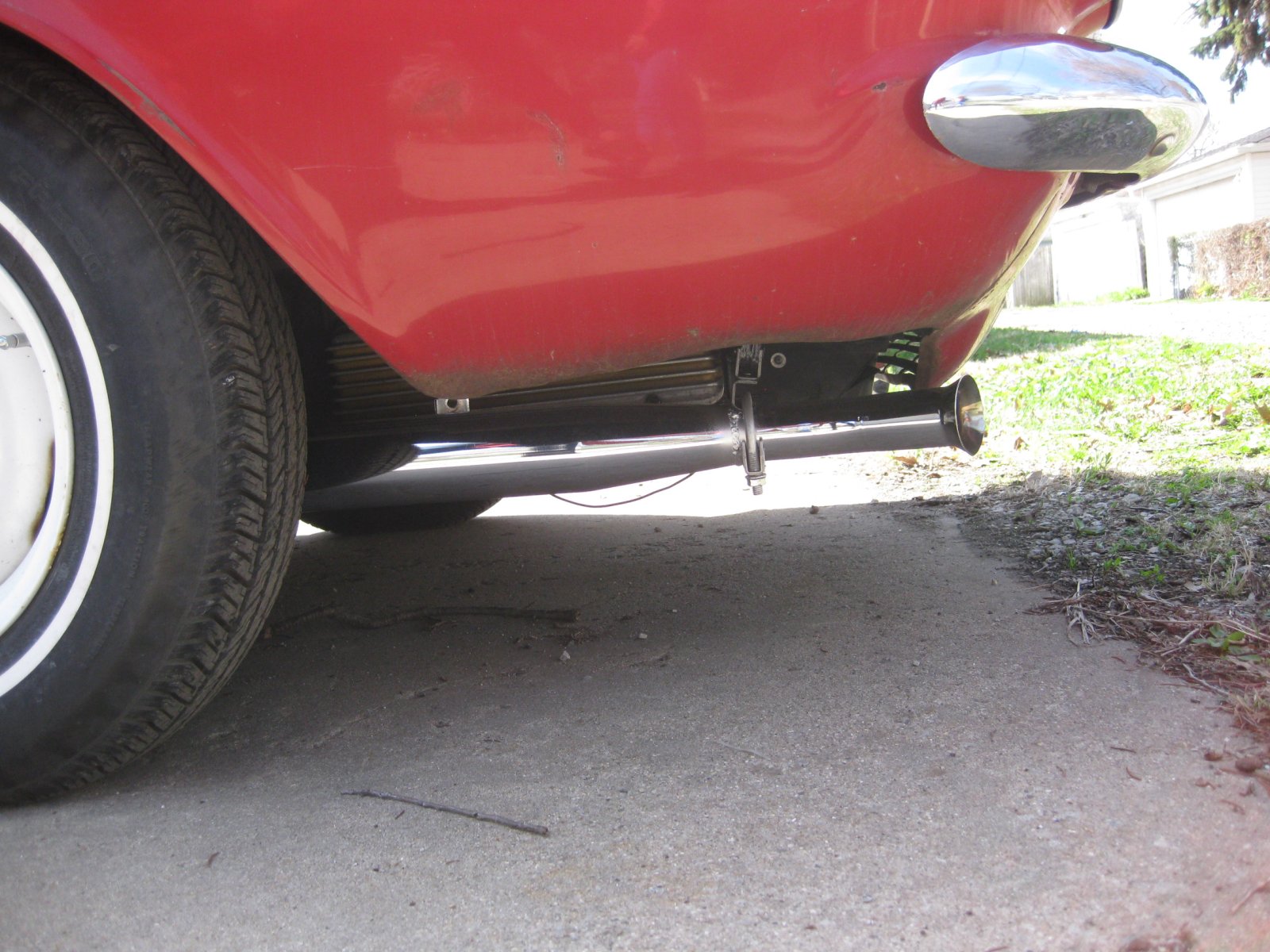

  8. Hellfish
    Joined: Jun 19, 2002
    Posts: 6,761
    Hellfish
    Ah, you're right! I built a custom dual exhaust for mine
  9. pvfjr
    Joined: Apr 28, 2020
    Posts: 233
    pvfjr
    1. Hydro Tech
    How did you have the tail pipes exit? I haven't thought of a good way to deal with the body asymmetry.

  11. Hellfish
    Posts: 6,761
    Hellfish

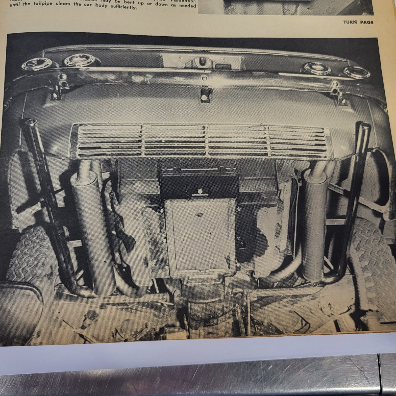

  14. HEATHEN
    Joined: Nov 22, 2005
    Posts: 8,977
    HEATHEN
    from SIDNEY, NY
    They relied on the 90 degree tailpipe shown in your exhaust system illustration.
