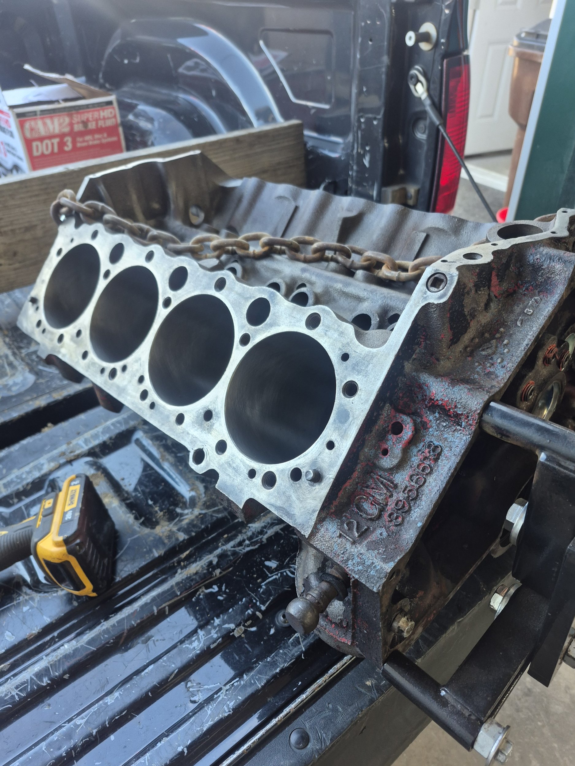

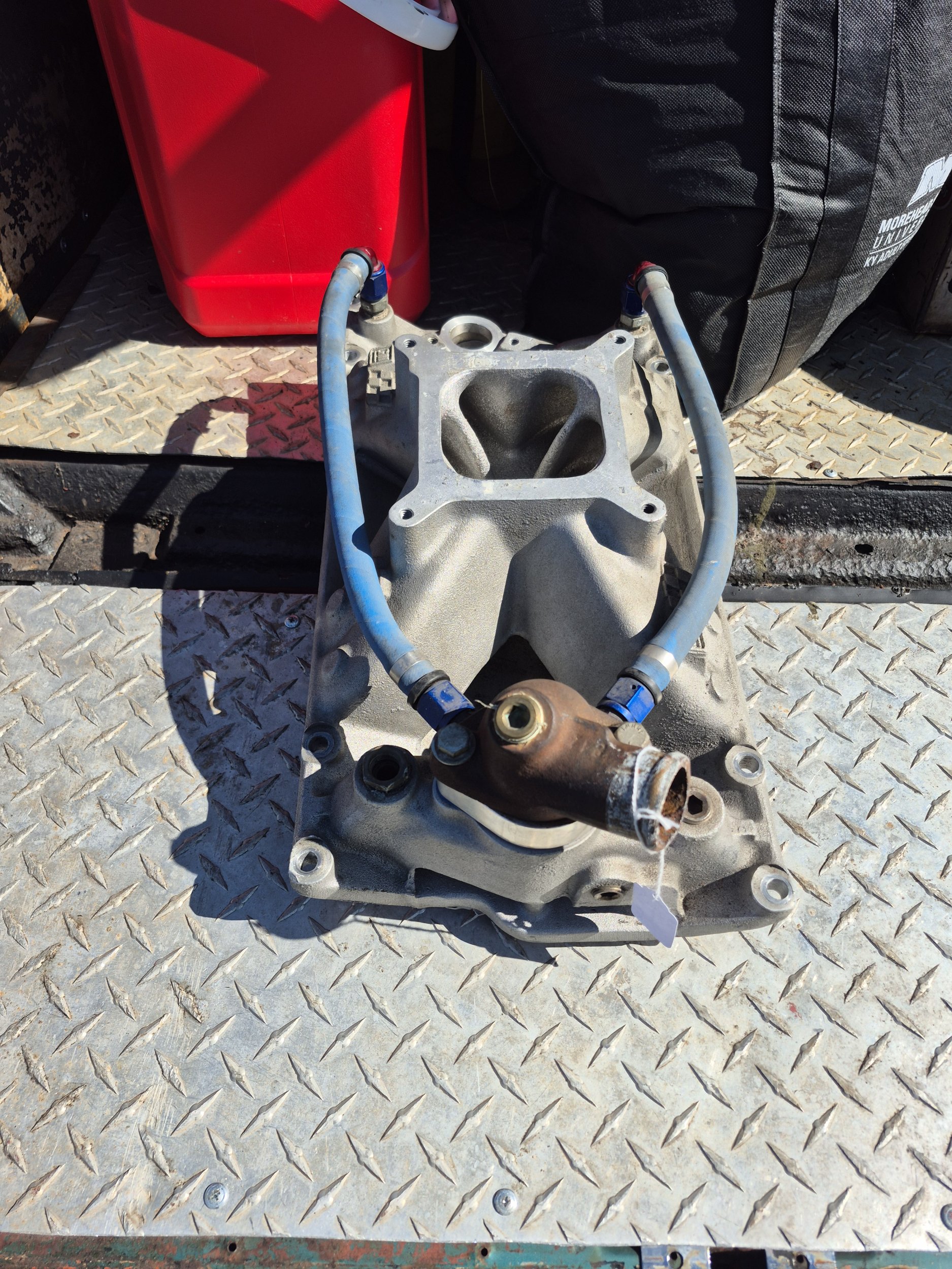

    Lol nothing to update. Block is in the machine shop getting bored, cleaned, plugs and cam bearings. Reconditioned the rods, and putting them on my @lumpy 63 pistons. I've got the cam & lifters. Bought a fresh set of 906 vortec heads. Gonna be 12.5-1 according to the sheet that came with the pistons, but it doesn't seem to account for the. 030 bore. Picked up this intake at the swap meet Saturday. $70 :cool: and i got a set of fenderwell headers for it. Should be set as far as engine/ trans goes. Had a great conversation with quick performance about the axles and rear gear. But I've got narrow the rear housing still, cut the ends for C clip eliminators, and order said eliminators lol. The car is just sitting around waiting :D

    They are Bluetooth shocks lmao! You're guess is as good as mine. I'm not sure what they were planning to do there. I'll get to that later

    Lloyd, I have AN fittings and braided steel hose. If you want to replace the blue stuff on those crossovers, I'll send you the pieces.
