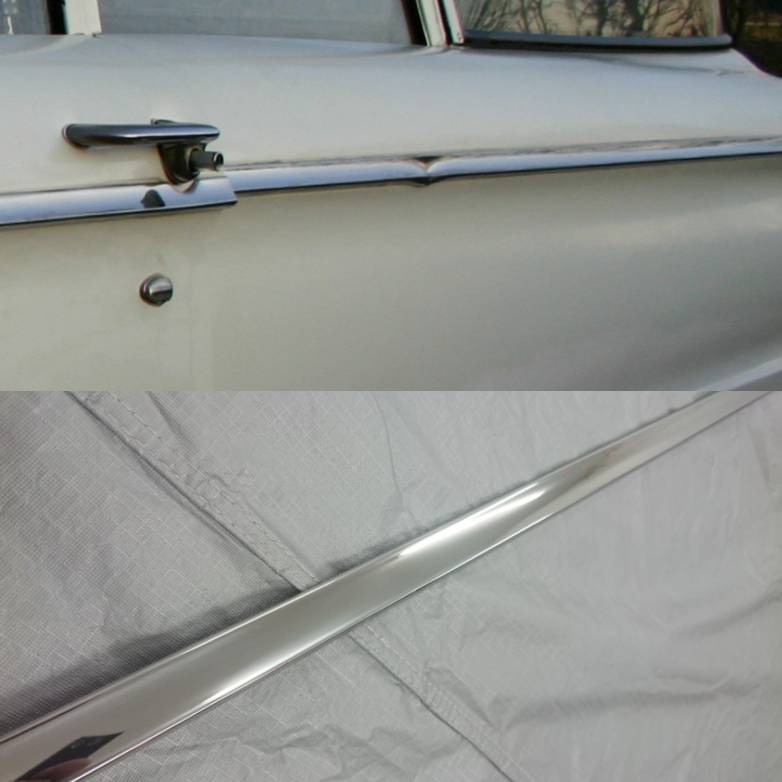

    My coworker kept nagging about that outside needs lacing so I did that to make him happy. [emoji38] Rear pillar mouldings got lacing today after daily work. IMG_20190522_200749.jpeg

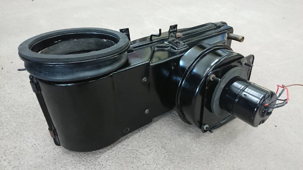

    Update time even a little one... Whole car is now back home. I've been waiting my parts to come and this week I got a message that parts are here. Well as I suspected not all of them but 90% of my order. Now I can start to put this back together... Few days ago I polished dash mouldings and installed them back. Glove box door with new bumpers and ashtray were installed at the same time.
    Yesterday I dug out heater box and heater core out from top shelf. New seal kit was bought way back ago when I was in States. Six years ago I worked with this heater so first I was kinda lost how to put it back together but when you got all parts on the table it was a easy job. Today I worked with steering column. Installed a new turn signal switch, signal cam and slided the column back on the car. DSC_0824.jpeg DSC_0825.jpeg

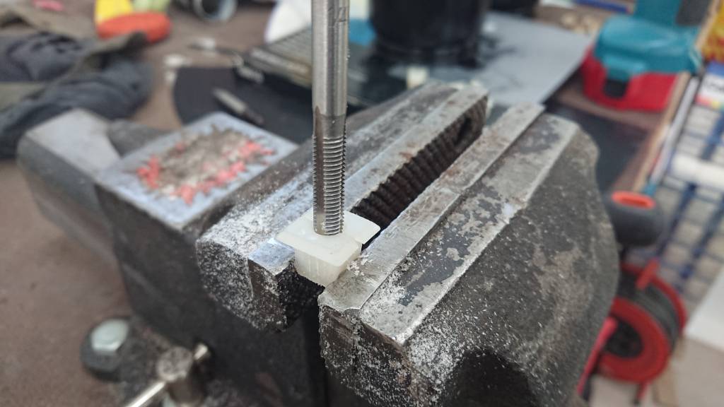

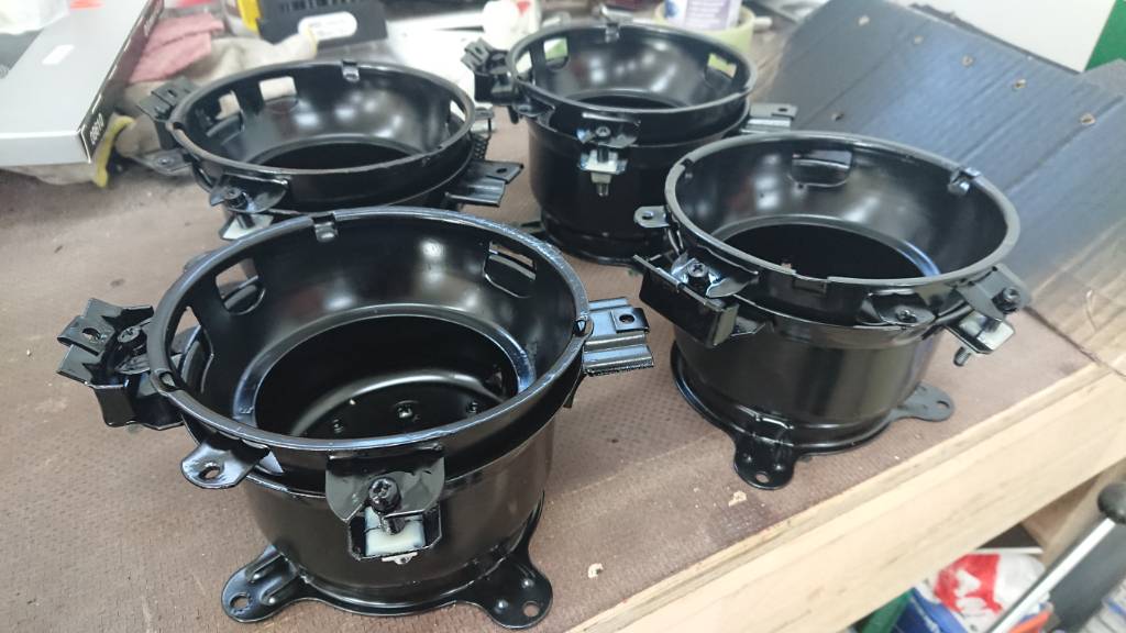

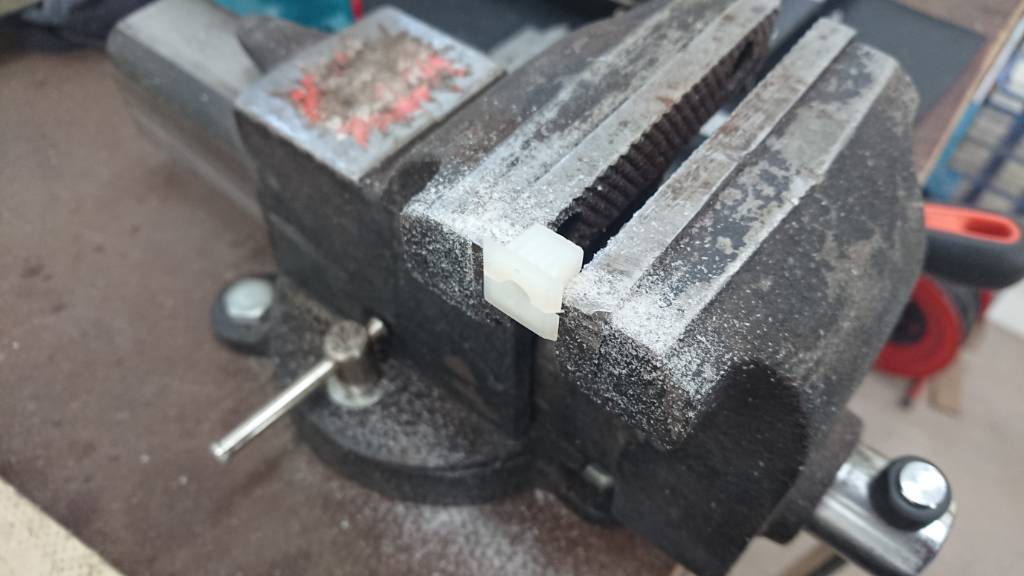

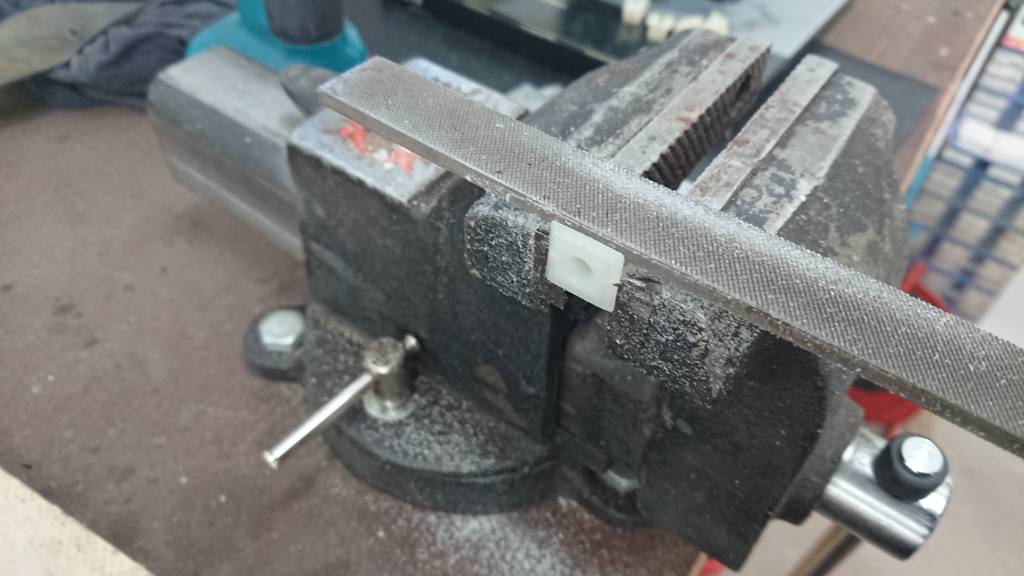

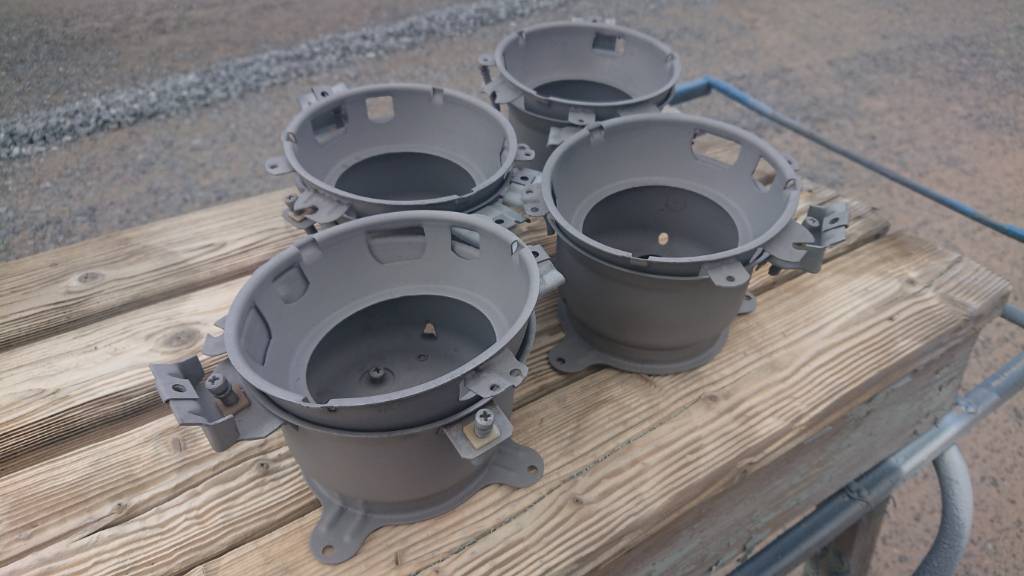

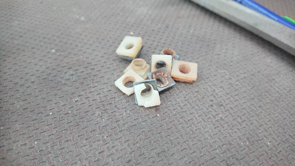

    This week I dis***embled head lights in pieces so that I could sandblast all buckets and paint them. Adjuster nuts was so fragile that they cracked really easy in small pieces. I knew that there's new oe nuts for sale but I went different route and it was really cheap fix.
    Yesterday I made a order from local parts store for a plastic nuts that are used in some Peugeot/Citroën models. Nut size was really close to the hole and nut was slightly bigger. Few times with file and it fitted nice and tight to the hole. Since nuts was without threads I made 1/4" threads on them just to make sure that screws goes in better. After all nuts were done I ***embled all back together. Adjusting works now and those nuts cost only 3$. DSC_0895.jpeg DSC_0885.jpeg DSC_0892.jpeg DSC_0889.jpeg DSC_0890.jpeg DSC_0891.jpeg DSC_0893.jpeg

  5. Peanut 1959
    Joined: Oct 11, 2008
    Posts: 2,188
    Peanut 1959
    Great tip. And way to economize!

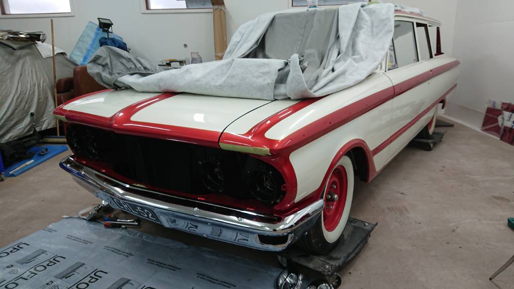

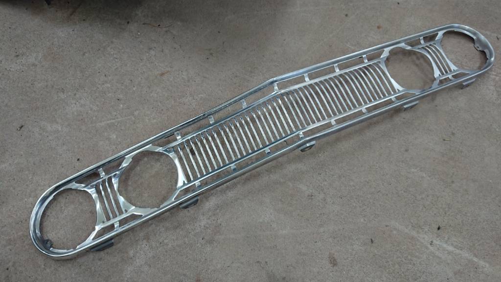

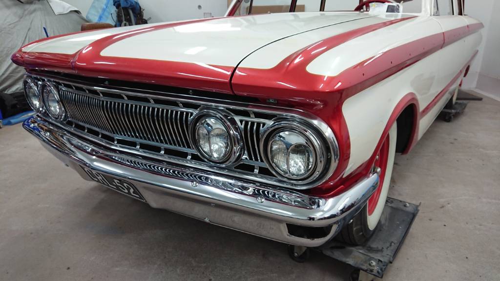

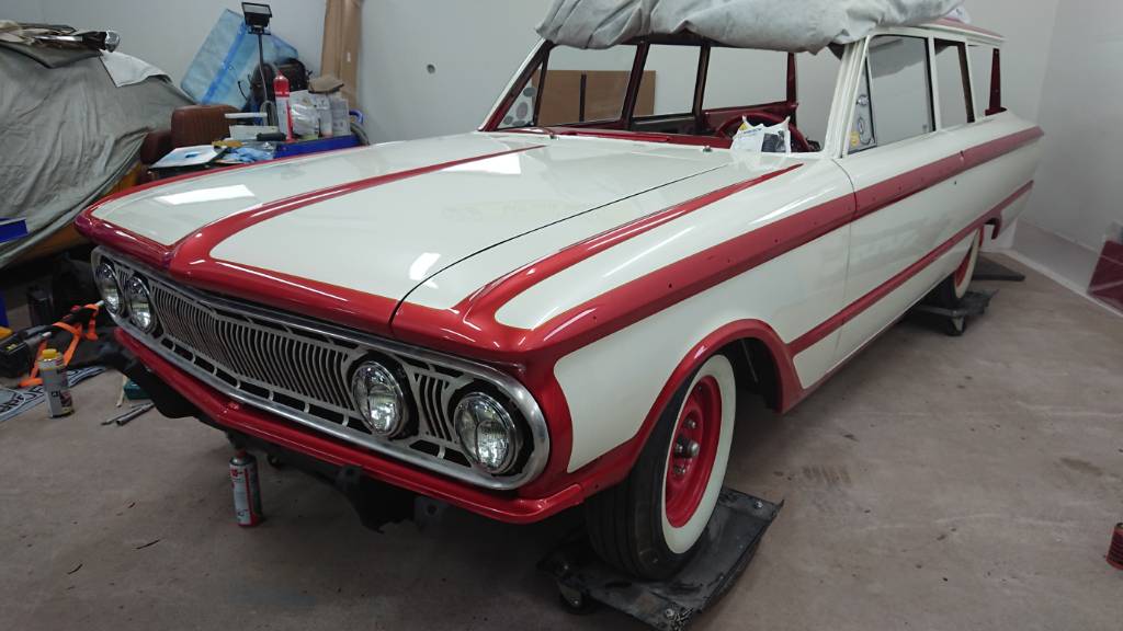

    Polish, polish, polish... That's what I've been doing. [emoji1] Well that's not the whole truth. Front end is nearly done except grille what I have been polishing few hours now and half of it is now good enough for me. IMG_20190805_225859.jpeg IMG_20190808_210141.jpeg DSC_0901.jpeg DSC_0904.jpeg DSC_0906.jpeg

    Looks great!
    Like we talked few weeks ago, i have to come to check out whats going on there. Its still warm in here, so a small motorcycle trip to your neighborhood could be cool.

    Thanks! Come on and stop by for coffee or beer, your choice [emoji1] whenever you have time.

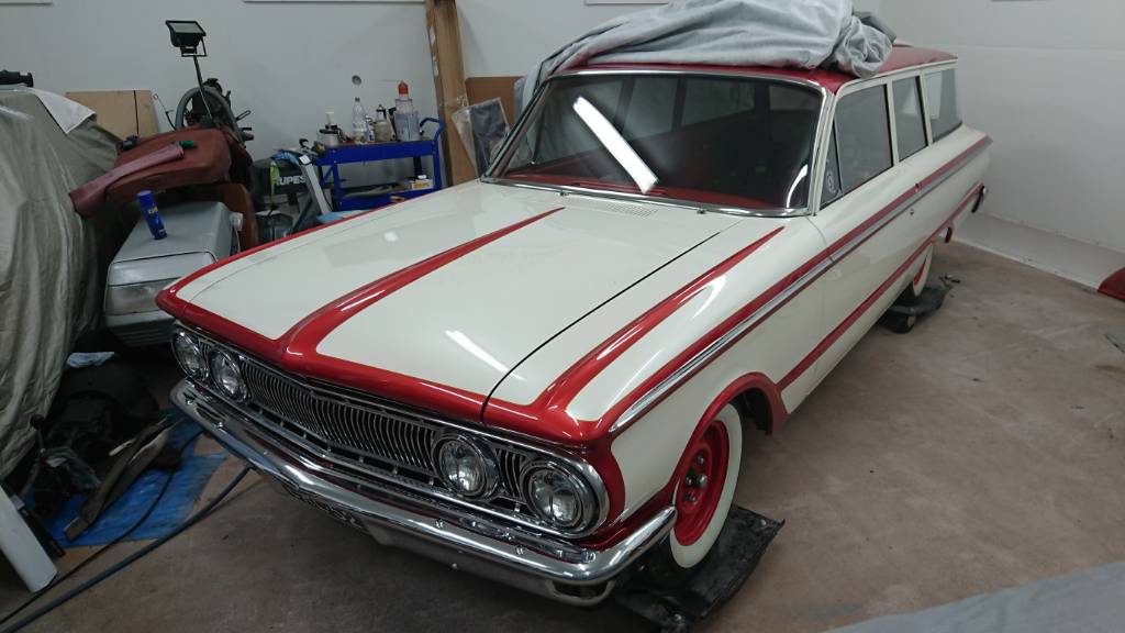

    After work I thought that I polish only grille today nothing else. During that I had tons of time to think what to do next and I ended up to finish front end. Only parking light bodies are not installed because I'm waiting new ones to come. DSC_0908.jpeg DSC_0909.jpeg

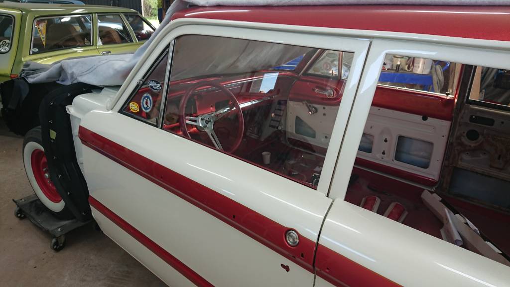

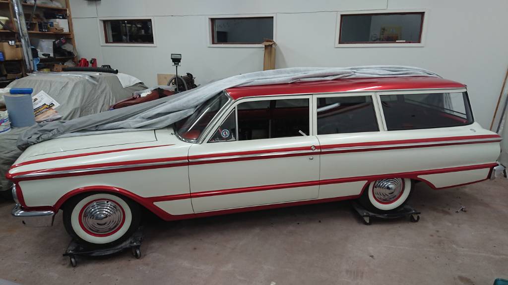

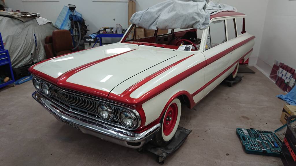

    Two months since last update so it's time to do a new post... I had to order some windlace what I forgot to order earlier this year. When it arrived it was time to install new headliner. I have once put old headliner back but never a new one. Well that wasn't a easy job for a first timer even thoug in basic it's simple job. Anyway it turned out quite good but it took several hours and extra pair of helping hands.
    All side windows are installed back and yesterday windshield mouldings got polished and installed windshield also back. Of course I have done many smaller things but those are not worth to mention. DSC_0969.jpeg

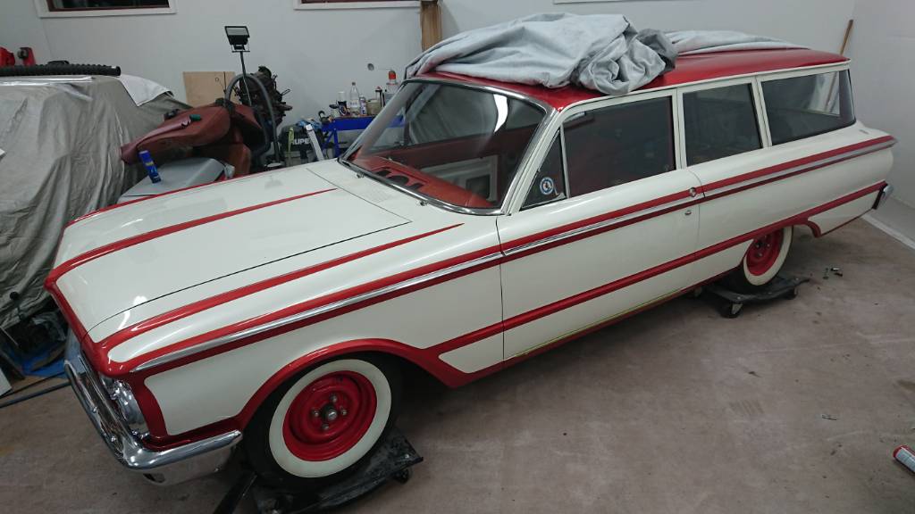

    Thanks! This week I saw a pic of one installed headliner that had so many wrinkles that my eyes hurt. [emoji1] I think I got mine installed just great.
    I have worked with interior parts, tailgate is back on, better rear bumper is almost fitted and so on... Now I have been polishing side mouldings. They were all in quite good shape but left rear fender moulding had a really nasty dent on it. Too bad that I never took any closer pics of it before I started to straightening it. Well that took several hours of hammering, filing, sanding and polishing before I was pleased of result. It's not perfect but really good driver quality. Here is a pic from left side so you can see the sharp dent on moulding. IMG_20191114_205621.jpeg

    After I got all side mouldings polished it was time to install them back. That should be a easy job to do but not this time because I had to modify every single new moulding clip that I had bought and it took hours to get them fit good. Comparing new clips with oe-clips, new ones are cheap aftermarket **** far from original one. Too bad that so many oe-clips were rotten in pieces. Well all mouldings except tailgate mouldings are now installed. Once again I have done smaller things that are not worth to mention. Current status below... [emoji3596] DSC_1056.jpeg DSC_1055.jpeg

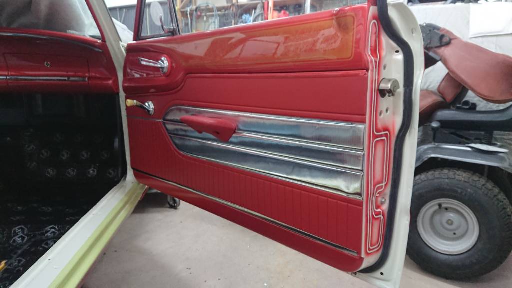

    Just before christmas I started to do some sound deading on whole floor. When I was on roll with it I did also doors. Task completed... IMG_20200110_062656.jpeg

    That looks like pretty thin stuff?

    Yeah, I bought Stp black silver which is thinner that black gold. Silver one is little bit easier to install on curvy surfaces. Silver 1,8mm vs black 2,2mm. Now door shut sound is way different than before so it really does something.

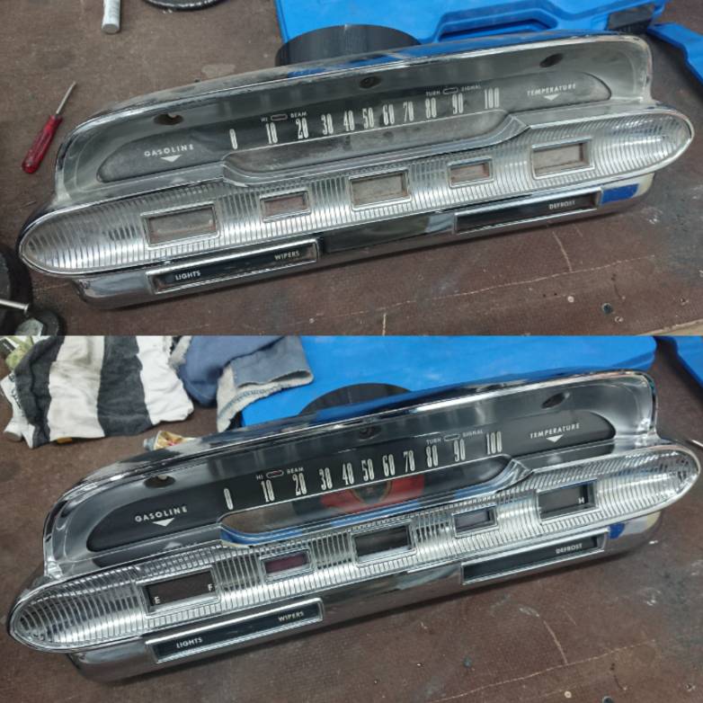

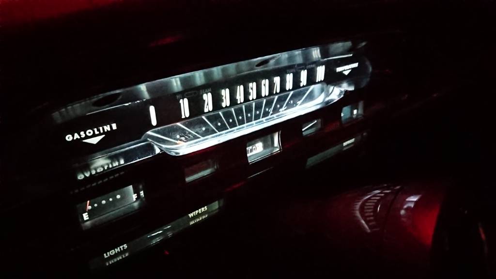

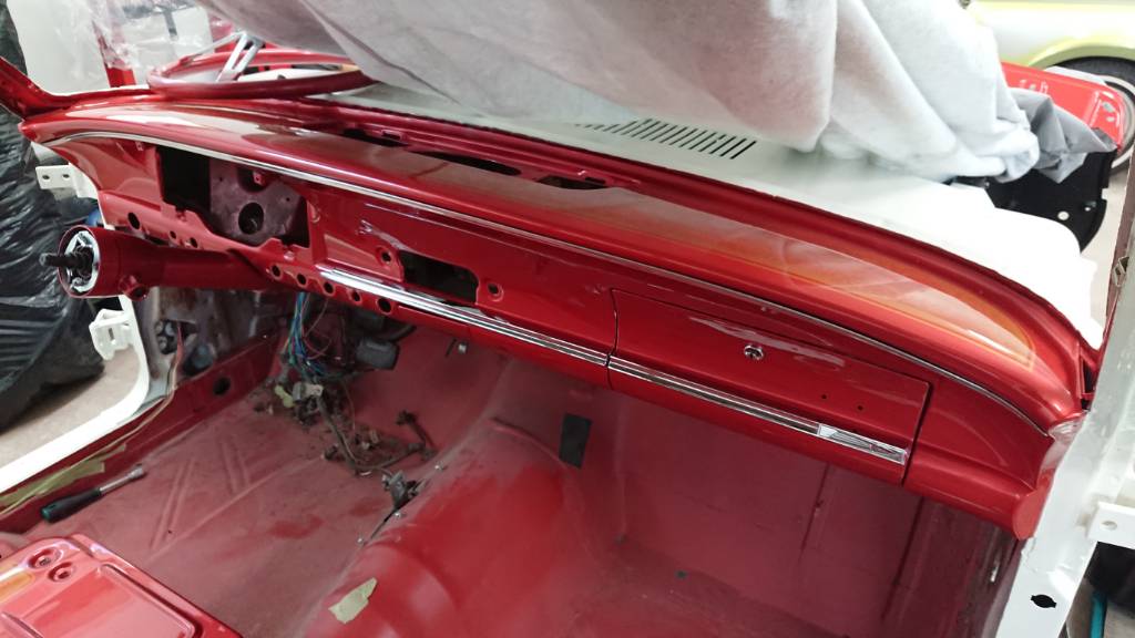

    Project rolls even though I don't do updates... Time for a one now. Heater found its place last week and now it's fully working. Cables, wires and hoses are all connected. Instrument cluster got all cleaned up, led conversion done and installed it back. Door panels, battery tray with new battery are also installed. All lights works and so on... IMG_20200114_184816.jpeg DSC_1104.jpeg DSC_1112.jpeg

    Nice look on the lighted dash.

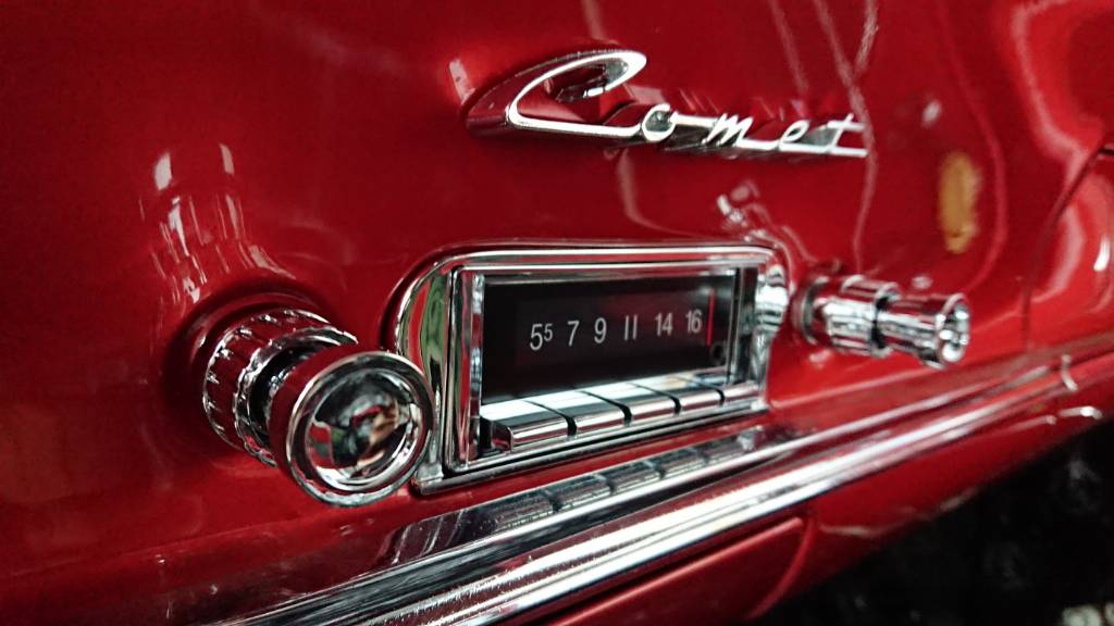

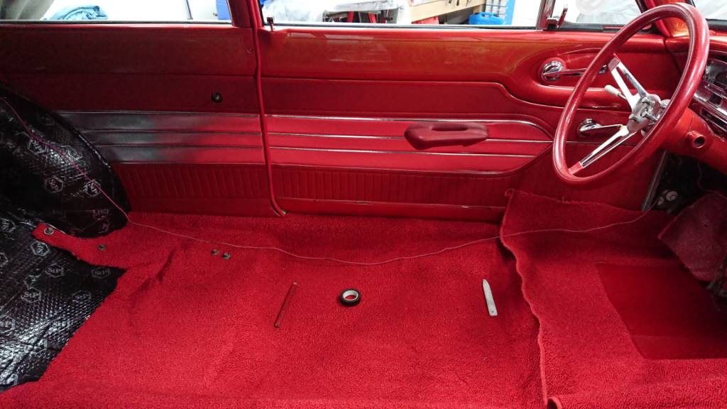

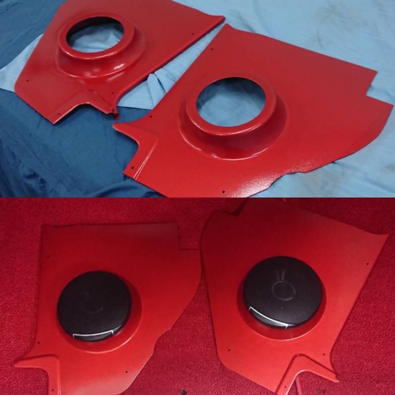

    I've been working mostly with interior. New carpet, new scuff plates, new kick panels with speakers, Custom Autosound radio and flat subwoofer under front seat found their places. Front seat was cleaned before I lifted it back in the car. Few things are still out in upholstery shop...
