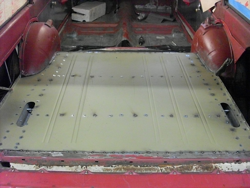

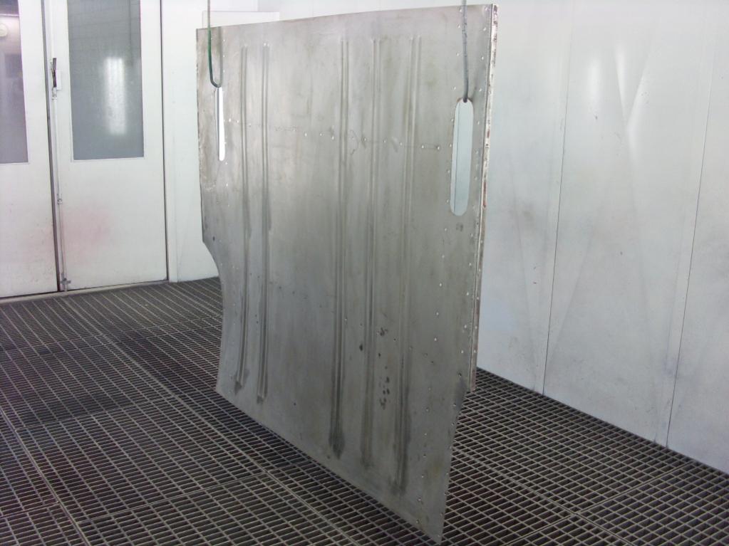

    Last sunday I started to work on trunk floor. I grinded the latest floor out of the car and I must say it didn't take long. Less than 5 min...
    I knew that there was pieces of old floor under that and it was pitted very bad. Pics don't tell the truth but trust me it was. Old pieces out and then back to the new floor fabrication.
    I decided to use that previous floor pan but it needed bead roller treatment. Gladly one of my co-worker had bead roller that I could use. There had to be few guys to do those beads because that floor pan is so big. One on the crank and guys at both ends to steer it right. Now floor pan has decent beads...

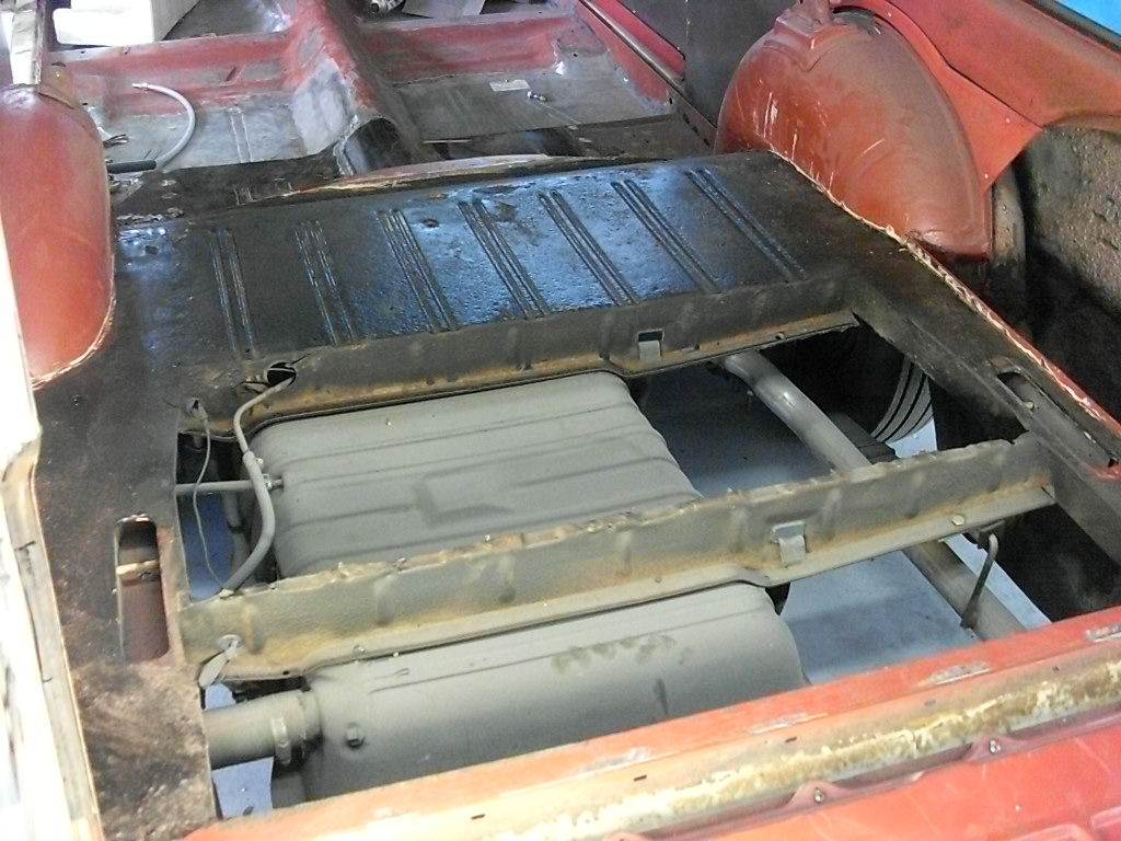

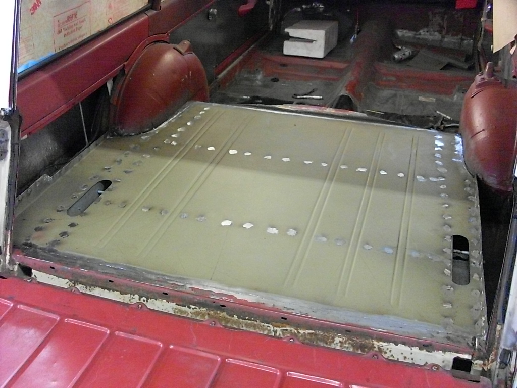

    Ok, it's time for update...
    This week I finally got that trunk floor ready. I decided to paint trunk floor before welding because there's fuel tank under it and it's a bit hard to paint it under without removing the tank. I didn't wanna do that so reaction primer on it and then semi flat black. Now all floors are welded. Yes!

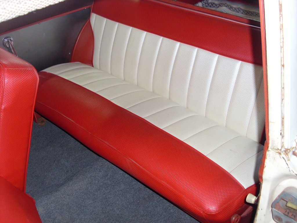

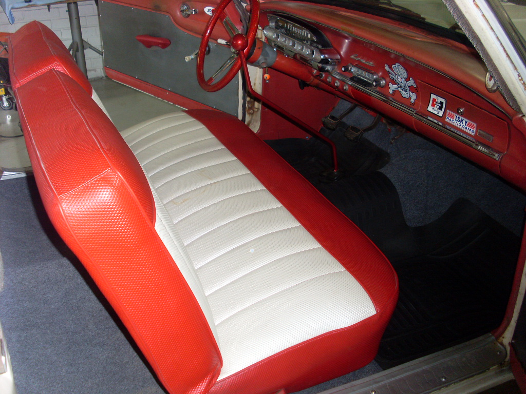

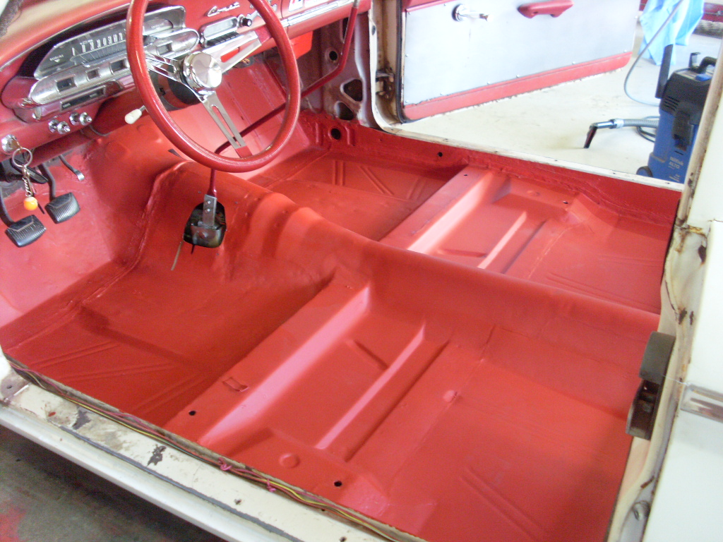

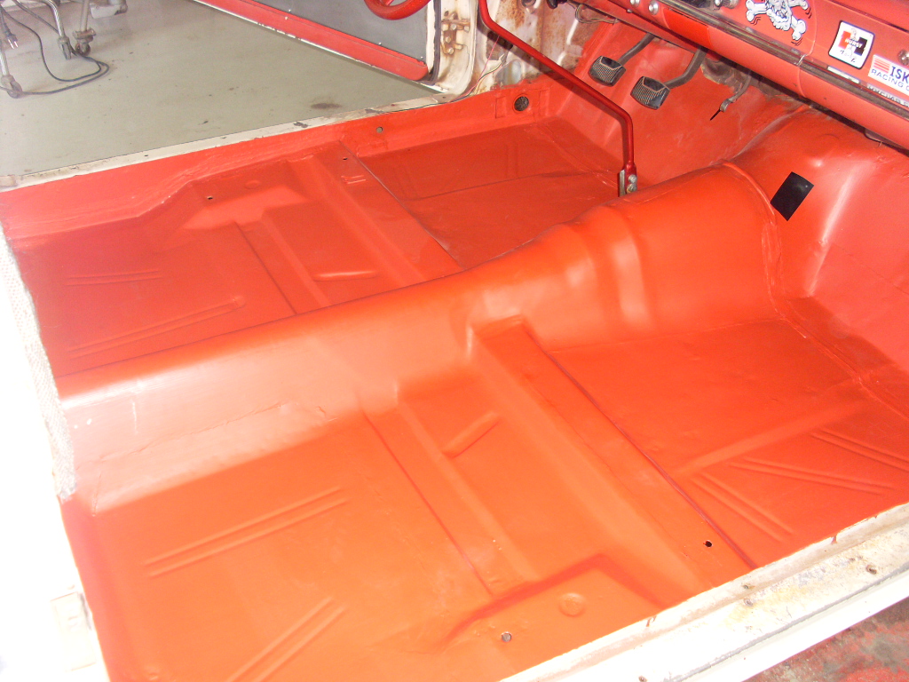

    Floor is now painted from inside and outside and today I put whole interior back in the car. Carpet doesn't fit at all and gotta order right one but old one goes for now. Also installed rear Monroe air shocks but right shock has leak. Now I have to install old shocks back and wait replacement shocks from Monroe.
    Pics at the end...

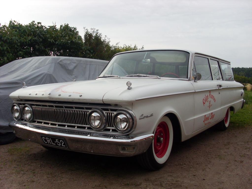

    Here's fresh pics of the whole car... enjoy.
