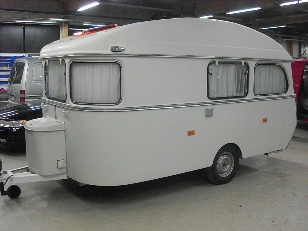

    Not so much to this topic but this trailer is gonna be towed with Comet. I just gotta build tow bar to Comet.
    I bought it from Holland last weekend. Needs desperately new paint job. Maybe something wild?? :D

    Pretty neat trailer,i talked about that with mr.V at the work earlier at today..
    So,looks like you got some more paint job to do:D

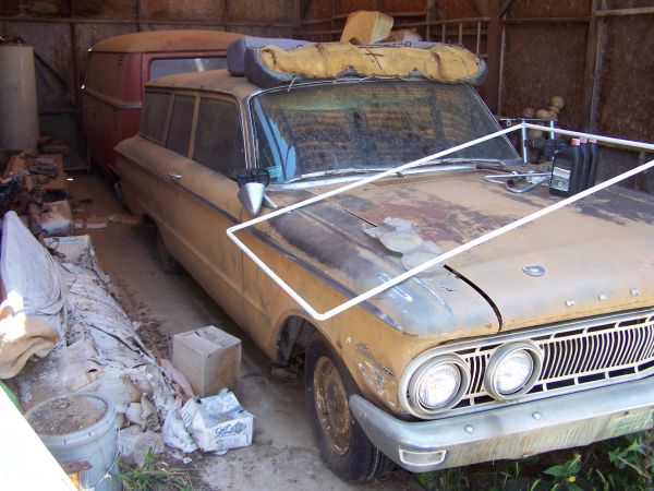

    Another one just turned up on c-list on the West Coast.
    (I am not connected with the ad in anyway, just always looking for them!)
    Seller want$ a lot, but it is a decent project '62 2-door wagon.
    7/17:
    (To anyone lookking for one... - it WAS a lot - $3500. - today, 7/17 I saw the ad again and they are asking $1700.
    Someone get it.).

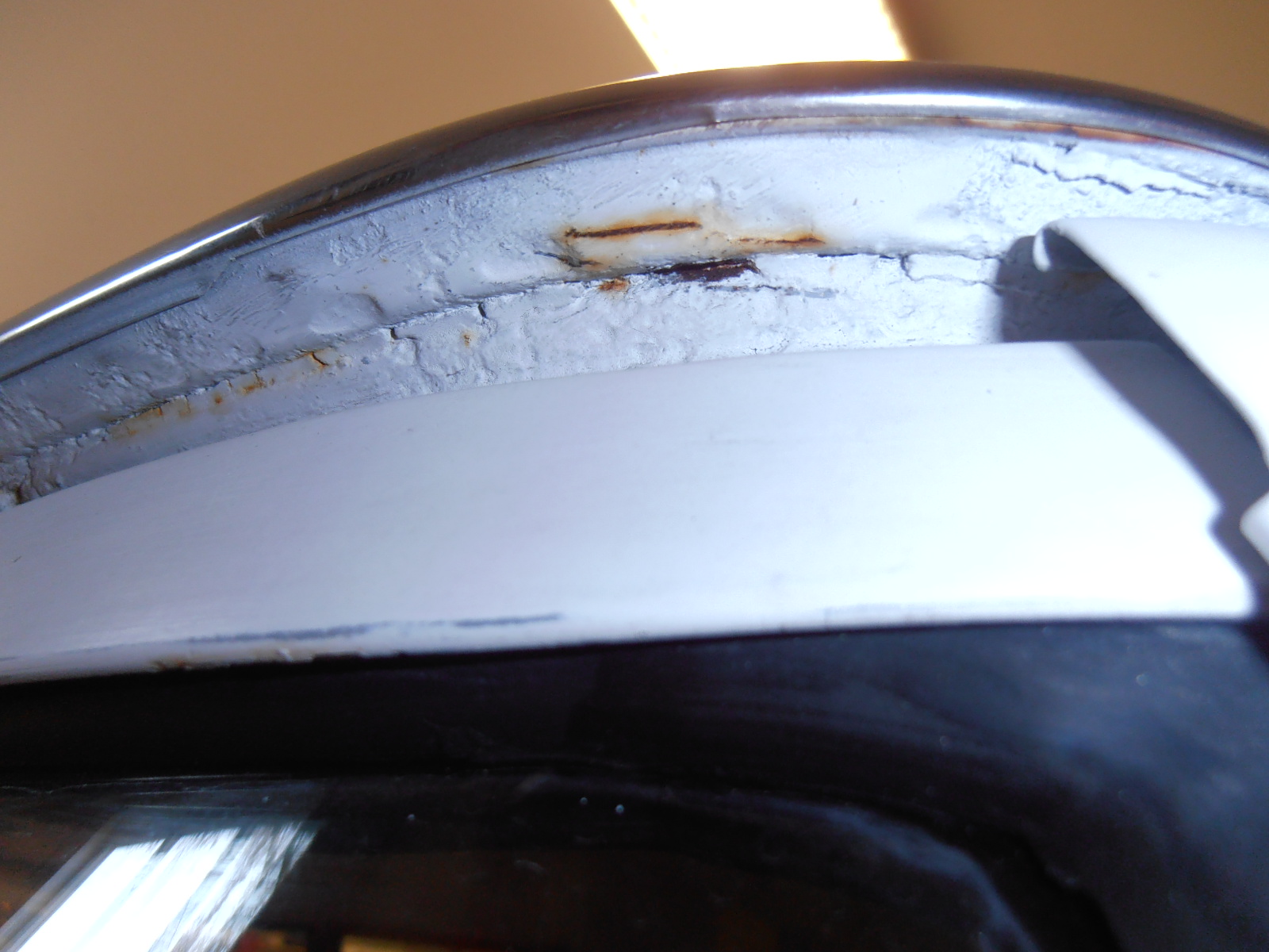

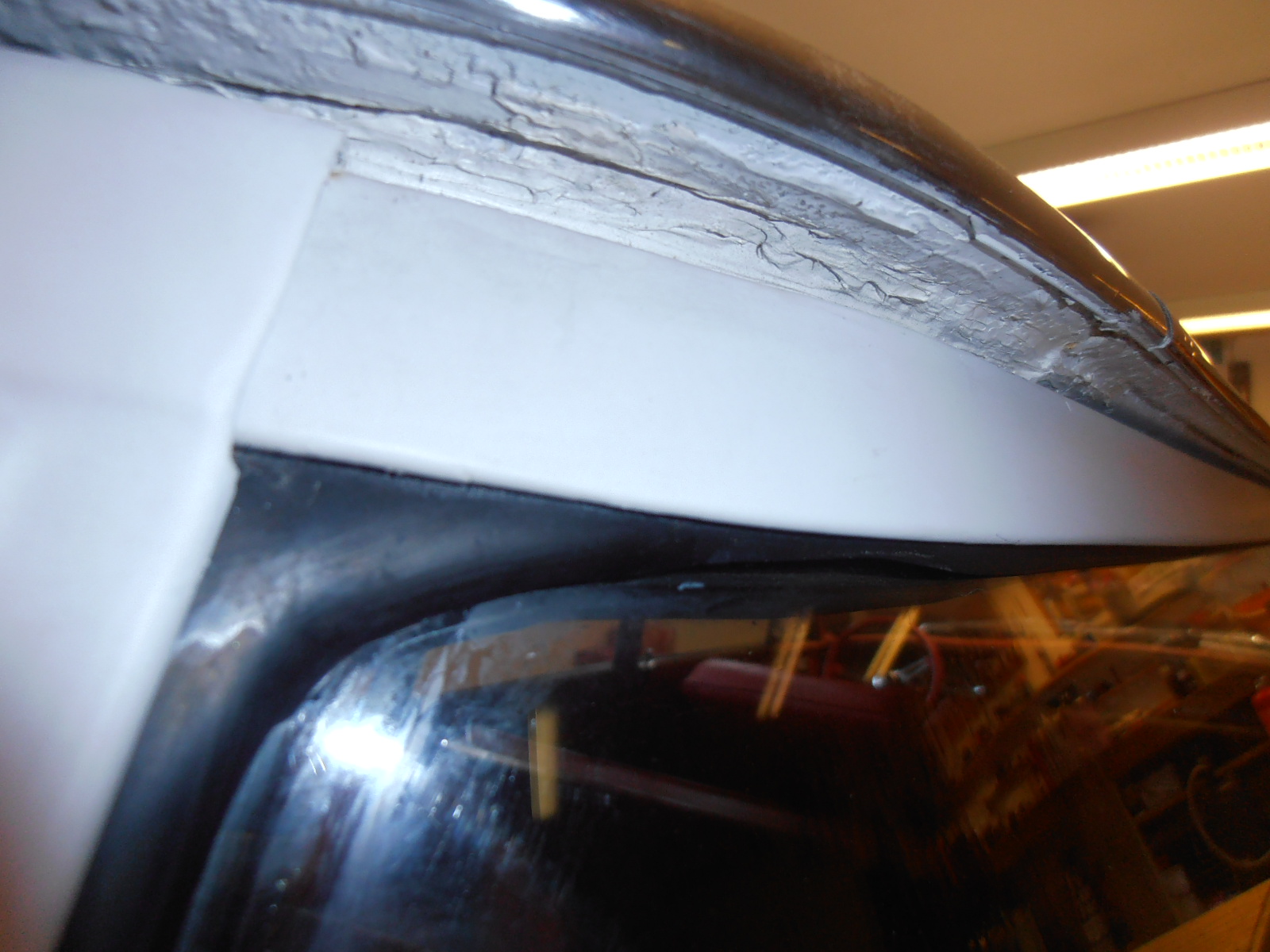

    There are now wheel dollies under Comet so I can push it sideways in the garage. There is some rust issues in roof drip rails and rear side windows must be removed. Water is leaking to the trunk between side windows and think that there is really bad rust damage under the seal.

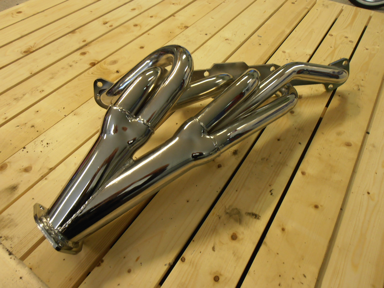

    I also have some speed goodies to the engine. I have better cylinder head with bigger valves and header. Engine tune up is somewhere in the future but it is good to have parts already for that job.

    Thanks man! I also dig wagons and there´s nothing to do with that I have family and dog. Haha... It's good that roof is bit rusty 'cos now I really have to do some flake job to the roof.

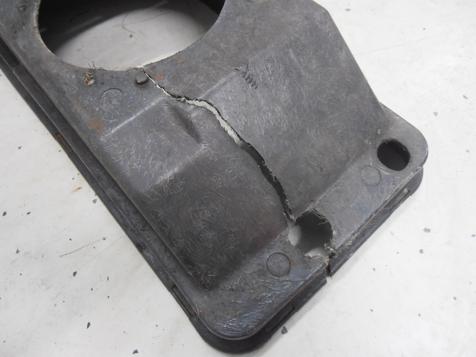

    Small update...
    I found that heater set up almost my neighbour town. Donor car was -65 Comet. I bought everything what is related to heater.
    Heater box had a crack and I fixed it yesterday. Box needs some paint and new seal kit. Heater core must be checked for leaks. Defrost ducts are in bad shape and I think I'll buy new ones with new hoses.

  25. New core from RockAuto fixed mine - now it burns me out of the car!!
    Defroster ducts were fixed with a little fibreglas. Cut two holes in a piece of plywood to hold ducts, then fibreglassed to rebuild/strengthen. Easy.

    Cheers! Yesterday I thought that I make ducts from steel so they'll last forever. Maybe I'll do so... I thought new core also but old one looks pretty good but it hasn't been in use for a while.
