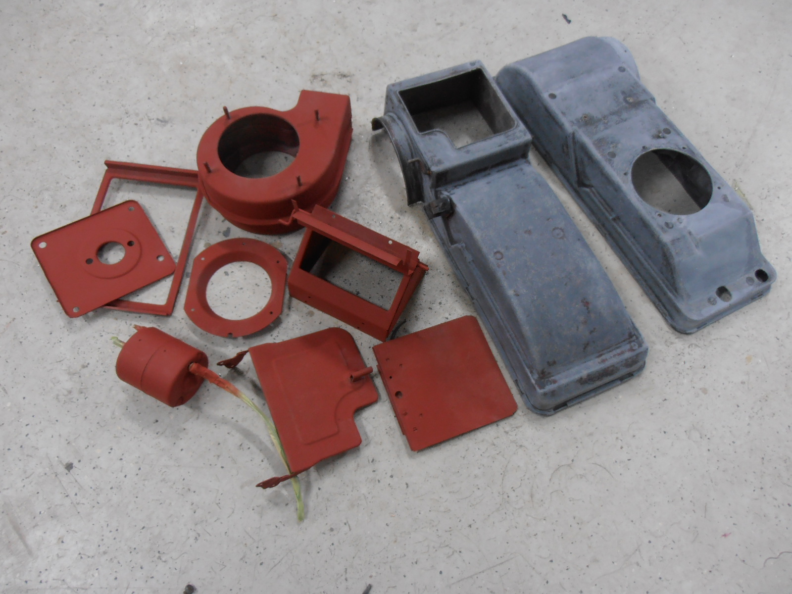

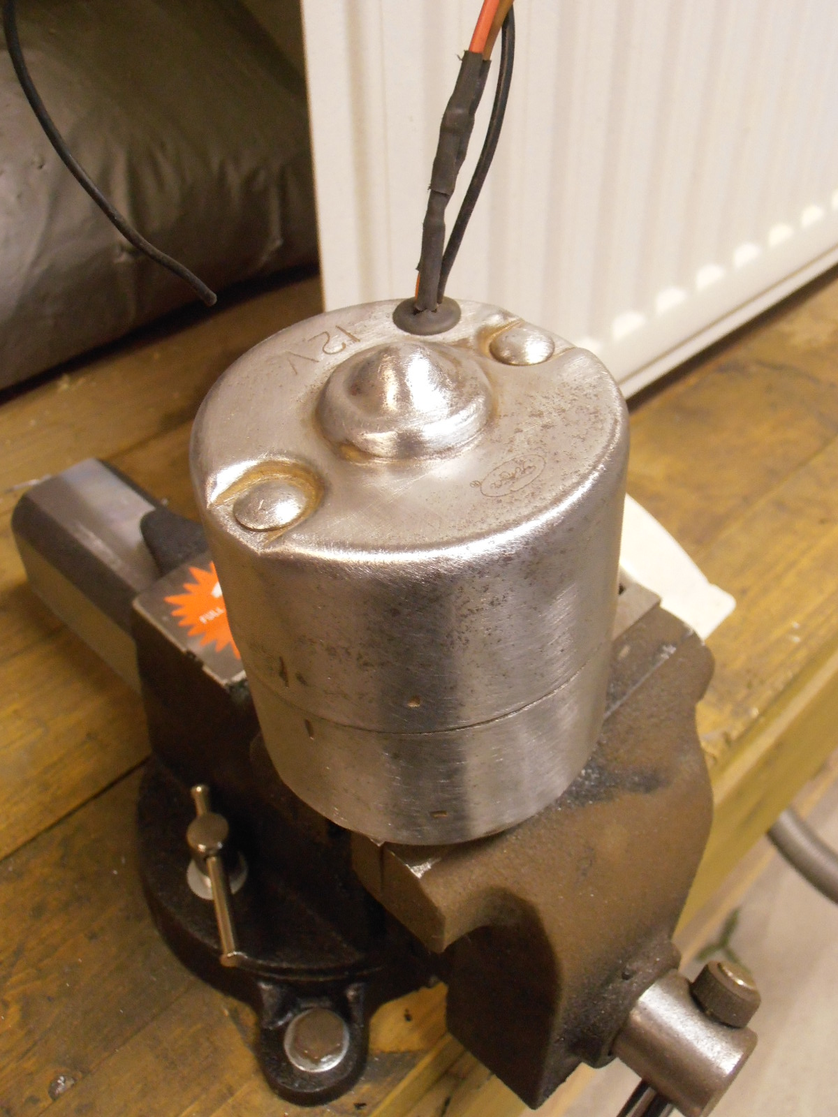

    Yesterday I fixed up blower motor wires which were pretty bad shape and also cheked brushes. Put it back together and removed rust from the covers. Today sprayed some primer to all metal parts that were sand blasted. Now all the heater parts are ready for some paint.

    Heater parts are now painted. Next I have to do order from Mac's to get the last missing parts...

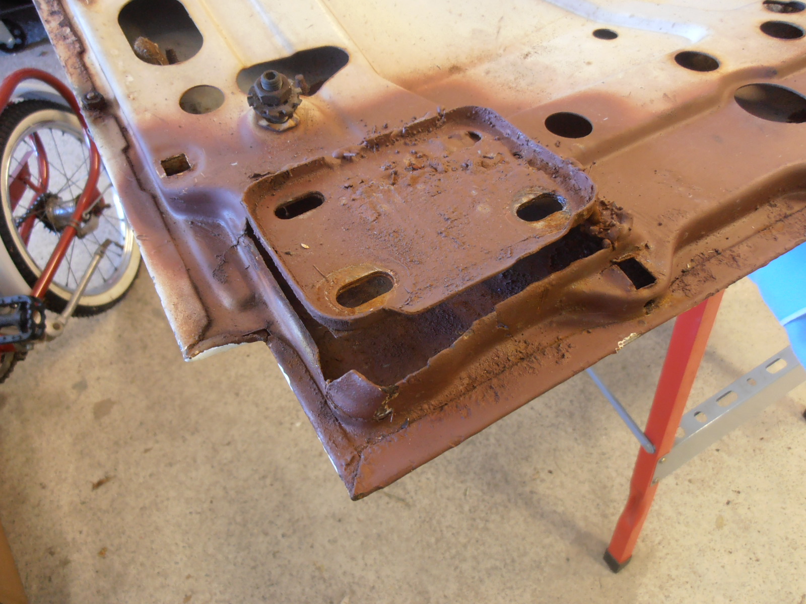

  10. JiiTee
    Joined: Oct 5, 2010
    Posts: 226
    JiiTee
    from Finland
    Blaah, heater is still in pieces and I have been thinking...
    Body still have few rust issues so I decided that I'm going to fix all of them and strip the whole body to bare metal. So this wagon is going parts for unknown time but it will come back kooler than ever...
  11. JiiTee
    Joined: Oct 5, 2010
    Posts: 226
    JiiTee
    from Finland
    9 days trip to Netherlands and over 4700 miles does good for my motivation.

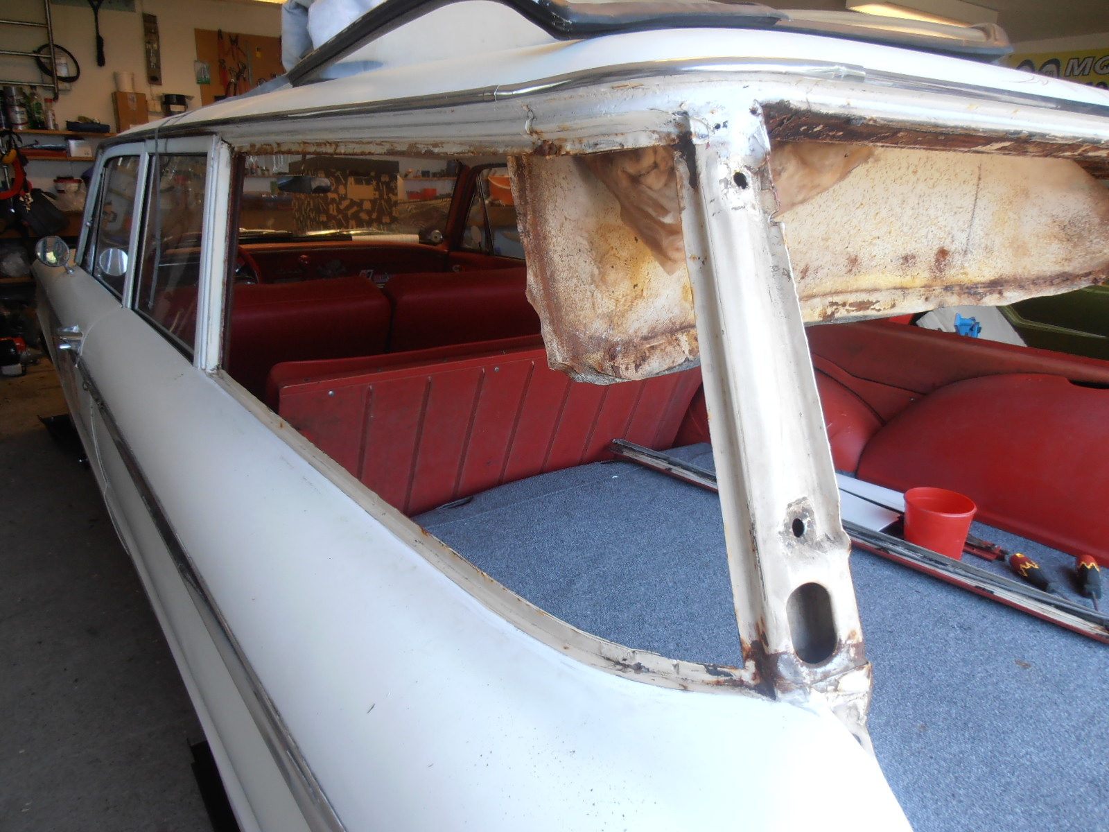

    First task is tackle with tailgate... Inner part of the tailgate is cracked and rusted so you can't put any extra weight on it or it might get broken even more. I think that inner part will be really tricky to fix but I'll figure it out how to do it. There is also rust spots outside...

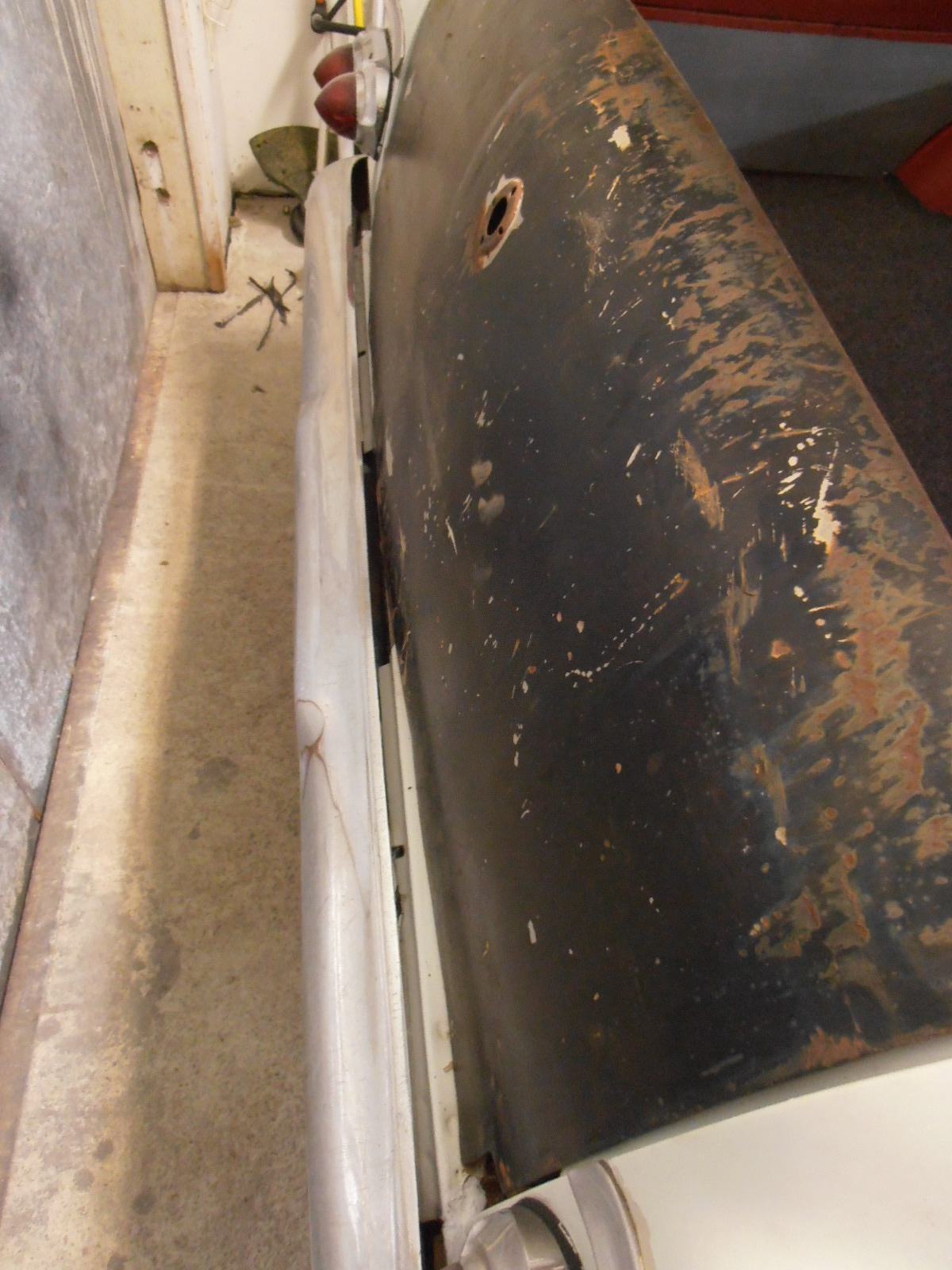

  14. JiiTee
    Joined: Oct 5, 2010
    Posts: 226
    JiiTee
    from Finland
    Ok, tailgate is out of the car and also rear side gl***es.
    I parted the tailgate and it's bad enough to think a buy better one. Well, easier to say than done because I think it would be pretty hard to find one, so maybe I have to fix old one. I'll try to hunt one down but if I don't find it I have to take the skin out of the tailgate to fix it good.
    Few pics...

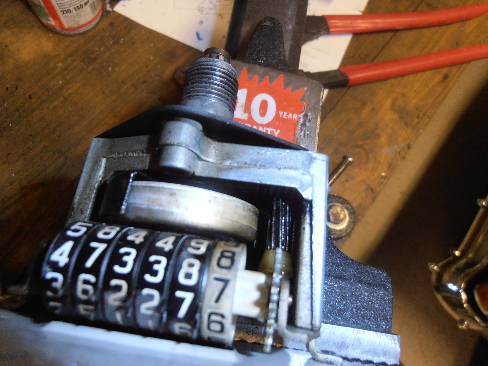

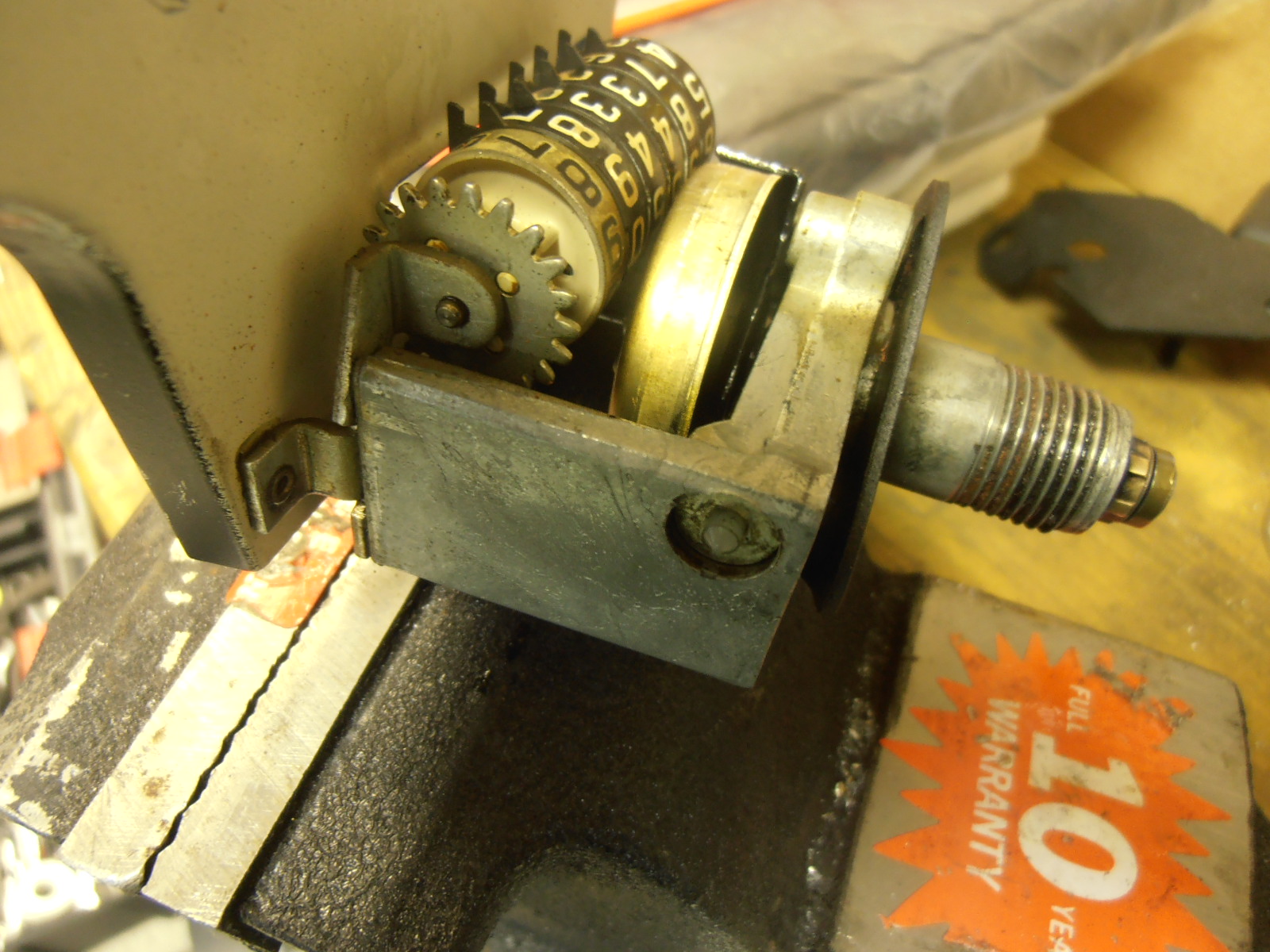

    I took the instrument cluster out of the car because odometer didn't work and speedometer needle got stuck when the speed got up to 50.
    Found out that one of the odometer gears was loose and one washer was bottom of the speedo. Facia plate is also loose and this might cause non working speedo.
    If someone could help me and tell me how this gear should stay there?? Now it comes out so much that washer drops and odo stops working. Check the photos...

    One end of the shaft that holds the tumblers and big gear together should have a "spring steel" clip that holds everything in place.

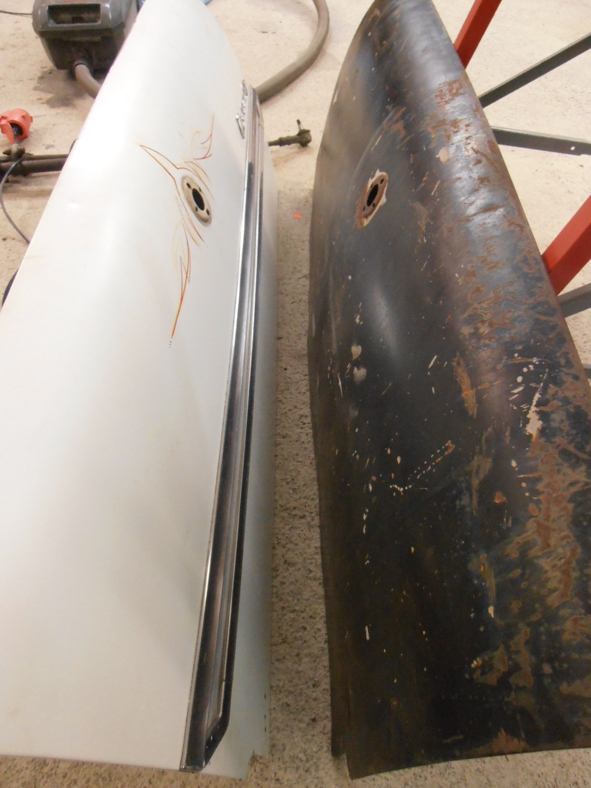

    Well, this wasn't true! Today I picked up this tailgate and it's a f...kin nightmare also. I can't find words 'cos I'm so pissed off right now. :mad:
    Pics tell more than words...

  21. JiiTee
    Joined: Oct 5, 2010
    Posts: 226
    JiiTee
    from Finland
    It's too bent and twisted that it's fubar. I f...kin waited this **** almost two months. I have to figure out something...:confused:

  23. JiiTee
    Joined: Oct 5, 2010
    Posts: 226
    JiiTee
    from Finland
    Might be same size but the inner part looks totally different. I don't want to spend any more cash for tailgates. Now I have two ****ty tailgates but I just have to build one good tailgate out of two bads. I made a good plan while sleeping...:D

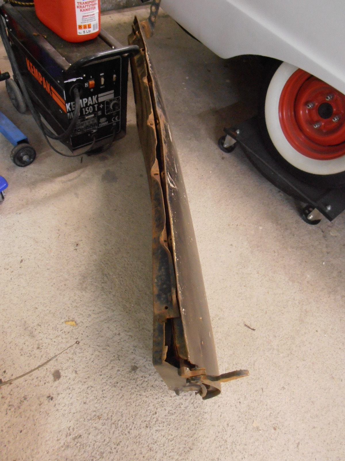

  27. JiiTee
    Joined: Oct 5, 2010
    Posts: 226
    JiiTee
    from Finland
    So I did skin those tailgates and now I have Comet tailgate build kit. Let's see what I decide to do but first there's some rust removal.

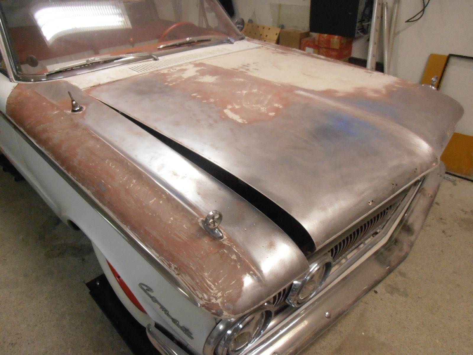

    Also I have started to remove the paint from body. It's coming out pretty easily when using hot air blower and s****er. That's slow way to work but I don't want to cover everything with dust.

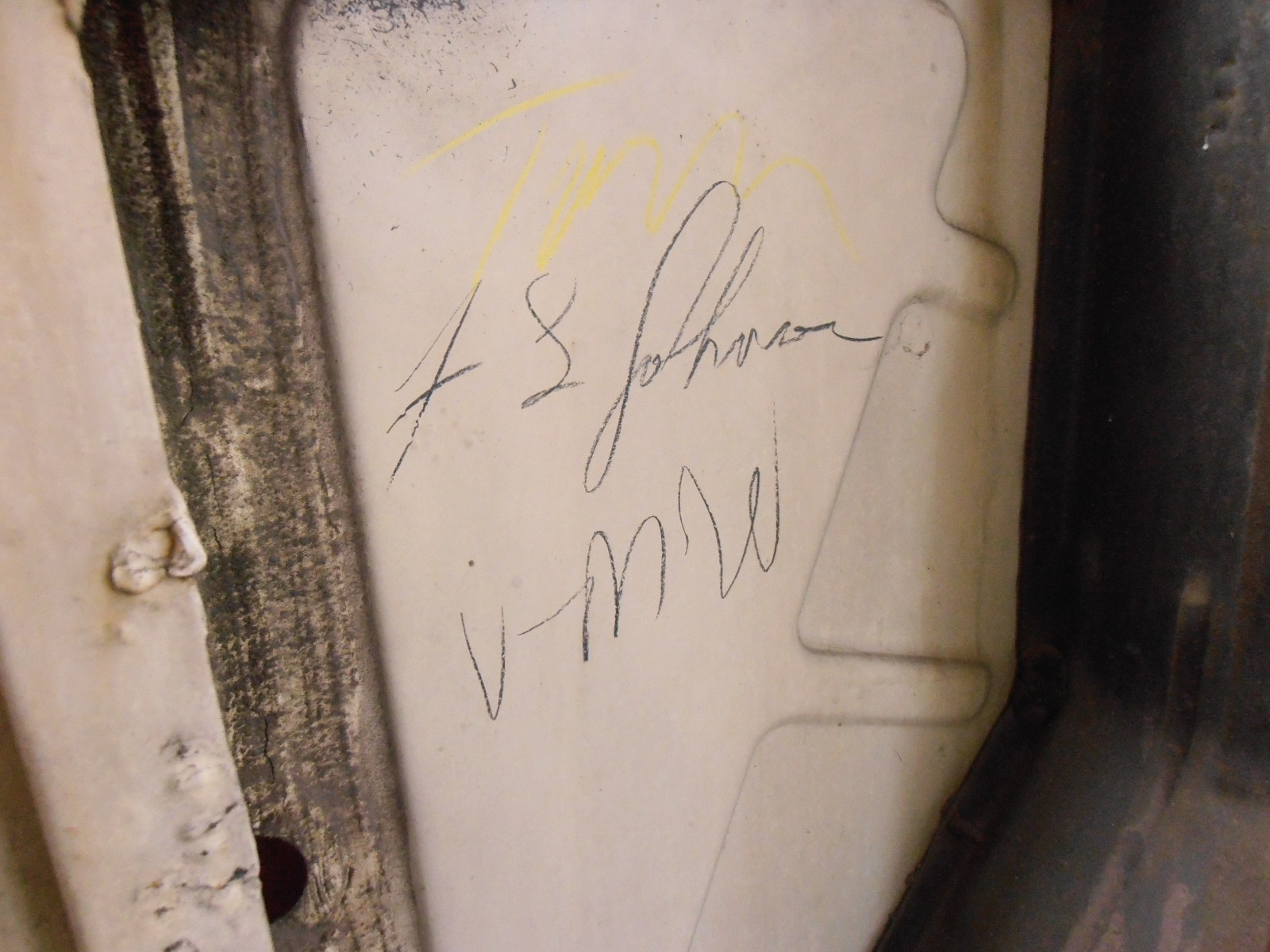

  28. JiiTee
    Joined: Oct 5, 2010
    Posts: 226
    JiiTee
    from Finland

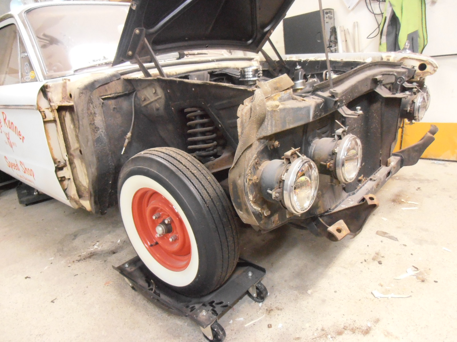

    Yesterday I started to part out the front. Bumper, grill and right fender is now out of the car. When I pulled the right fender out of the car I found few autographs from inner fender wall! Builders left their bookmark in my car... How common this was back then?

  30. Flattop Rook
    Joined: Jul 17, 2011
    Posts: 60
    Flattop Rook
    from Australia
    Don't know of these in production line cars, but I have always signed work on old cars when doing any timber or coach work fur some one to find, I hope they will any way, never been contacted YET! :p
