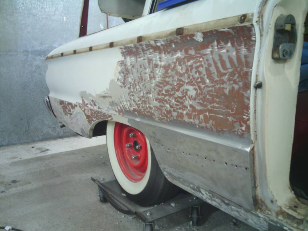

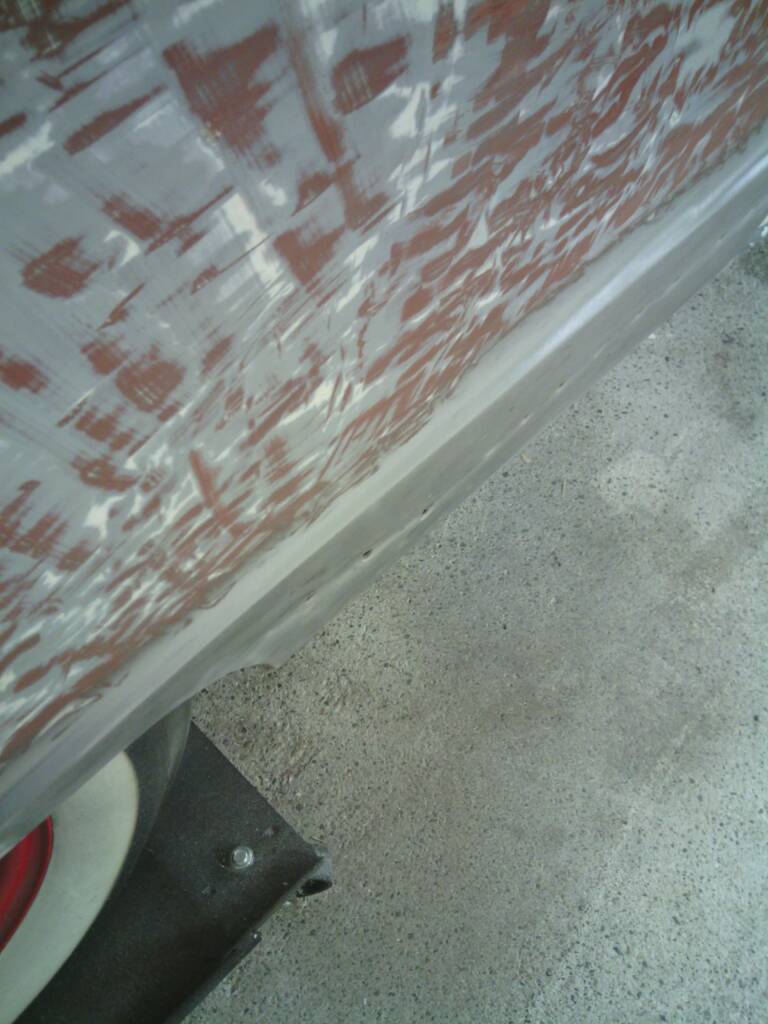

    Removed few mouldings from right rear fender and started to strip paint. Since right door had dent on the lower part so it was almost clear that rear quarter has also dents. So there was and all the repair was done with tons of bondo. I think that I have to buy repair panel for it because dent is pretty nasty. Best part is that there's only surface rust...

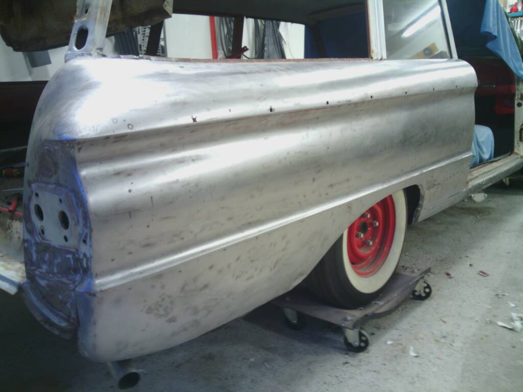

    Right/Left rear fenders are now clear from old paint. Today I had some time to work with roof and that's now also bare steel. Borrowed some tools from work that I could get few dents straightened from both fender.

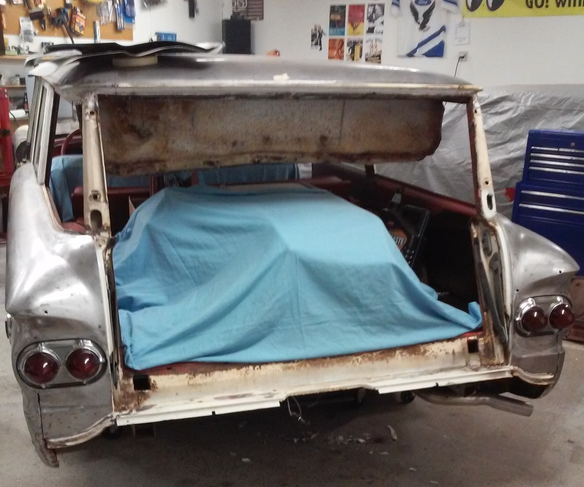

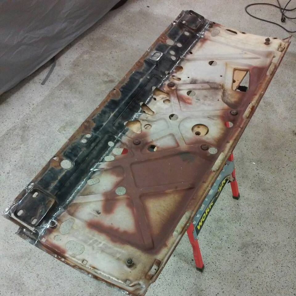

    Tiny update... Yesterday I started to work with tailgate again. Took both frames to made one good out of them. Grinded about 5 inches from better tailgate and welded it to original tailgate. Frame is now ready for sandblast and paint.

    Nice to see some progress with the Comet and looks like you found a solution for the tail gate issues.Keep up the good work!

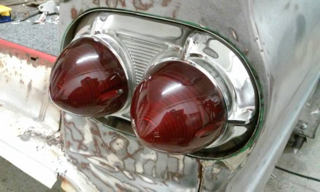

    Tonight I had time to play with tail lights so I started to recessing them a little bit. First pic is stock and second is recessed. I didn't weld it yet just trying to figure how deep I want them to be.

    it looks good so far, nice touch.

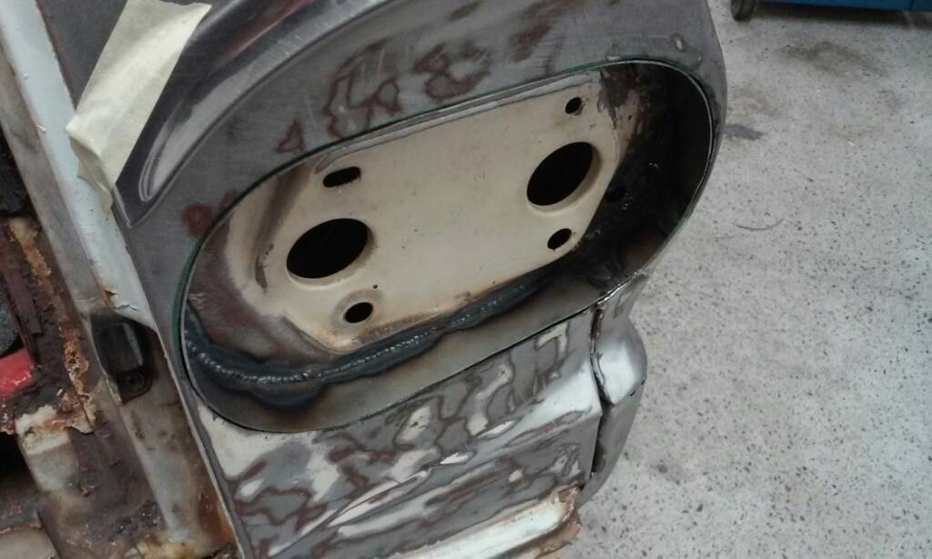

    I have to take my welding gas bottle to 10 year inspection so there won't be any updates for a while but I did something at this weekend.

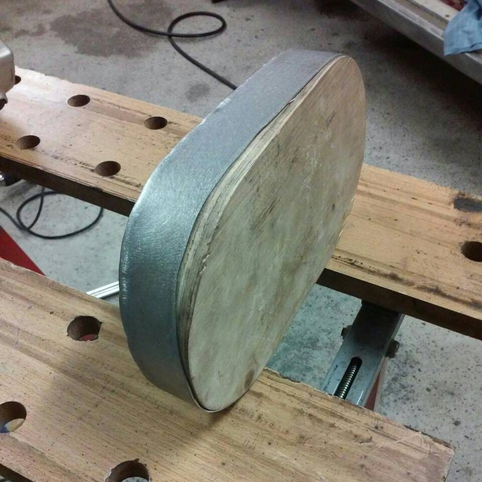

    I cutted a slice of sheet metal and started to fabricate a bucket for a right side tail light. Since the bottom of the tail light is far from straight I used old cutted piece as a bottom of the bucket to get a right fitment for the light. Stock lights aren't easiest lights to recess...

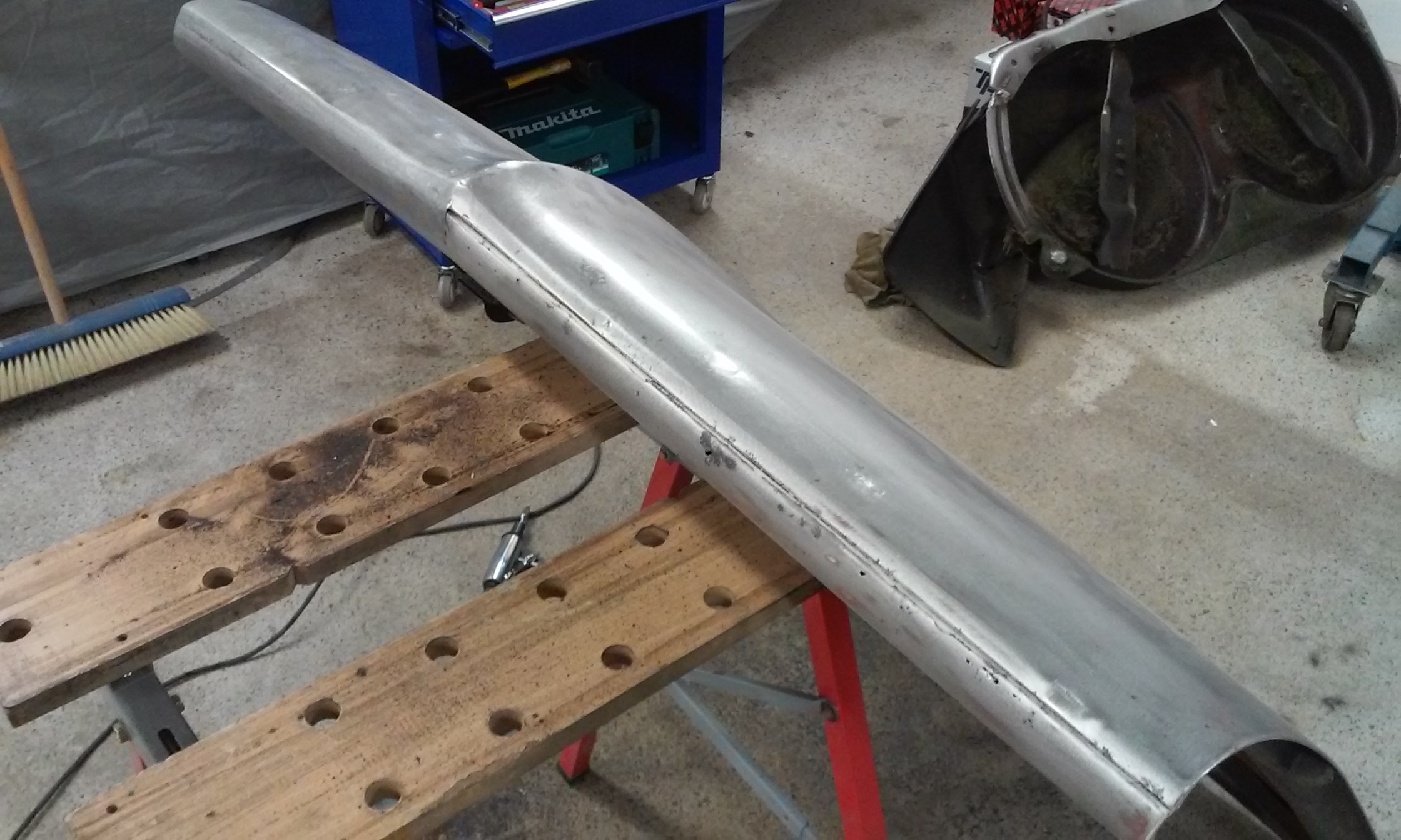

    Been kind of lazy lately with updates in here but here is something small to update. Both tail lights are now recessed so that's done so far. Hood had lots of pinholes on front so I fabricated a new "lip" from sheet metal. Left side is now ready. Since it must be fixed I can also shave that seam from hood to get nicer look. Rear.jpg IMG_20150118_171031.jpg IMG_20150118_180041.jpg IMG_20150119_192245.jpg

    Nice touch on the hood repair, eliminating the seam really cleans it up.
    Left side is also now done so hood is ready for prep work. Next I have to finish tailgate repair so that I can put it back together.

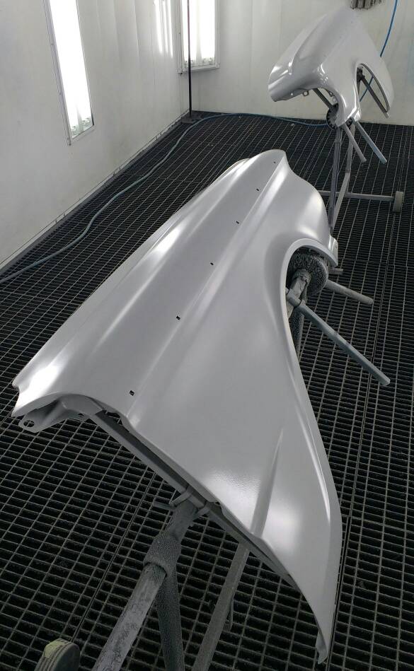

    I had some time today to sandblast front fenders from inside and shot reaction primer on them.

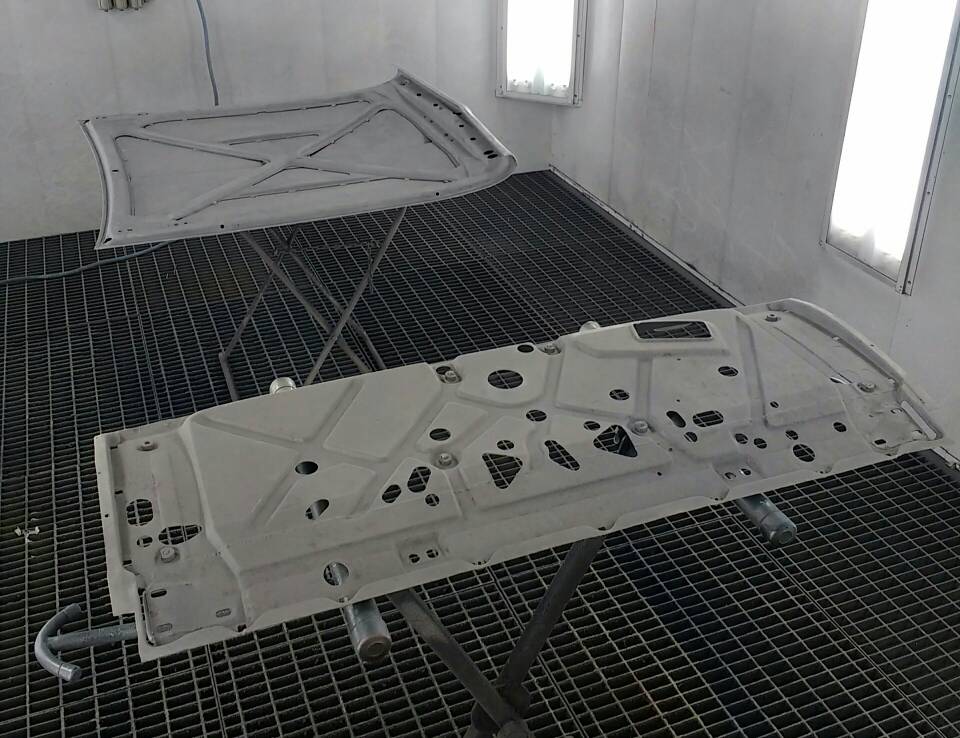

    Today here was sunny day so I decided to sandblast hood and tailgate inner skin. I shot also reaction primer on them. I'm doing this all at my work because my current garage isn't ready yet and so there's no heating at all.

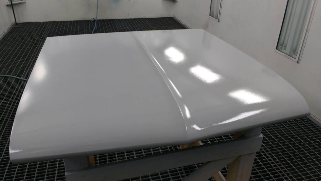

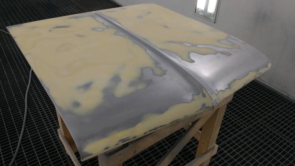

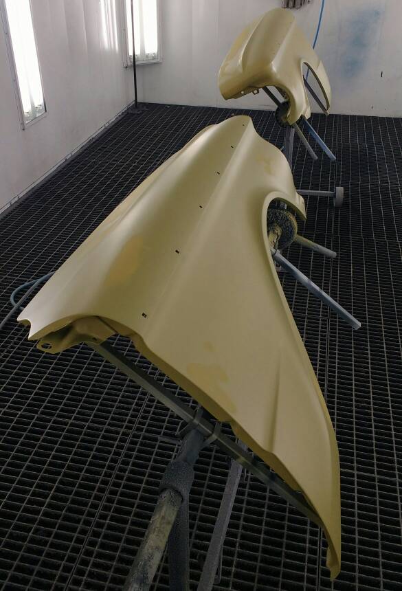

    Time flies and so did my motivation... After a nine months break I finally started to build this again. I did some prep work for hood and front fenders. Now those are primered and ready for blocking. This all took only few hours but damn it was hard to get back on to it. [​IMG][​IMG][​IMG][​IMG][​IMG]
