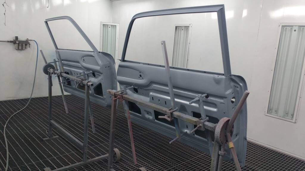

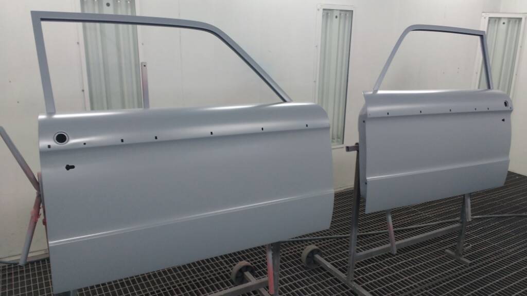

    More progress on the build... Spent few nights working with doors and all the prep work are now done. Almost forgot to take pics but here's few. [​IMG][​IMG][​IMG]

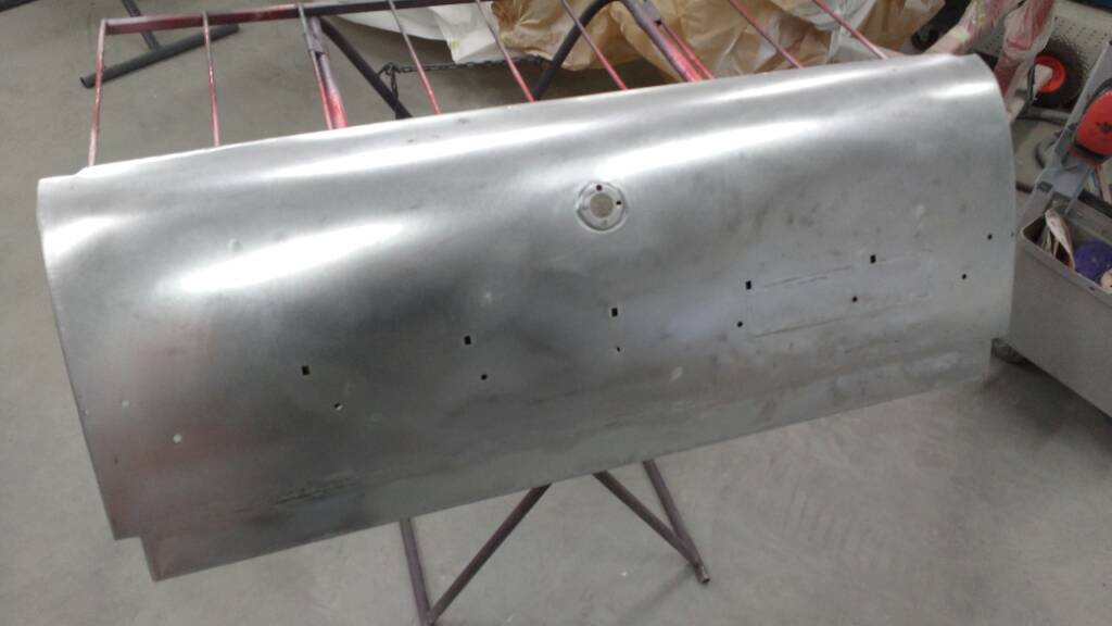

    There's been some daily driver **** and paint jobs for others going on so I haven't got any time for this. When I got a little time I worked with tailgate. Skin needed a new lower section so I fadricated it from sheet metal and weld it on. Result was far from perfect and what I wanted but hey it's rust free tailgate now! After hammer and dolly treatment it was decent enough to do prep work. I did all prep work today and now it's ready for primer. IMG_20170126_153101887.jpg IMG_20170126_163146855.jpg IMG_20170330_195212846.jpg

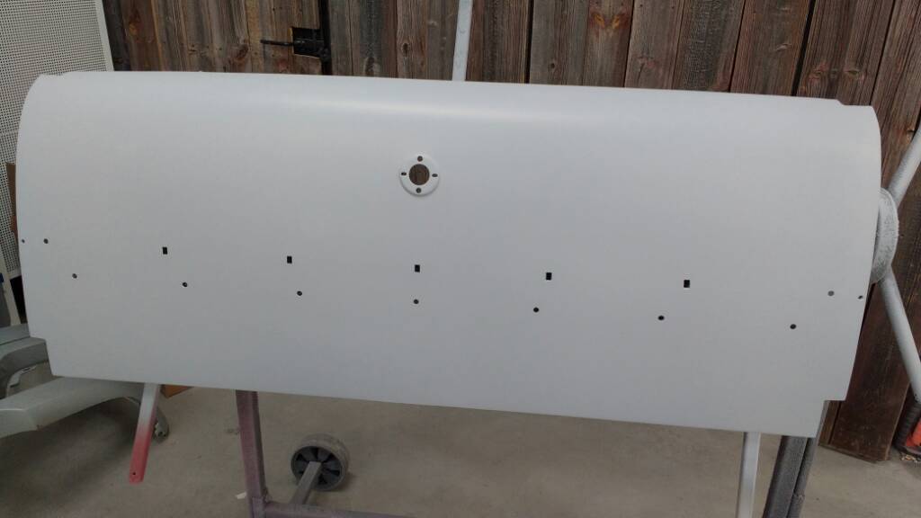

    Yesterday I shot primers to the tailgate. Hood, front fenders, doors and tailgate are now ready for blocking. Next task is rest of the body but before that I have to finish my garage. IMG_20170404_144017062.jpg IMG_20170405_060158440.jpg
    Sent from my MotoG3 using The H.A.M.B. mobile app

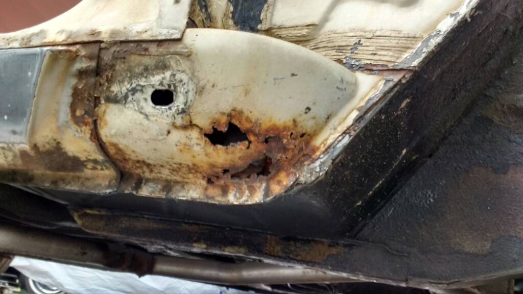

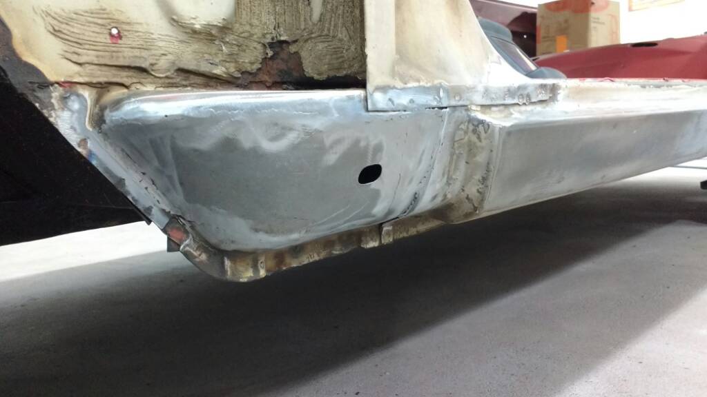

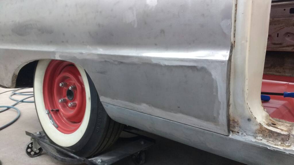

    Been working with dents on the right side and rust hole on the right rocker. When you got just few hammers, dollies and small anvil it will take forever to make patches out of sheet metal. Well there's plenty of time to do some magic with ****ty tools. Front fender will cover front of the rocker so it turned out way too good. [emoji38] IMG_20171213_164430671.jpg IMG_20171213_193111659.jpg IMG_20171214_164331807_HDR.jpg IMG_20171214_164834724.jpg IMG_20171214_183622813.jpg

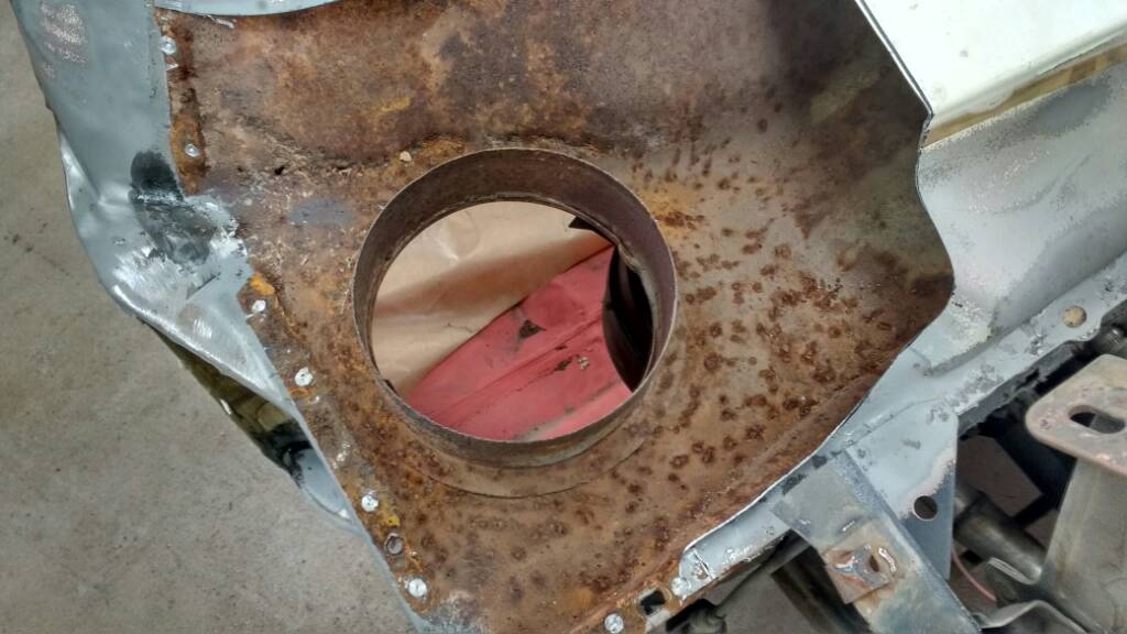

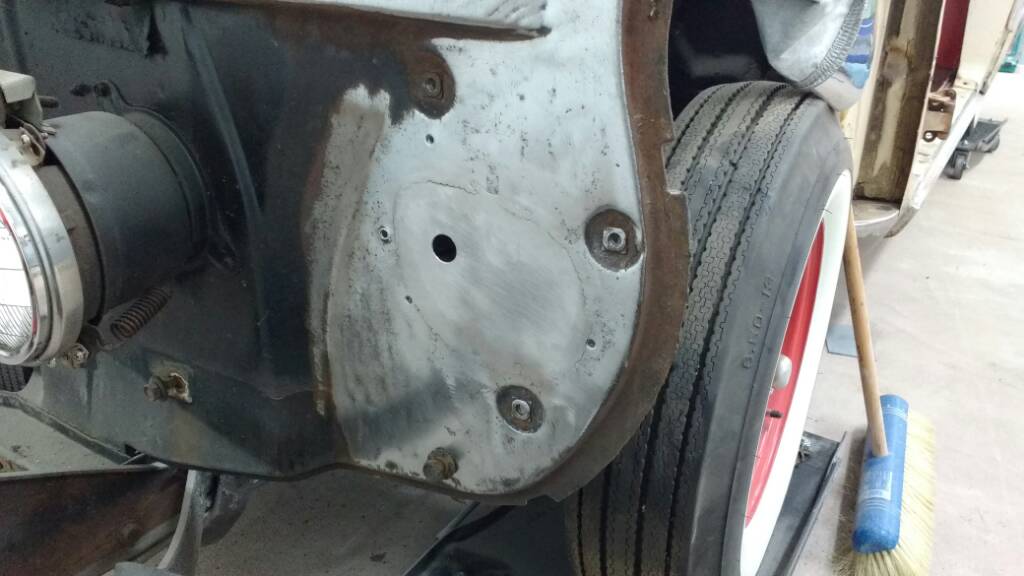

    I started to work on left side which was way worse than right. First I cut roughly all rusted metal out just to find out that inner wheel well was also badly rusted. It was time to find that big piece of sheet metal again and make a wheel well out of it. I left little of old wheel well just to make sure that wheel opening stays in right shape. IMG_20171219_200956325.jpg IMG_20171221_173955063.jpg IMG_20171221_194010453.jpg
    After inner wheel well was welded it was time to get that quarter panel fixed. I had that repair panel for Macs but it took quite long to get it in right place and shape. Had to do some reshaping before it was ready to weld. Since repair panel was for sedan it was also too short to get all rust fixed by one piece. Rear of quarter still needs a patch so I didn't weld one seam and left it open. IMG_20171223_160917883.jpg IMG_20171223_170346098.jpg IMG_20171223_170757785.jpg

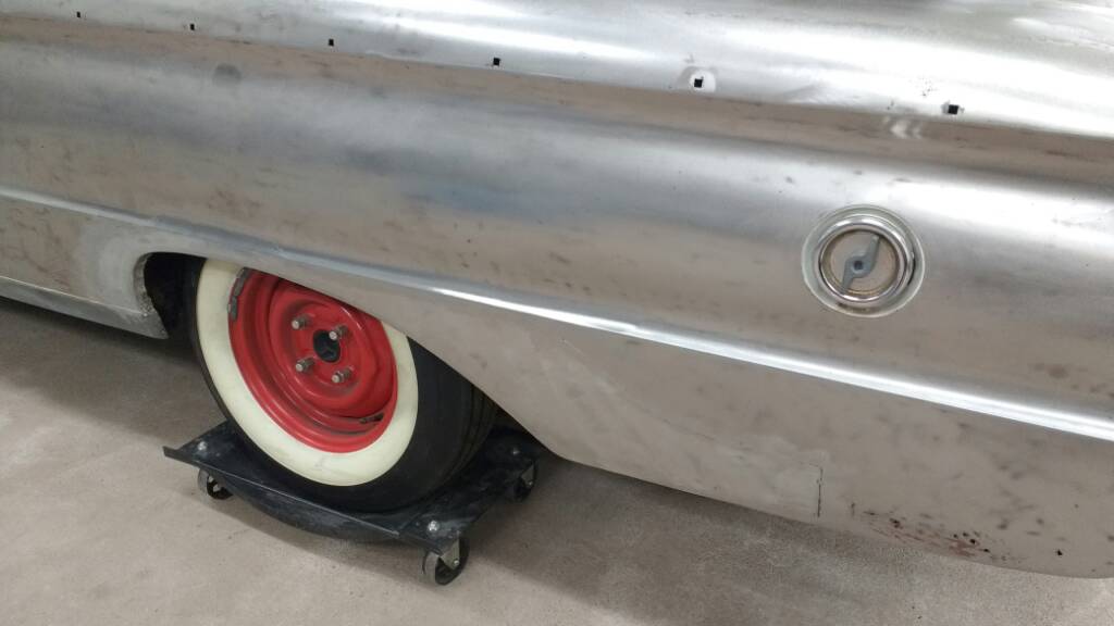

    I have been thinking options for gas cap because that stock one is no go in this build. It will be deleted that's for sure. I think that I'll go with a flush mount gas cap and relocate filler hole somewhere else.

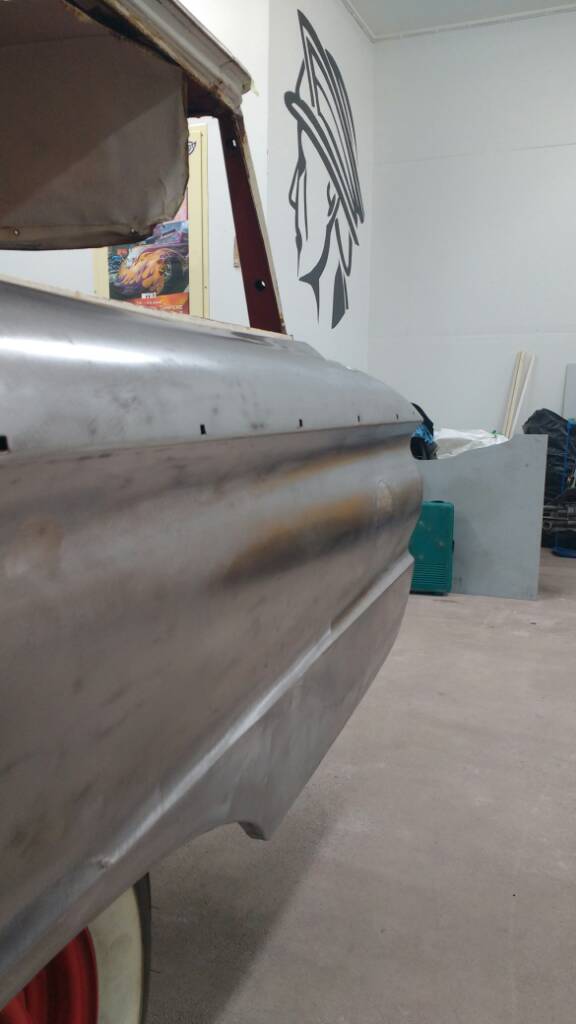

    So I ordered that flush mount gas cap from ebay and received it few days ago. After a quick think it ended up in the top of the fender. Cut the hole for it and gave a little hammering before welding for two sides of the hole to get that steel bung to fit little better. I also cut old gas cap opening out, fabricated a patch to fill it up and welded it. Now left rear fender has nice smooth lines. I dig that... IMG_20180120_142837386_HDR.jpg IMG_20180120_161504.jpg IMG_20180120_174040.jpg IMG_20180120_161732569.jpg

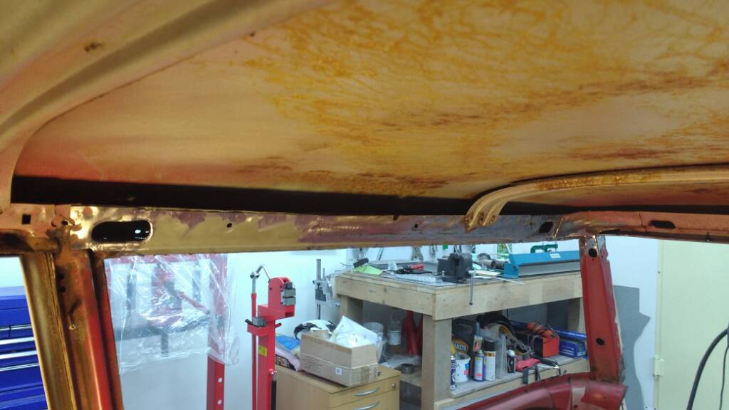

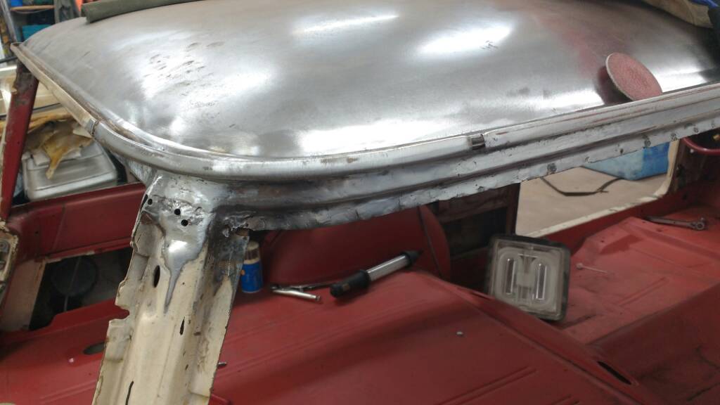

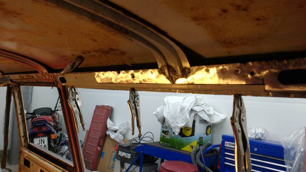

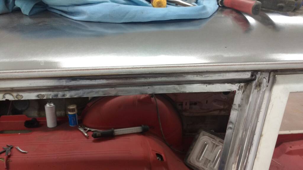

    Left rear quarter is now ready for prep job. Windshield was still on the car and headliner so I removed them. After the headliner was out I found some more rotten metal from right side rear quarter window opening. Inside and outside was rusted out. This car is getting on my nerves with all this rust... [emoji36]
    Also left rocker had same rust issue as right side so that had to care of too and after I removed head lights I found some rot under left low beam bucket. Weld weld weld... F...k I need a beer.
    Looks like I have lost some pics from my phone but here's few shots.[​IMG][​IMG][​IMG][​IMG][​IMG][​IMG][​IMG][​IMG][​IMG]

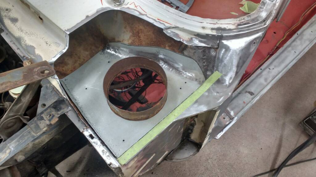

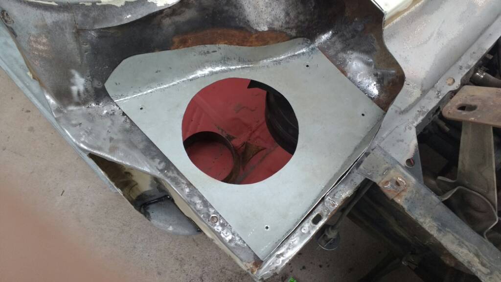

    It's really hard to see from small side holes how bad cowl is so it was time to do a surgery... Well it's bad but let's stay positive because it really could be much worse. I thought that all welds would be done by end of this month but it might take longer...[​IMG]

    Repair panel is coming along faster than I thought. Air box hat needs some rust removal before I can weld it to the new panel.[​IMG][​IMG]
