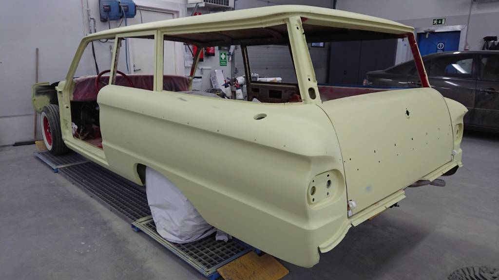

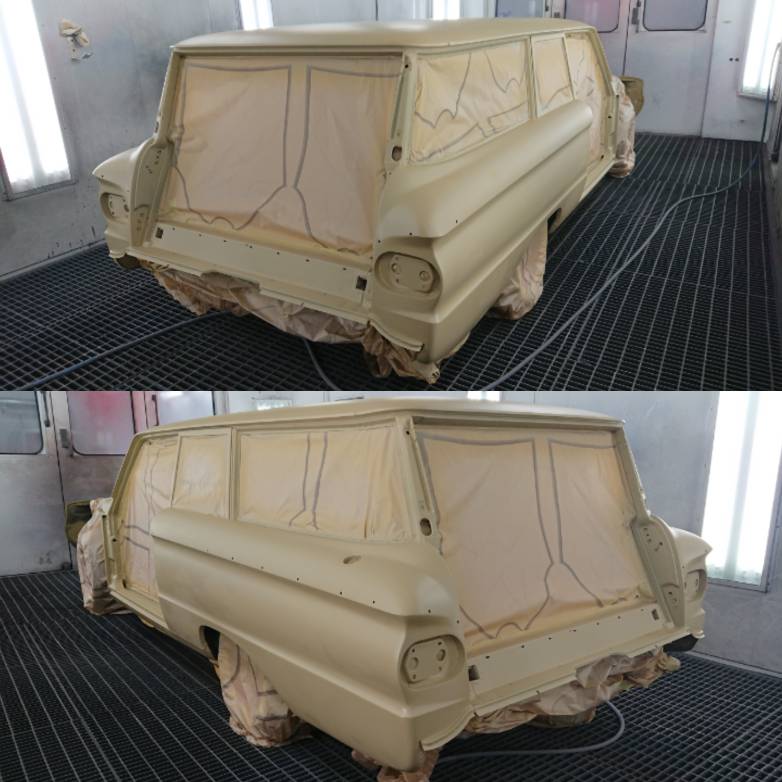

    It was midsummer weekend here in Finland and I think most of Finns were having fun but I had different fun at this weekend. Hauled the wagon to our shop for shooting primers because it much nicer to do it in a booth. Now I'll let it dry well few weeks before blocking and final primer. Somehow I can't add original pics from my phone maybe file size is too big or something. Running them through layout app and then add those pics seems to work. IMG_20180624_190754.jpeg IMG_20180624_192049.jpeg

    Thanks! Finally whole car is in first primer!
    Thanks! I'm not sure about popeye arms but fingerprints will be almost gone for sure! [emoji1]

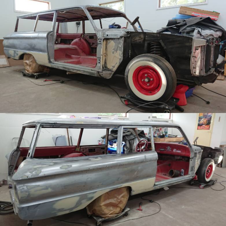

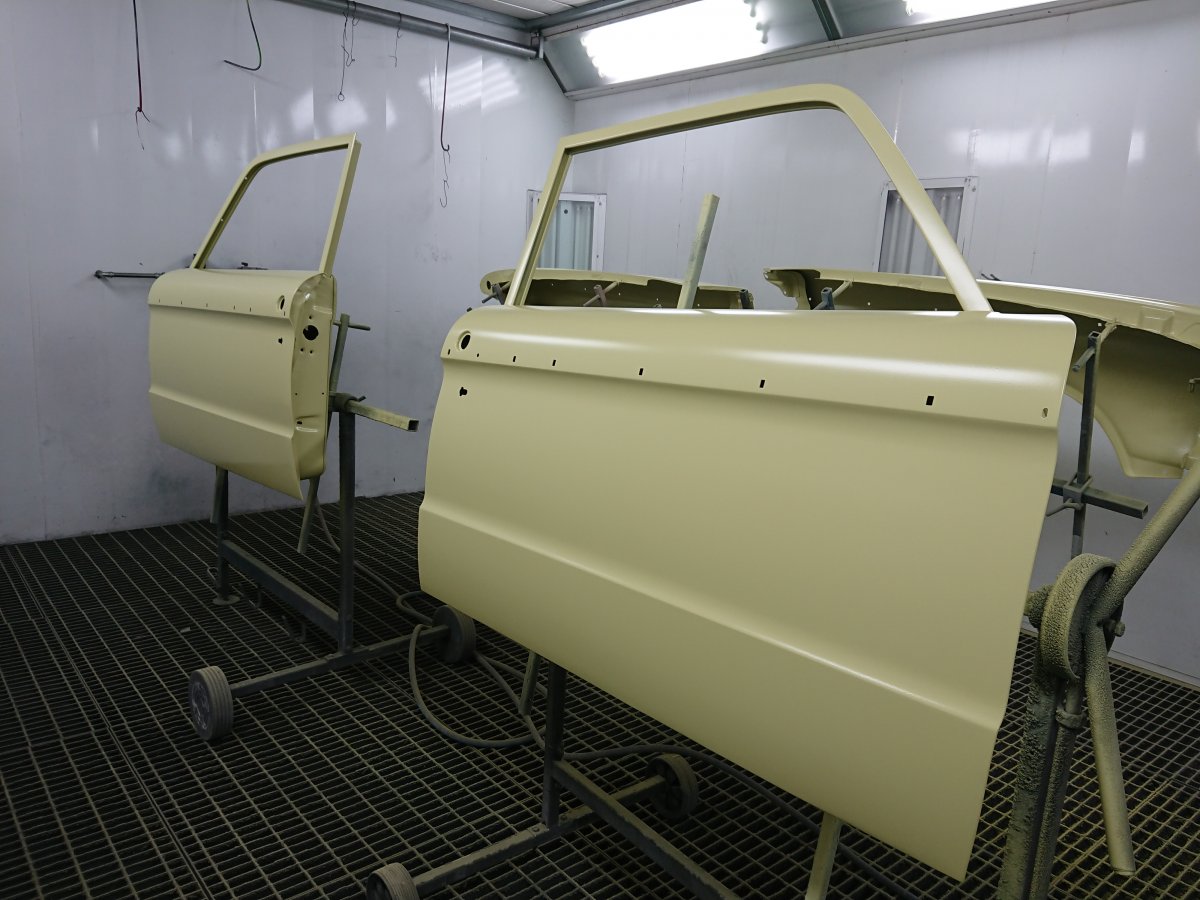

    Summer was so damn hot in here that I did something else like laying at the beach with my son. Made few trips to here and there but now all summer fun is over. There's been some daily driver **** going on also so it was hard to find any time to start blocking but this week I forced myself to start doing that. Got it almost straight in a first attempt but left front fender and hood needed some more attention. Door jambs and rockers needs to be sanded before rest of the body can be shot with final primer. All the loose parts got final primer today.

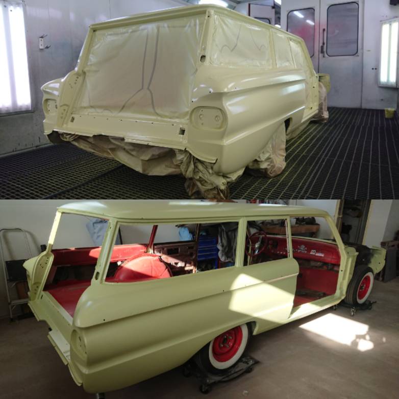

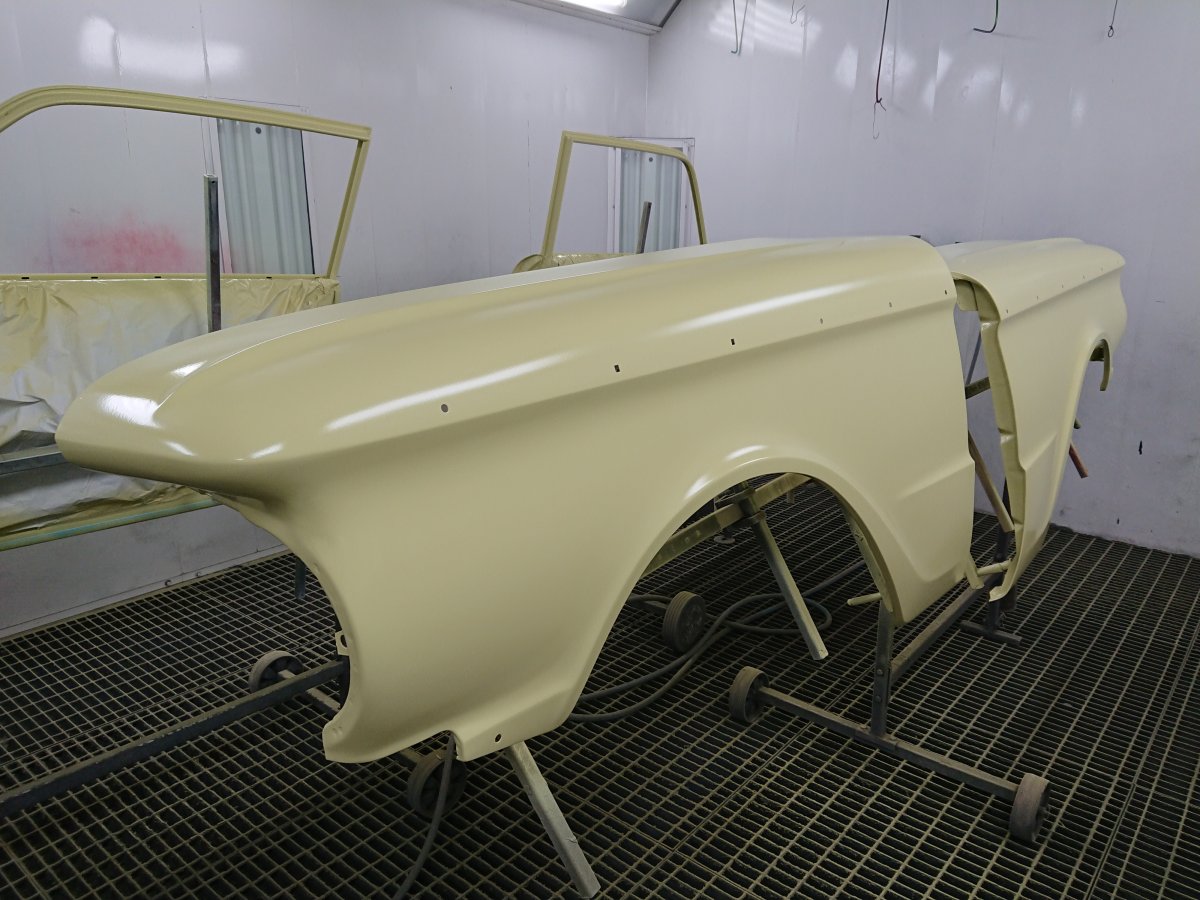

    Now this project is really running on high gear. Body was blocked, sanded and primered for a last time on saturday. There are now several parts ready for paint, front fenders, doors etc... Dash is also now in primer. I left the car to our shop so I really have to do it almost every day. Funny how motivation goes higher every day because you'll see it all the time while doing daily work. I'm going to change that red color on interior parts to a little lighter red so there's gonna be some extra work. IMG_20181013_122939_540.jpeg IMG_20181017_190349.jpeg

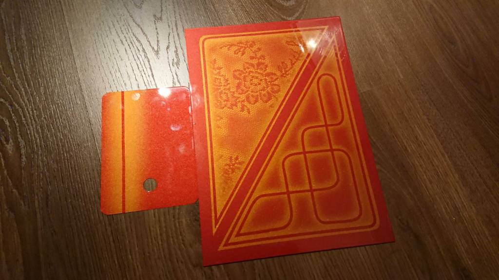

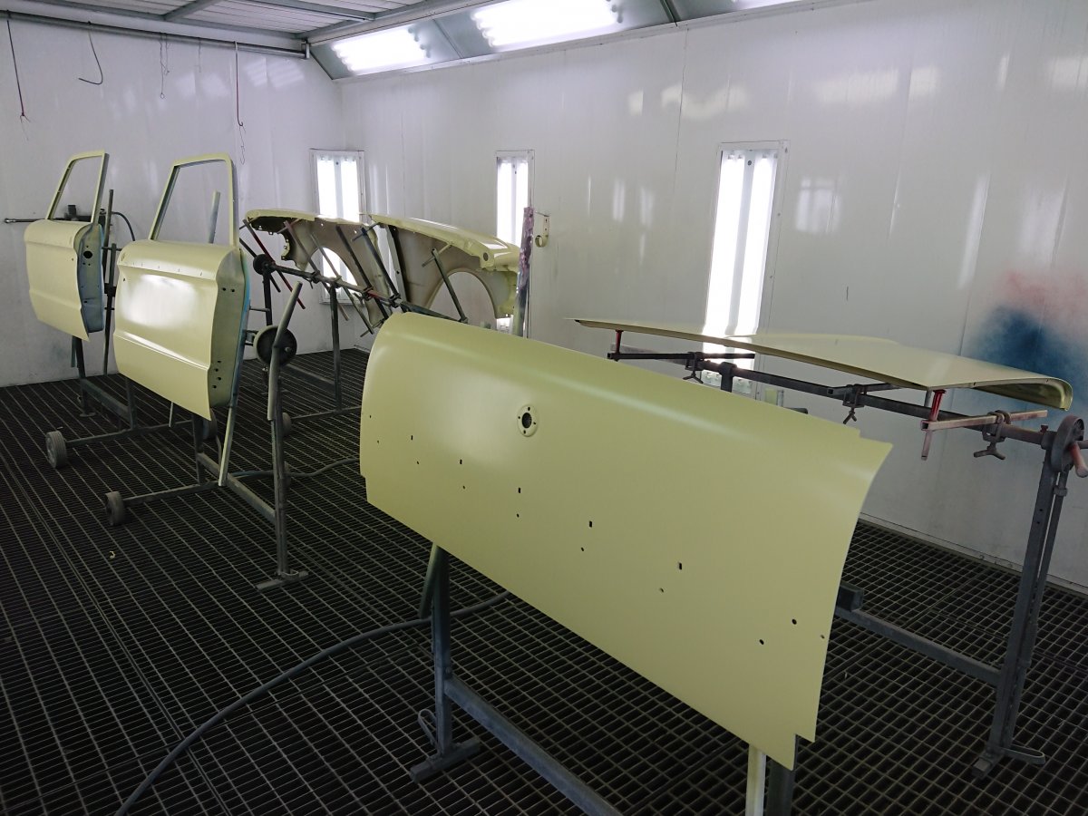

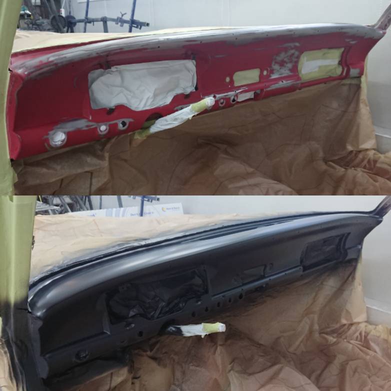

    Dashboard, glovebox door and few other parts are now ready for paint. Last week I also shot some test panels only to make that red paint decision harder. Well not only that because I wanted to look how that orange pearl goes with pearl red. 1540226182574.jpeg

    That red on the dash is the original color, or primer?

    Thanks! That was original color or what was left of it after all these years.

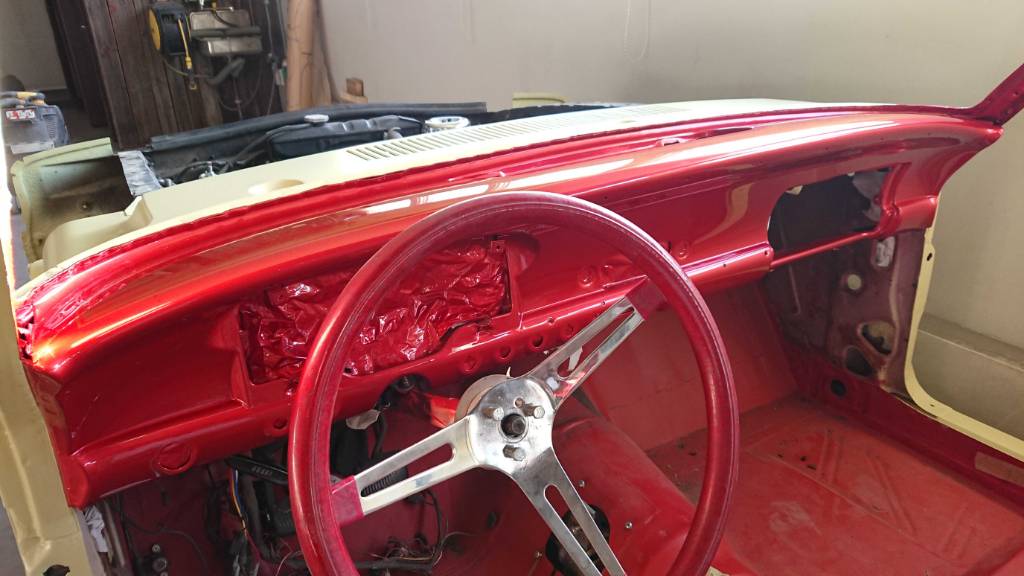

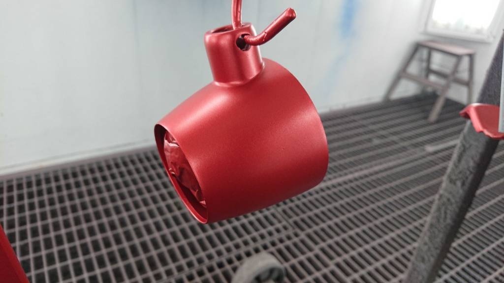

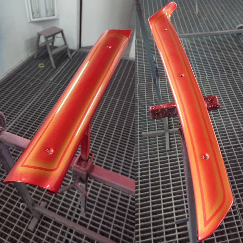

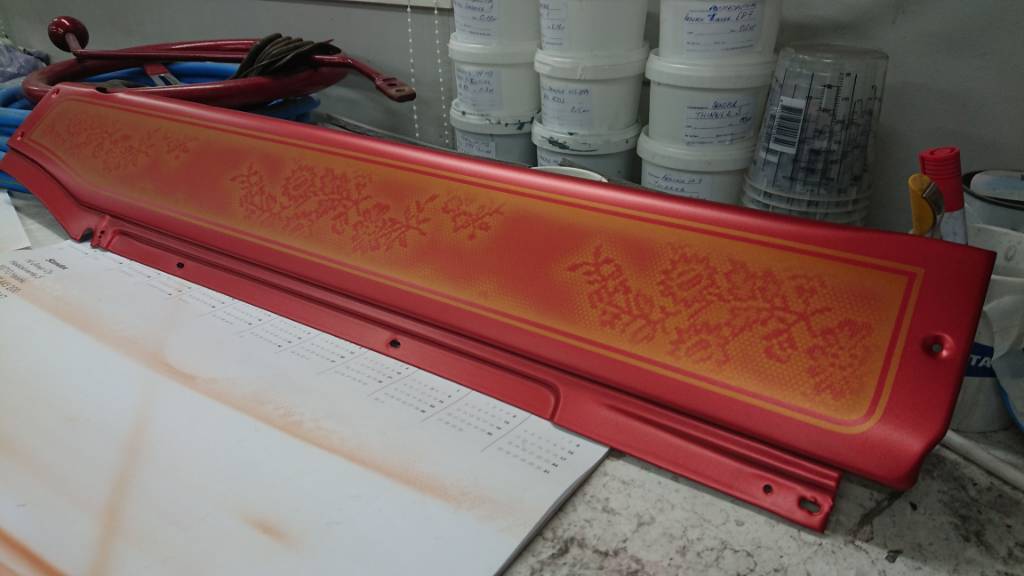

    Whole weekend was full of painting. Dashboard, side panels, moldings etc got some fresh paint. Several hours later interior is almost done now. IMG-20181026-WA0003.jpeg IMG_20181027_144834.jpeg IMG_20181027_164543.jpeg 1540729295357.jpeg

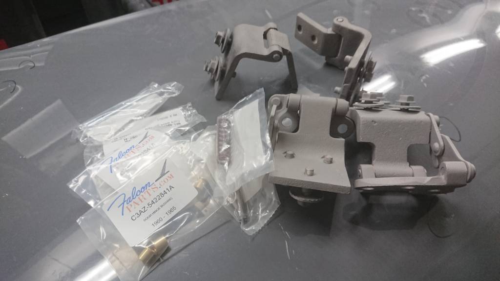

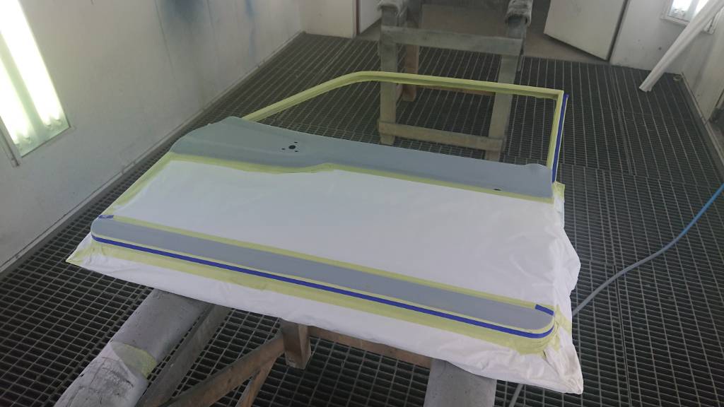

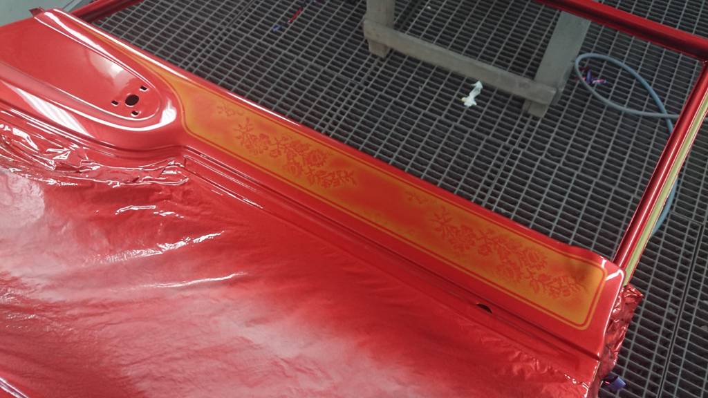

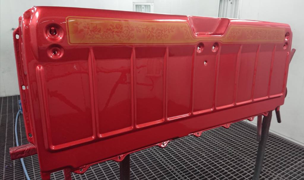

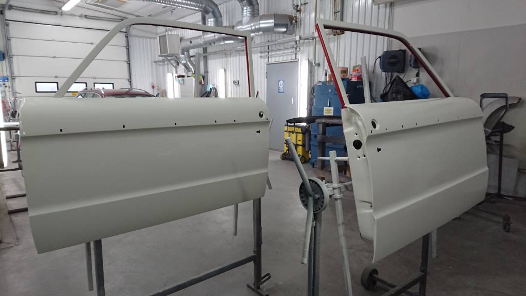

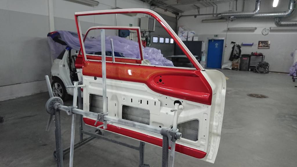

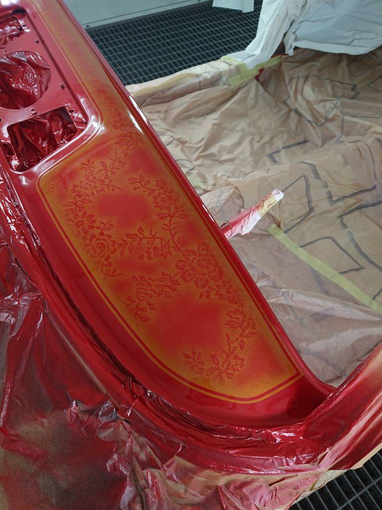

    Last week my parts order finally came so I blasted hinges, replaced bushes, pins and springs with new ones and then primered them. Turned out good as new. Saturday I had some time to paint doors from inside with red where it's required. Threw some lacing also here. Few small parts got some red paint too. DSC_0421.jpeg DSC_0422.jpeg DSC_0425.jpeg

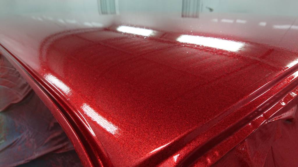

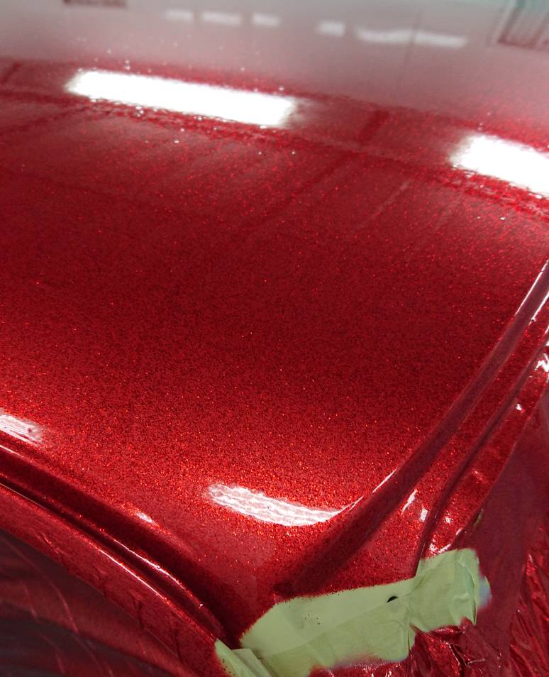

    Here is a last update for this year. Yesterday I shot roof with that same red pearl basecoat what's interior is painted and then flaked it. Now it can cure over holidays before sanding and final clear. Loose parts are also painted with white acrylic paint what's going to be base for a white pearl. DSC_0433.jpeg _20181223_085336.jpeg DSC_0428.jpeg DSC_0430.jpeg

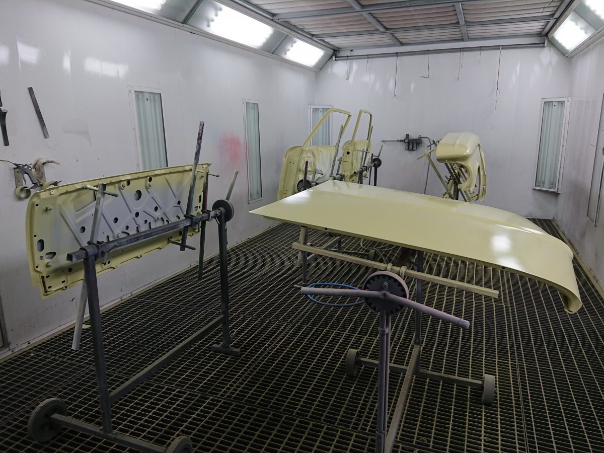

    Joined: Oct 5, 2010
    Posts: 226
    JiiTee
    from Finland

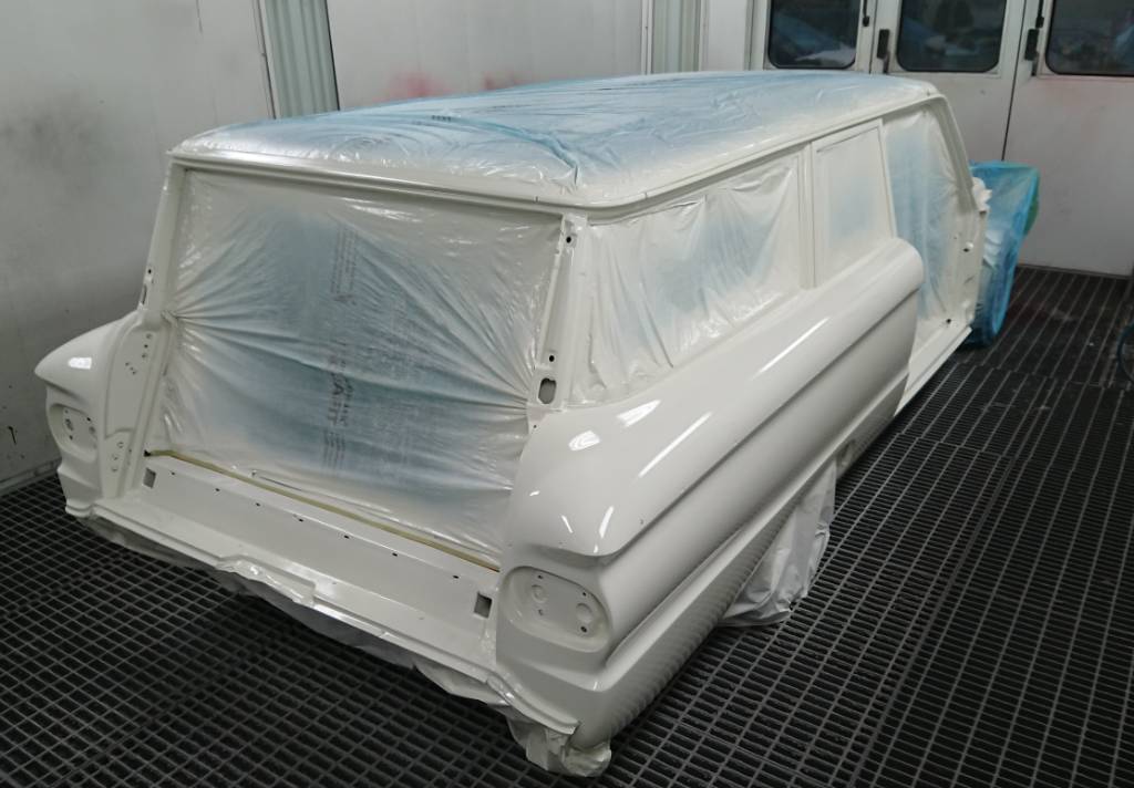

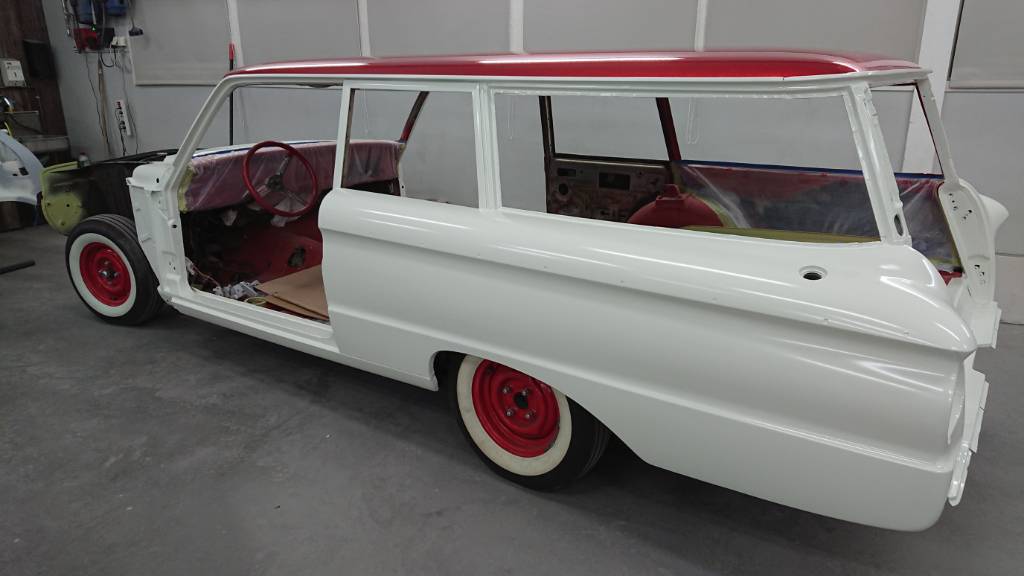

    I thought yesterday that I'll paint rest of the car today. It takes so long that I didn't want to do it after work. So why not to do it on saturday... Mission complete and now it's ready for a custom mixed white pearl. I'm getting quite anxious to finish this paint job. [emoji1] _20190105_181749.jpeg

    Thanks! I think so too although it's just a base color.
