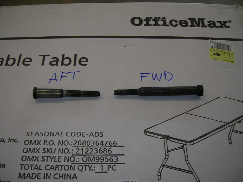

    @FrozenMerc when you modified your lower arms to take the Galaxy front bush, what bolt did you use?
    My bushes are shot and you like to have everything in place before I start.
  11. FrozenMerc
    Joined: Sep 4, 2009
    Posts: 3,419
    FrozenMerc
    I reused the stock Mercury bolts. If I remember correctly, I had to chuck one of them into the lathe and turn the shoulder back. I think that was done on the aft (rear) bolt.
