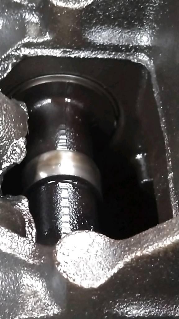

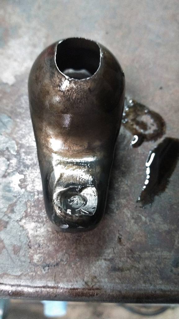

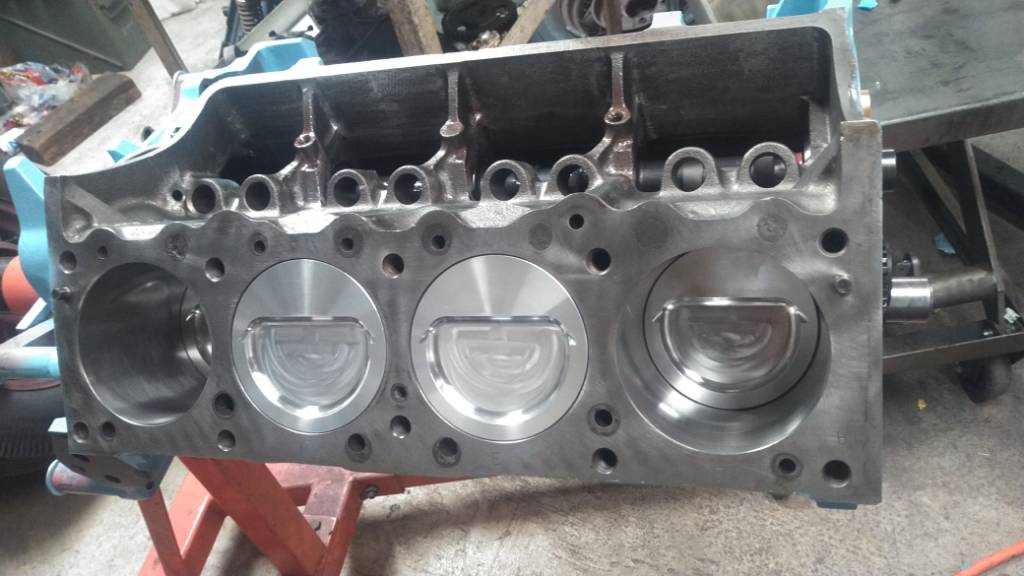

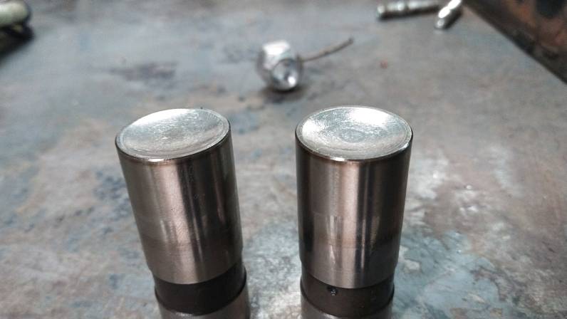

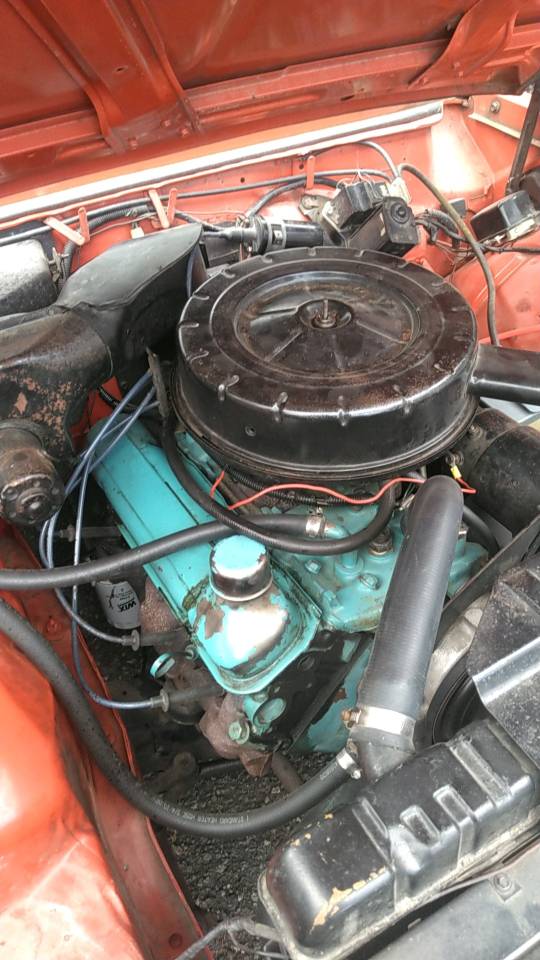

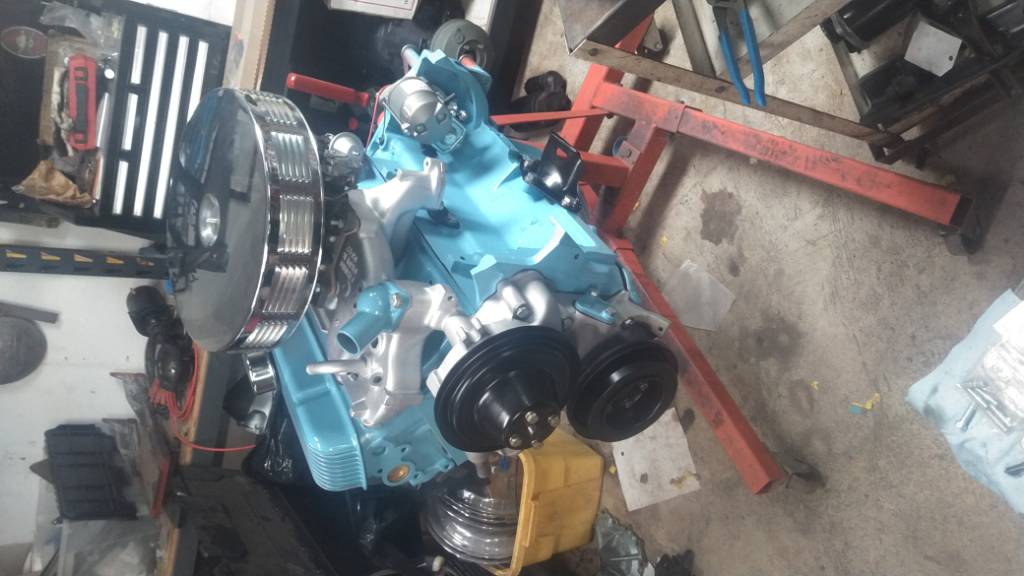

    Well thought I would post a build I am working on while the 46 Chev is at the paint shop. It's a 1962 Pontiac Tempest LeMans. Original trophy 4 cylinder, 4 barrel, 4 speed with 3.55 gears. For those of you who don't know these cars Pontiac took a 389 and cut it in half length wise to make the four cylinder. It actually uses the 389 head and pistons. I bought it was driving home and promptly ran out of gas. LOL while waiting for the GF got a call from the old man I bought it from telling me if the gas gauge says 1/4 tank it's actually empty. Finally got it home and started a tune up I knew it had a gnarly vacuum leak. Finally got that straightened out but just couldn't get it to run right. It ran quiet no Knocking just couldn't make any power. Pulled valve cover to replace gasket and checked the rocker arms 3I and 4I rocker were super loose, not good. So I pulled the intake and valley pan. No lobes left on 3 and 4 intake. So out came the engine and full rebuild is done. That's where I am now. 28332.jpeg 28336.jpeg 28339.jpeg

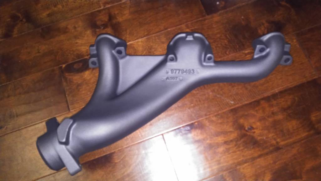

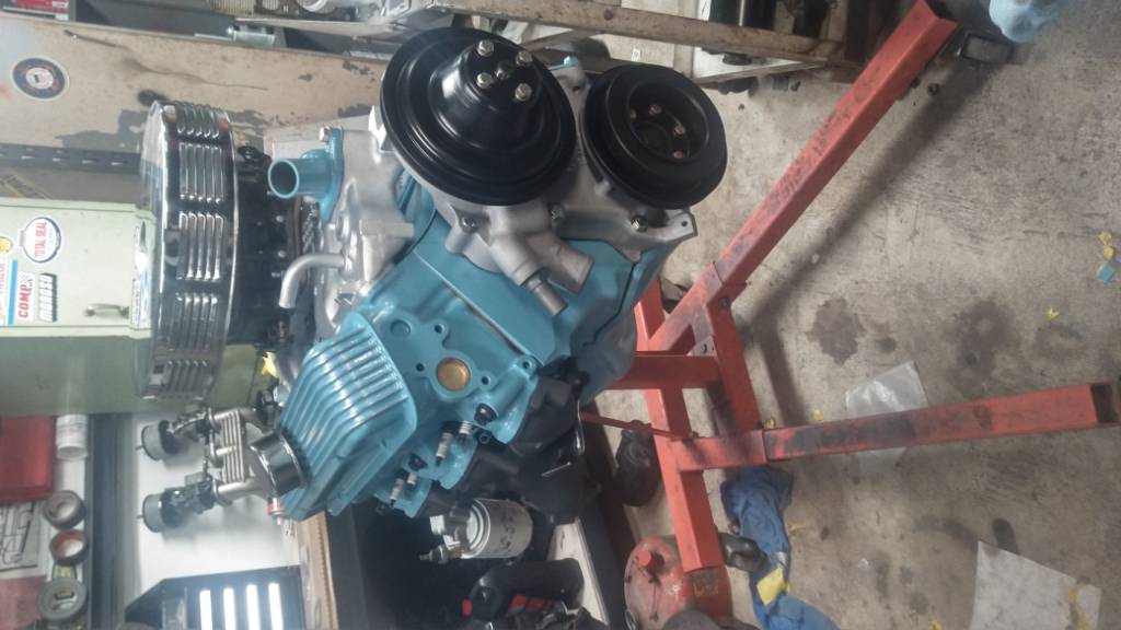

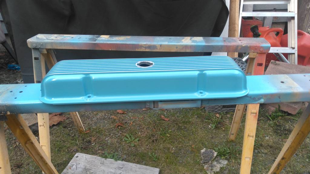

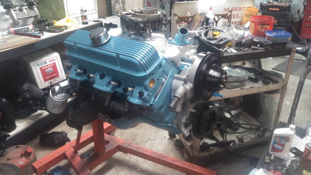

    Rebuild of the original engine. sleeved back to standard bore. Ross pistons, h beam rods, prted and polished head, long branch exhaust manifold and original Cal custom valve cover. KIMG0493.jpeg KIMG0684.jpeg KIMG0789.jpeg KIMG0665.jpeg KIMG0671.jpeg KIMG0824.jpeg KIMG0825.jpeg KIMG0827.jpeg KIMG0828.jpeg

    Nice car, seems that except for the worn out engine it is in real good shape. It's neat that you are keeping the 4 cyl and doing a mild performance rebuild on it. I am sure the increased power will make it even better driver. Was there a problem with just std boring of the block that required the sleeves? Rebuilt engine looks great with the valve cover and long branch exhaust.

    Rest of the drive train is good. Engine was already .040 over. Probably could have just installed new rings but it would have been a little loose. Went with a very slight dish to drop compression from 10.25 to 9.5 to help with drivability.
