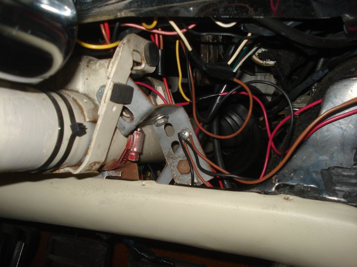

    He's having the same underdash issues of space, etc.
    On the front of the top bracket for the pedals, there was an extension made for holding the swing away column. He has cut that off. I have pics, if I could post them would be nice :mad:

    who ever built the pedal ***embly in mine completely disabled the tilt away feature.
  4. Green Rodz
    Joined: Jan 30, 2011
    Posts: 493
    Green Rodz
    That seems to be the case with my neighbors, too.
    He said you might be able to do it, but he was never of a fan of the swing-away column anyway so he's not planning on trying to figure out how to hook it back up.
    If I ever figure out how to post the pics, I can show you. He's got the whole dash apart and the column is swung all the way to the right and tied up to the p***enger door to keep it out of the way for the time being.

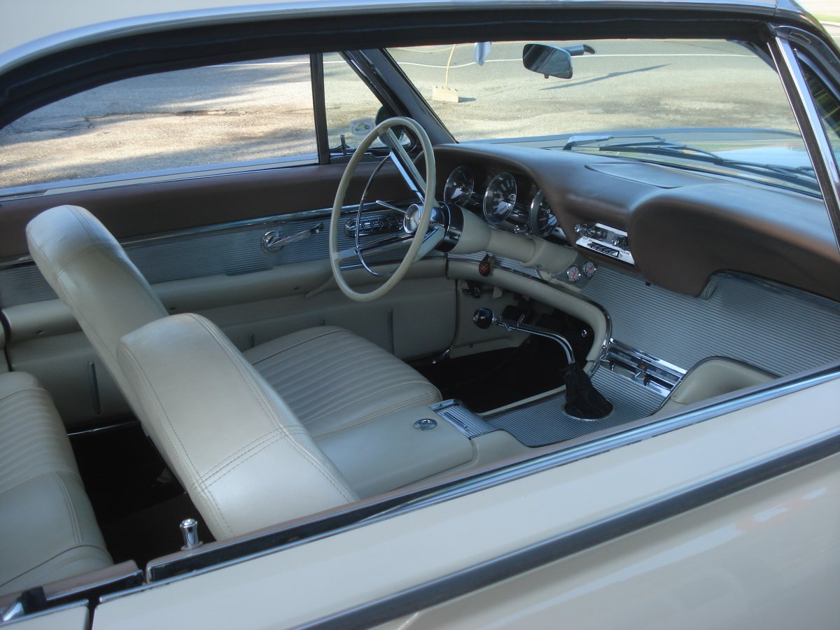

  7. CrusadersNV
    Joined: Feb 1, 2010
    Posts: 158
    CrusadersNV
    heres a pic of my 62 complete with 4 speed
    Unfortunately its tucked away under cover behind a few cars so i wont be able to take photos of the setup. The car anyways is a big 70s style g***er/street freak (or however you want to cl***ify it). it goes like a scared goose but obviously not as much as a lighter car. the 4 speed just gives it that extra touch of fun. my Kustoms are all automatics, glad they are, but i like having a car in my fleet thats able to drop the clutch and smoke'm from time to time. I guess its more of a novelty.

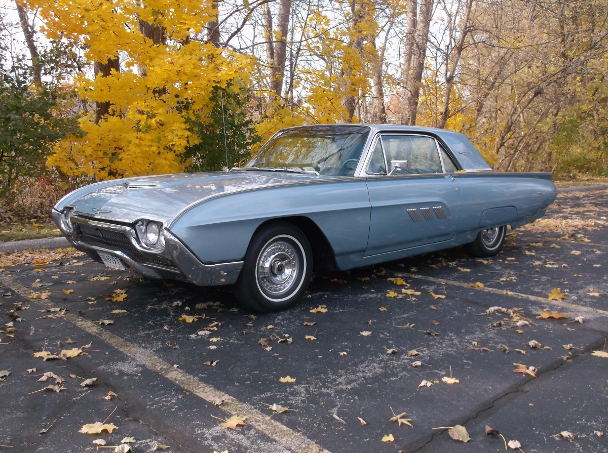

    I have always like these Birds, so yes, let's see some more.
  19. Aaron65
    Joined: Dec 29, 2005
    Posts: 390
    Aaron65
    from Michigan
    I just bought a '63 back in October. I'm currently breaking just about everything in the steering column as I replace a broken shift collar, worn shifter, and worn detent plate. One thing I've noticed: This is not a fast car. A 390 pulling around a 4500 pound T-Bird with air conditioning probably won't be, but at least it will do a decent one-wheel peel. On the plus side, it looks great and rides better than any old car I've ever driven.

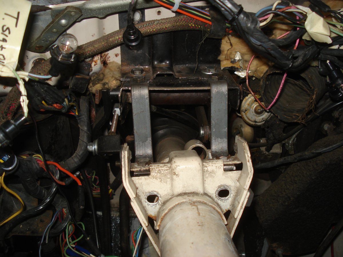

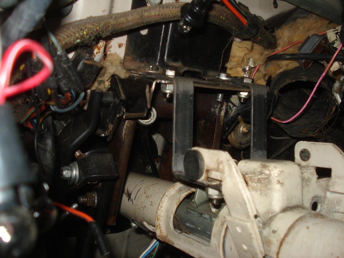

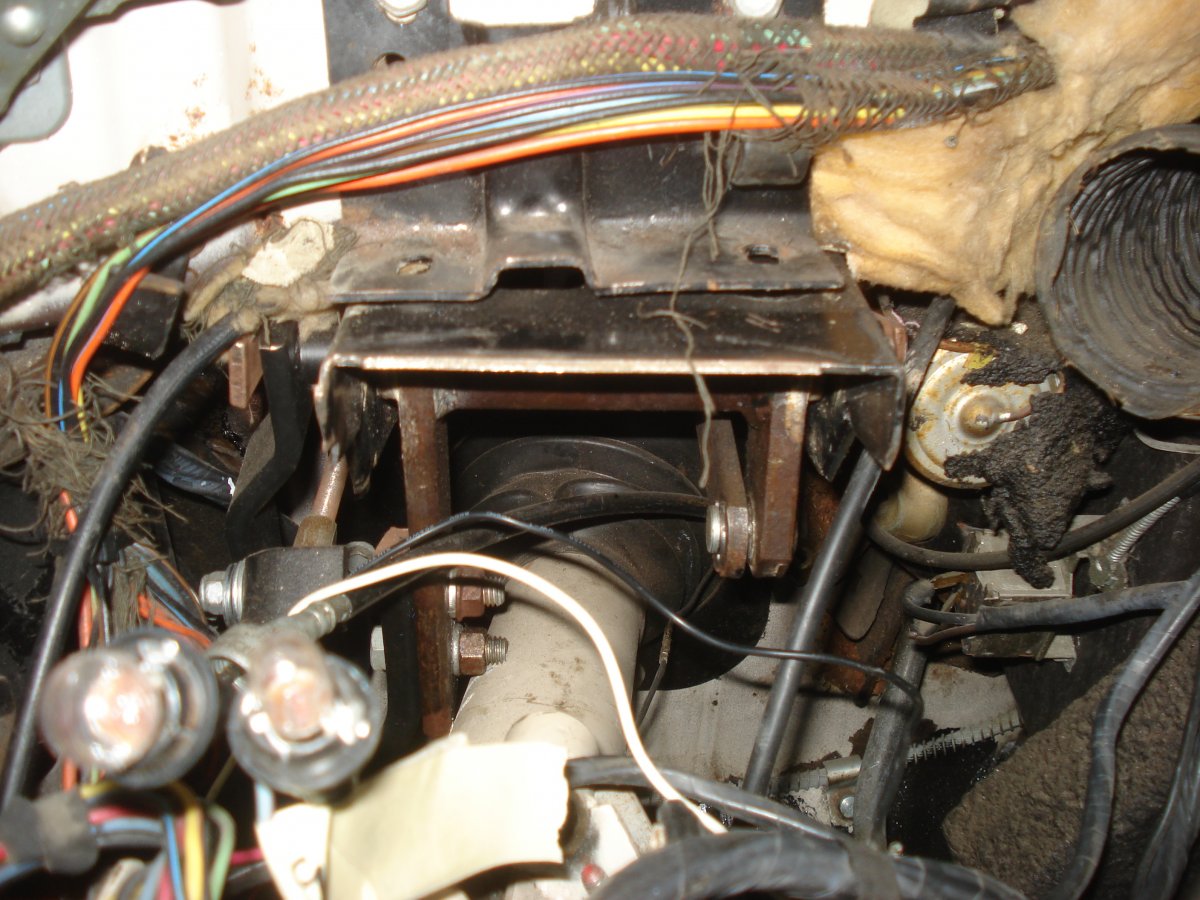

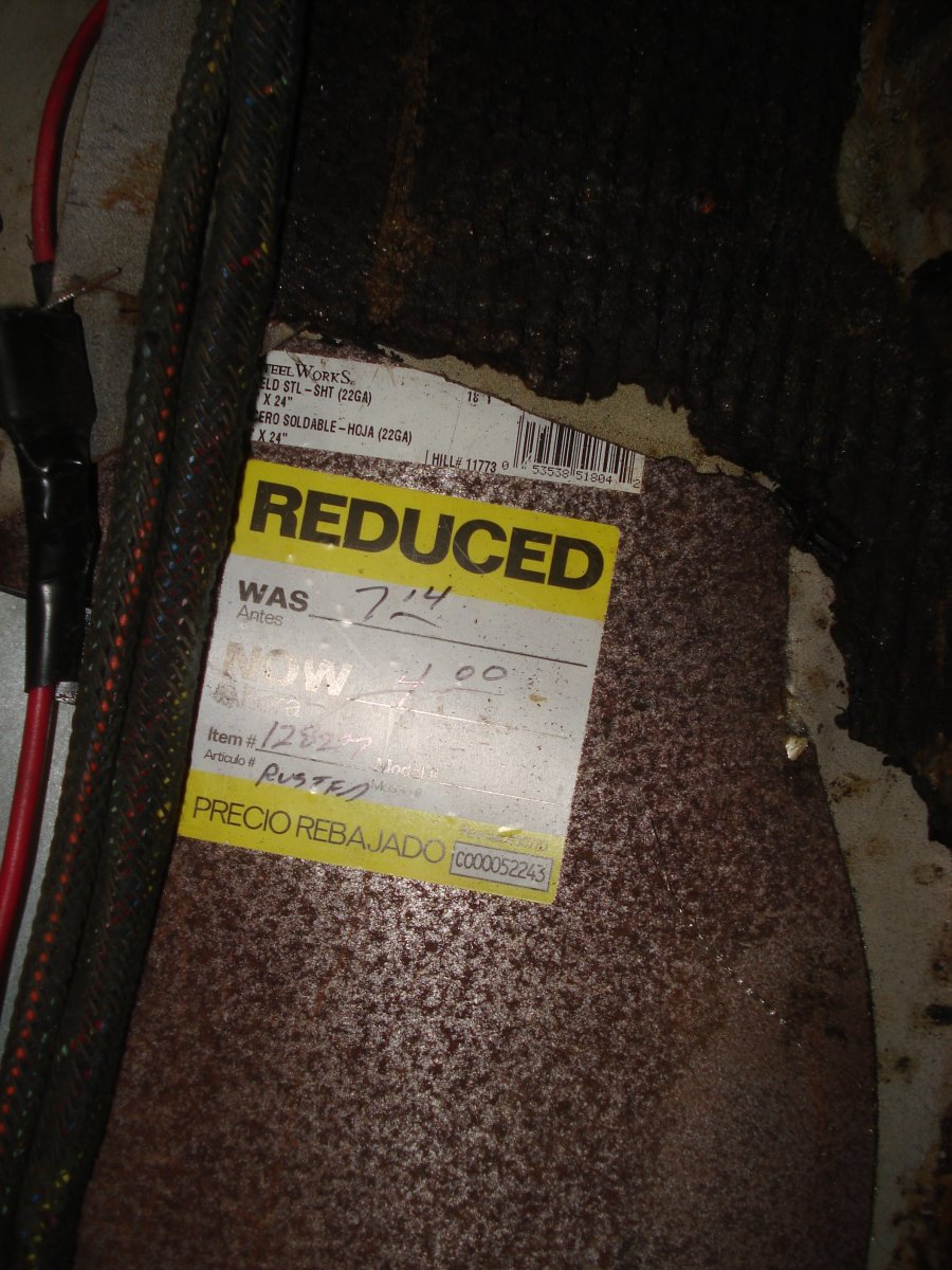

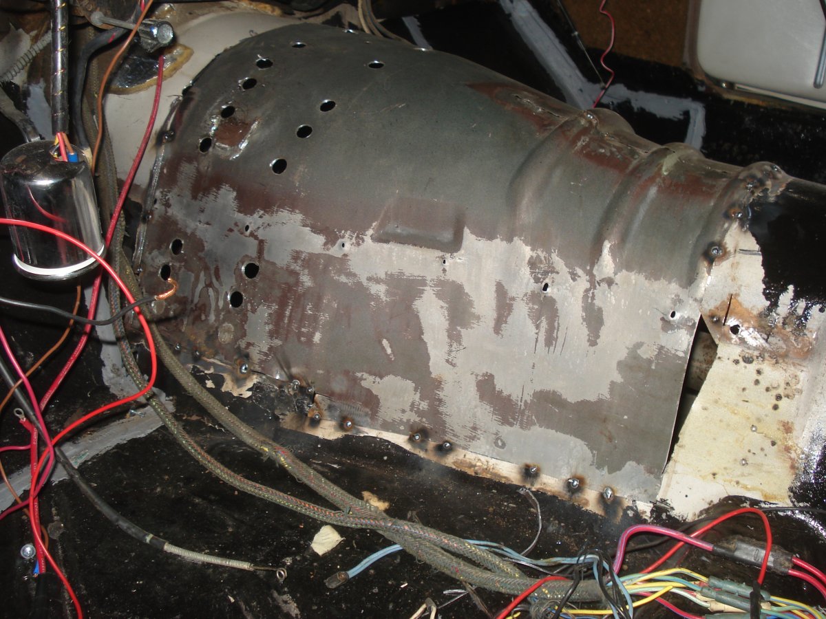

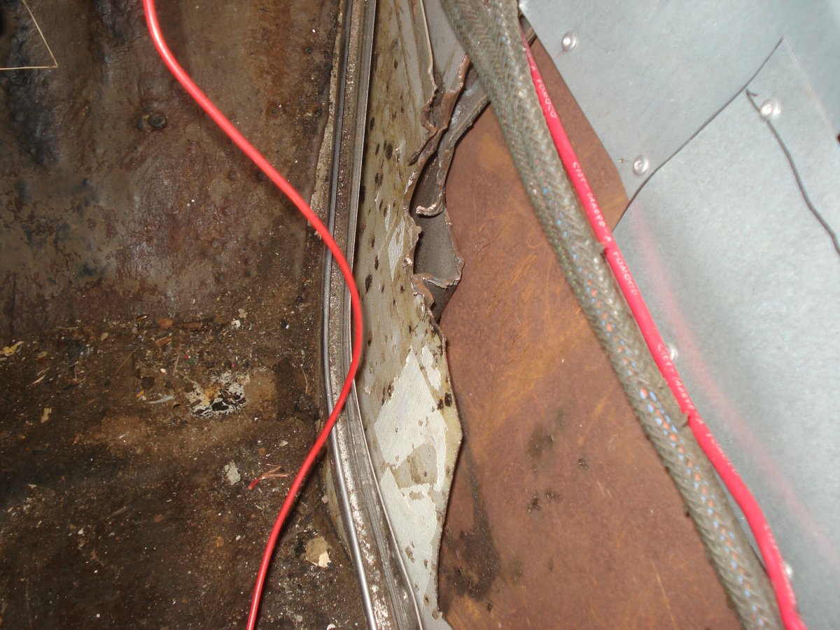

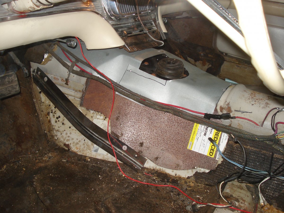

    Sorry this took so long I had lost files on my computer.........So here is what we found when we pulled the carpet...The guy who did the conversion (Ed from Fla.) was a mechanic... BUT HE WAS NO BUILDER...His nick name around the shop was "THE BUTCHER".... When preparing for the trans he cut out 22" of the hump from front to back & right down to the floor...He even hacked the support cross member out ......Then he replaced it with tin & rivets.....I thought he could have at least used a stop sign....We are a town away from Pat Wilsons T-Bird parts & he cut us out a hump from one of his parts cars.....

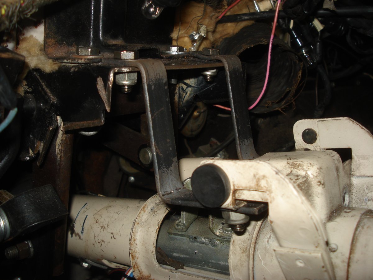

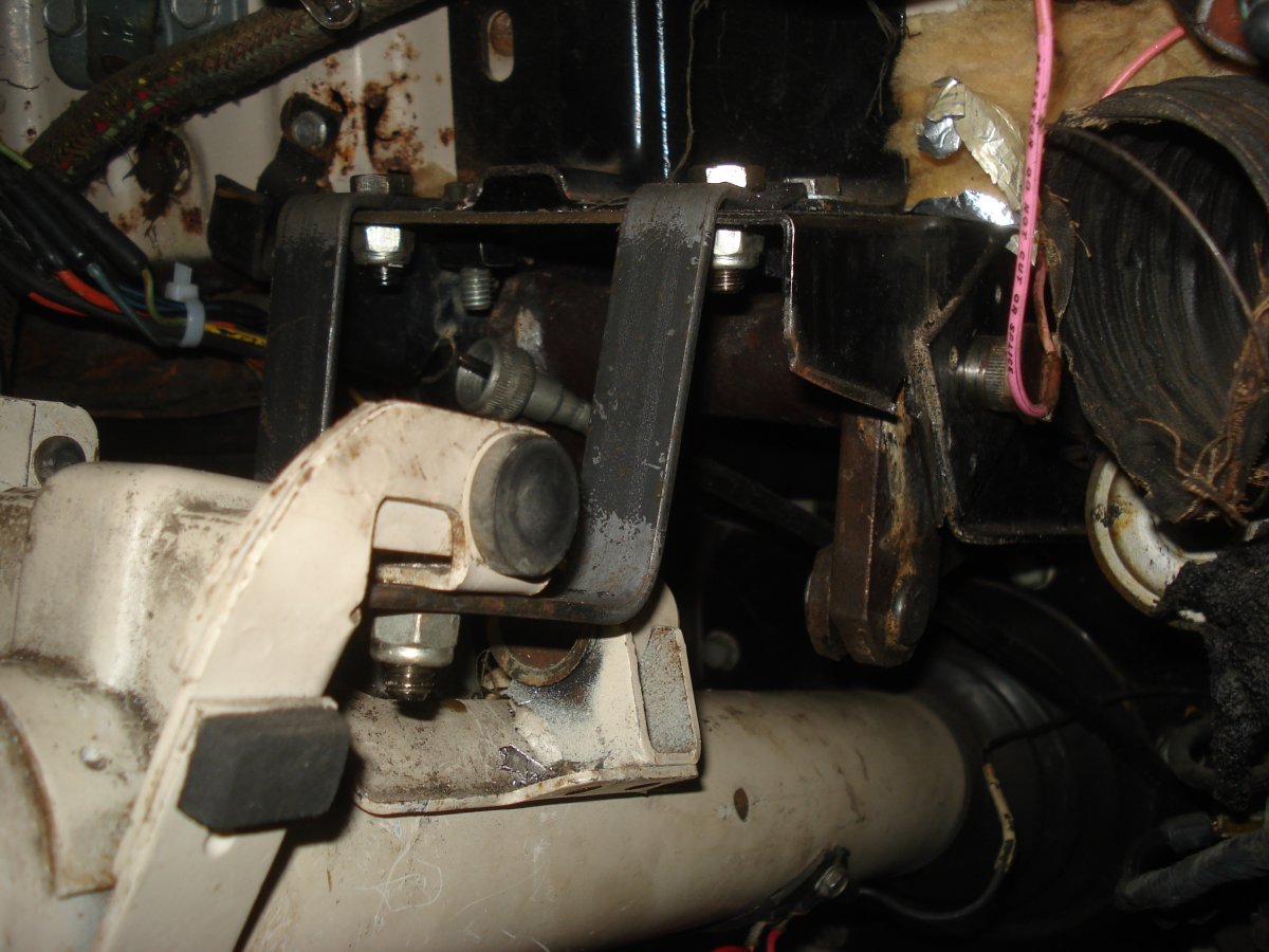

  24. Oldmics
    Joined: Sep 22, 2006
    Posts: 1,250
    Oldmics

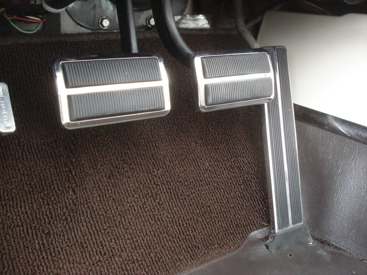

    Tell us about how the pedals were fabbed and hung.
    Are they donor pedals outta something?
    Oldmics
  25. junkyardjeff
    Joined: Jul 23, 2005
    Posts: 8,703
    junkyardjeff
    The pedal pads look to be mid 60s Galaxie.
  26. Torion Boy
    Joined: Nov 20, 2014
    Posts: 6
    Torion Boy
    Yes the pedals came out of a 65/66 Galaxie......What he did was Incorporated the 65/66 into the factory T-Bird bracket..Which was a very large piece...He drilled & installed a rod for the clutch pedal & then cut the arm for the brake pedal & bolted it on...It wasn't a bad job..Works well.....We had to redo how he had the column supported which was relaying on the lower section of the dash...Which was not good !!!! We bent some 1/4" steel & hung it from the brake bracket which gave us more support & enabled us to raise the column to a comfortable height.....The T-Birds steering wheels are known for being very close to the seat & I think this is why they had the swing away wheels...It was almost impossible to get in & out..Hence move the wheel & then bring it back.....I also fabricated some brackets for the seats so I could move it back a tad.....
