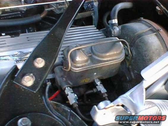

    just a heads up on the front disc conversion...you will have a fun time putting a dual master and booster on these birds with the front shock tower support brace. you will need a compact unit to fit under the brace or a master with a remote fill resevior. ford didnt leave much room toupgrade to a dual master and booster. avoid hacking up the support brace like ive seen so many others do on these

    I'm looking at making a new support brace out of DOM and possibly adding a Monte Carlo bar. Should be relatively easy to make enough clearance if I build it that way.
    More to just tighten up the front unibody and let the suspension work than make it a corner carver.
    4000+ lbs is only every going to corner so good.

    Yeesh, I see what you mean:
    Pretty janky.......o_O

    Same thread, a gent named "hawkrod" chimes in and said he used a 66 brace on his 62 with a 1973 F100 brake push rod:
    Looks pretty good!

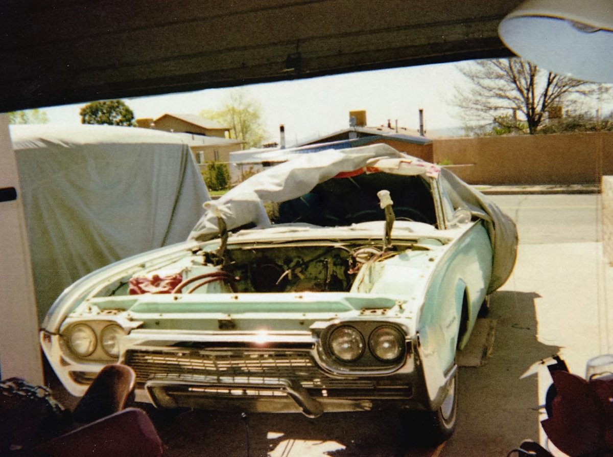

    I love the design of the 61-62-63 T-bird....I dragged mine out of a field in northern NM few years ago, which sat for 15 years....thankfully the dry area left minimal rust! I'm still working on it, and my feeble wisdom is to do ''small'' jobs at time, instead of diving right in on the whole thing! It's a big car, and can easily get overwhelming! My biggest surprise wasn't so much the body work or the engine/****** work, but the interior was a ****** to replace correctly!!! The interior prices $$$ are out of this world:eek:for replacing door panels and dash (notorious for cracks)! All in all...I learned to ''pace myself'' and not get to mentally overwhelmed...after all, it's a 21' foot car, and big doors. Once I got it running correctly, I took it out on the side roads and floored the gas-pedal, and it bolted out from under me. It reached 100 mph, and scared the sh*t outta me:p:D...juice brakes can get squirrely at speed...but the 390 is a nice engine! ---------I painted mine sea-foam fenders & doors with an "off-white" hood and trunk...looks cool with the two-tone paint.....have fun with your car!!! Can't beat the slick design:D 002.jpg 001.jpg
